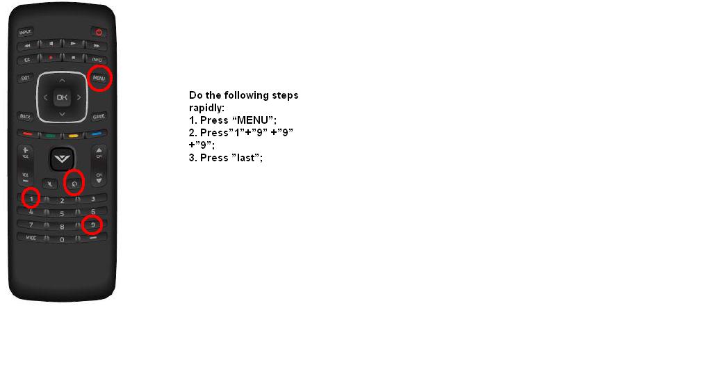

                  • R_J
                    • Jun 2012
                    • 9632
                    Re: Vizio M50-C1/M65-C1 Service menu
                    Try this:
                    Do the following steps rapidly:
                    1. Press “MENU”;
                    2. Press”1”+”9” +”9” +”9”;
                    3. Press ”last”;

                    • xfox
                      • Feb 2018
                      • 84
                      Damn, worked, so one dude from Vizio support gave correct one but forgot about return after 1999, unfortunately that menu cannot change model number, so I assume they flashed it to emmc and it's specific per model
                        I thought that "no service code" was BS from vizio, looks like the one guy was close then the second had no clue so he said there isn't one, too funny.
