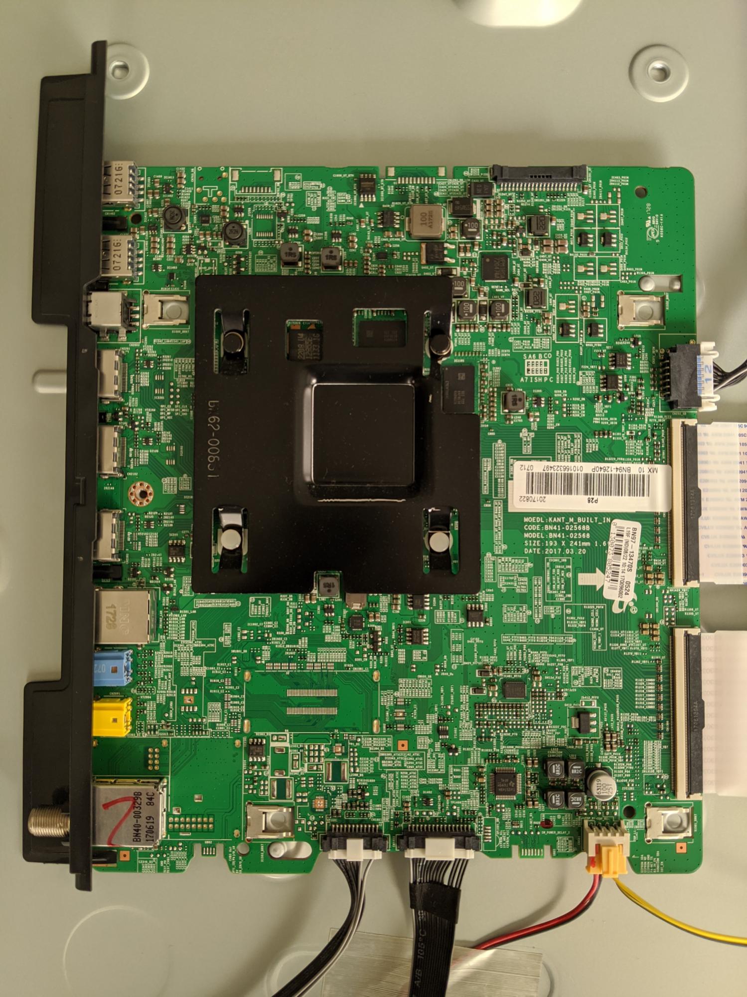

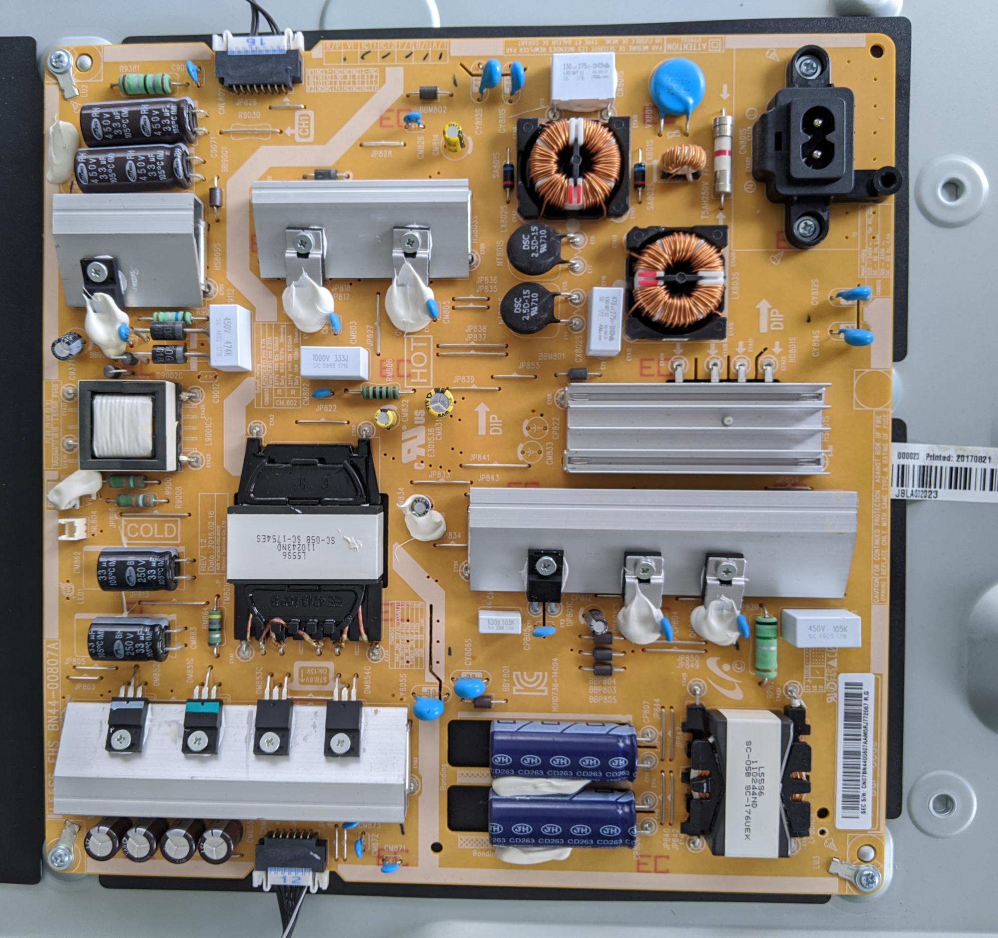

    From this information I assumed there was some issue with the power supply board (could not provide the needed current to the main board) or there was some issue on the load from the main board, so I ordered replacements for both. Main Board. Power Supply
    The main board arrived first, replaced and I have the same symptoms. Replaced the power supply board also, same symptoms. I've tried the other combinations of components and every time I get the same result with minor variations of voltages. I have trouble believing a purchased component would come in with exactly the same issue. I'm more concerned that the power supply had some unexpected behavior and burnt the replacement main board.
    I'm quite confused and what could be my issues. For giggles I tested the voltage at the main-board where the power button and IR receiver come in. At appears that the main board is receiving the communication from both the physical switch and the remote to power on.

    For shits and more giggles, unplug that wifi module and see what happens.
    Your replacement main board isn’t the same as the original. The MU has tons of different versions. Check SJ.
    The PSU you tested correctly by unplugging the main board and the back lights came on. It’s a main board fault or something connected to the main board that is at fault.

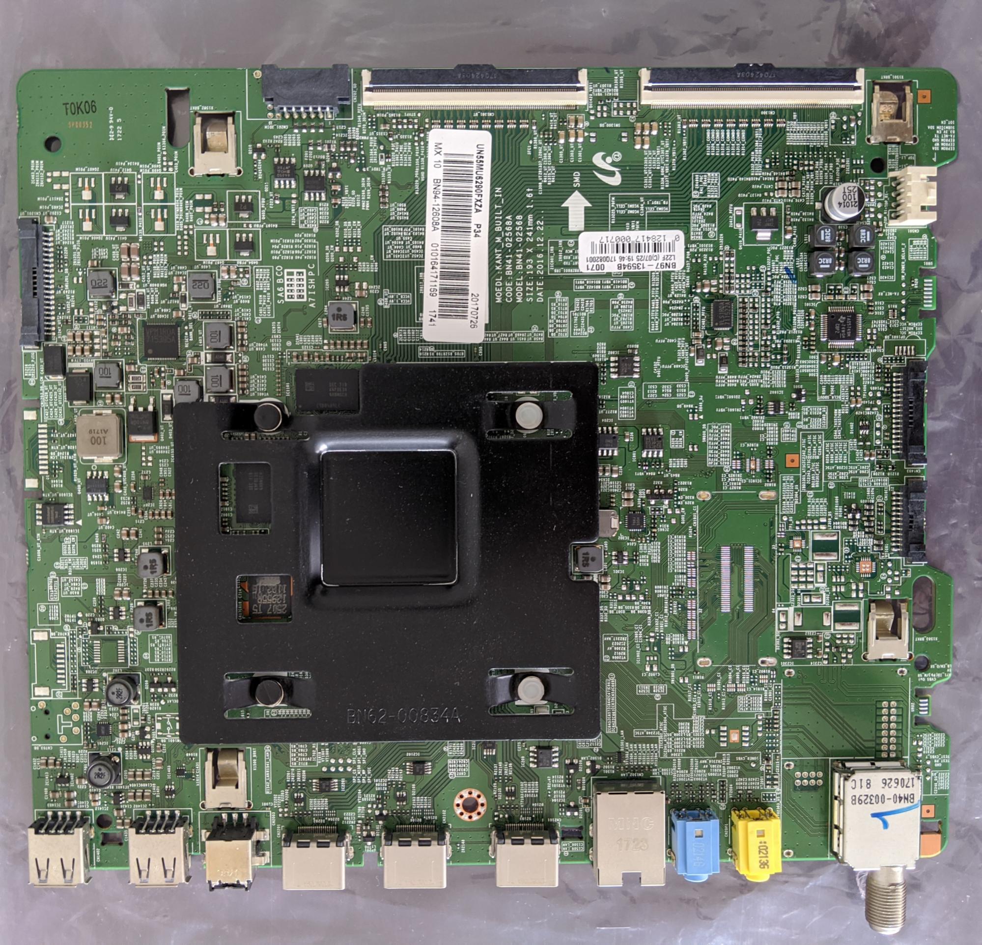

      Shop Jimmy suggested that the BN94-12640P is a substitute for BN94-12608A here. I actually ordered the BN94-12608A but the BN94-12640P was delivered. Either way, I can't find either of these board in stock anywhere else to purchase a third.

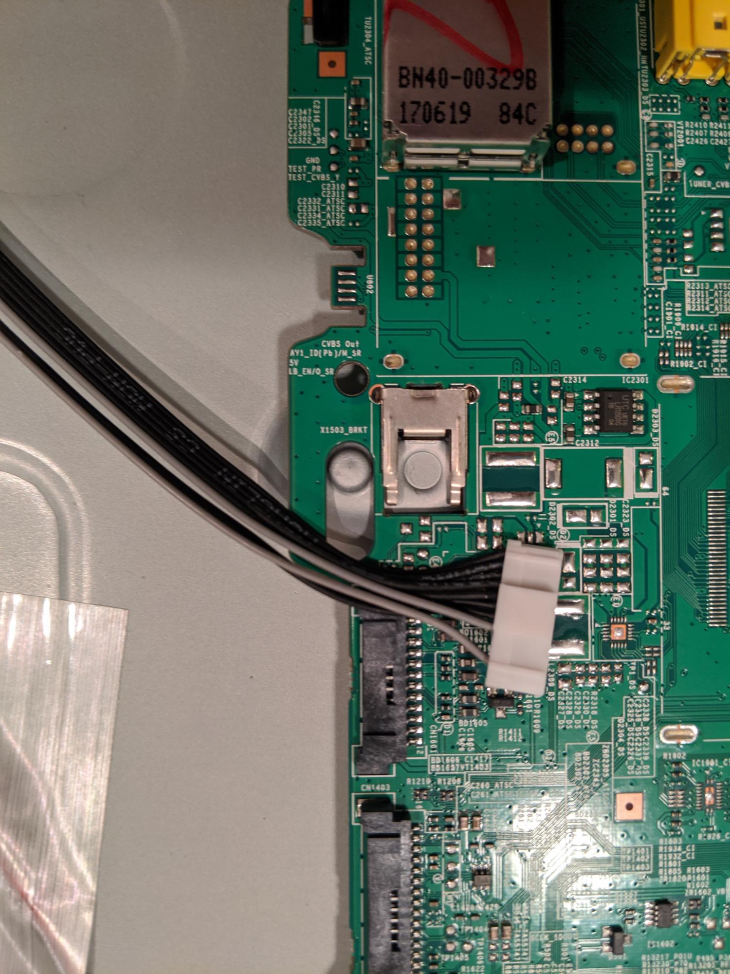

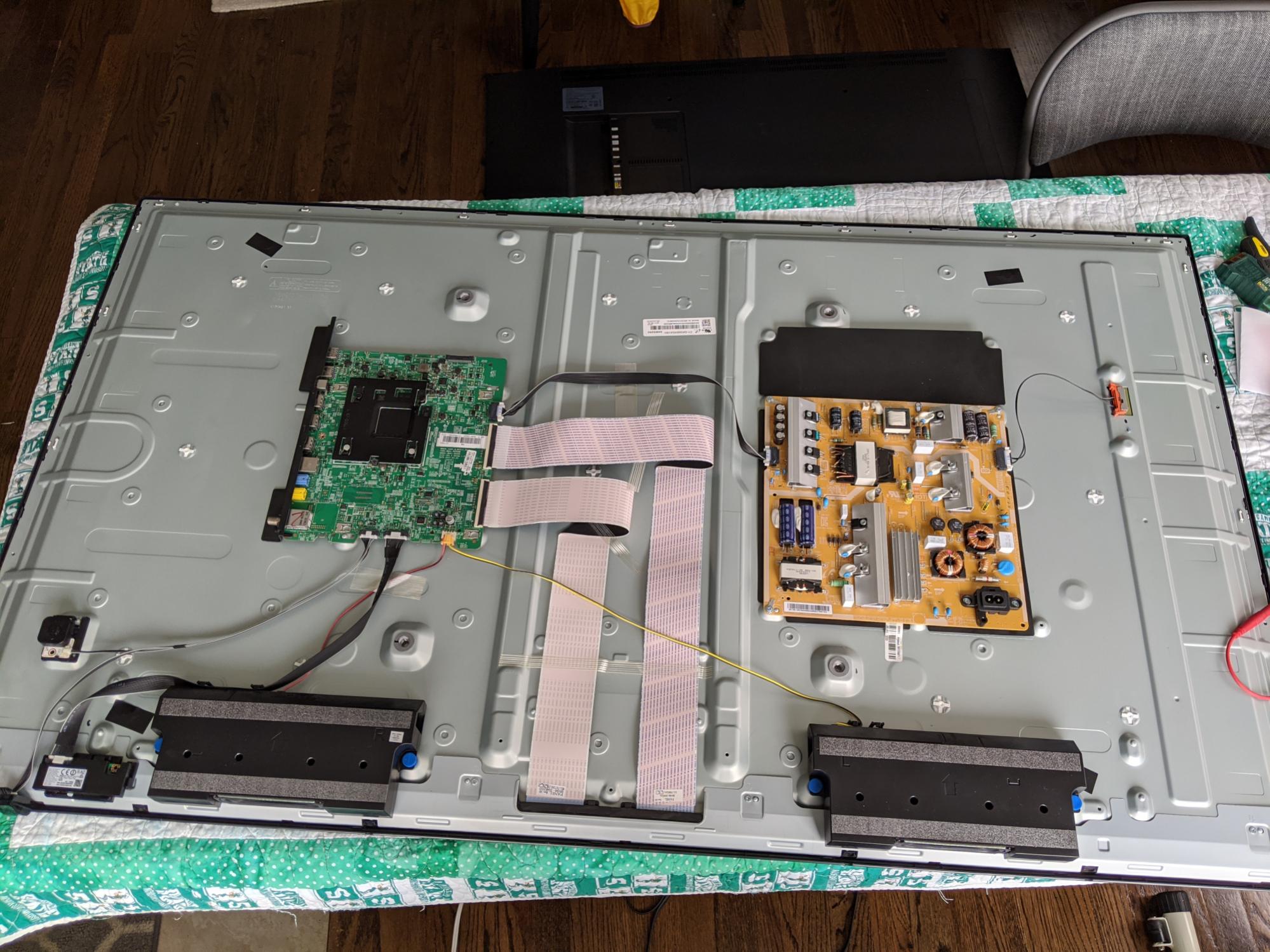

            Originally posted by notallbad
            When you say tested voltages with everything disconnected did that include the 2 ribbon cables to the T-con/panel?
            Yep, T-Con disconnected as well as pictured here.

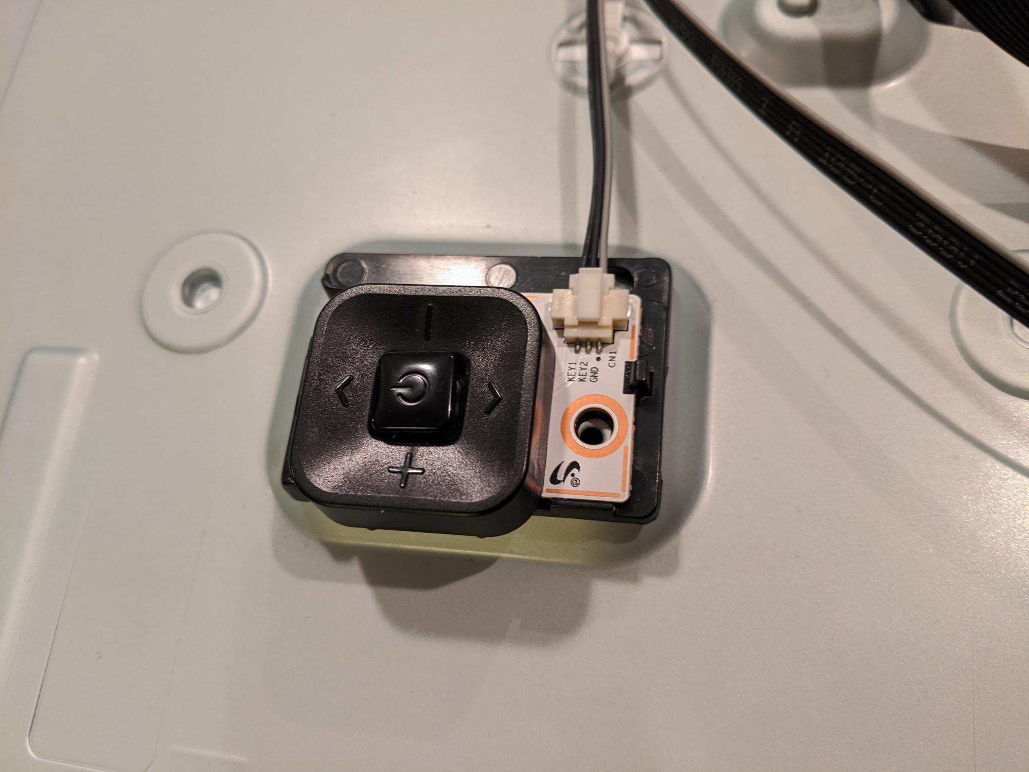

                Yes, that CN1601 connects to the IR receiver and a combination power and navigation button array. See attached picture for a close up.

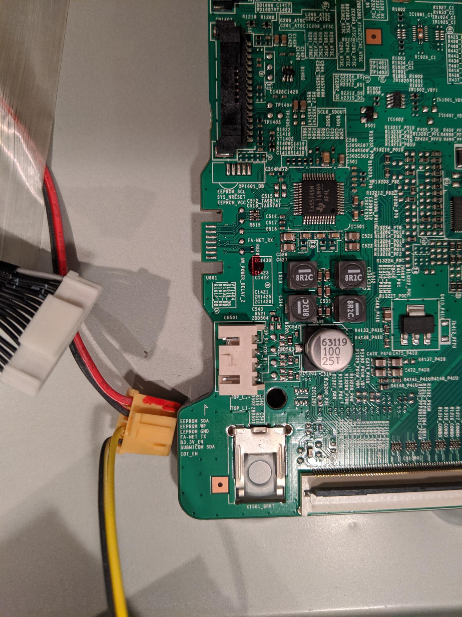

                So far I've completed the testing on both sets (original and replacement) but fair point to isolate. I can't find a good detail of the circuits on the main board to understand what I'm testing and what the test would be on.
                I've attached two more images showing this area of the board surrounding the CN1403 and CN1601.

                  Even with a bad eeprom, the stby led should be still on. I wonder if that joystick ir receiver combo is any good? Try to see if something shorted there. Other than that this doesn’t make any sense, unless you got 2 bad main boards. It shouldn’t happen, but once in a while it does, even with SJ. Speakers are disconnected too?

                    The IR sensor and the power/joystick can be unplugged individually. Isolating each and trying to power on has the same result as before, no led, no backlight, and no change in 9V from the powersupply.

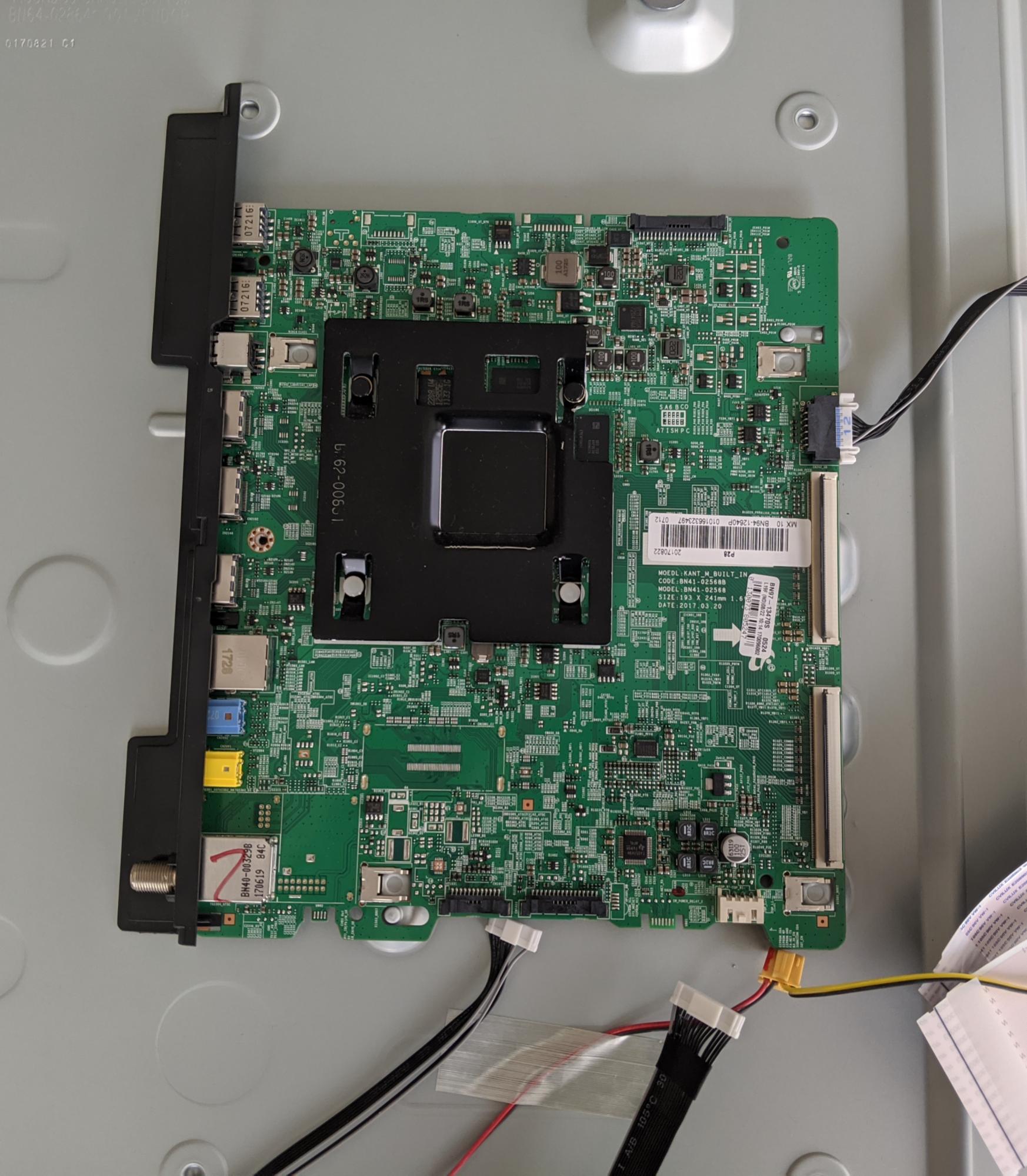

                            Replacement main board board 2.0 came in today. Hooked up and now we have a new situation.
                            Standby LED is illuminated. When the power button is pressed (Remote or button) the TB attempts to boot with a second or two of back light, then backlight goes away and seems to start a boot loop cycle about every 10 seconds or so.
                            Loop is:
                            1-2s backlight activated (9V standby changed to 12.9V)
                            2-10s backlight drops out, (12.9V drops significantly and comes back up to 9.09V
                            Nothing really changes by unplugging the Tcon, wifi module, or IR/power nav (using the other to power on)
                            I'm assuming this is EEprom or some other issue which I'm not familiar with correcting. Any recommendations with this other failure mode?

                              Turn the tv off and unplug one ribbon cable from the main board to the panel and turn it on and see if it stays on without turning on and off in a boot loop. If it does stay on turn the tv off. Wait about 5 minutes and then hook that cable up and unhook the other ribbon cable to the panel. Turn it on. If it boot loops then you have a short in the lower driver board on that side of the panel. A common fault on both the 55" and 65" MU models. This is a tedious repair involving a capacitor or two on that driver board that are in parallel so it takes a lot of time to find it. This is the result of Samsung's attempt to eliminate the tcon board to save money and allows a surge to take out these tiny caps instead of a tcon board. We are seeing this so often now we just refuse the repair due to the bench time involved in doing it right. And now Samsung's Display has announce they will no longer manufacture panel's for Samsung and sent Samsung begging back for mercy at Sharp for panels. What are you thinking Samsung? Just pay more for the panels from Samsung Display so they can make a profit instead of going back to Sharp panels that can't perform. And then to make things worse Samsung announced they will end their agreement with Kateeva for their new QD Oled film technology development that looked promising and put Kateeva nearly out of business. Don't be surprised if TCL or Hisense swoops in like a vulture with a claw full of cash and buys Kateeva or it's technology giving them the edge for the first QD Oled before Samsung's engineer's have a chance to breath, and then cry.

                                Thank you for the insight. I checked the operation with individual ribbon cables. In either condition the unit still continues to boot loop. I also checked with no ribbon cables, same boot loop.

                                  I guess you got another bad main board. Send it back and get another one. Maybe try to update firmware?
