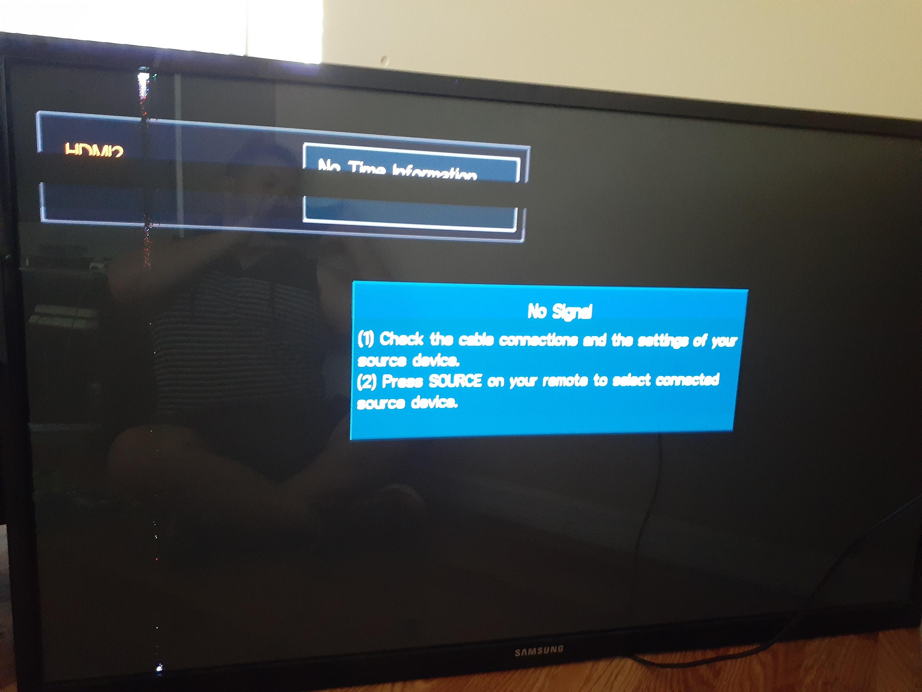

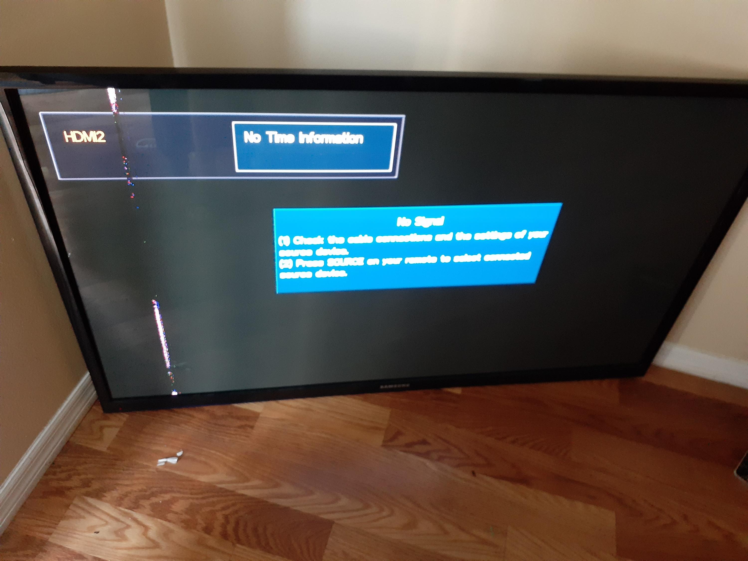

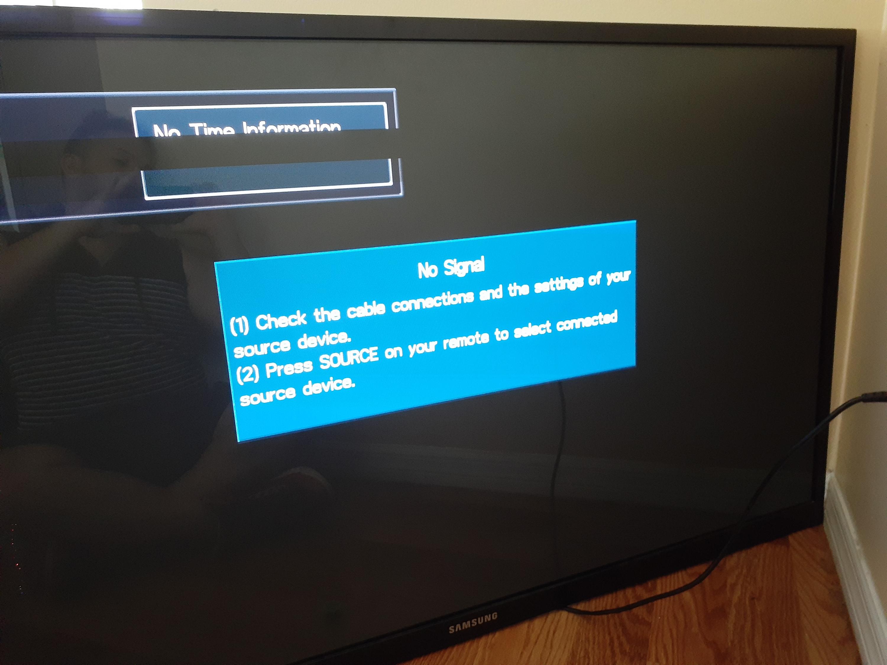

TV gets boot sound but no picture. Light in front flashes 6 times, then it gets the boot sound.
I had replaced y buffer, and y main. That did not get the panel to do get a picture, or boot. Suspecting power supply, main logic, or main control board.
I tested the connector from PSU to main controller board. The pins are getting the right readings for standby (5v), and the pins for that connector are reading the right voltage indicated on the board such as the 15v, or 5volts etc.
VS is reading 10v, VA 0v. Well below what it states in the tv.
