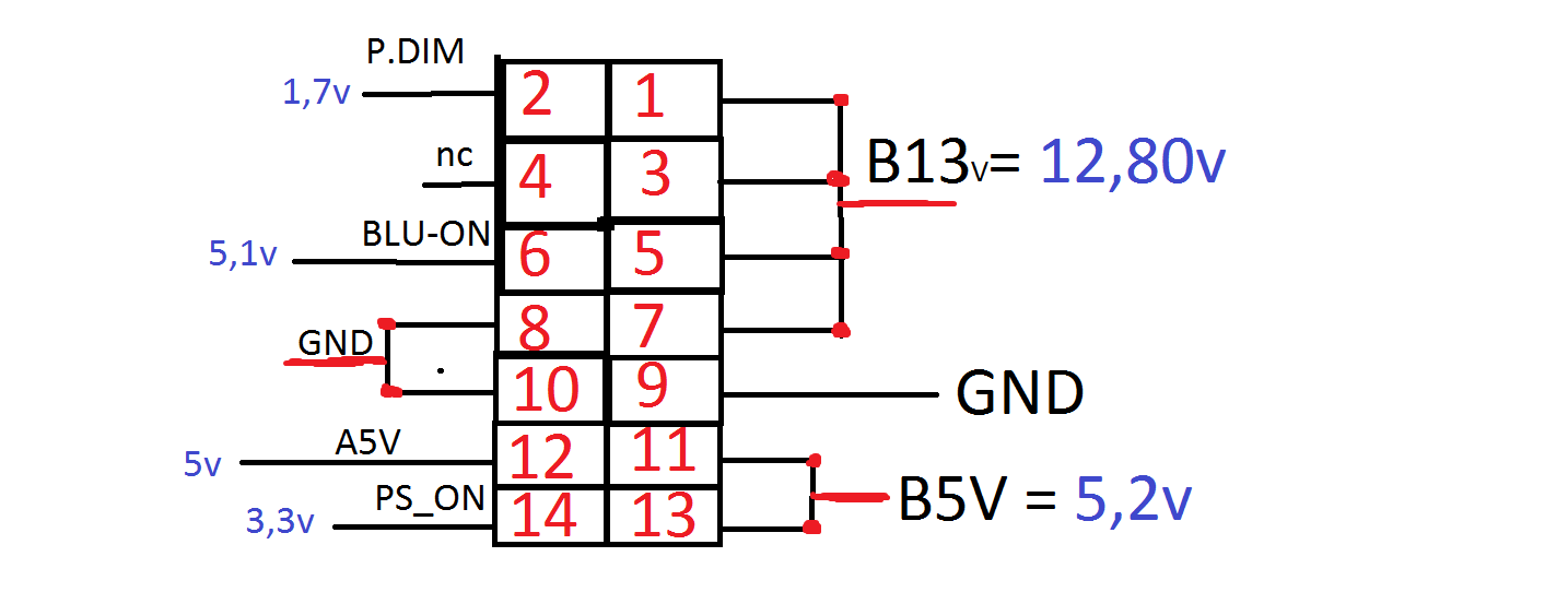

    I am measuring voltages on the CNI802 and will report them shortly, thanks to all those who will participate in the discussion ...

    Here are the tensions on CNI802 which goes to the main, in blue the detected tensions that seem to be all normal, any suggestions and well accepted, at first glance no obvious signs, retouched some welds without result, no short circuit in appearance on mosfets and diodes on the surface, dc voltage on mains filter capacitor 390v stable, thanks to all

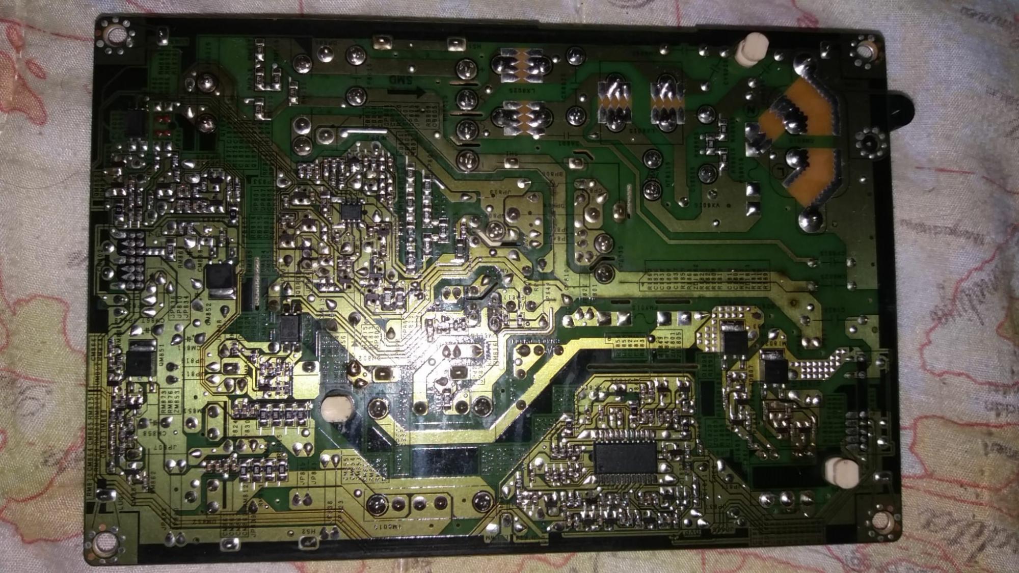

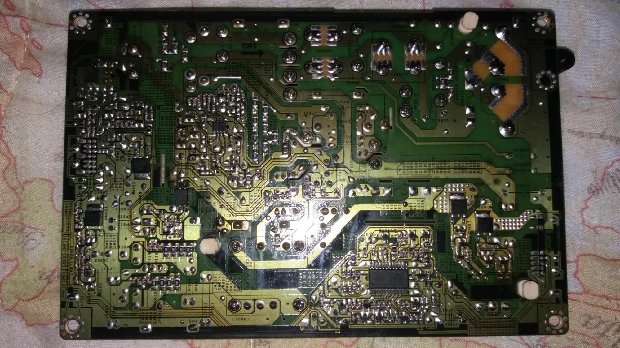

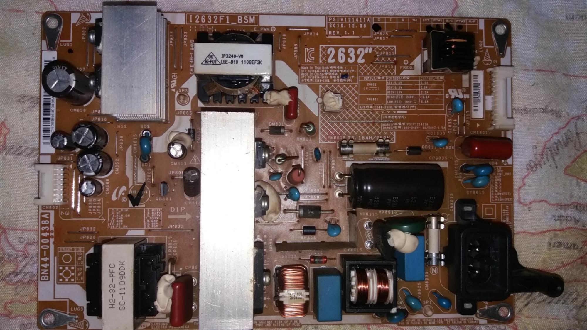

      Please attach good clear straight shots of the whole top and bottoms side of YOUR board for us to look at.
      • toty79
        • Mar 2019
        • 42
        • Italia
        Re: Samsung LE32D400E1W no backlight
        Thanks budm for joining us, here are the photos I hope will go well

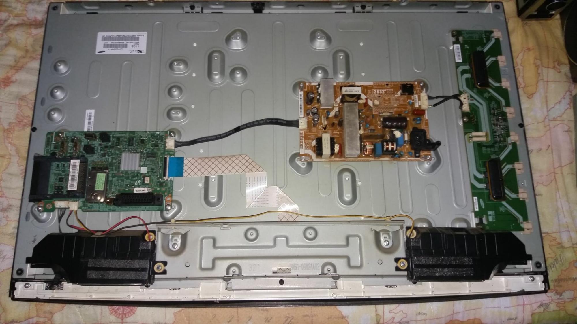

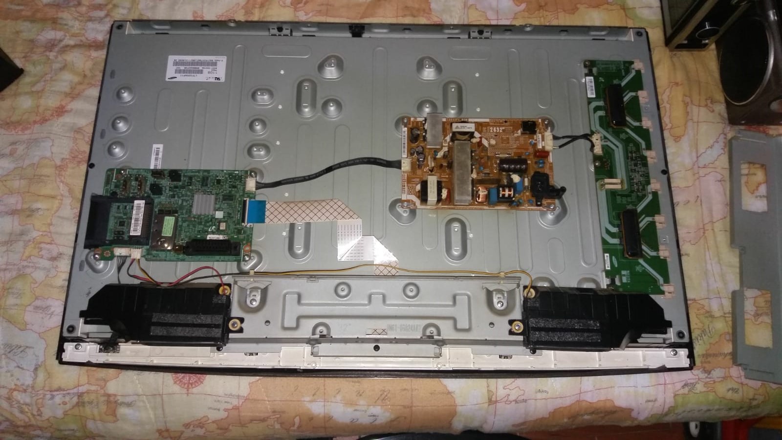

          Where are the whole backside of the TV showing all the boards?
          • toty79
            • Mar 2019
            • 42
            • Italia
            Sorry here they are, thanks
