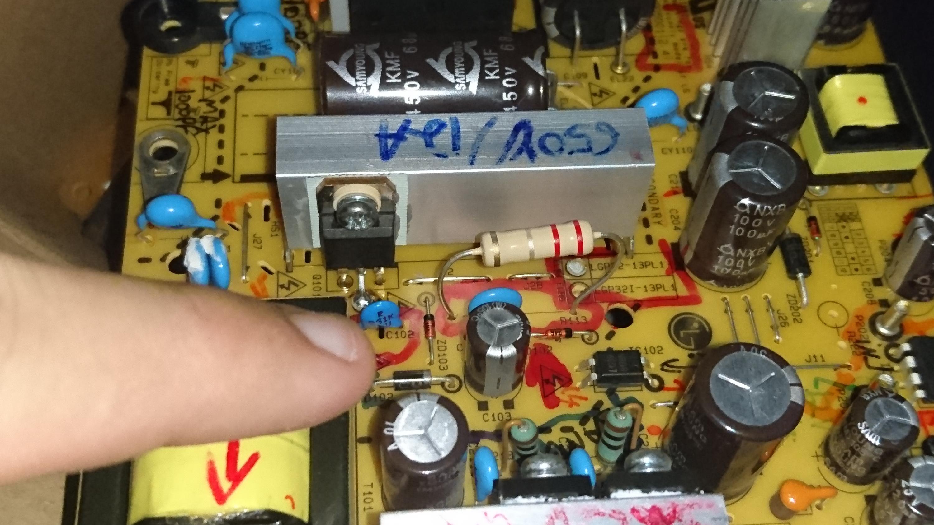

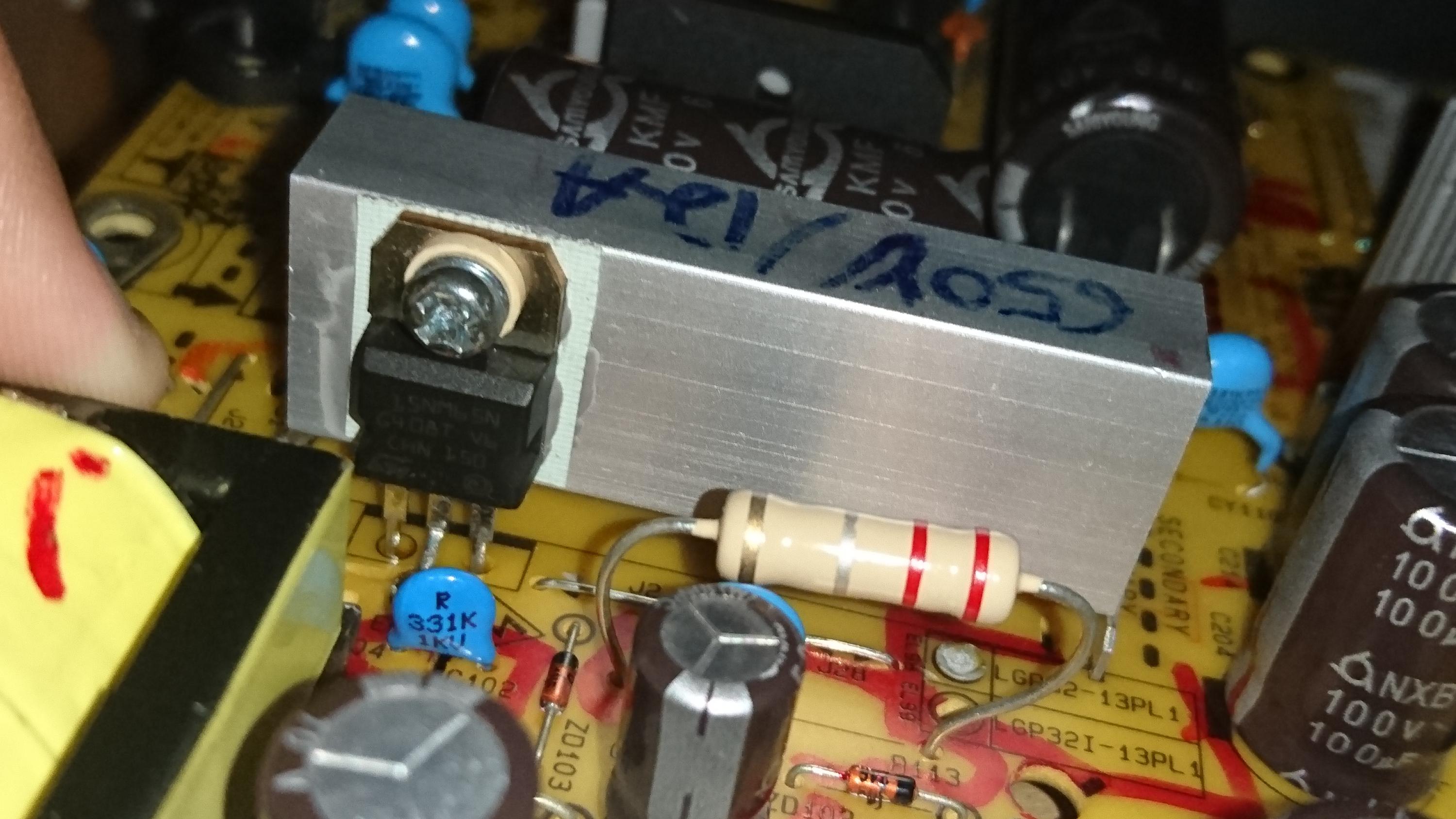

        Hi
        Its the c102 of the MOSFET ( on the TV PSU)
        It's a blue 1kv 331
          #44
          Re: Diagnosing EAX64905001
          So it tested shorted, correct and you replaced it when you replace the MOSFET and the resistor as shown in your pictures, correct?
          You still need to verify the Gate drive diode/resistor network as suggested per post #35.

            #45
            The c102 was completely burnt, luckily I was able to read it's value
            Yes, in additional to the th101 thermistor which had a hole on it( although it's still was changing resitance due to temperature changes 😂+ main fuse of course ( with a lower amp(3 instead of 5, probably because it's ready for 120 vac ) and fast blow type to minimize further damage on the future when the Mosfet will fail again

                  #48

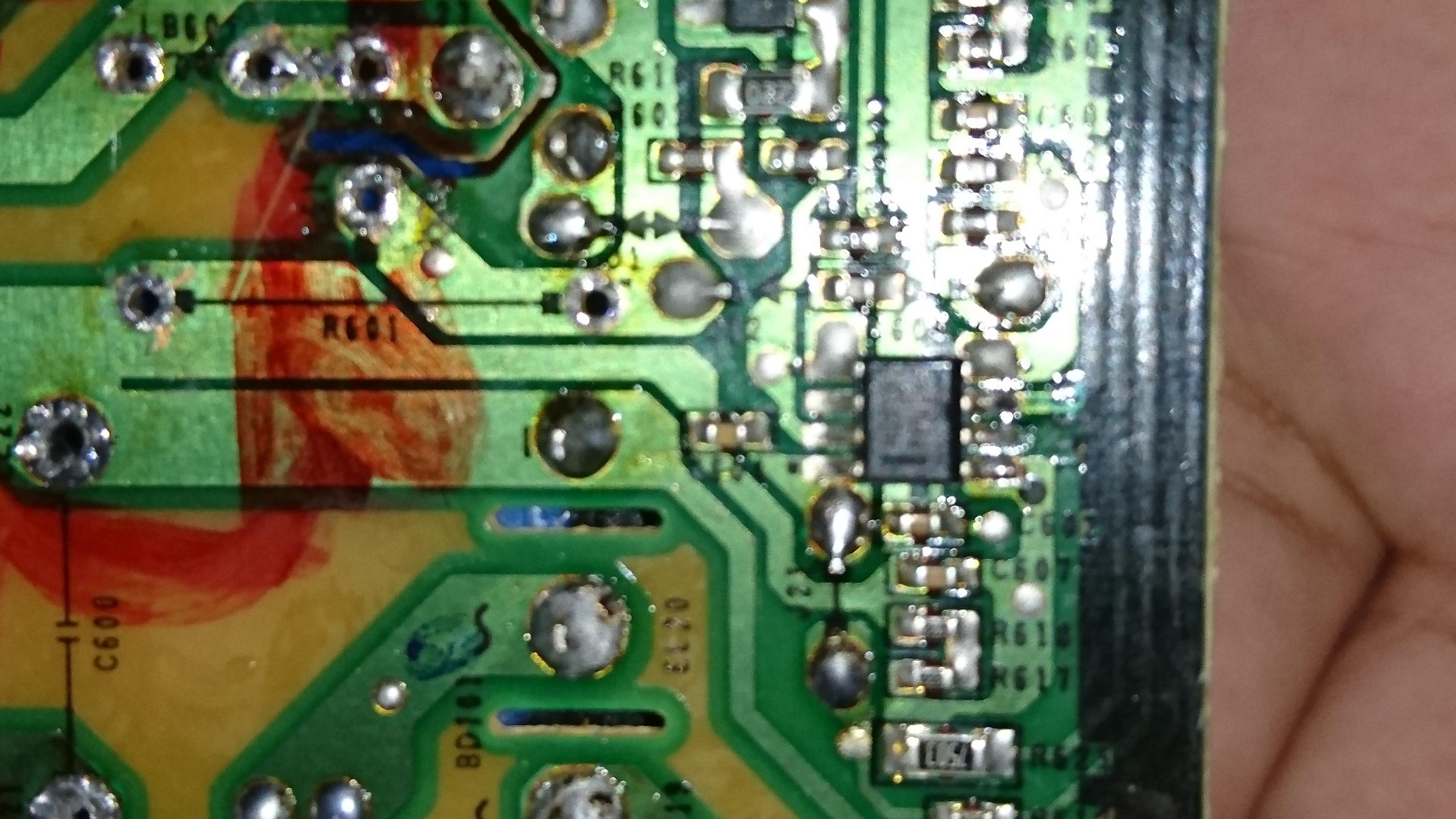

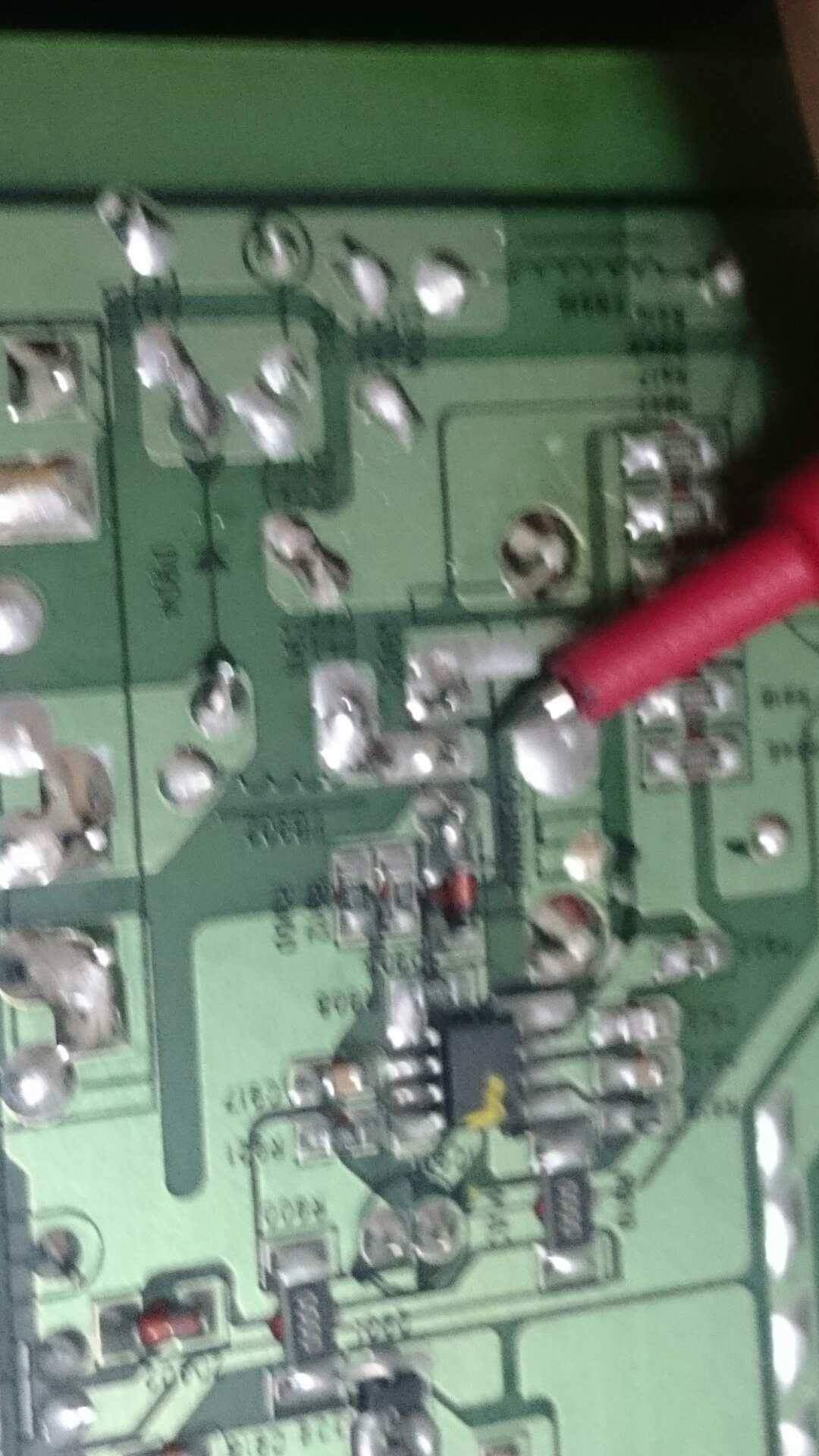

                  Hi
                  So I've desoldered that ic,
                  Here are its markings
                  SSC1S311
                  Sk2d3a\ Sk203a ( not sure if it's a "D\A"
                  518t
                  And here are the values of the 2 resistors + D103 ( while only the IC isn't in the circuit)
                  R108(101 markings on it) = 100.1 ohms
                  R107(220 markings on it) =22.6 ohms
                  R111 ( 103 markings on it) =10.00 k ohm
                  So far, looks good right? �� ( besides the Mosfet ic that I don't know where to find a cheap replacement that will actually work and wont be fake)
                  D103,while still on circuit ( but without the Mosfet ic) = 0.150 in both directions, but as you said its because it's connected together ( if you suggest to test it outside the circuit to fully troubleshoot the psu, Could you please advise me which temperature to set my ( fake hakko 936) 75w soldering iron, to minimize the risk of blowing that tiny diode? Or i can set it to the highest level (450c) And do it quickly?
                  AND now, is there a reason to retest the Mosfet ic again while it's out of the circuit or if the R107 ( = it's " fuse" reads good) + as you said that there's no way that It'll survive after the current that passed through it?
                  Thanks for all! ����

                    1) Those resistors are fine, but you still to test other resistors connected to the IC, you need to measure those other resistors connected to the IC, see the schematic.
                    2) Again, YOU MUST: "6) You need to read post #27, #28 since it looks like you have bad resistors on some of the SMPS IC pins look at the PDF schematic on post #31."
                    3) My post #17 "1) There is no chance that IC survive when R106 (220 Ohms) connected to the CS pin of the IC is blown, large amount of current has flown through that resistor to ground."
                    So I do not know why you are talking about R107, R107 is part of the Gate drive circuit, R106 (220 Ohms) is part of the current sensing circuit which you reported the resistance reading in your post #27:
                    "1. Smd, r106; 0.838 K OHM (it has a writing of 221\ [ or 122? ] but looks more like 221" this resistor is bad!

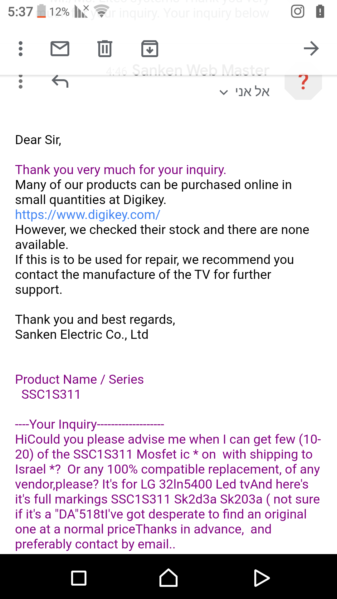

                      I do want to replace that IC, but not at a cost of a half new 32 TV here, on the other hand, i like this tv
                      So I'LL do buy spares, I've thught of excacly the chance that they'll blow up again, but i cant find a reliable seller. I've found a "good + reasonable " price on eBay for 10 ic+ 10 Mosfets( just in case that somehow it'll blow again soon)
                      But reviews on all seller says that they're fake, which actually, if it'll work reliable, even just for 2 years each IC it's good enough, but im afraid that itll damage the PSU further and that's why i don't know what to do this ic is out of stock...
                      And there's a 2nd PSU'S on eBay for about 30 bucks BUT actually i want to learn how to diy repair it, but on the other hand, not spending more than a working psu( although i cant know how much life left on the ebay's PSU...
                      Below is the Sanken reply to my question on where i can get it...
                      Lg wont respond to me( and probably never will,as they want us to buy thier new TVS every 3 years
