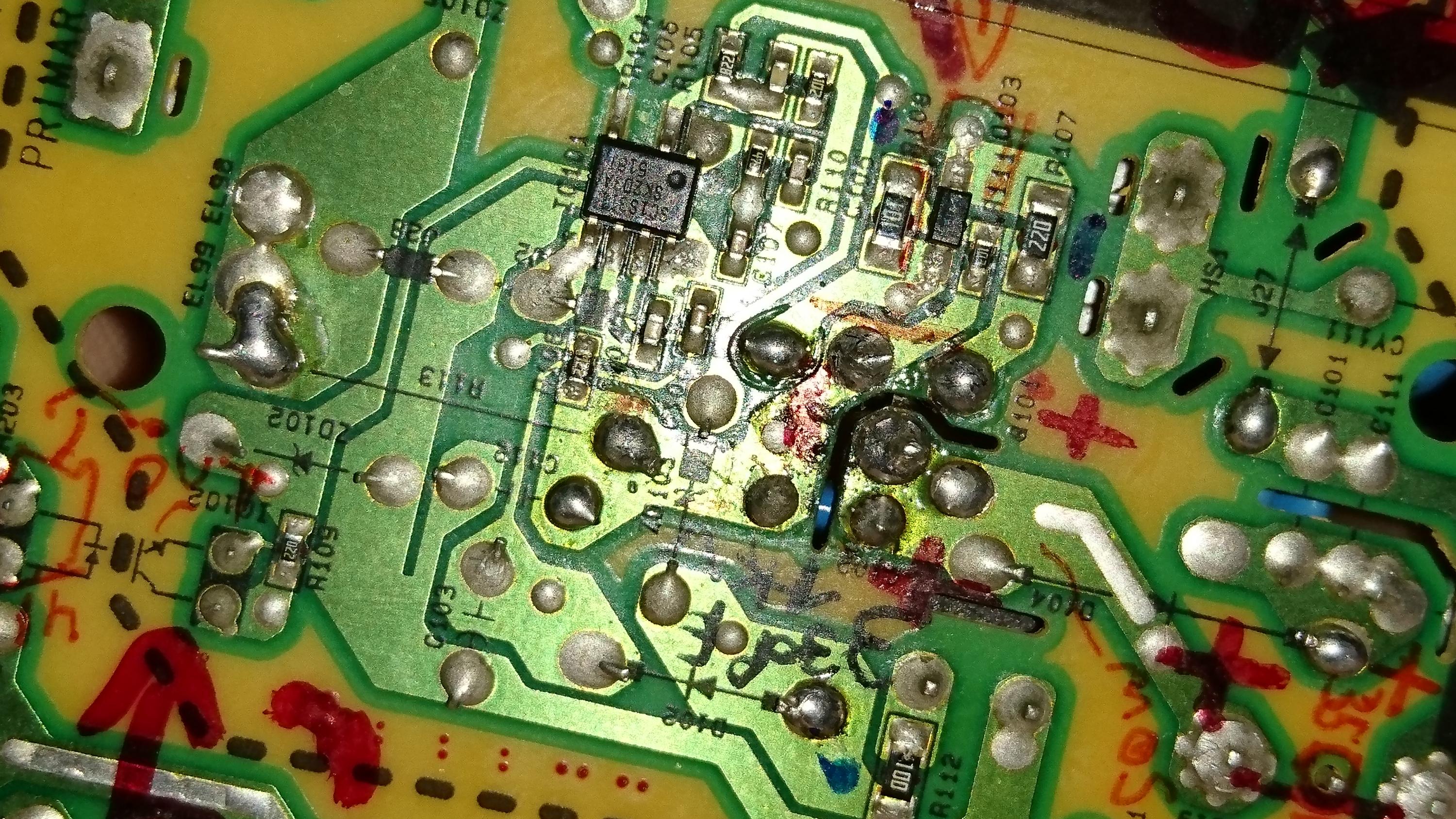

      Some of your solder joints look a little funky as well, maybe touch them up.
      ok which area looks bad?
      The Mosfet\ motherboard output?

        They may be ok, I can't do it for you, the 2 links there show all manner of possible bad joints, just use your eyes and possibly finger to see if any are bad or loose.

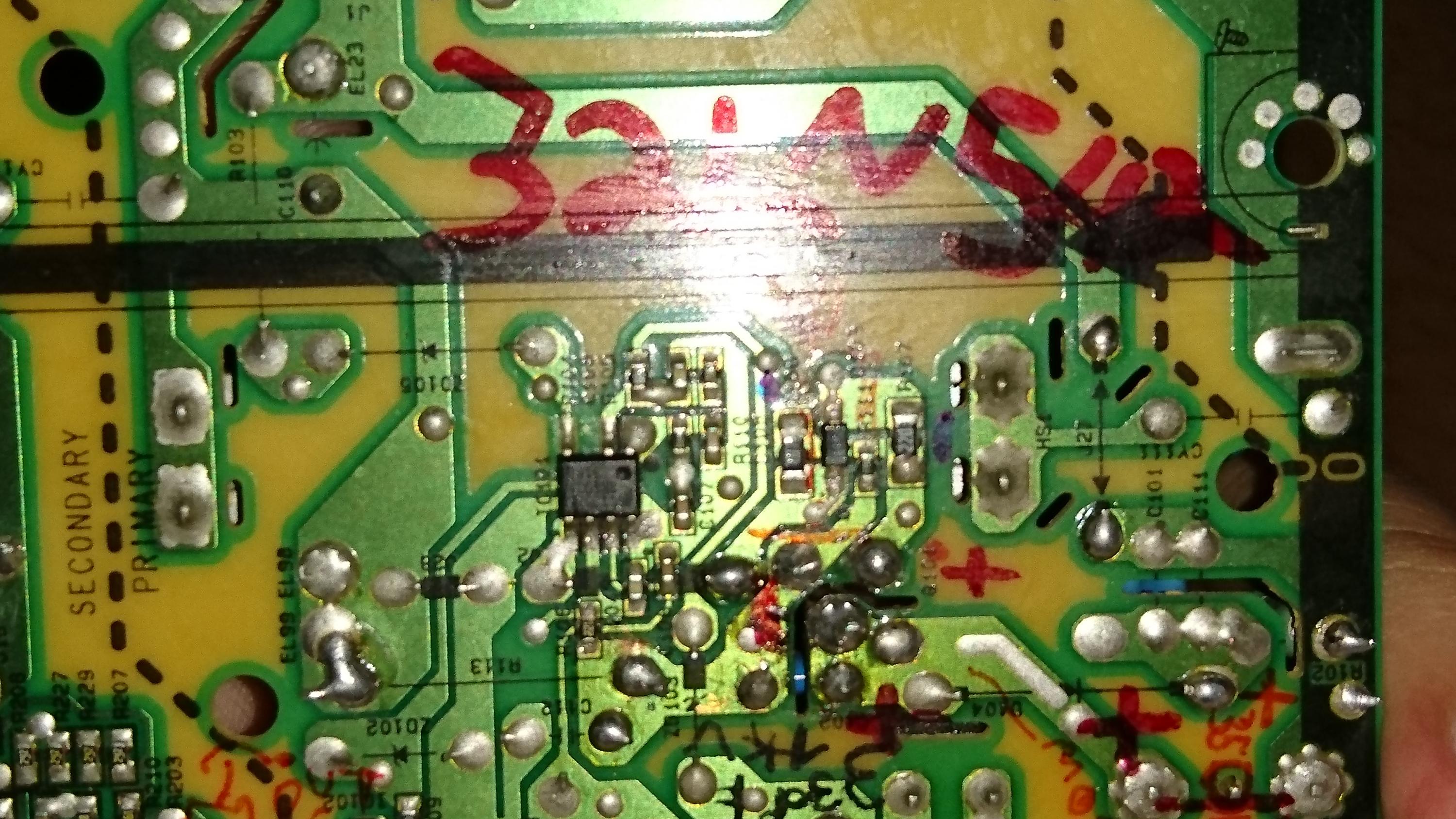

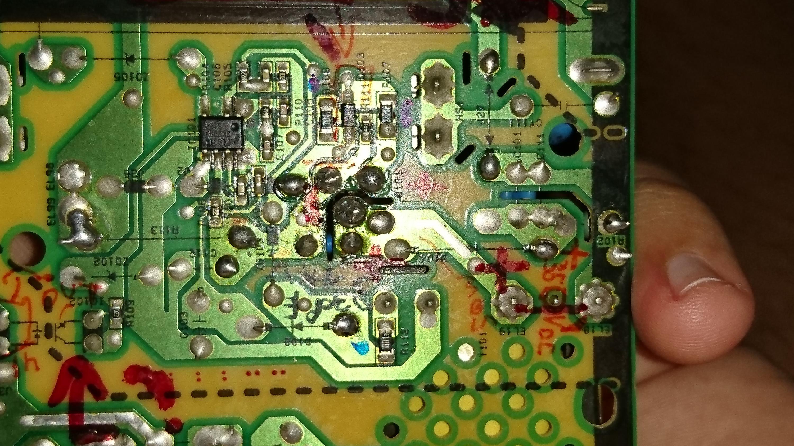

                Ok so I've tried to test all the components resistance around the Mosfet & its ic
                And here's what I've found..
                These are 2 suspicious smd resistors ( both around the Mosfet ic) not sure if the Mosfet ic is bad or the resistors close to it are bad ( tested in circuit and I'm pretty afraid desoldering & resoldering them so i wond destroy them completely on that process [ but im assumes that I'll have no choice in order to find the culprit? to either desolder the IC \ these resistors,
                But I'm think that it'll be smarter to start desoldering the IC as long as you're thinking that he's the real culprit?! ]
                Anyway, here's the suspicious resistors + thier reading values
                1. Smd, r106; 0.838 K OHM (it has a writing of 221\ [ or 122? ] but looks more like 221
                2. Smd, r111; 176.2 OHM - out of 10k ohm = (it has a writing of 103)
                About the Mosfet ic results with the black probe on the ground
                Pin 1- 8.01 MEGA OHM ( with the round notch, parallel to the GND
                Pin2 - 0.994 K OHM
                ( pin 3, -NC)
                Pin 4 - when ive test it first few hours ago it showed me** 27.01 MEGA OHM, ** when I've retest& note myself the results -** it changed to " OL" - ** not sure if on the first time my meter lefts a little voltage there or IDK how it happens.. I'VE HAVEN'T PLUGGED IT IN for weeks, including today
                Pin 5- 78.9 ohms
                Pin 6- 0.838 K OHM
                Pin 7 ( vcc) keeps dropping down every time I've retest for the last few hours....
                It starts at 30.0 MEGA OHMS and keeps dropping down........
                Pin 8 ( GND )
                Thanks for your valuable time!!!! ❤

                  R106 should read 220 ohms
                  R111 should read 10K but may need to be lifted to have an acurate reading.
                  The other measurement should have had the black meter lead connected to pin 8 and have readings roughly as follows.
                  Pin 1 should read around 47K since it is connected to ground via R110
                  Pin 2 should have around 1K since it is connected to ground via R105
                  Pin 5 should have around 10K since it is connected to ground via R108+R111+R113
                  Pin 6 should have around 220 ohms since it is connected to ground via R106+R113

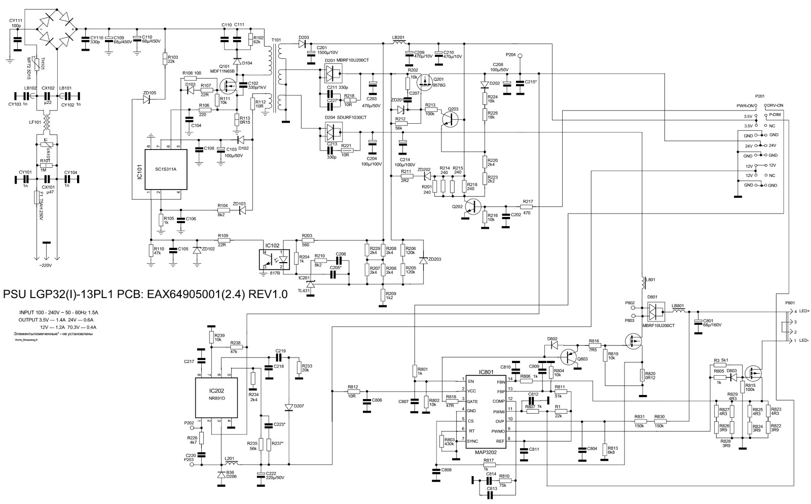

                      Hi dick_barton, Do you have the PDF of the schematic or the whole service manual? Thanks.

                        Re: Diagnosing EAX64905001
                        Here you go budm.

                            At this point the SMPS IC is damaged due to the fact that R106 (220 Ohms current feedback) is blown when 300V is dumped into the IC via R106.
                            How about the Gate resistors and diode between Gate drive output of the IC and Gate of the MOSFET.
                            BTW, most of the time when that 1KV snubber cap is shorted out, the MOSFET will still be OK.

                                If you look ate the schematic, you will see that the Gate Resistor/Diode network (R108 (100 Ohms), R107 (22 Ohms), D103 are connected in series/parallel fashion, that it why when you test D103 you get reading in both directions. If the Gate components are tested bad that means the 300V is also dumped into the Gate drive output of the IC also.You do understand series and parallel circuit, correct?
                                You need to use the same SMPS IC, it is not standard IC.
                                That 1K snubber cap (connected in parallel with S-D of the MOSFET) failure mode is shorted circuit, it is commonly fail cap. I would replace it with 2KV rating instead, but for now you can use what you have.
