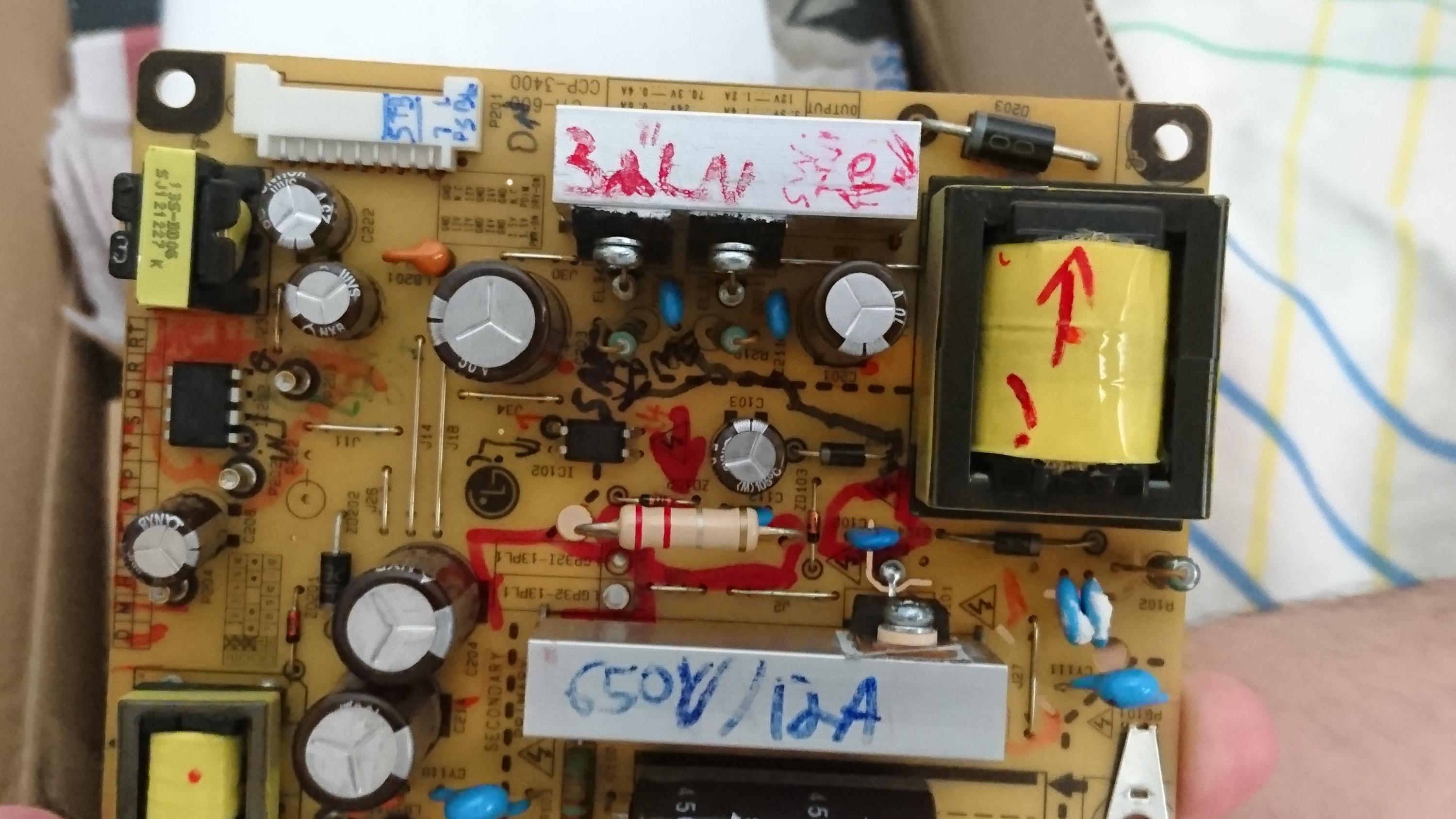

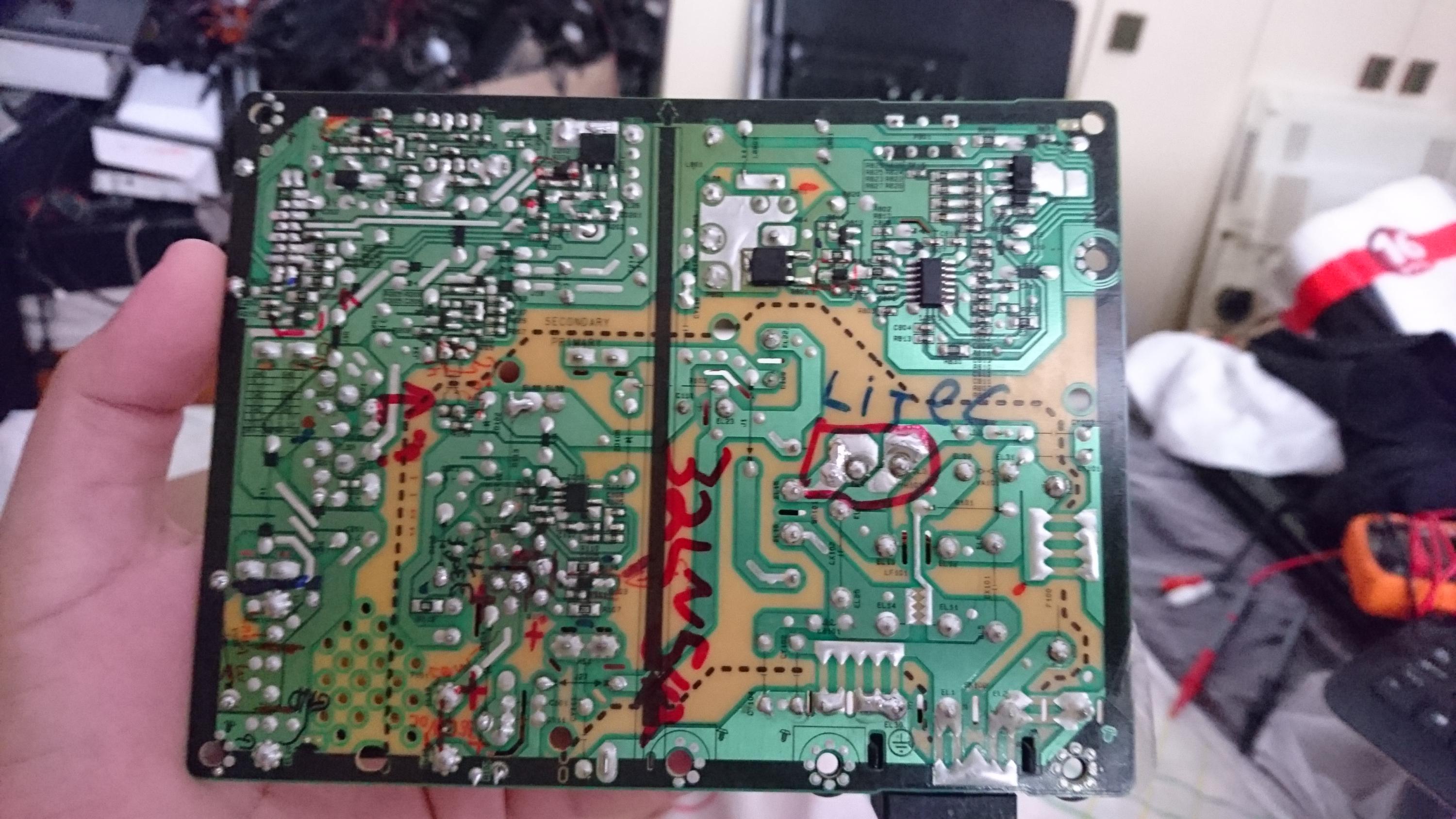

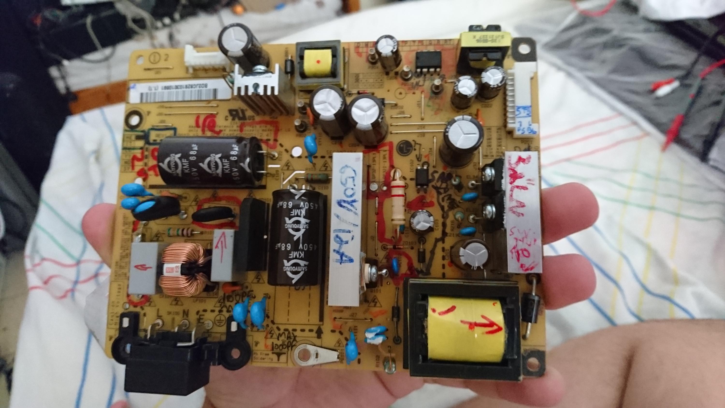

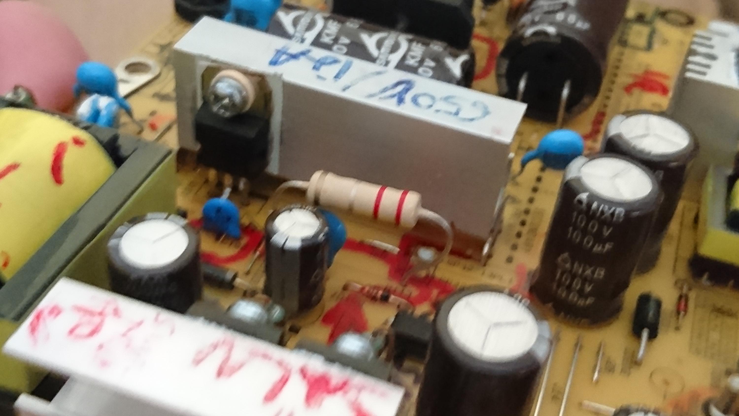

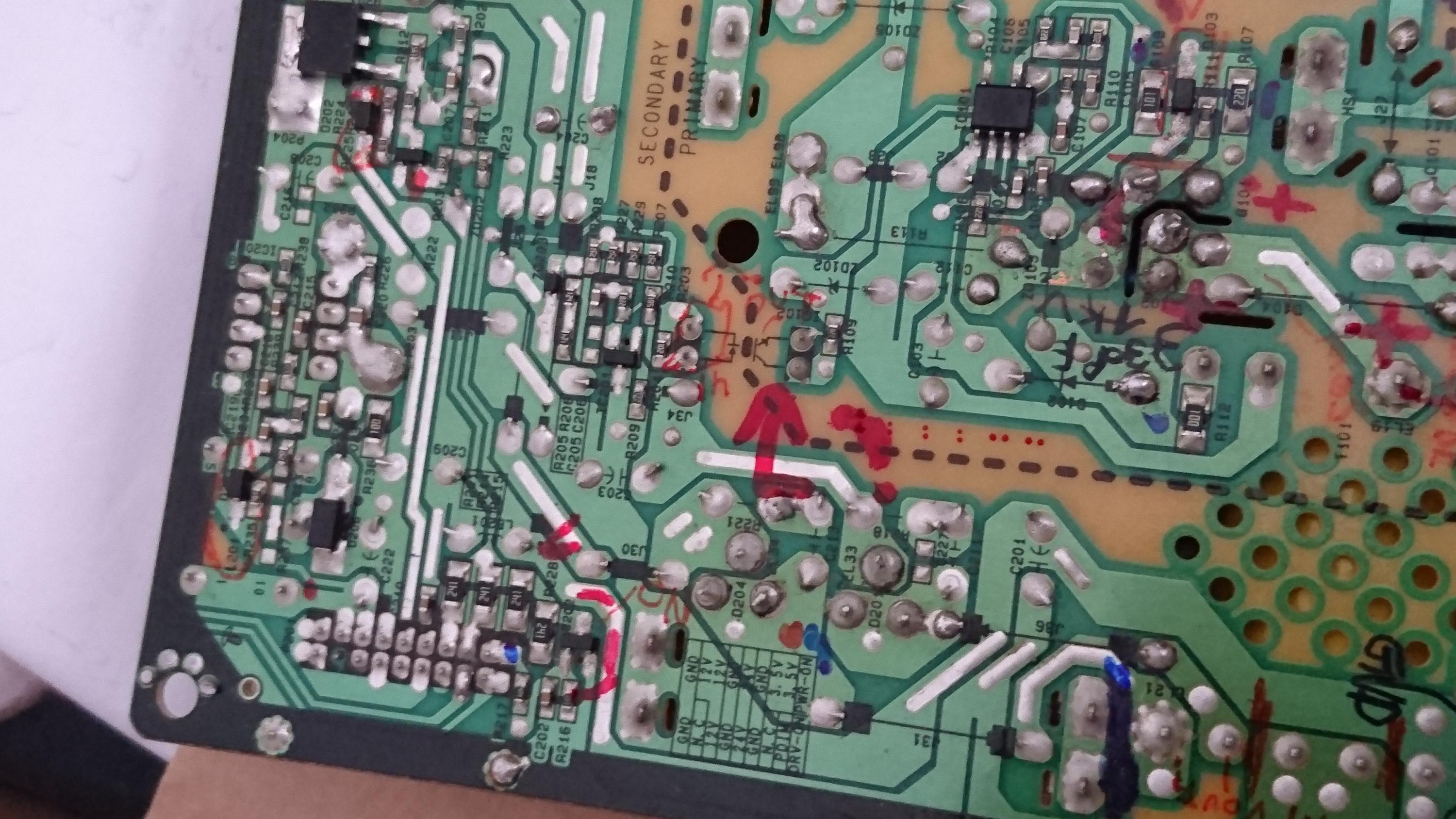

                              Do you have the screen label numbers eg Qxxxx, Cxxxx, Rxxxx and what was the original mosfet part number (printed on it) and what did you replace it with part number?
                              A picture is worth a thousand words so photo's of your boards would be helpful.
                              • litec systems
                                Electronics is
                                • Feb 2018
                                • 97
                                Re: Diagnosing EAX64905001

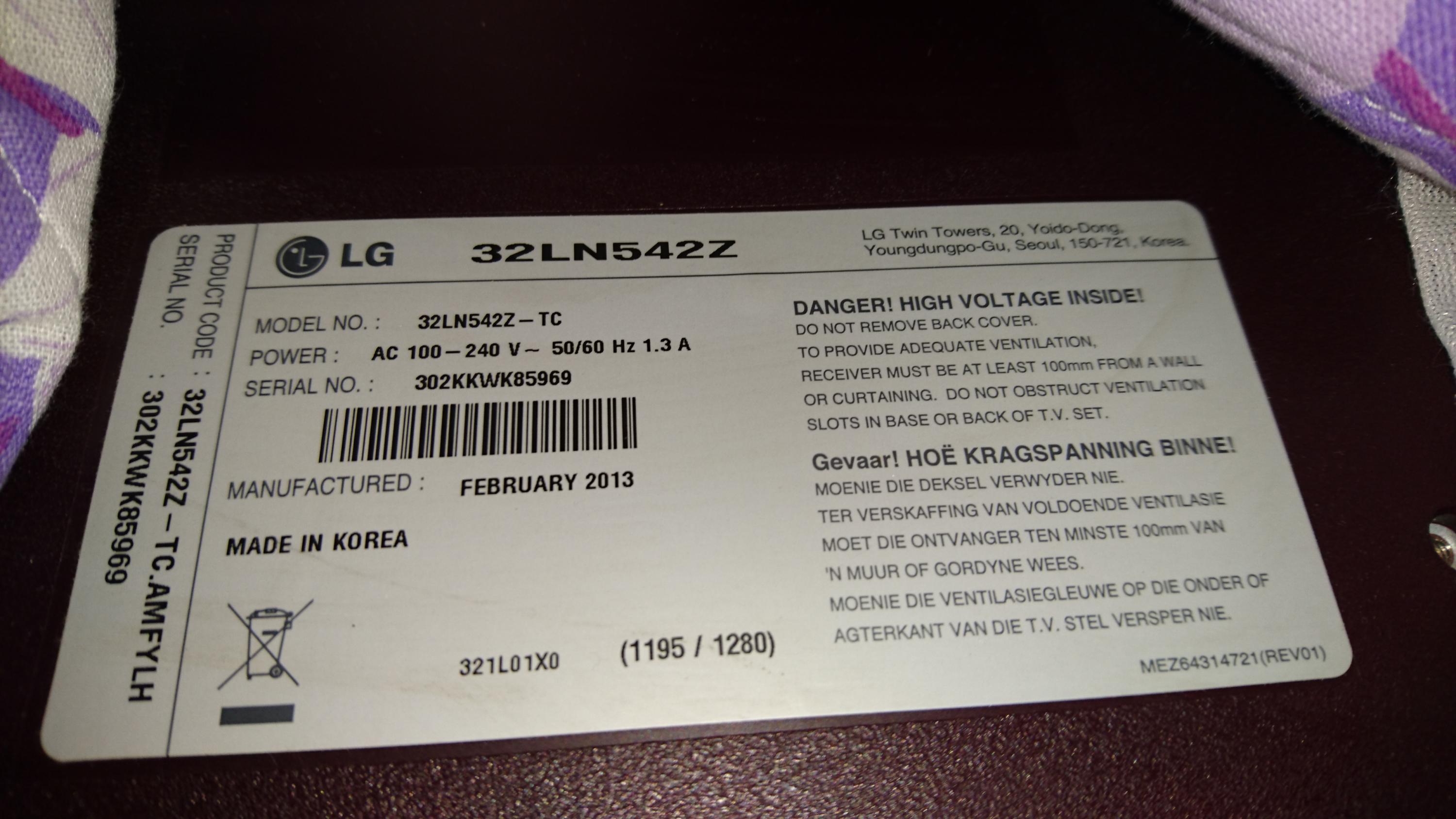

                                Hi
                                Thanks so much for your reply! 🙏🙏😃
                                By "Screen label" you meant to the sticker on the chasis? If so I've attached a picture of it. ( it's says 32ln542z because it's a local model number) but it looks the same as the international \ USA models ( the difference is probably the 1080p vs 720p but according to the videos on YouTube, they're all build from the same boards, just different panels + firmwares)
                                About the Mosfets
                                The original one was MDF11N65B
                                And I've replaced it with an st 15NM65N
                                g408t v6 *
                                chn 150 *
                                * ( the "0" might be "o" lol ST uses special font that I'm not always identify the characters 😂😂😂

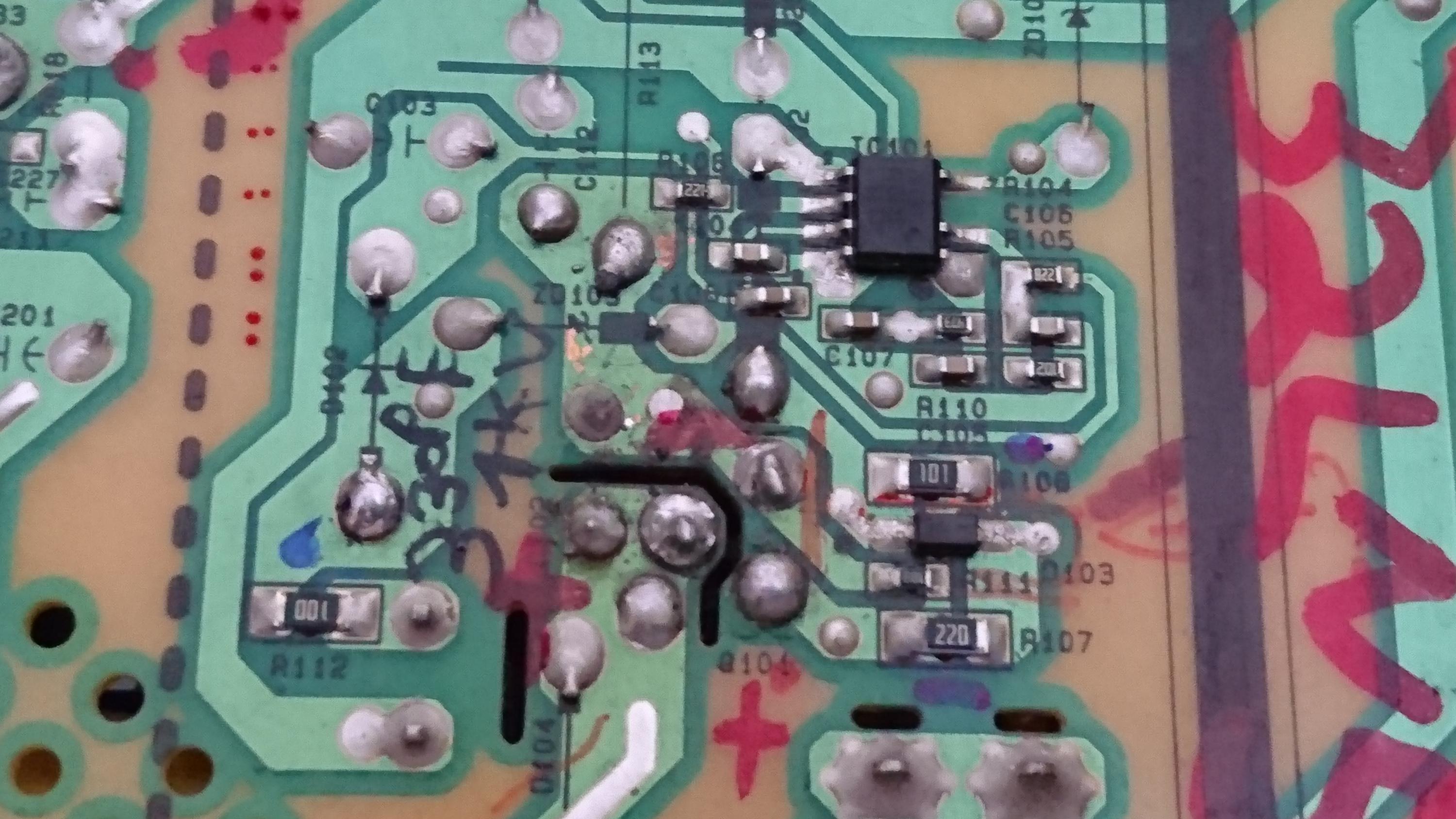

                                  Some of your solder joints look a little funky as well, maybe touch them up.
                                  • litec systems
                                    Electronics is
                                    • Feb 2018
                                    • 97
                                    Hi
                                    It's because It didn't worked ive tried on the solder joints and added more solder to it that's why It looks like that...
