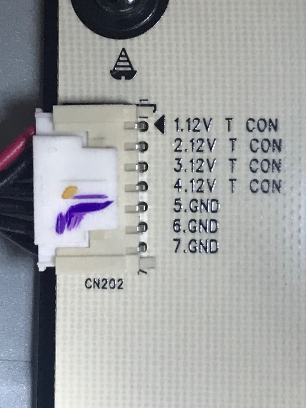

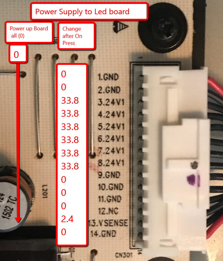

    No Back Light, No Sound, No Video The board and red light on the CPU audio out tries to power about a minute. Not sure if it the power supply is the problem. Attached photos of voltages at Power Supply board when powered up and then turned on.
    Any Suggestions Welcome.

      I wasn't sure about the voltages that i was reading -- some looked higher that the board indicated?

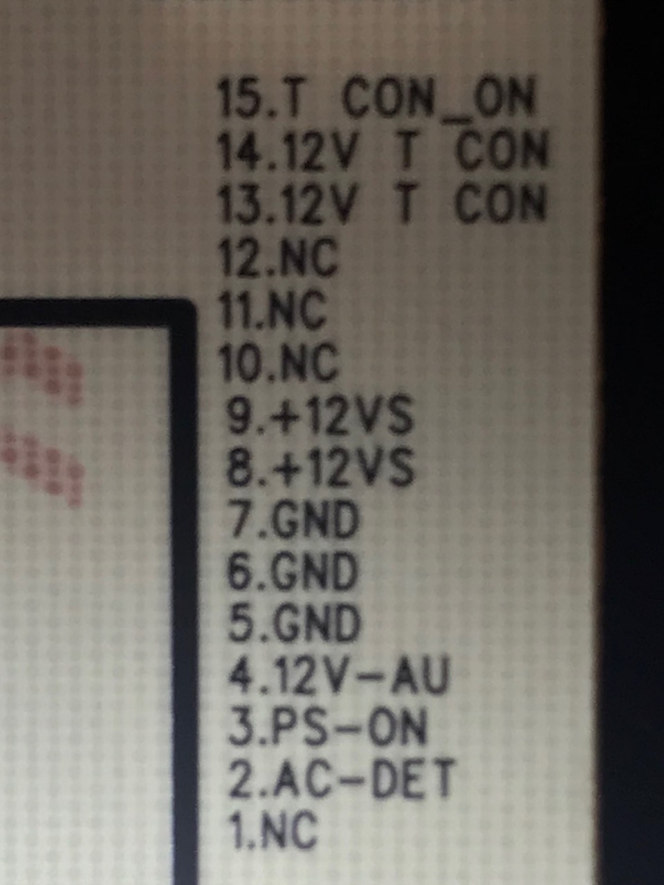

        you need to measure and record every pin shown in first picture.... with tv off and then tv on... note some change quickly after pressing on so you have to monitor each one during each press on.

                Some of the values that you read indicate "33.8" -- is that in VOLTS or MILLIVOLTS?

                  You need to check all the pins as print on the board of the first picture and watched closely during power up. You are saying you never see the tcon on signal?
                  unplug the power cable to the tcon... attempt a power up and check the pins for the 12v.

                    No dc voltage to tcon pin 13 tcon, 14 tcon or 15 Tcon ON when unpluged and applying power to power supply board.

                        I am not getting 12V to any of the T Con pins. I'm not sure if it's the Power supply or Main Board. Does the Power Supply receive a signal back to the Main board to power up T Con???

                          You will not have any 12V T CON (pins13,4) untill it is turned on by (pin15) T CON_ON
                          You have +12v on pins 8&9 so the power supply is working.
                          Does pin3, PS-ON change when the power button is pressed? if it does not, then the main board is likely the problem.

                            I do get 5.1v at PS on when the power button is pressed and red led on main board comes on for a while then flashes about 16 times and shuts down

                              So in standby, PS-ON is 0 volts and when you press the power button, PS-ON goes to 5v correct?

                                yes correct

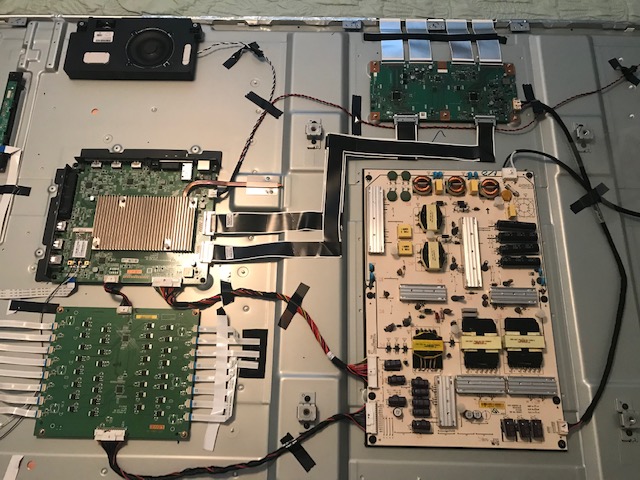

                                  So the main board is partly working, it understands the the command from the power button and outputs the PS-ON signal correctly, but it's not outputing the T-CON_ON signal, This could be a bga fault on the main as suggested. It could be that the t-con is not turned on until the backlights are turned on.
                                  So the power supply is working corrctly. I would suspect the main board, you can try heating the large ic under the heatsink and see if the tv comes on. the heating can sometimes temporarly restore the connection.

                                        This heating is on a the large BGA ic, if it works, it just rules out the rest of the tv, but usually is only temporary, to do a proper job the ic needs to be removed, reballed and replaced.
