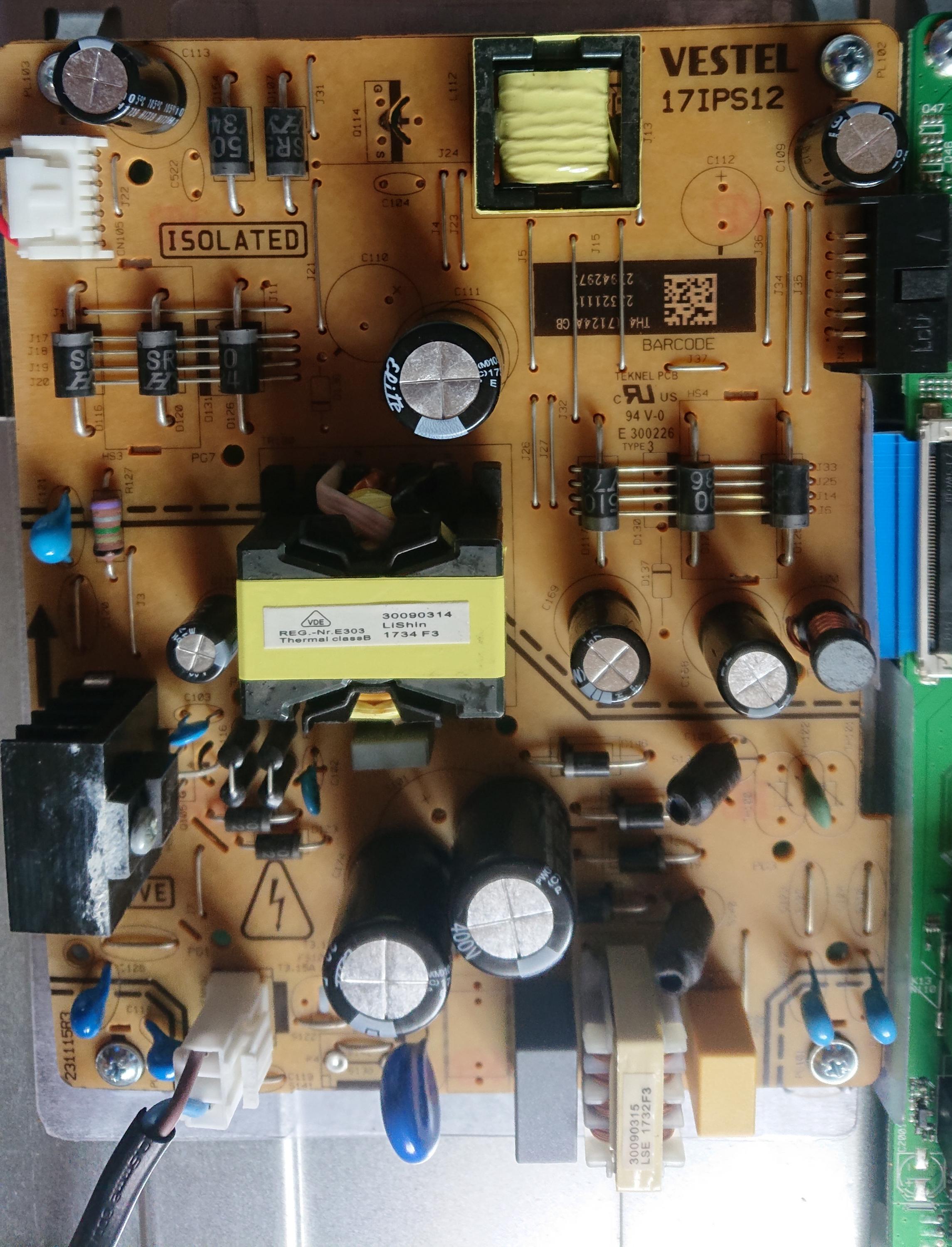

    I have changed the power supply board with a known working part and the issue remains the same.

    Pictures of your boards and power supply voltage reading would be a good place to start. What is the power supply board number. You may eg have bad leds so voltage readings will help to diagnose the problem.

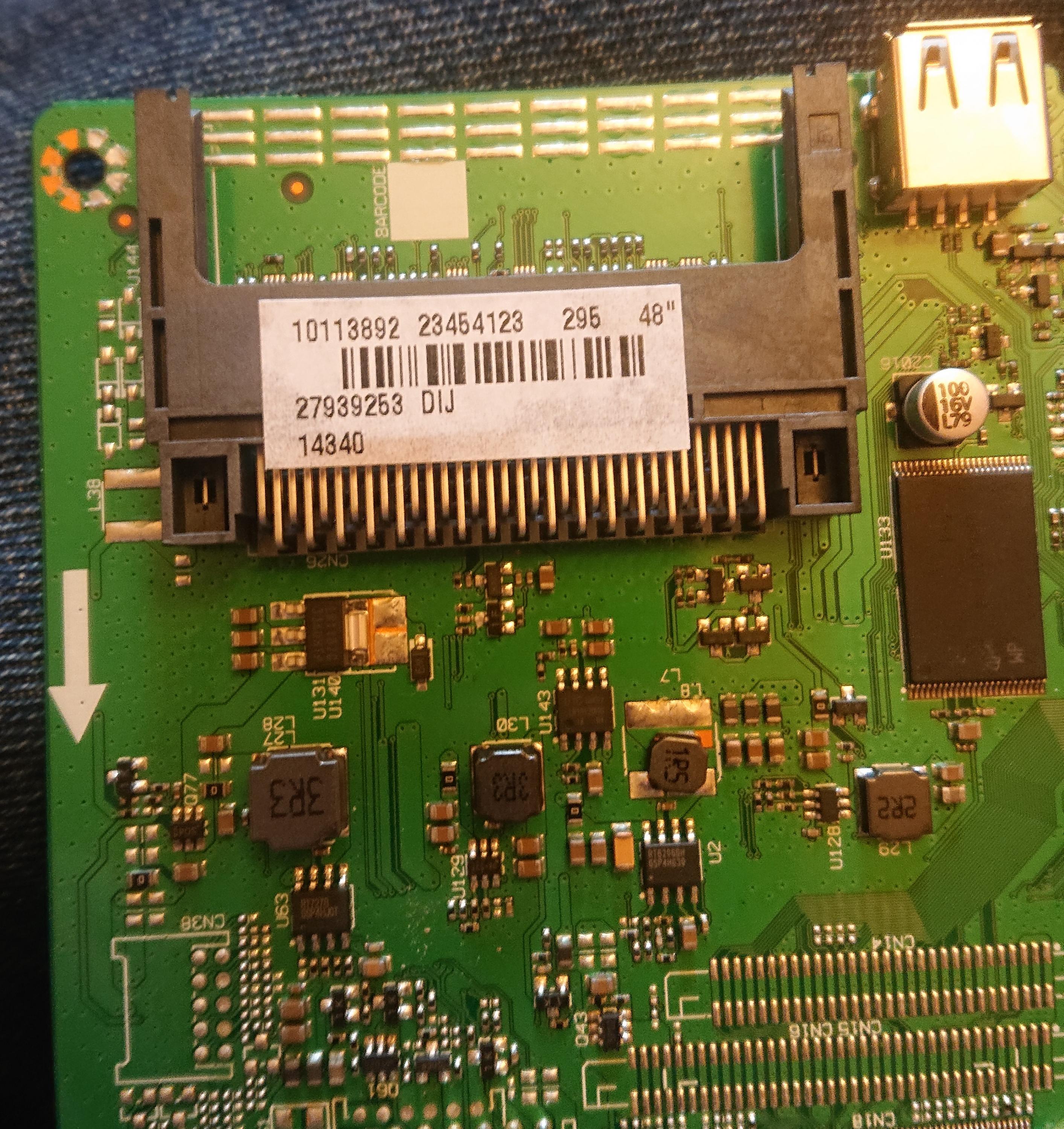

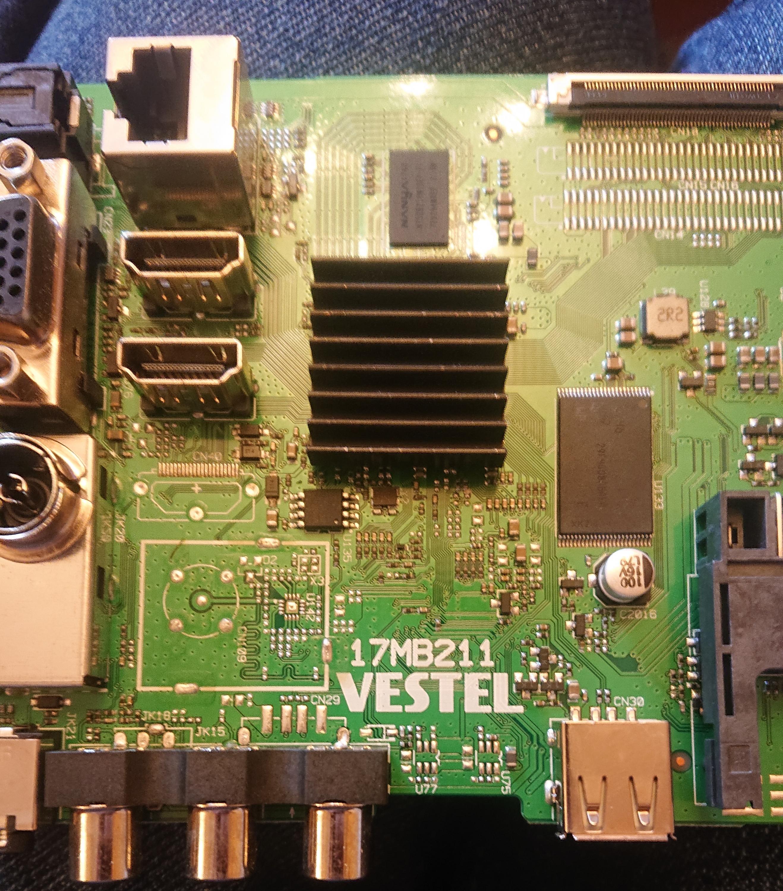

      I have attached photos of the system board, panel sticker and the PSU.
      I don't have PSU voltage readings to hand, but I can confirm that the PSU currently fitted works 100% as it was removed from a fully working TV to test with.

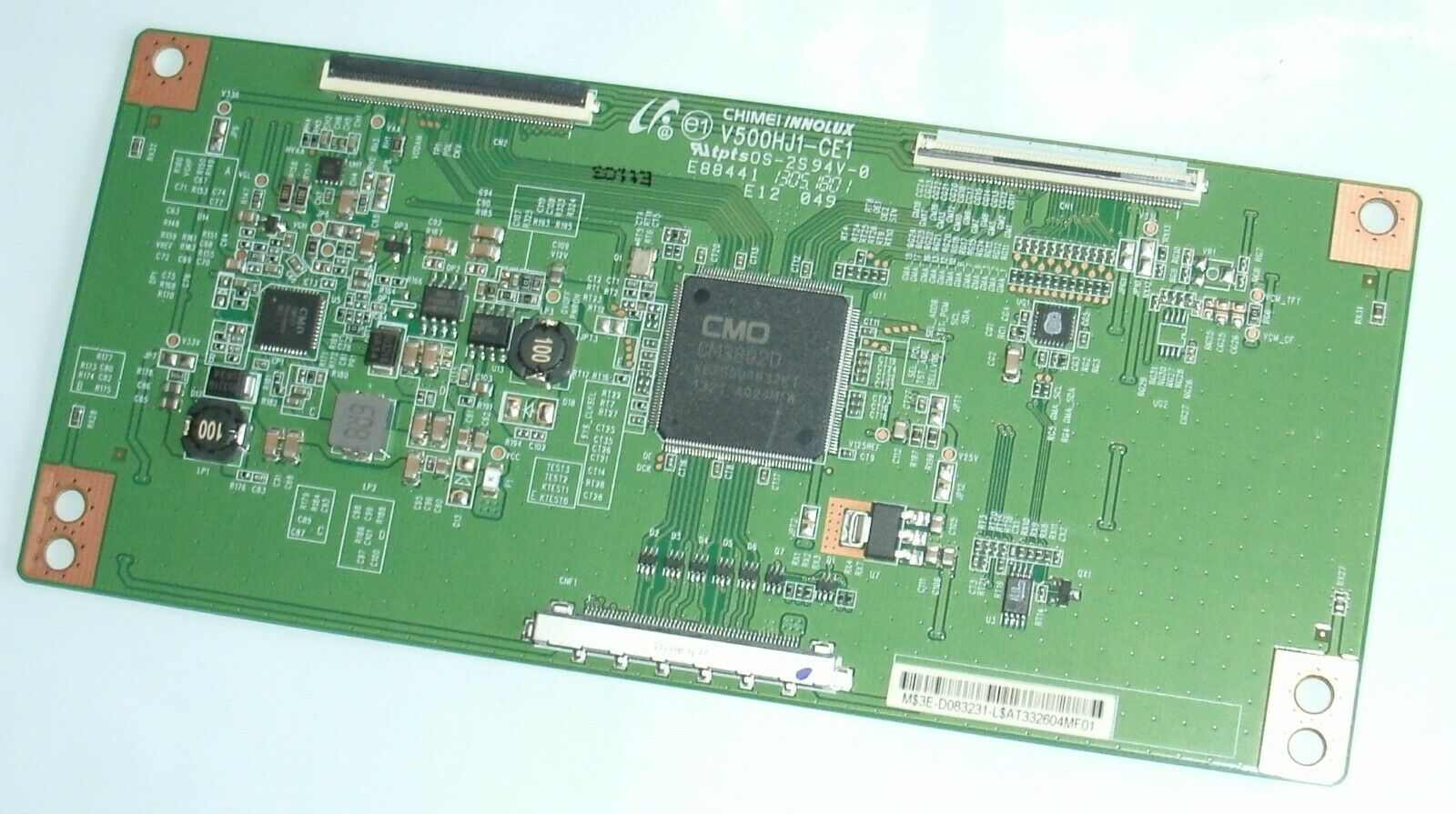

            Check the solder joints on CN11 for cracked or loose joints
            What voltage do you have on the fuse on the Tcon board?

                If you post pictures of your Tcon that would help. It looks something like attached

                    I can't see a board that looks like the one you showed me.
                    There are five PCBs in the TV:

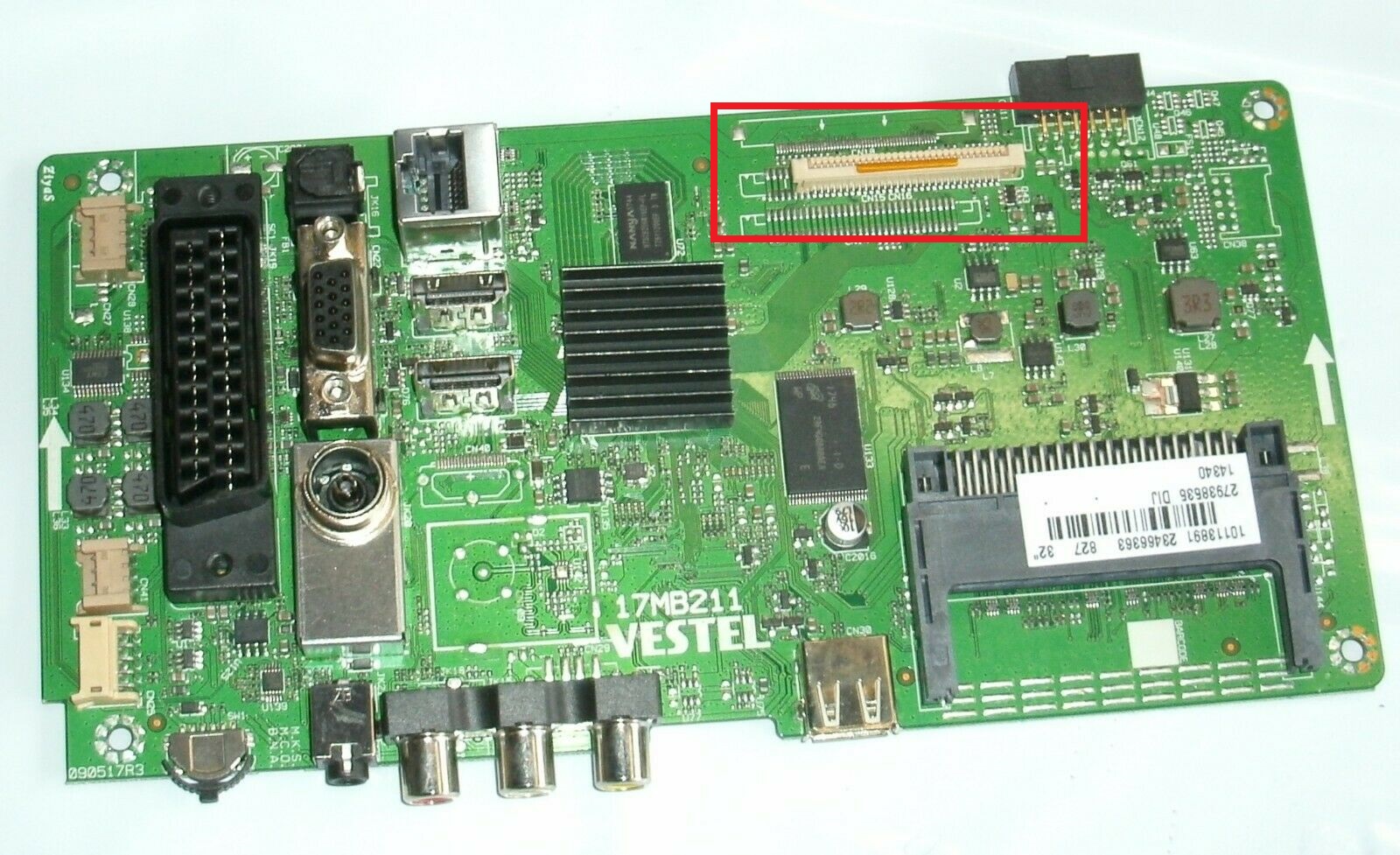

                      Is this similar to you mainboard and if it is where does the flat ribbon cable go?
                      A photo of the back of the set showing the boards interconnected would be helpfull.
