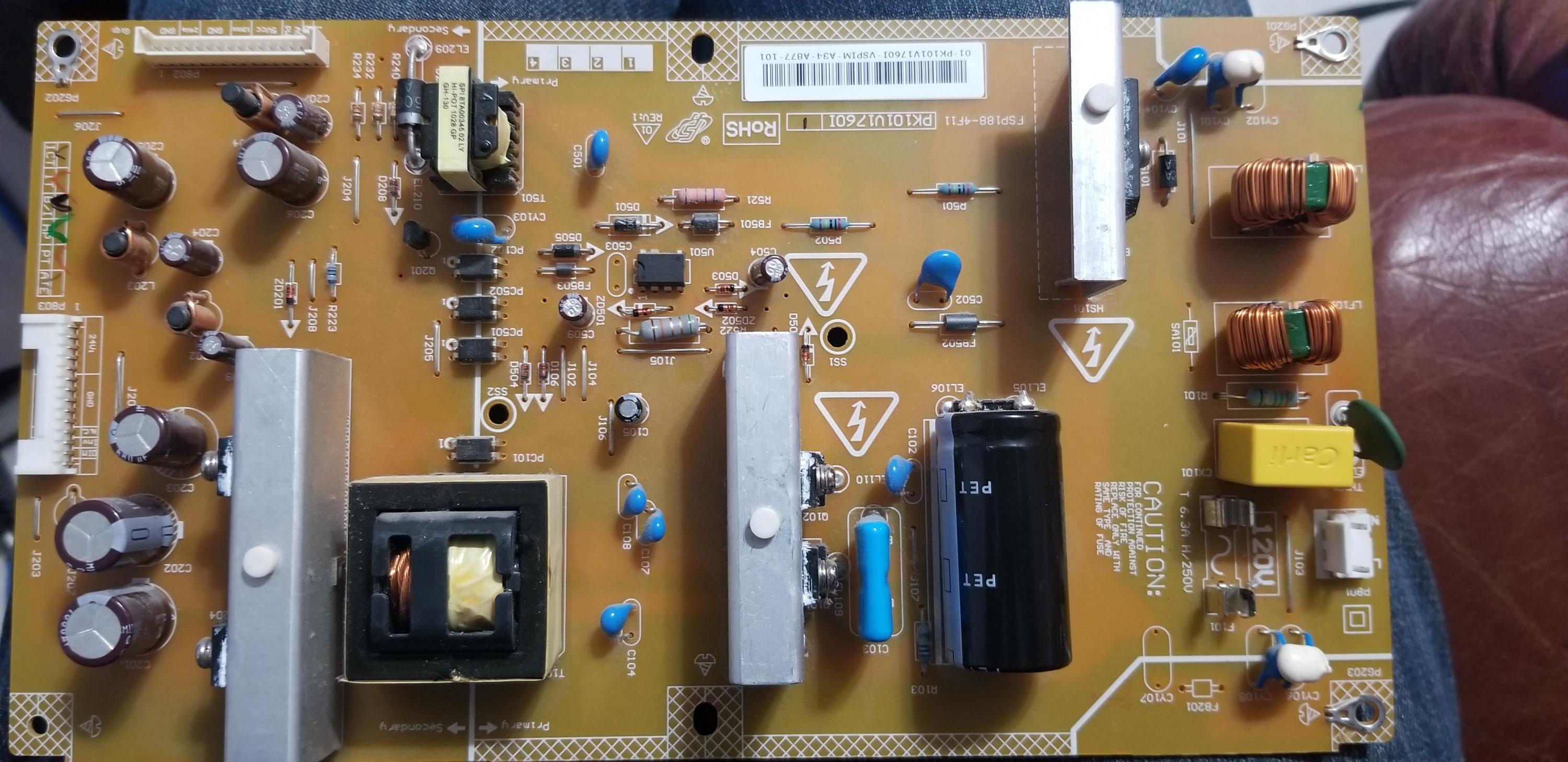

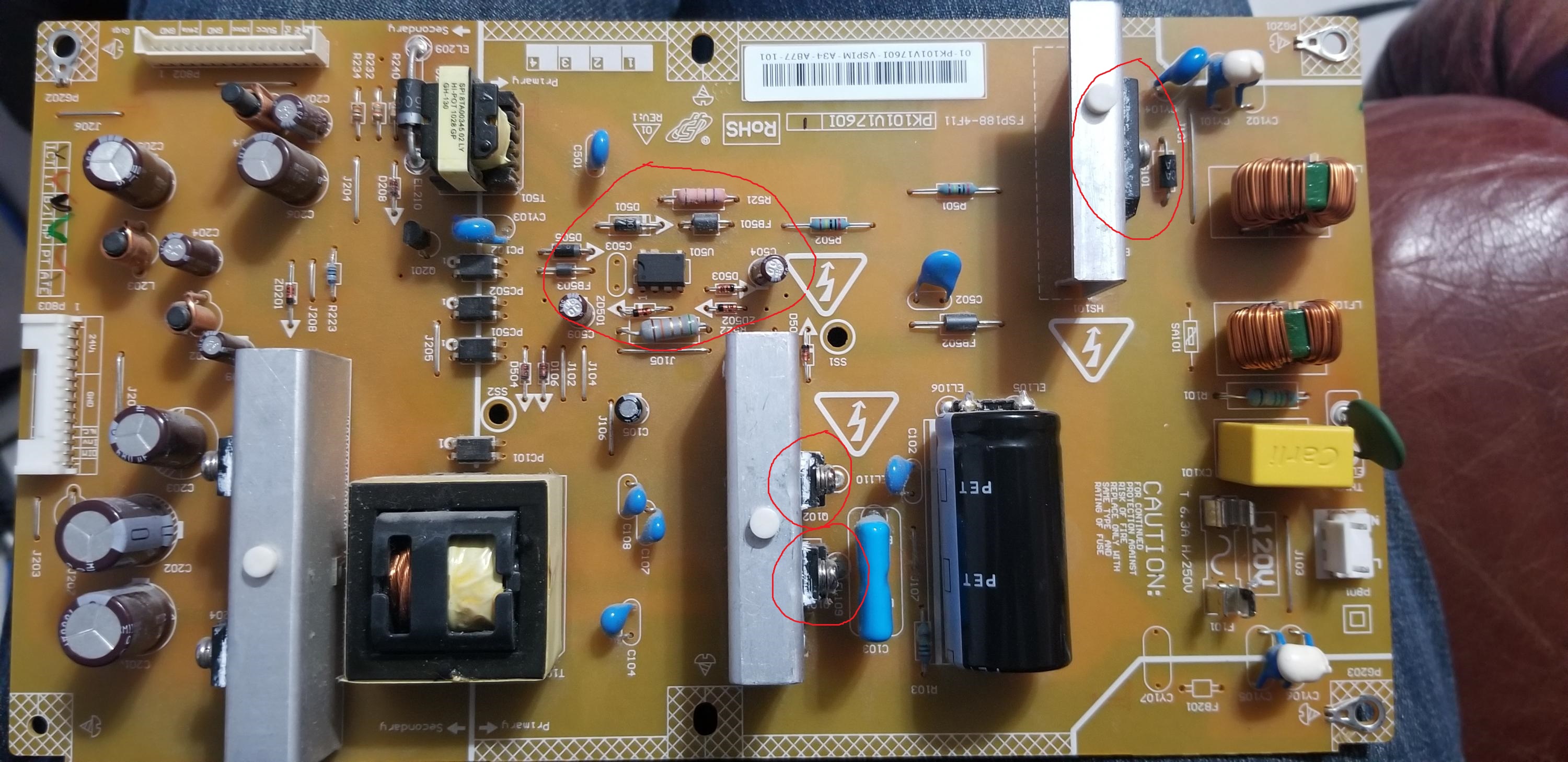

    I have a Toshiba 40 FT1 U. It was hit with a power surge. And the fuse blew. When I install a new fuse and plug it in and it blows instantly. I can't find any shorts on the mosfet or Bridge rectifier Maybe someone can take a look at the power board And has an idea where to test for shorts.

    Do you have any shorts on the cold side?
    Did you have the main board plugged in at all?

      I have the other boards disconnected. Still blows up fuse instantly. So the short has to be on the coldside I'm not sure where to start testing and what the values or for things. The green disc beside the power connector Is that supposed to show closed Or have some resistance. ?

        Likely is a NTC thermistor. Should have a resistance. What’s the markings on it?
        For the cold side: there are two heat sinked three pinned parts (D201, D202). Any shorts across the combination of two pins for each part? Any shorted to ground? What’s the marking on them?

          1) What is the resistance of the main filter cap C101?
          2) What is the resistance between the ~ of the bridge rectifier?
          3) What is the resistance of VS101?

            Vs101 is 0 the rest ill check tomorrow

              For starters you should check what is circled with red.
              Since the source does not have a PFC, you can put a 220v / 100w bulb in the place of fuse. Try it without mainboard, backlight etc. If the light bulb is bright it is not ok.

                Did you use the same type fuse? That is T 6.3A H/250V.

                  But you indicate that he Bridge rectifier tested OK are you sure? If you check between ~ of the bridge rectifier you would have seen it shows as shorted since the VS101 is connected in parallel with the ~ pins of the rectifier.
                  More likely that the VS101 is shorted out, common failure for this power supply when power surge occurs, so lift one leg of VS101 off the board and check the resistance between ~ pins of the bridge to see if it shows 0 Ohm or not.

                    No short on the rectifier after I lift one leg. Vs101. J105 resistor show short or is it just very low resistance?

                      If I connect a light bulb across the fuse. Can I test the TV with vs. 101 removed? Or does that littelfuse need to be there? I can't find anything matching on the boards I have here.

                        The bulb should be mounted as protection, to protect the components. But for a short time. If it lights up, turn off the power immediately. It is used without the psu having a load. Start with the stb part. Switch off the power supply and see if you have STB voltage. The bulb should not light or just very briefly until the filter capacitor is charged.

                          I found. A match for vs 101 I installed it. Put in a new fuse and the TV's working fine. Thanks for your guys's help. Much appreciated
