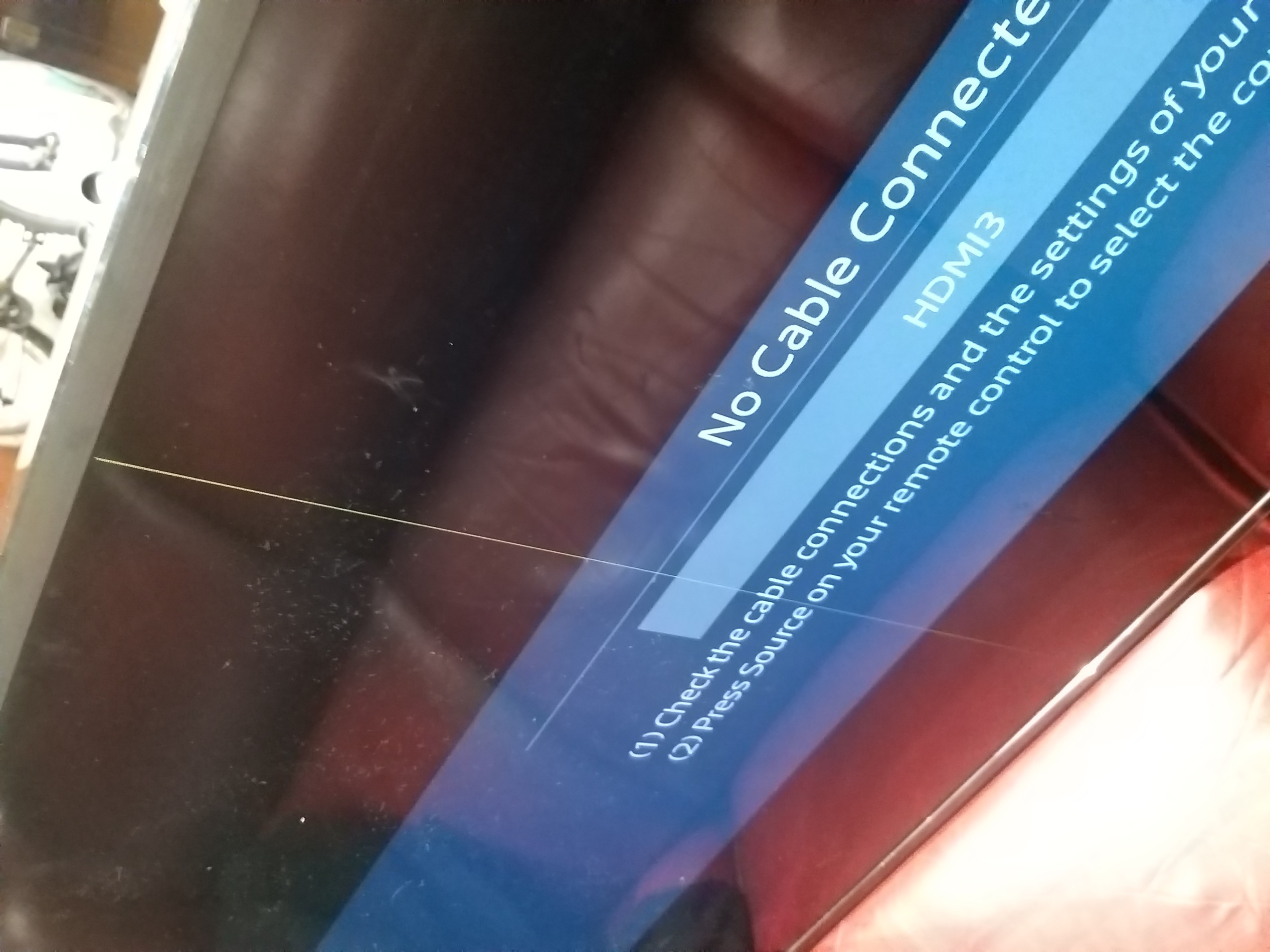

    Hi guys,
    hope everyone is coping with this crisis.
    Has anyone ever seen this particular issue shown n the photo.?
    Very thin vertical yellow line just off centre of the screen.
    I have disconnected both lvds cables and cleaned and reseated,,no change.
    What could cause this. Could the panel be cracked internally?
    ps. is there an issue with iploading photos.? Cannot seem to.

          Re: SAMSUNG UE40JU6000K thin vertical line.
          Ok
          the pic was too big.
          Although it was jpg and only 4.40mb
          Anyway I have managed to upload.
          Can someone tell me if this is actually a damaged screen or is fixable.?
            The line stops approx 2 inches from the bottom of the screen.thnx
              Possible tab bond issue or a bad cap in the lower drive boards attached to the panel. You'll have to remove the back and the driver board covers on the bottom and inspect the ribbon cables for corrosion. You'll need a multi meter to check the caps but some will be in parallel so you'll need to remove them one by one to find a short. These are small caps so you will need a good degree of soldering experience.
                Did you try cleaning the ribbon cables going from tcon to panel? Some use a pencil eraser, gently they can be delicate, might be a loose tab bond as mentioned.
                  Some have had success with the "cutoff tape" method with vertical lines.
