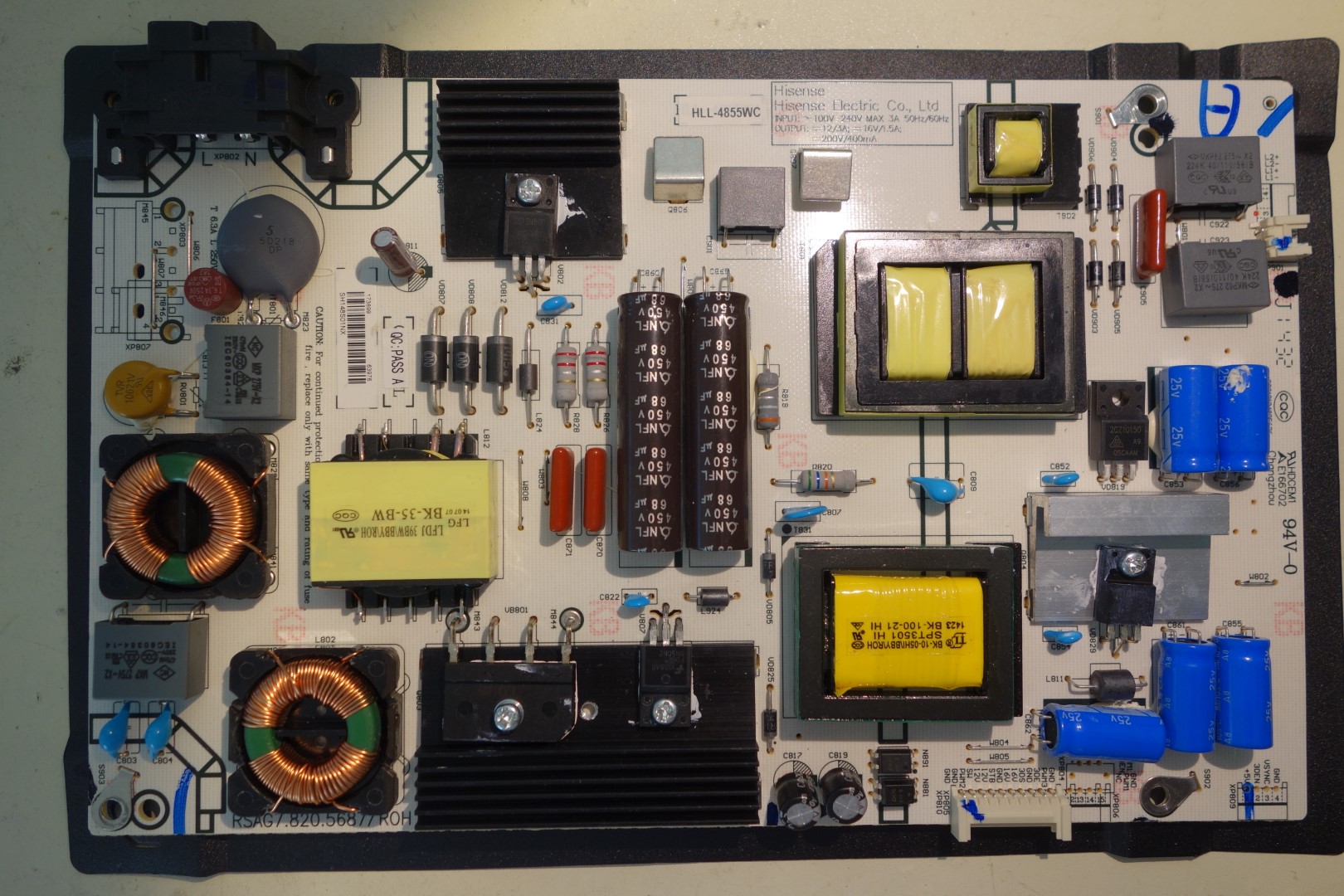

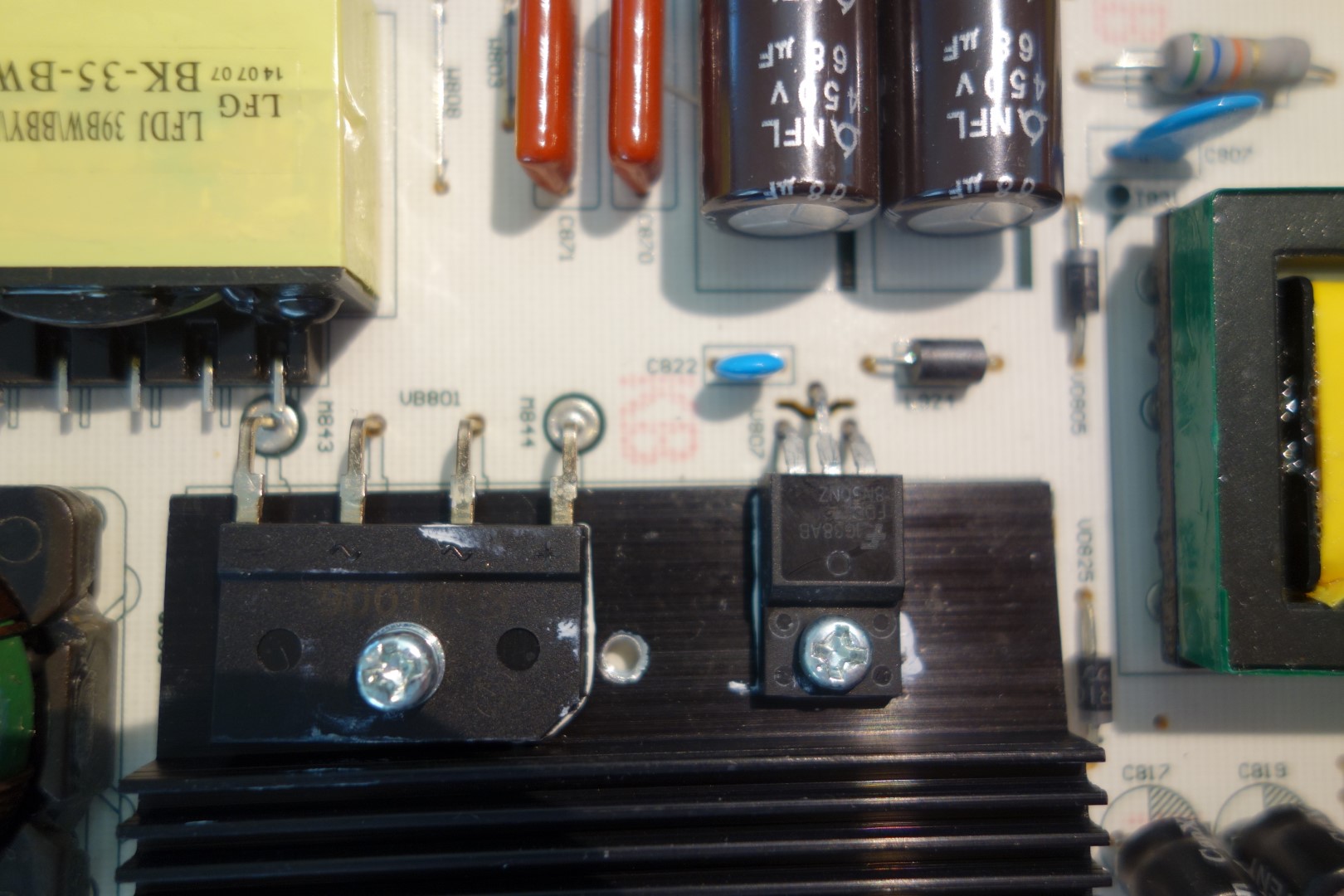

    This model suffers from bad backlights but my power supply is dead and no standby light and no standby voltage. Main fuse was good but found U807 (NCH, 650V, 8A) shorted and replaced it (subbed with 450V). Didn't fix it. Checked C822 and measures 100pF. Main filter cap is around 290V and drifting a few volts. Suspecting PFC IC may have been damaged. Only one set of wires to strips (10 rows of 6 LEDs) and reading about 60V on LED tester so not sure if there are bad LEDs as well. May or may not be related.
    Power supply is HLL-4855WC (186132 according to Shopjimmy)

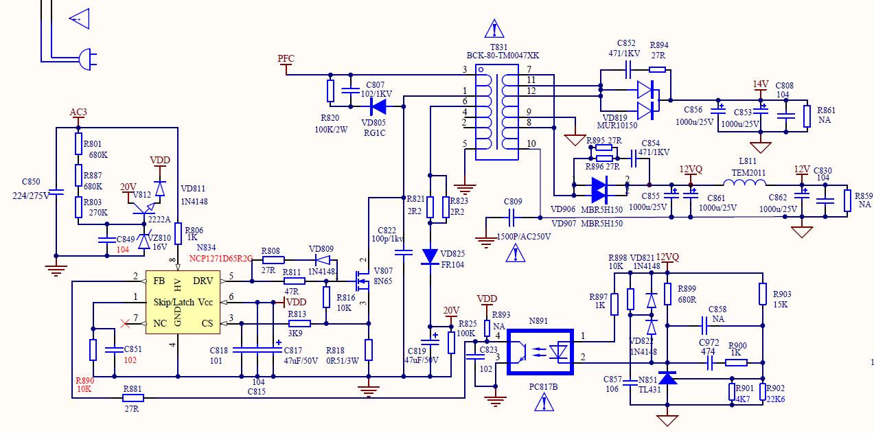

    If U807 was shorted, Is R818 still ok? The circuit does seem to be working as the pfc circuit is sort of working.
    I would then check the voltage on C819 (20v), C817 (16v) and C811 (16v) C819 47µf/50v would be my first suspect.
    If one or all of those caps are bad, the vcc for the ic's will not be stable.
    You might also want to check VD807, VD808 & VD812.

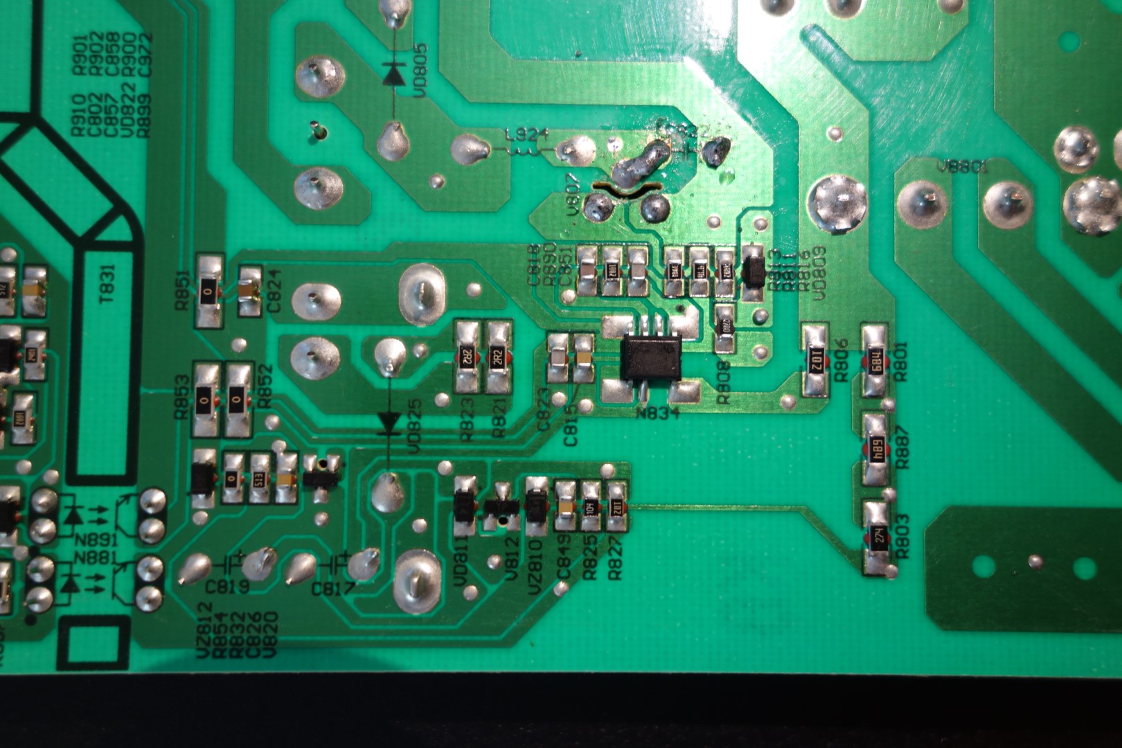

                I got a similar power supply HLL-4255WJ for Sharp LC-40N5000U and it had a shorted U807 FET and visible damage on R818 (blown). I replaced both and plugged it in and one leg of C822 blew as well as N834. Replaced those two and now power supply is working but searching N834 found this thread and dug up this old board in my junk pile.
                Comparing boards, I found R808, R811 and R813 damaged on this board so replaced these 3 as well as N834 and still no standby. Found the schematic posted by RJ in another thread searching N834 so can see if I can track it down further. PFC voltage is a stable 155V.

                  I compared my working board with the Insignia and the standby voltage is low
                  PFC = 159V (same for both)
                  20V (C819) 6.5V on the Insignia, 18.5V for the Sharp
                  VDD (C817) 8-10V unstable, 15V for the Sharp
                  Since the 20V is coming directly from the transformer not sure what is causing the low voltage. Checked R820, VD805, R821, R823, VD825 and C807.
