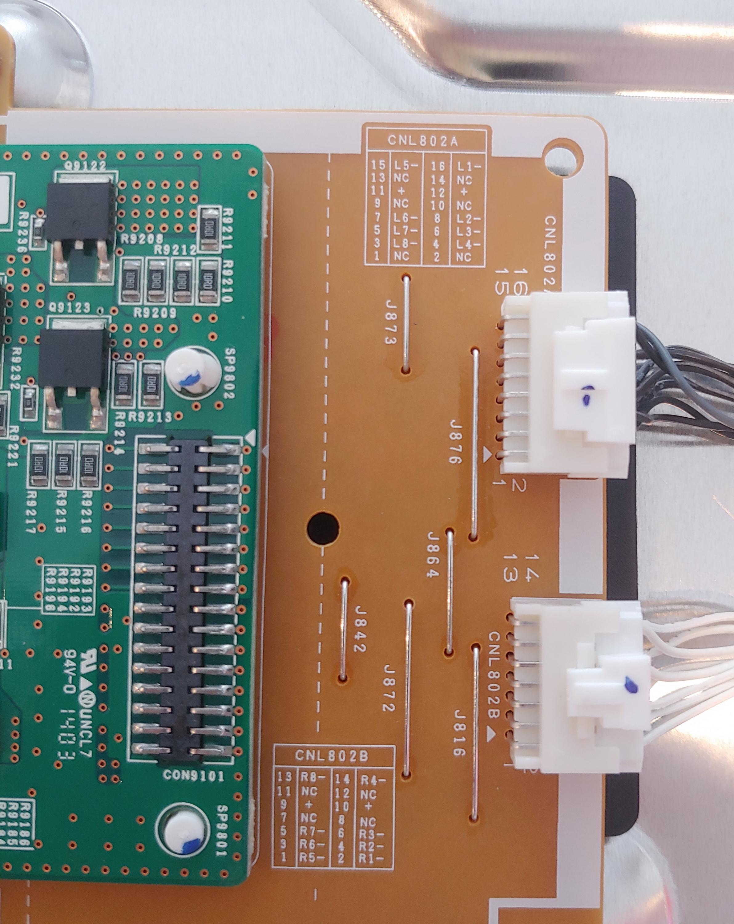

    TV show image with the help of a flashlight but no backlight. I can confirm that all led are OK.
    CNL802A
    TV OFF
    0v
    TV ON
    Pin 11 and 12: 16v
    All others: 0v
    CNL802B
    TV OFF
    0V
    TV ON
    Pin 9 and 10: 16v
    All others: 0v

        Re: Samsung UN55H8000AFXZA No Backlight, LED Strips OK
        Monitor the voltage between chassis ground and J816 when the tv is first turned on, What is the voltage?
          J816: 16.2v
            J876, J864: 16.2v
              That voltage is low, What is the voltage across one of the main filter caps, CP811S or CP812S ? If this voltage is about 385vdc then the pfc circuit is working ok.

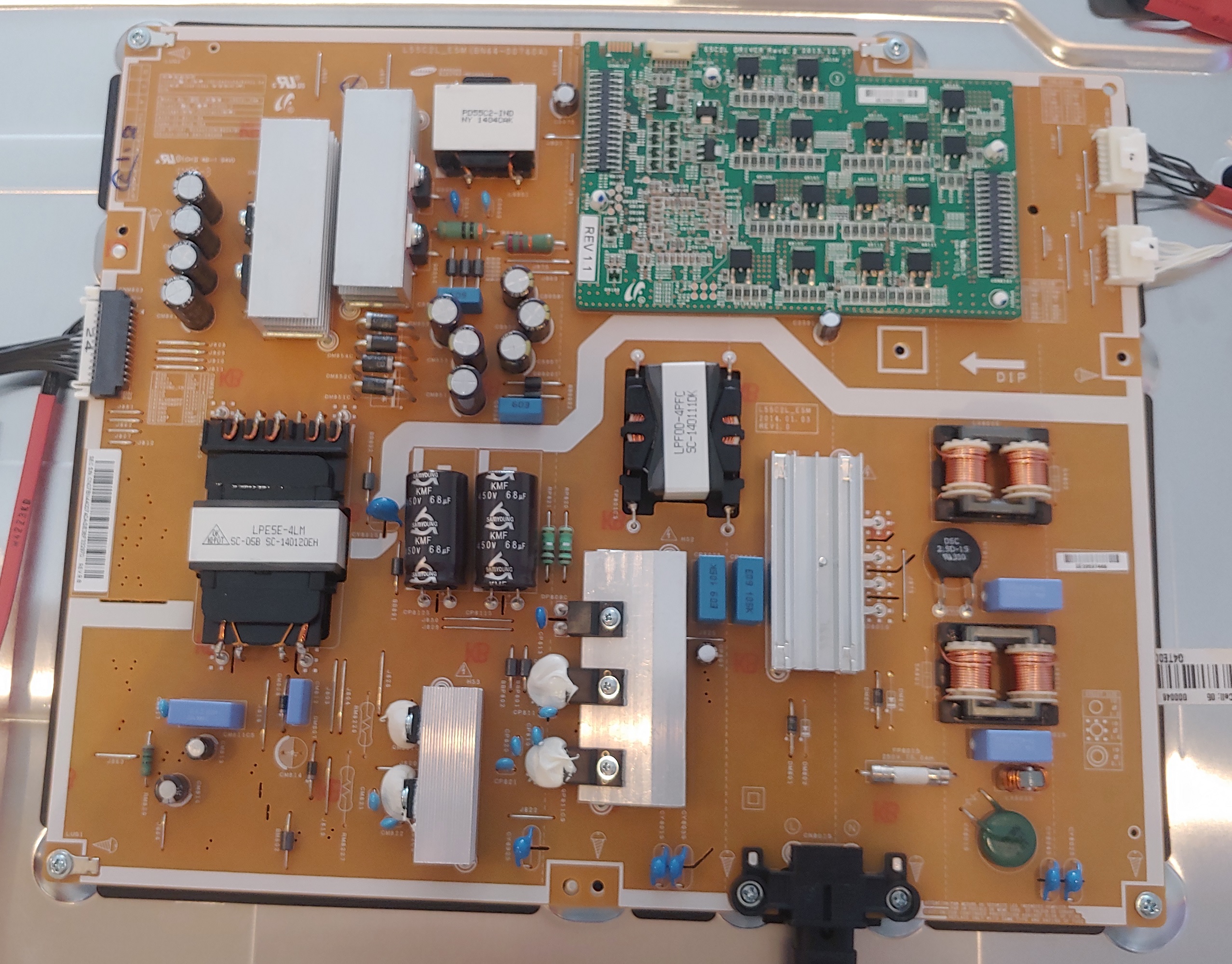

                  What is the power supply board P/N? BN44-?????

                      Bn44-00740a

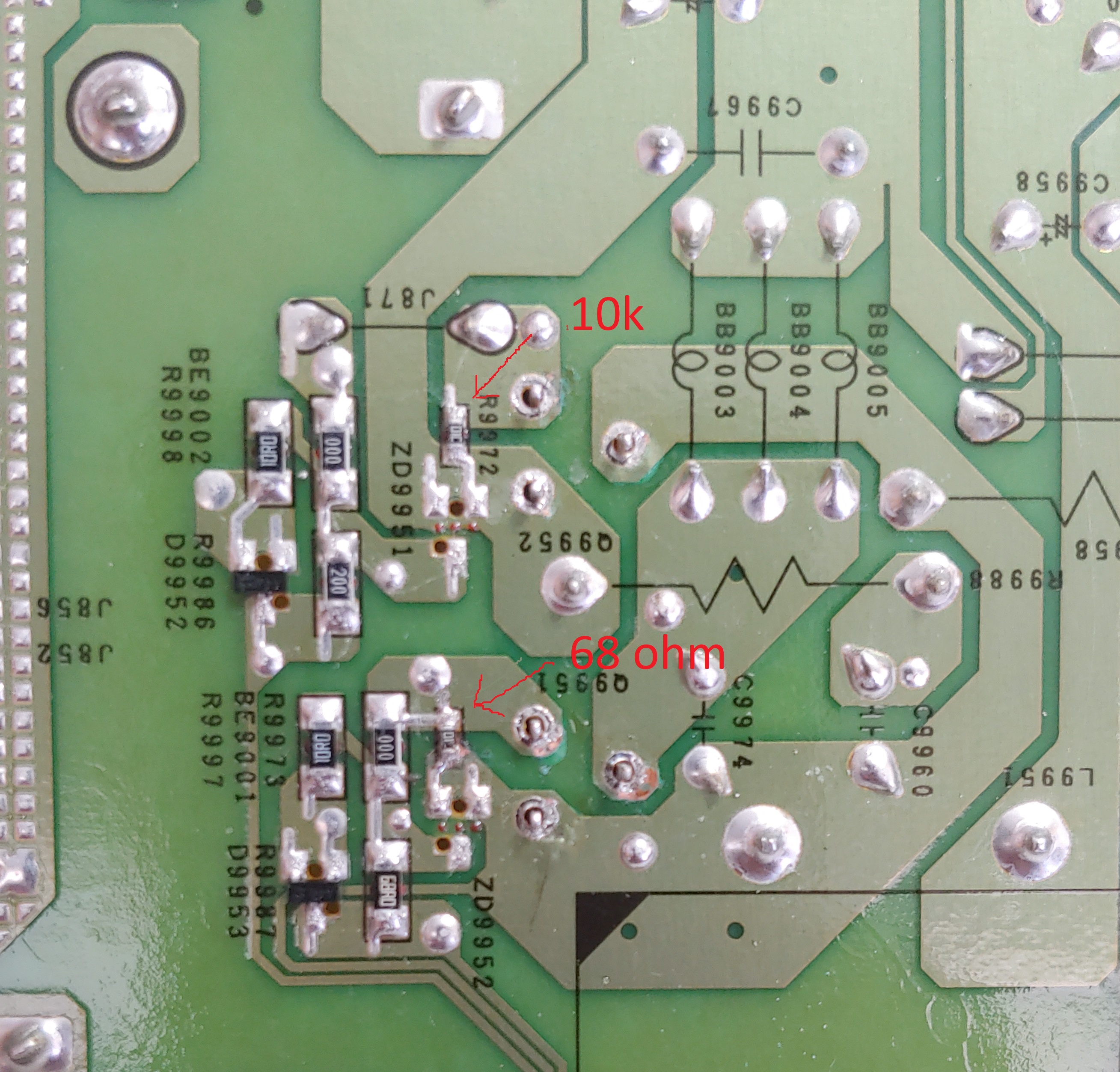

                                    Q9951 and Q9952 OK, R9988 and R9958 OK
                                    IC 9951: NCP1034DG
                                    10k R9972 and R9973 are OK when tested out but R9973 only read 68 ohm in the circuit. All components on the picture are OK
