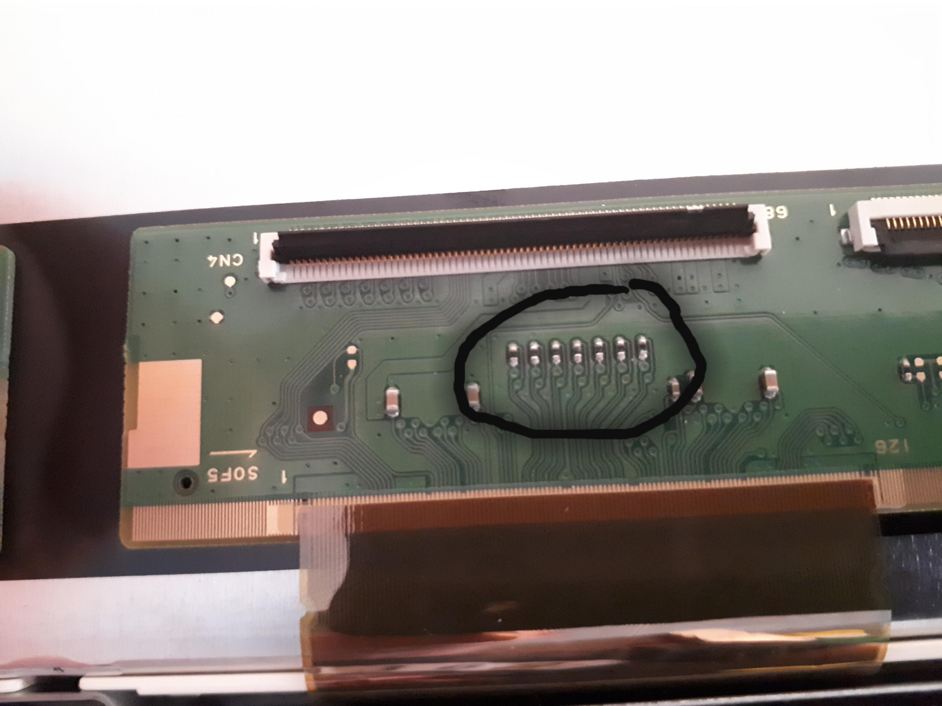

How to test tiny black resisters on lcd panel board
    Just wondering if i should be looking for continuity here is a pic of what im talking about

    Re: How to test tiny black resisters on lcd panel board
    these dont have any resistance.
      Ty but What could be the cause of this problem i have
        I tested all the caps non are shorted out although when i tested some caps in ohms some started reading in the negative then slowly went up to over 150 ohms is that bad.
            When i plug in a video source to the hdmi the picture is gean red and laggy like overlapping. I ordered a tcon board put in in with no change.
              We need to see what the image looks like on the screen, your description does not mean much.
              We do not even know the make and model of the TV.
              We also need the pictures of the whole backside of the the TV showing all the boards.
              It is hard to help since we do not have the TV right in front of us to look at.
