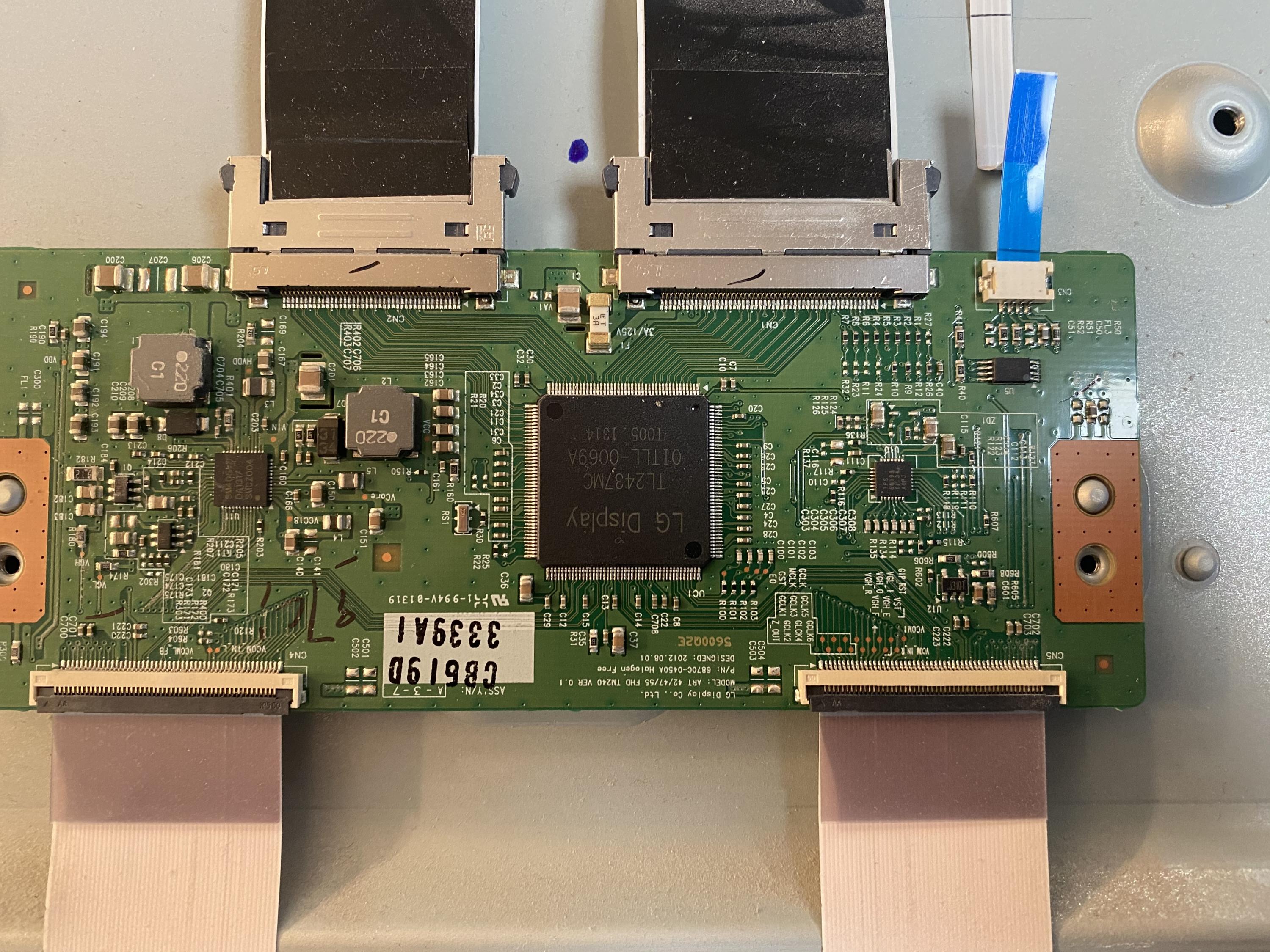

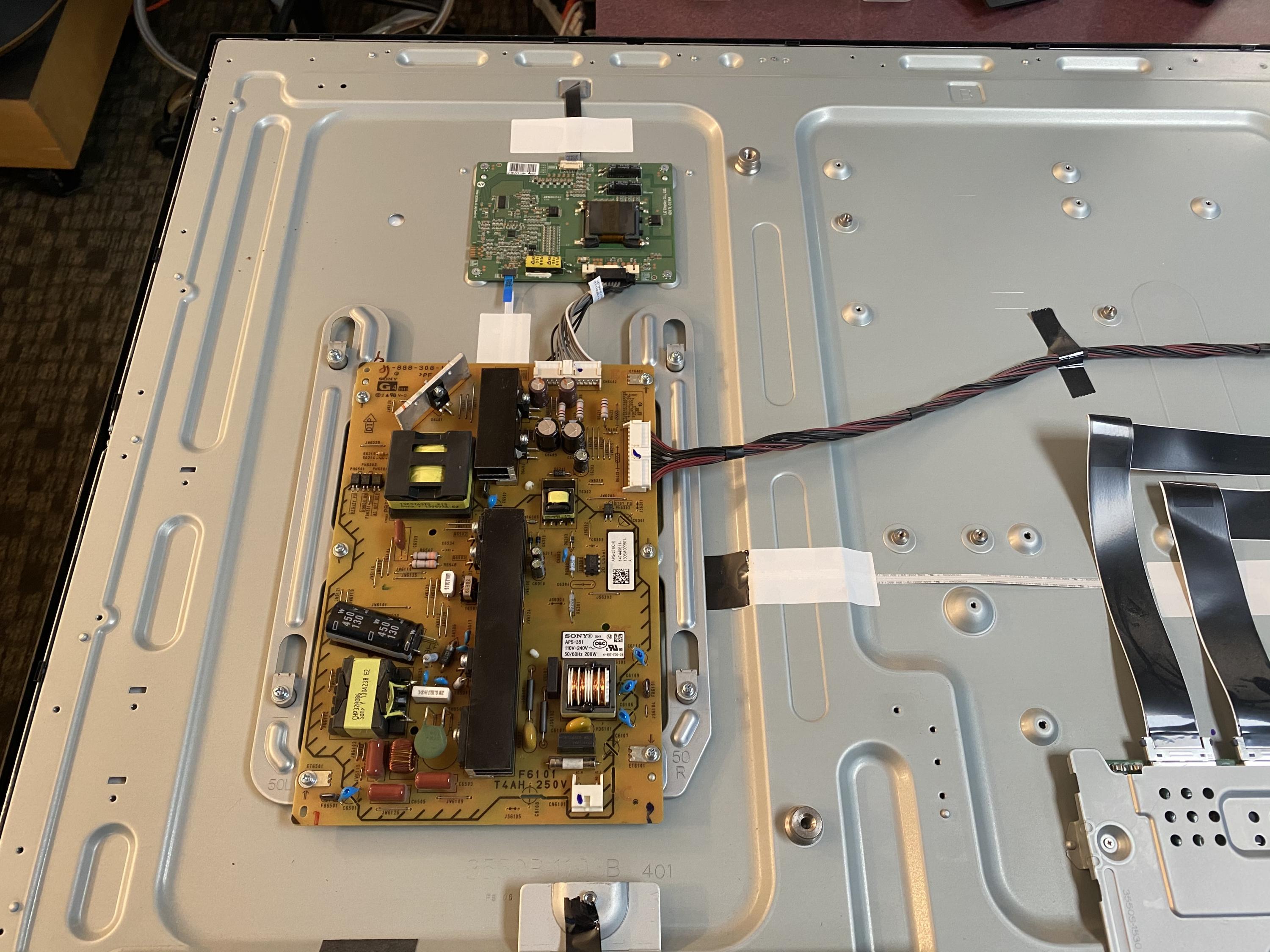

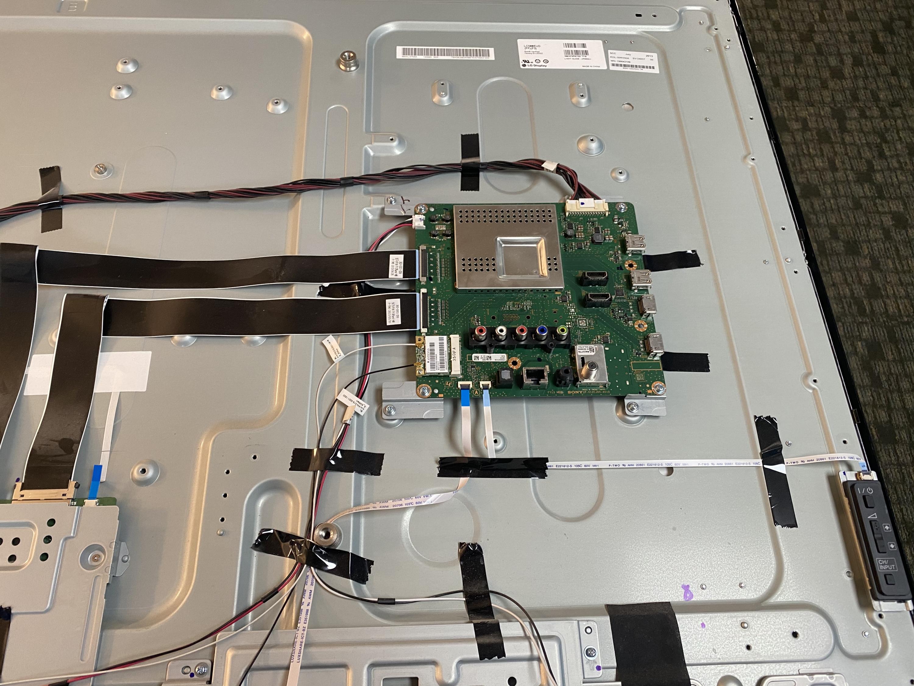

    When Tv is first plugged in and power button is pressed it will turn on. After a second or two the tv will then shutoff and give a 5 blink error. I am trying to figure out if this would be an issue with the t-con or the panel itself.
    Re: Sony KDL-50R550A 5 Blink Error
    We need to see the whole backside of the TV showing all the boards, that will be a starting point.
    • blake.s
      • 123

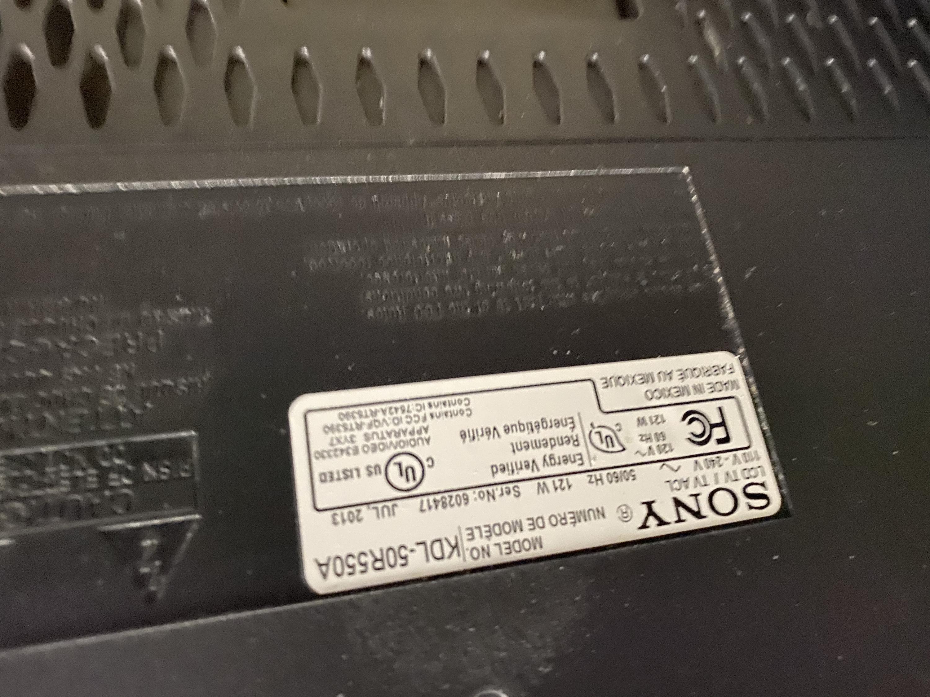

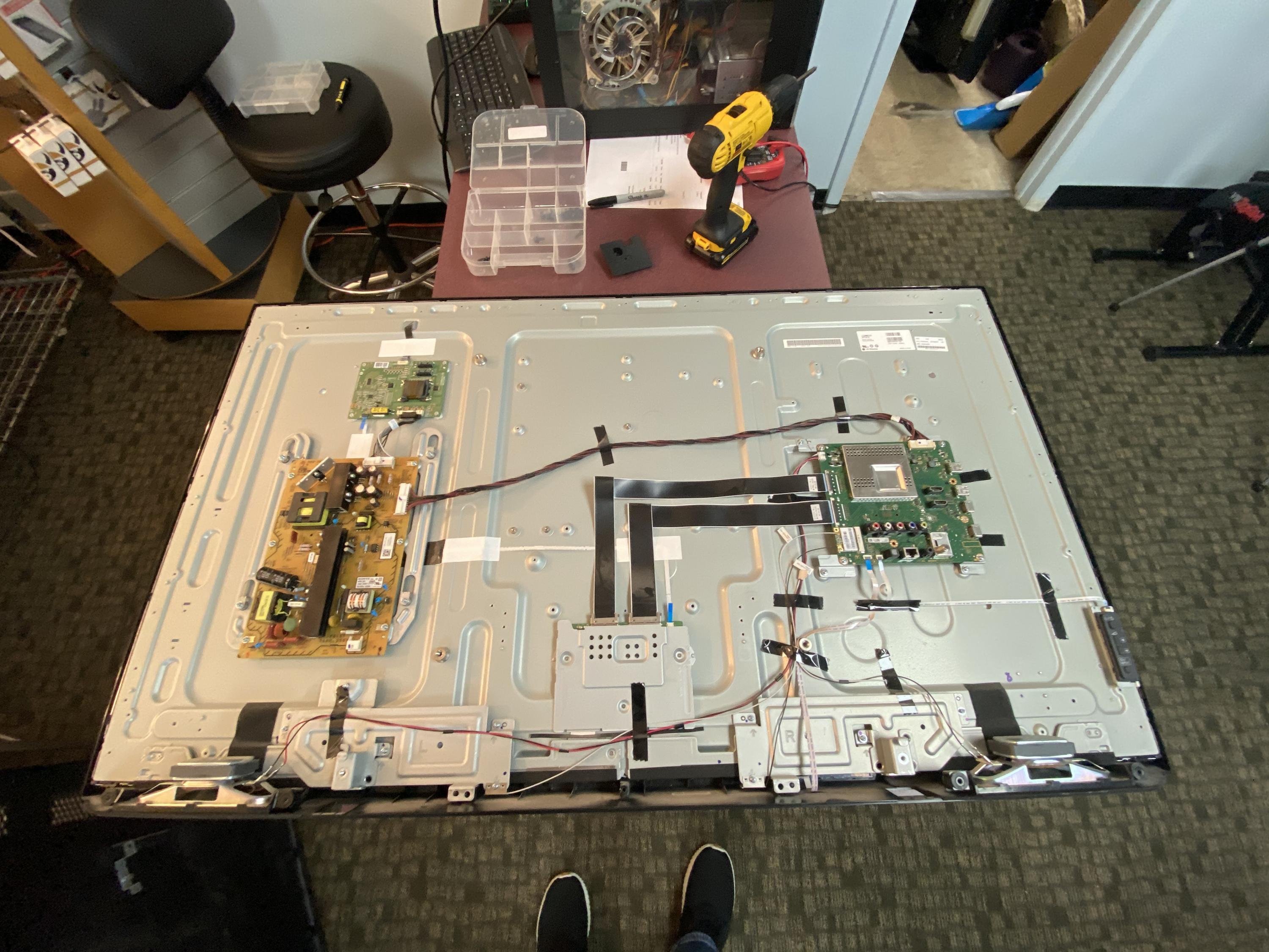

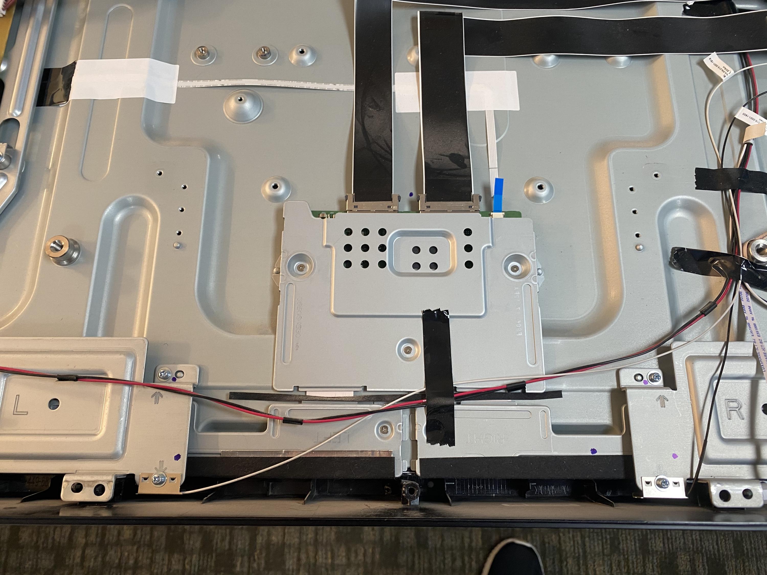

      Here are the pictures of the tv. It includes model number and all boards shown.

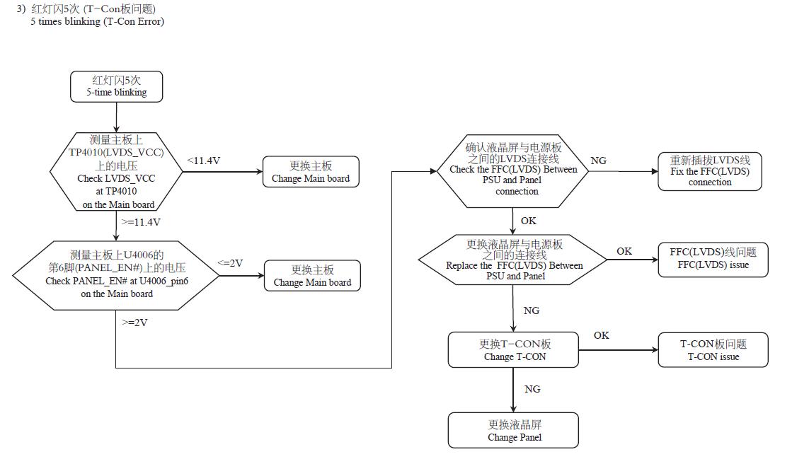

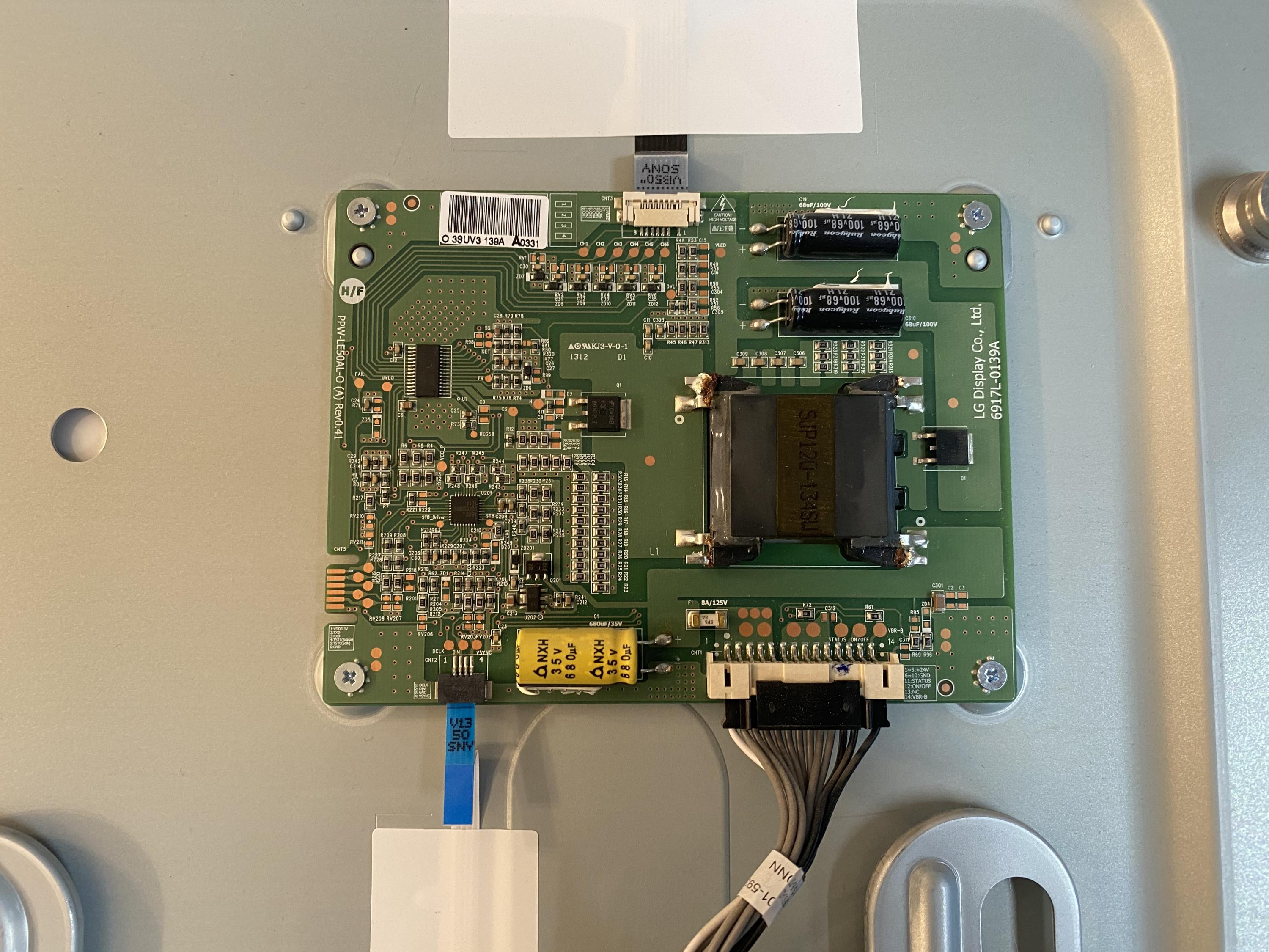

        Download the service manual. A 5 blink error is a T-Con error code, This is from one of the manuals.

            1) Check the fuse on the T-CON board.
            2) Check to see if you do have 12V at both ends of the fuse on the T-CON board with ref to GND.
            3) Try having one ribbon cables between T-CON and the LCD panel connected one at the time (make sure to unplug the TV from the outlet first) to see what happen.

              I tried unplugging the t-con to the panel ribbon cables one at a time and turning on and it repeats the same error. Press power, backlights turn on for a couple seconds and then shuts down to the 5 blink error.
              With checking the fuse. (Guessing it is the component above the chip and close to in between the top connections that connect from the t-con to the motherboard) I tested and received nothing out of it. Assuming i did it right.
                Yes that is the FUSE (F1, 3A/125v)
                What voltage do you measure on both sides of the fuse? It should be around +12v.

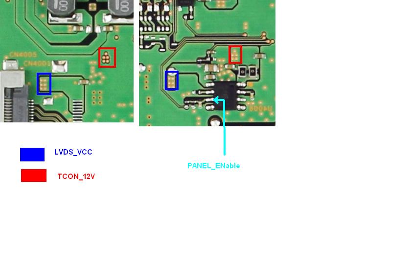

                      So you have NO Voltage on BOTH ENDS of the fuse, If this is correct.

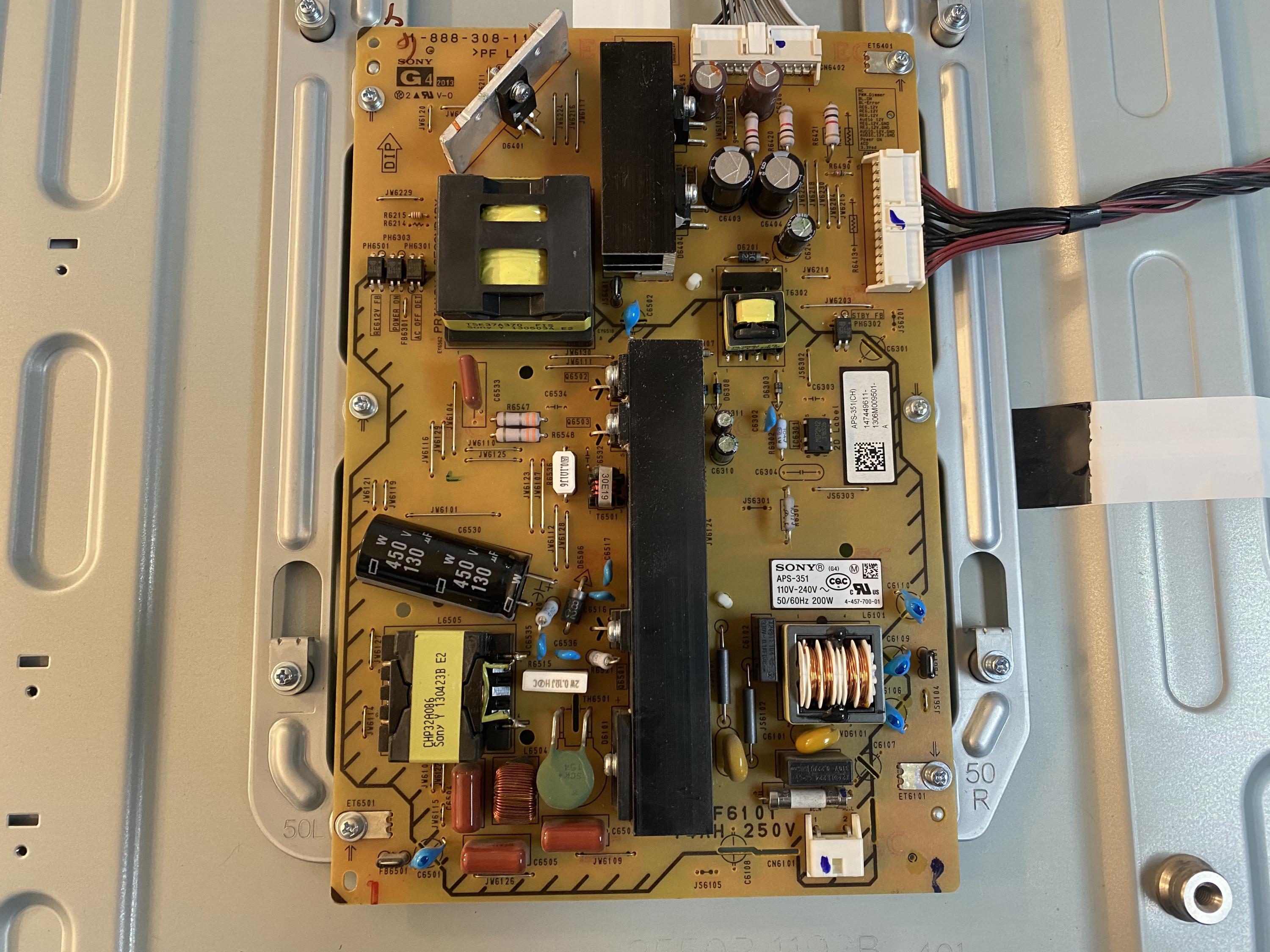

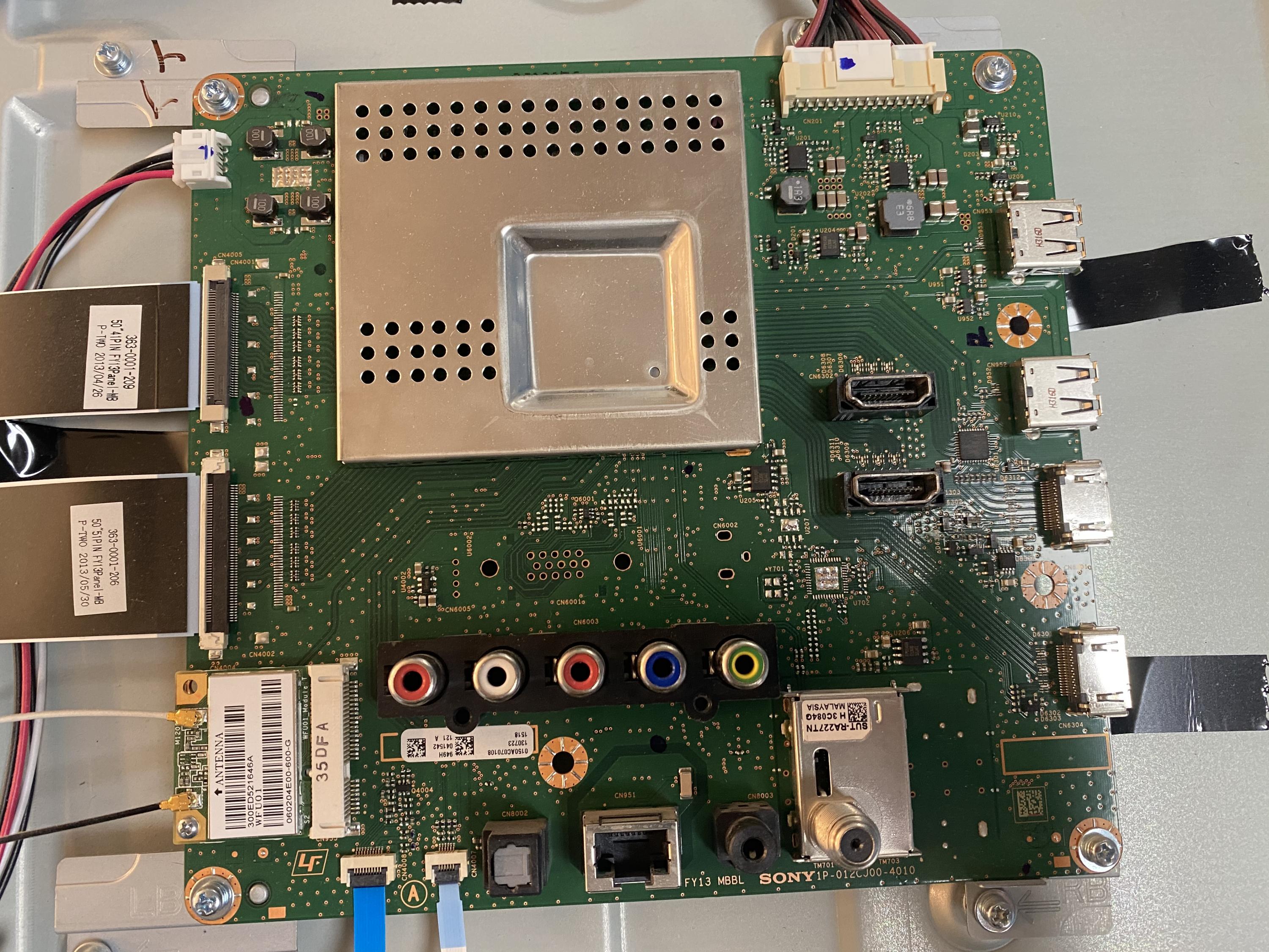

                      Locate the test points on the main board, Check for 12v on TCON_12V and LVDS_VCC

                          It would seem that you don't have +12 volts from the power supply, Check on CN6401 pin10 of the power supply, this should be +12 volts
                          If you no not have +12 volts, from the power supply, Un-plug the tv and check R6536 resistance (white ceramic 0.1Ω)
