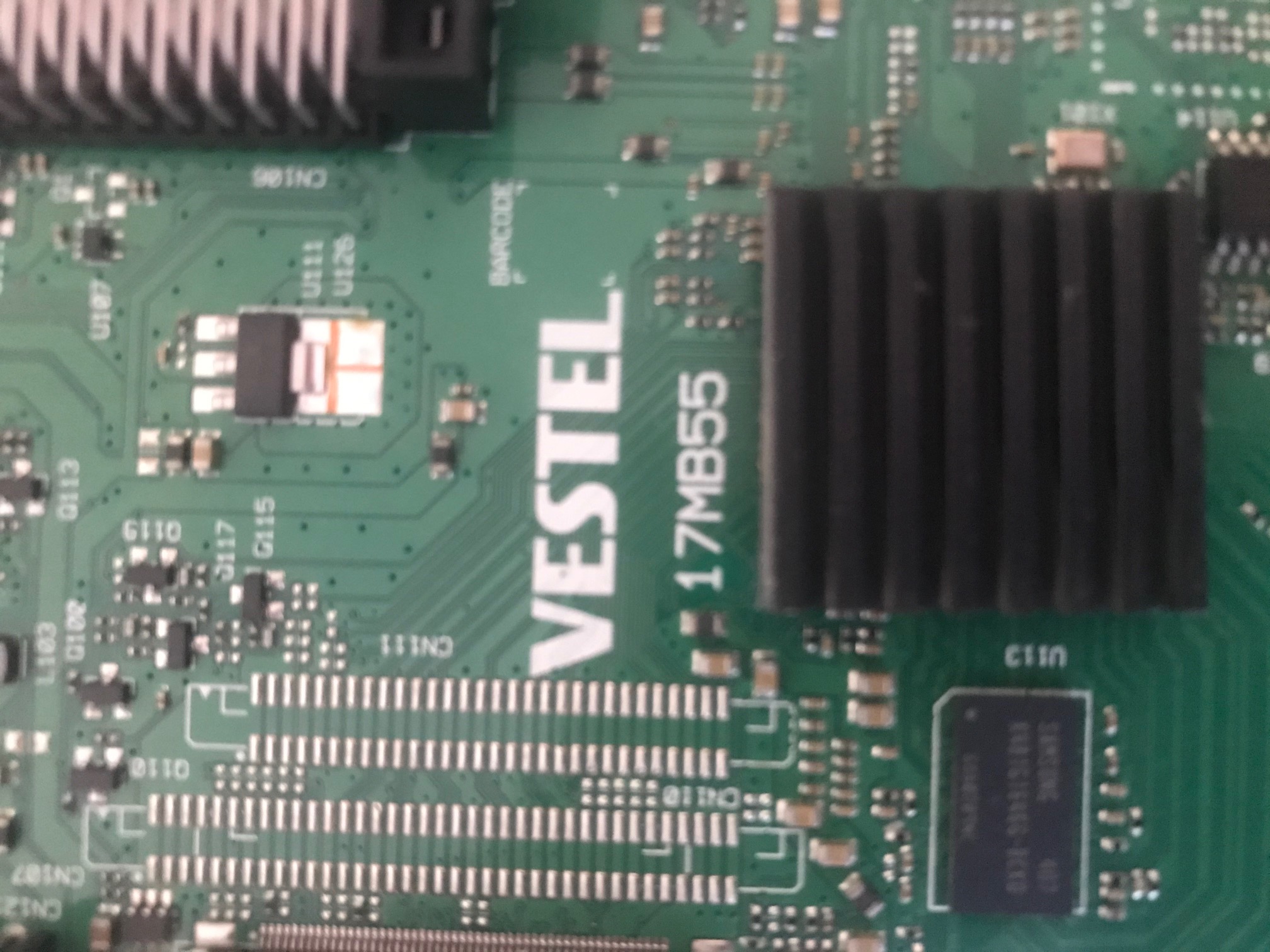

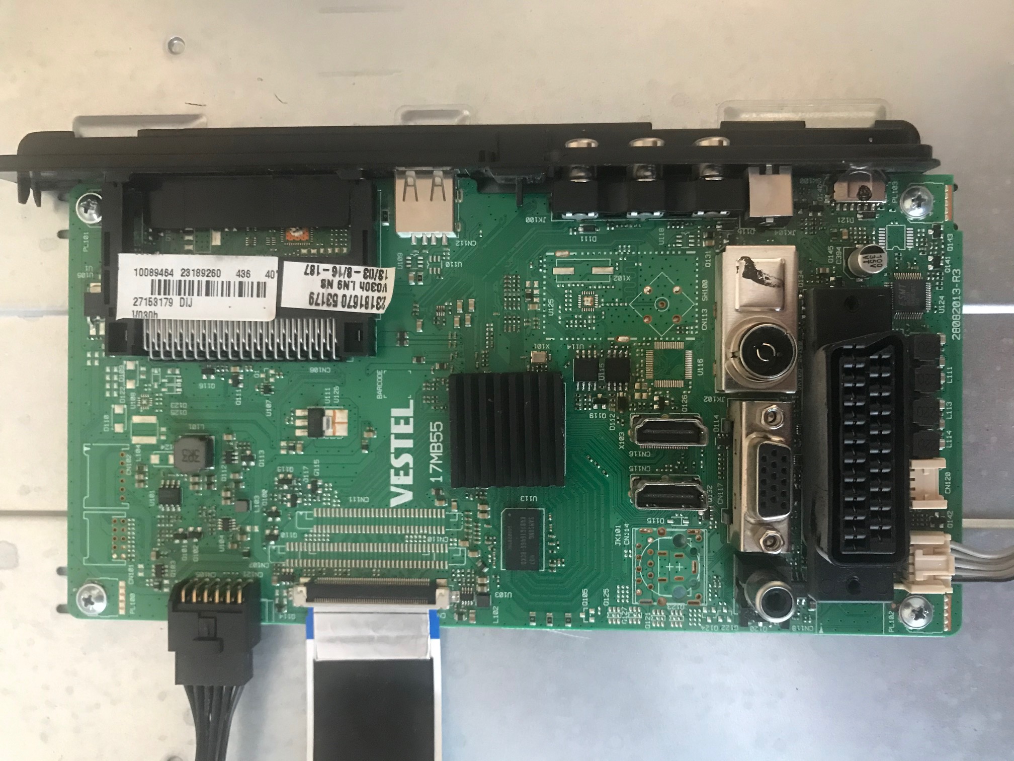

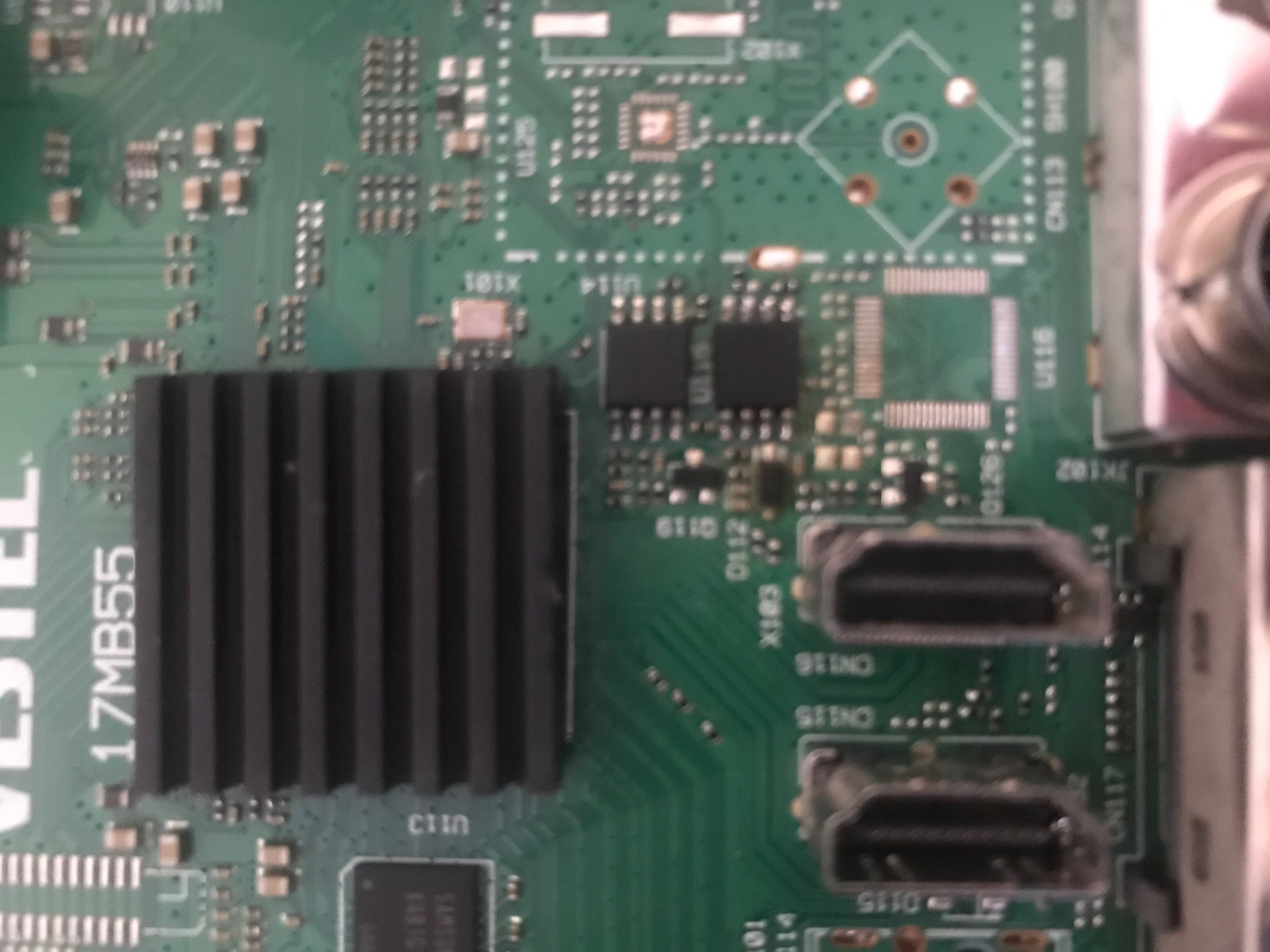

    flashes both eeproms u114 and u115, tv now boots and works great on all inputs, but can not tune in any tv channels ? ideas ?

    is dtv selected ?
    go into the "hotel mode" service with Menu + 7935 and see if the "digital tuner" is activated or not.

      Re: celcus dled40125fhd
      just tryed it, it is turned on and hotel of, will not tune, just moves though the channels when trying to tune, as if no signal.

        Where did you get the eeprom bins from ? Are you certain they are correct ones ?

          it was listed as the correct files even with the correct screen, but that don't mean its 100% working or right, but the tv is now working apart form the tv channels,
          here are the files in case anyone else wants to try it.
            U115 deals with channel management. Copy that into memory. I compared what you have and they are different.
                thank you, i will try it, but broken my programmer, so just waiting for another to be delivered
                    well tried your file and still the same, search completes with no channels found
