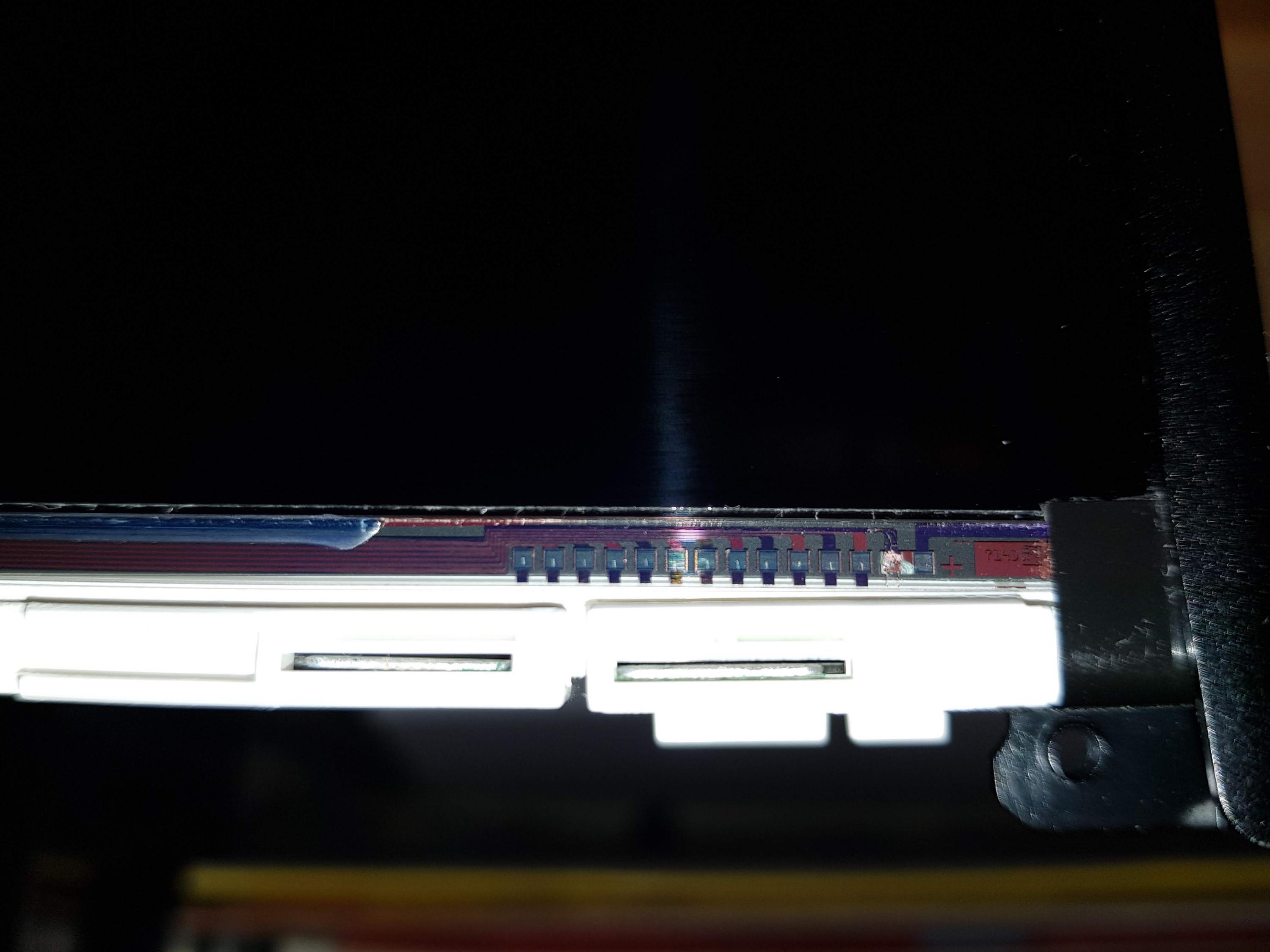

                I did have a closer look at the lcd and i found a crusty looking trace on the lcd.
                It is at the far right bottom corner of the screen. Could that be the short?
                Would it be possible to fix this with the cutoff tape methode?
                I don't really understand the theory behind this methode. Is it to bypass the bad signals-shorts?

                  Re: Sony KDL-50W828B sound but no picture
                  Here's a picture.

                    I'd try giving it a gentle clean with a cotton bud and some isopropanol alcohol (IPA) before playing with tape.

                      Sure looks like cleaning fluid/water damage, I suspect there is more water damage to the lcd driver board. This happens all the time when people clean the screens with liquid cleaner. That's not Sony's fault

                        Water damage is possible but I did not find any trace of water. Both driver board are very clean and also on the bezel no water stains.
                        What happened with trace I don't know. Cleaning it is not possible I think because it is behind the glass.
                        I will have to remove more parts from the bezel to have a closer inspection. It could take awhile because of my limited time.

                          I am sorry for the late reply.
                          After some more inspection and testing, even the good side of the screen went bad.
                          So after that I did not bother to do more testing and I trashed it.
