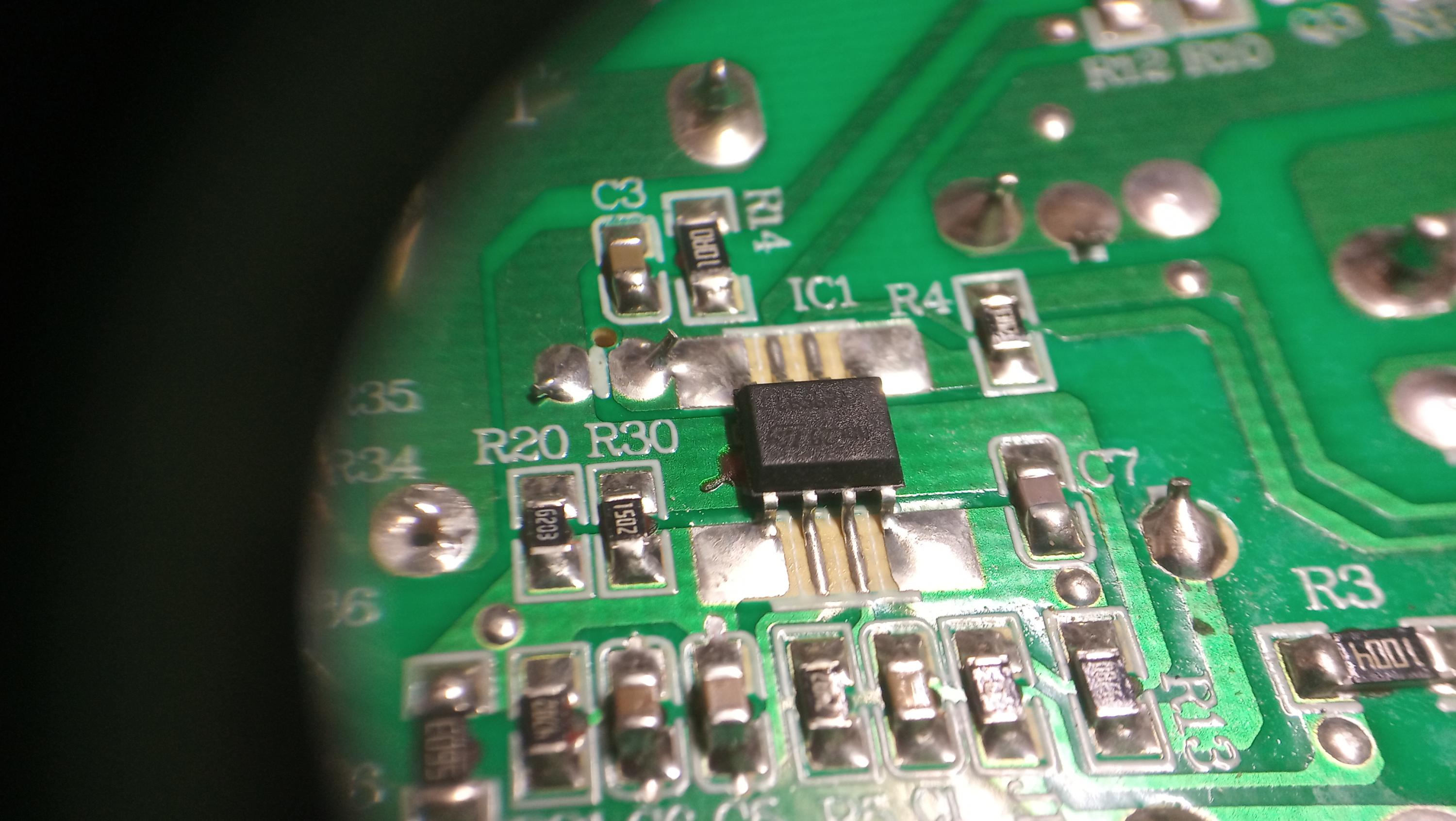

    I Have received a TV that someone worked on and removed the following components
    Q4, C27 and R41
    from the colors of R41 from photos online it is a 0.3ohm resistor but I can't find any schematic of the board online.
    Any help would be greatly appreciated

        R41 can't be 10k it is 0.3Ω It is the fet's source resistor.

            I looked a a few power supply schematics and the value for C27 could be around 20~220 pf and the originals are usually 1KV but its best to use a 2KV replacement
            Samsung board BN44-00338B uses a 12N50 mosfet and the cap from drain to hot ground is a 220pf/2kv so it might be similar
              Re: faulty AY160D-4HF12 power board
              What is the P/N printed on SMPS IC1?
              C27 is the snubber cap for MOSFET Q4, it is connected to Source and Drain of Q4, typical value is 220 ~ 330 pf 2KV.
              The application circuit of IC1 may show the value of snubber cap.
                  Logo is of ST
                  From what I can read there is
                  L6562A
                  And
                  GZ344
                  But I can be wrong, will attempt to upload the best photo I can of the IC
