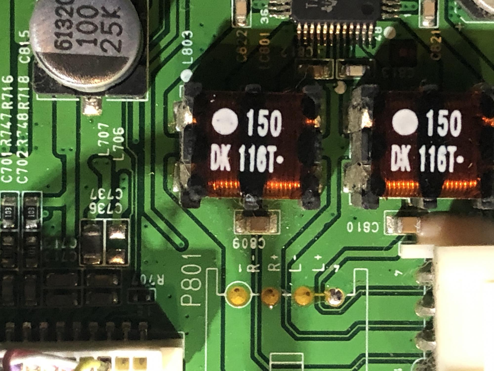

    This LG 60pv400 red light comes on after plugging in.when you turn power button on red light goes away then faint snow image comes on for 2 seconds then goes out.press power button as in to turn off red light will remain.
    I did confirm on power supply test points vs=200 va=54
    I followed from ps to both y and z boards and they both are matching voltages from ps.
    I did tested all capacitors on video board all read good with no shorts except c809 and c810.
    My question is if I replace those should that resolve the problem or is there something else I need to look at?
    Thanks in advance.

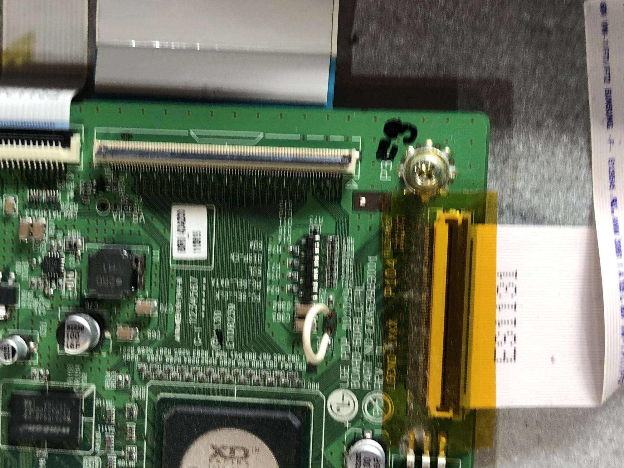

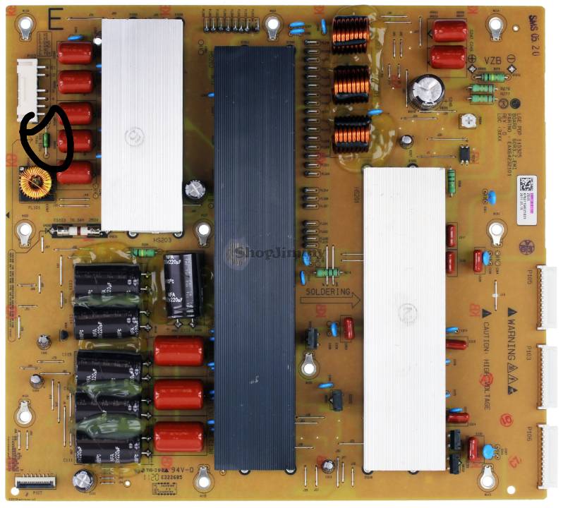

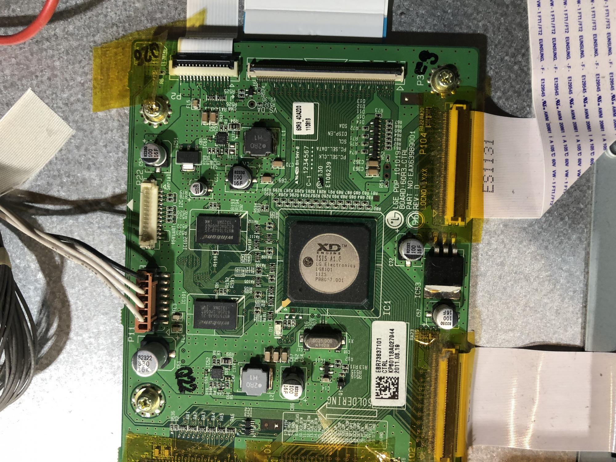

        Unplug the power cord. Un-latch the ribbon circled in black. Put a paper clip in both the holes circled in red. Plug the tv back in and look for the test patterns on the screen.

          Re: LG 60pv400 gets faint image on screen for 2 seconds
          Forgot to post the picture.
            Thanks tvtimmy, I ran the jumper and unplugged cable plugged tv in no test pattern showed just the faint image for 2 seconds and disappeared.

              I starting checking fuses and fs103 on zsus board is blown.I looked at inductor solder joints and there was cracks so i reflowed solder on them.
              I'm guessing the next step is to test igbt's and other components.I will research other threads and get back.
              I took ysus board off and noticed cracks in the inductor solder joints,I'll re-flow them later tonight or tomorrow.

                      There are smaller fuses on the y and z boards too.

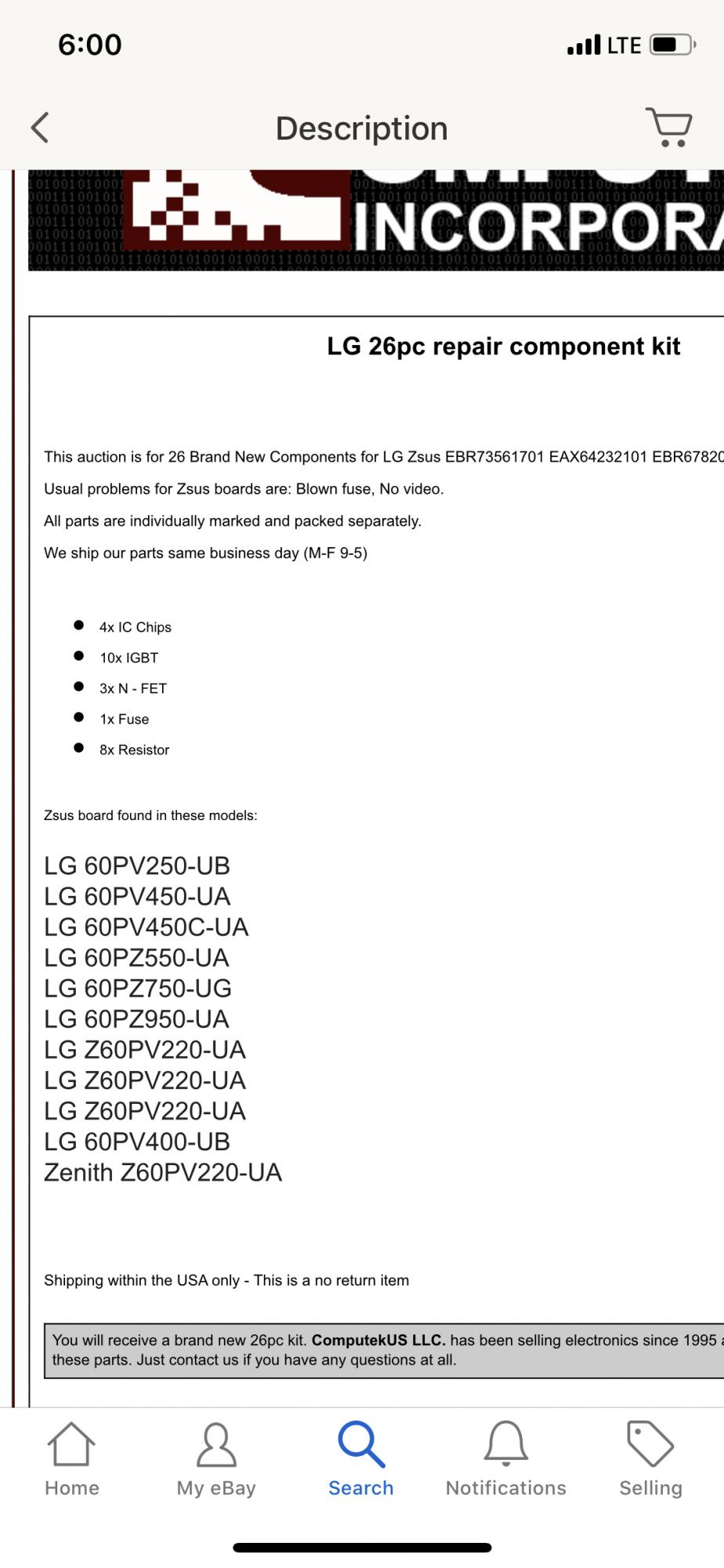

                            Ok I tested all the Q ones and most of them are bad.beeping away.i pulled the y board no beeps on them.
                            If I get a repair kit should it include all the igbt's or do you have any recommendations?
                            Also the fuse that you posted a pic of is showing good.
                                I've ordered parts from this guy before, always good stuff from him. Look up your board number and search for it on Ebay.
                                  I found this on eBay for $20 so I'm gonna have to desolder and pull the heat sinks completely out right?

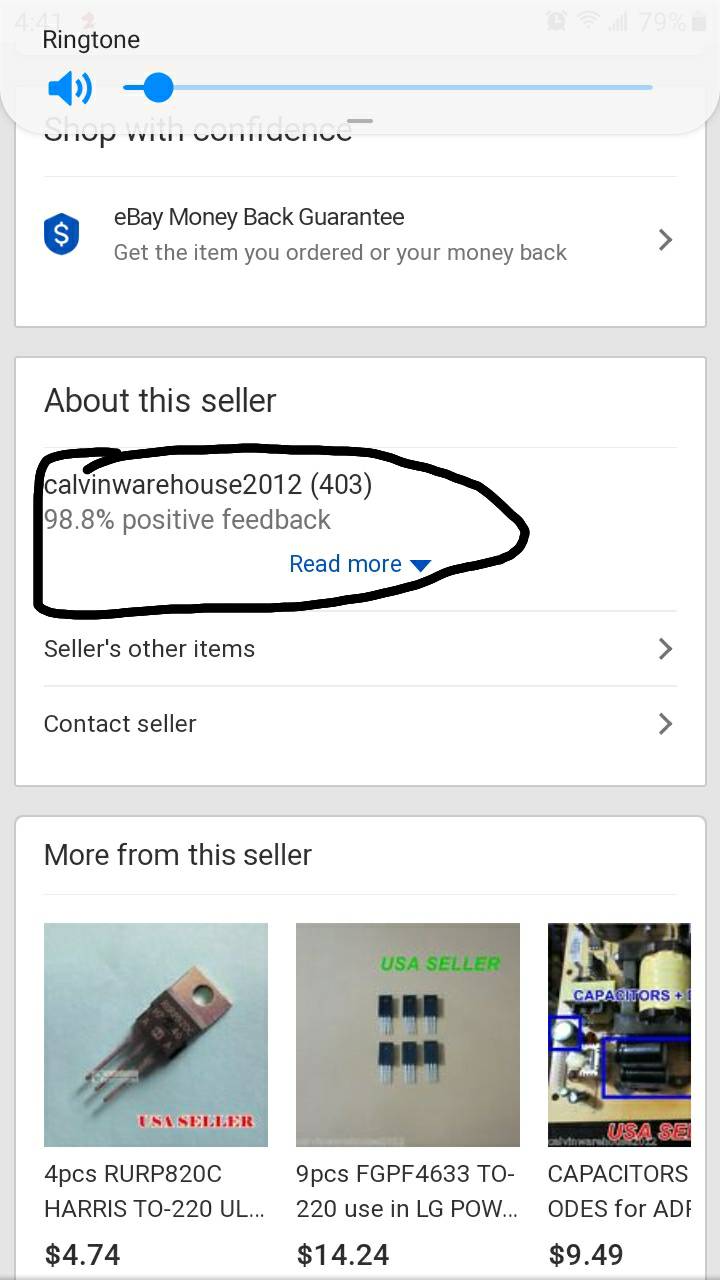

                                      • ajshoe
                                        ajshoe
                                        • Dec 2012
                                        • 477
                                        • usa
                                        I've used this guy before also - not competent. sent him 3 power boards to repair and he shipped them back like an 8 year old would. boards came back all broke. I'll never use or trust him again. Had to agree with fleabay so unfortunately I couldn't give him negative feedback. just my 2 cents worth
