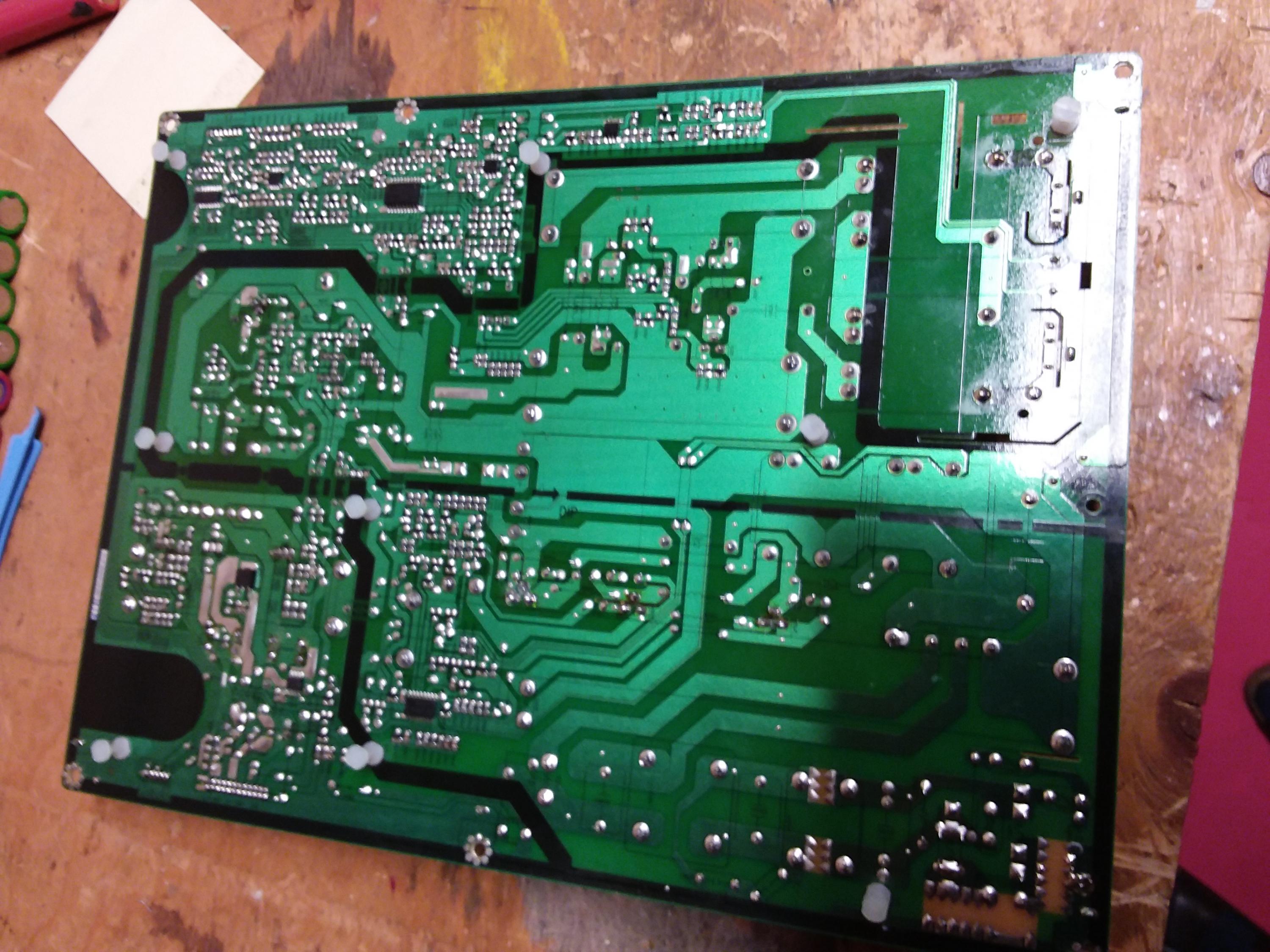

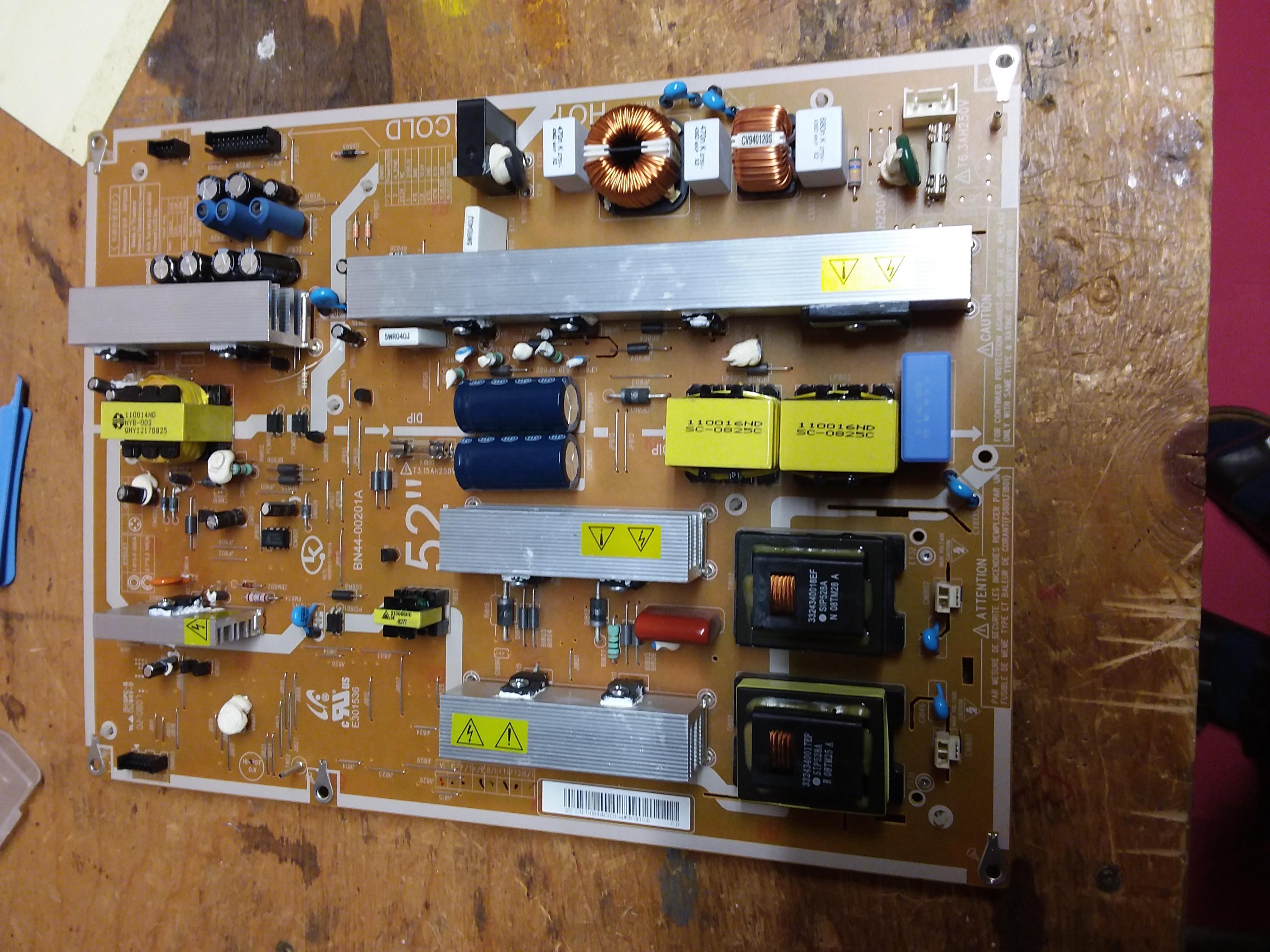

    I have a Samsung LN52A630M1FXZC that does not have standby light and will not power on. This uses the BN44-00201A power supply board.
    I ordered the repair kit for this board from ShopJimmy and installed the following.
    QP801, QP802, DP802, ICM801, CM851, CM852, CM854, CM855, CM856, CM858.
    FS801, FI801 tested good.
    When I applied power the TV came to life and all was good for about 5 minutes.
    Then there was a loud snap and it went off.

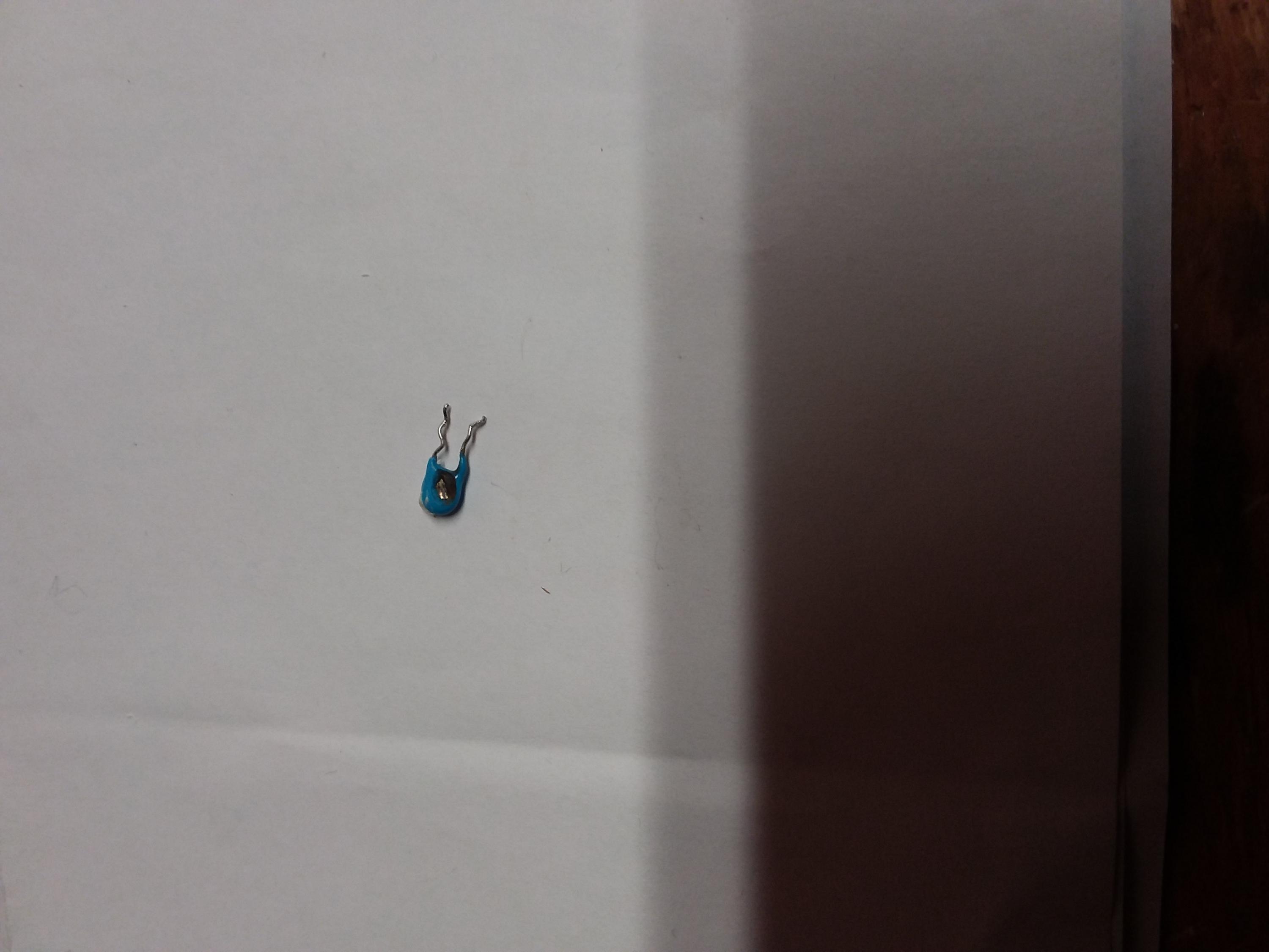

    No burning smell, but under close inspection I found CM814 (470pf 1KV) to be split open, and FI801 to be blown.
    I have power to the rectifier, but no voltage to CN801. My electronics skills are limited.
    Any ideas on a path forward?

    Re: Samsung LN52A630M1FXZC that does not have standby light and will not power on
    You are sure you didn't get any parts in backwards?
    • pjcanuck
      • Dec 2019
      • 5
      I've checked several times and verified that I installed the components the same way the original parts were installed. The banding side of capacitors lines up with the marks on the circuit board.
        CM814 (470pF) is the snubber cap (these cap will shorted out when they go bad, it is commonly failed cap, it should be replaced with 2KV rating instead) for the MOSFET QM803 so you need to check the resistance of the Source resistor RM834 to see if it is blown open circuit or not, it should be <1 Ohm.
        See schematic attached.
          I checked the in circuit resistance of RM834 and it is approx 0.5 ohm.
