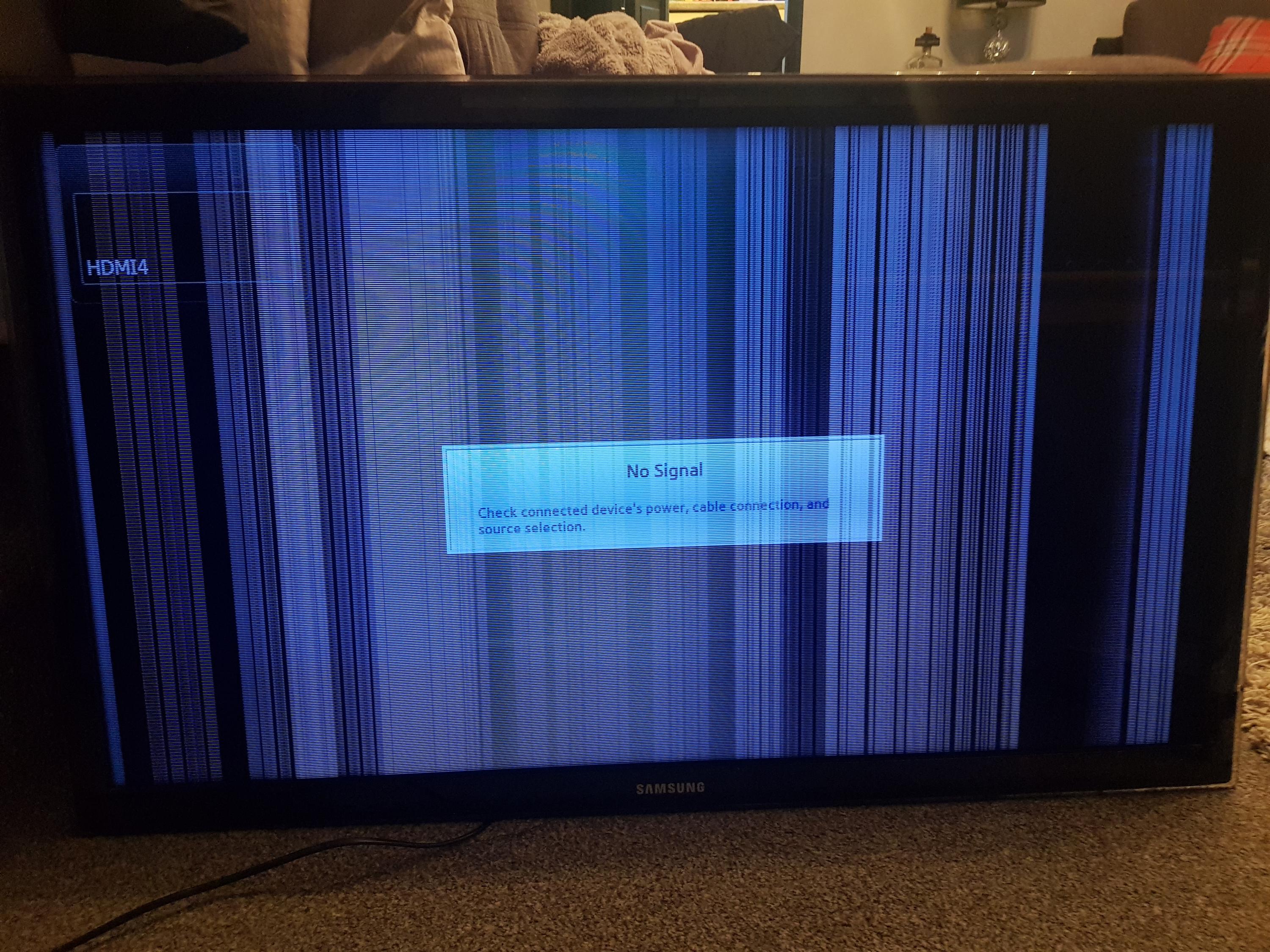

Samsung UE40D5520rkxxu lines on screen
  • Bloopeta
    • Jun 2018
    • 526
    • United Kingdom

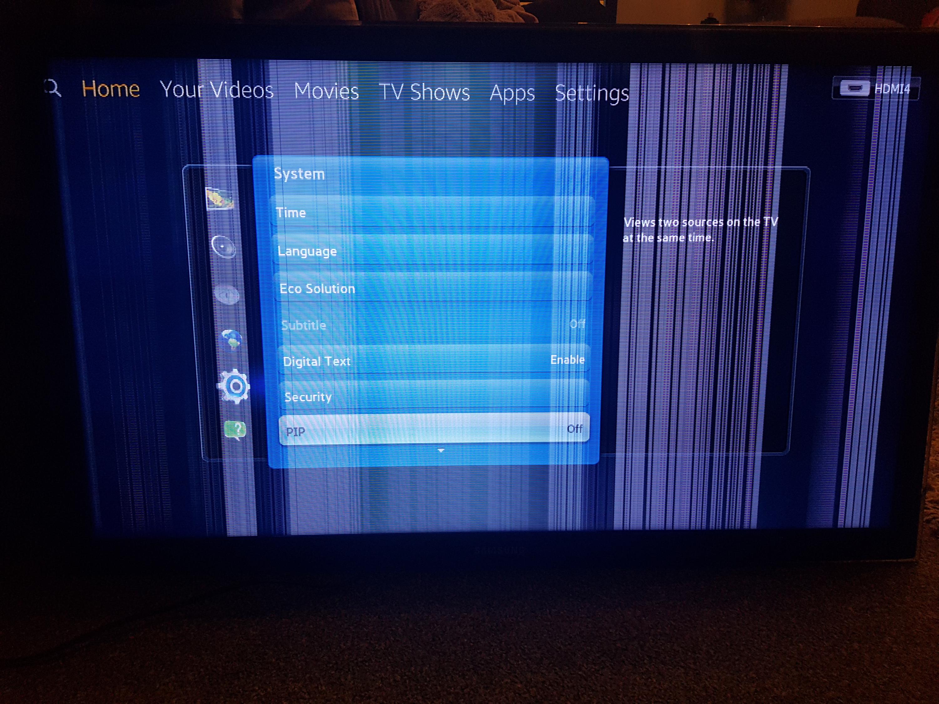

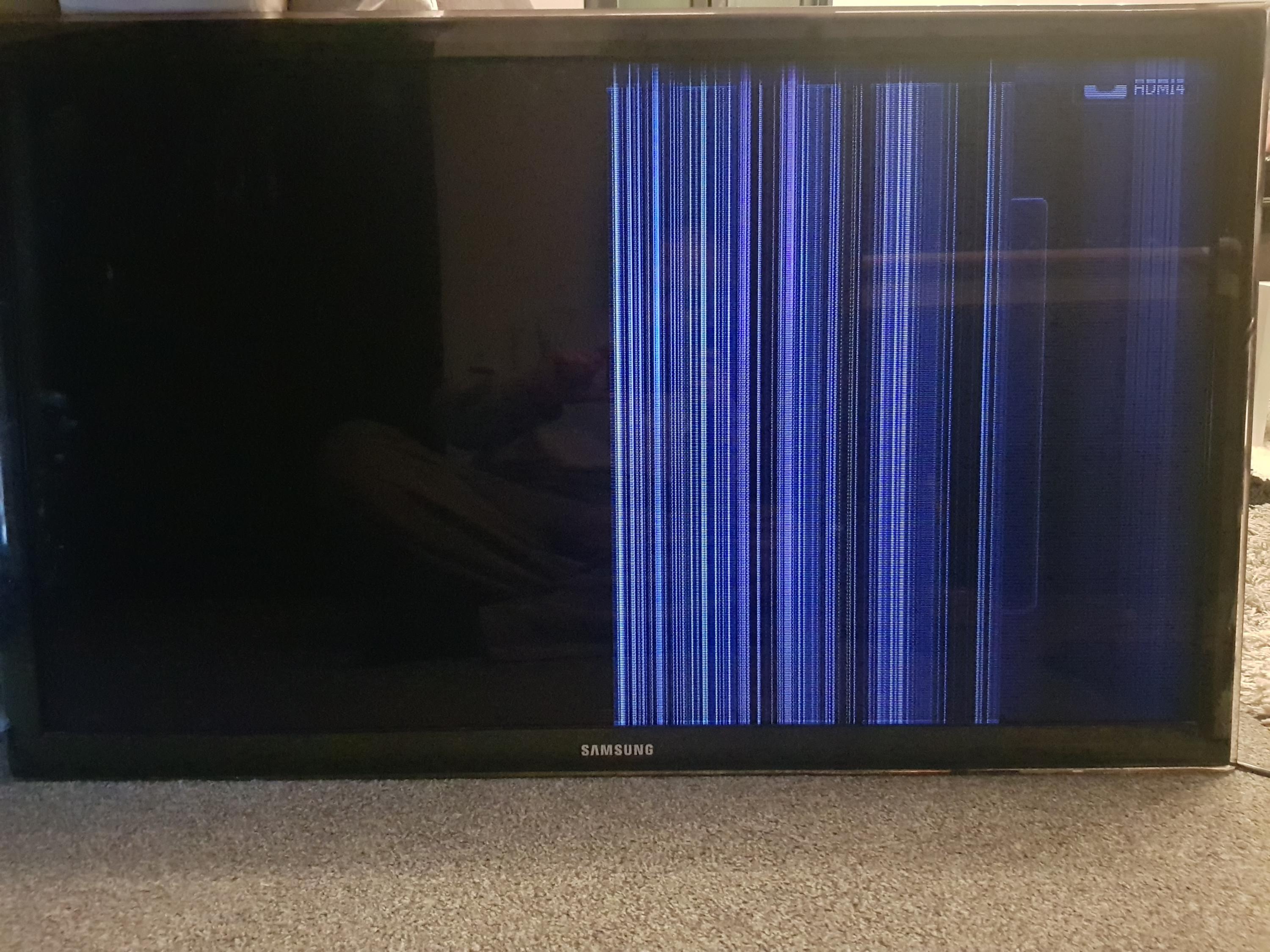

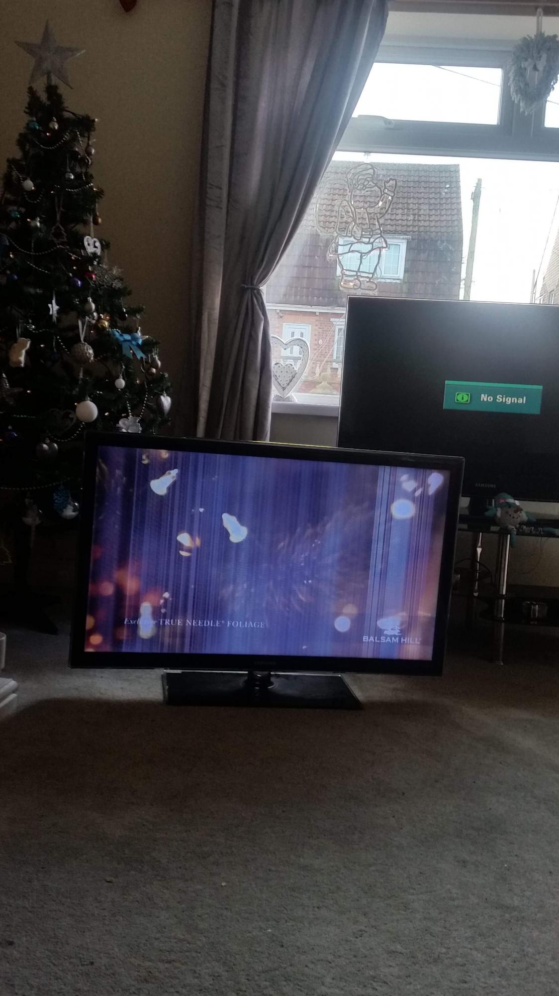

    Just a quick one, what would cause the lines on screen on this in the pics? T-con? Connection/cable? Or is the LCD panel shot??
    Apologies for the poor pics, its all thats available

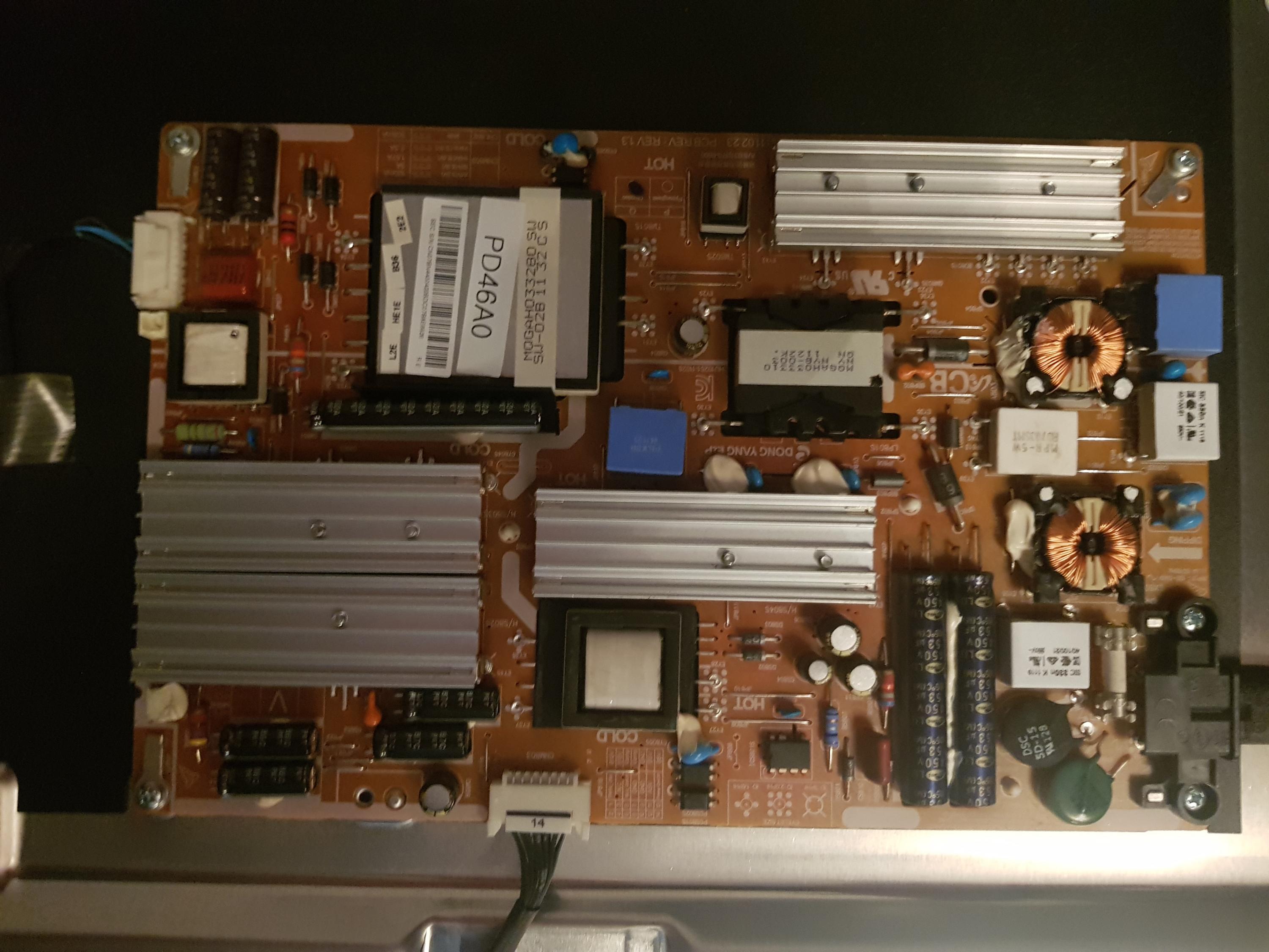

    Re: Samsung UE40D5520rkxxu lines on screen

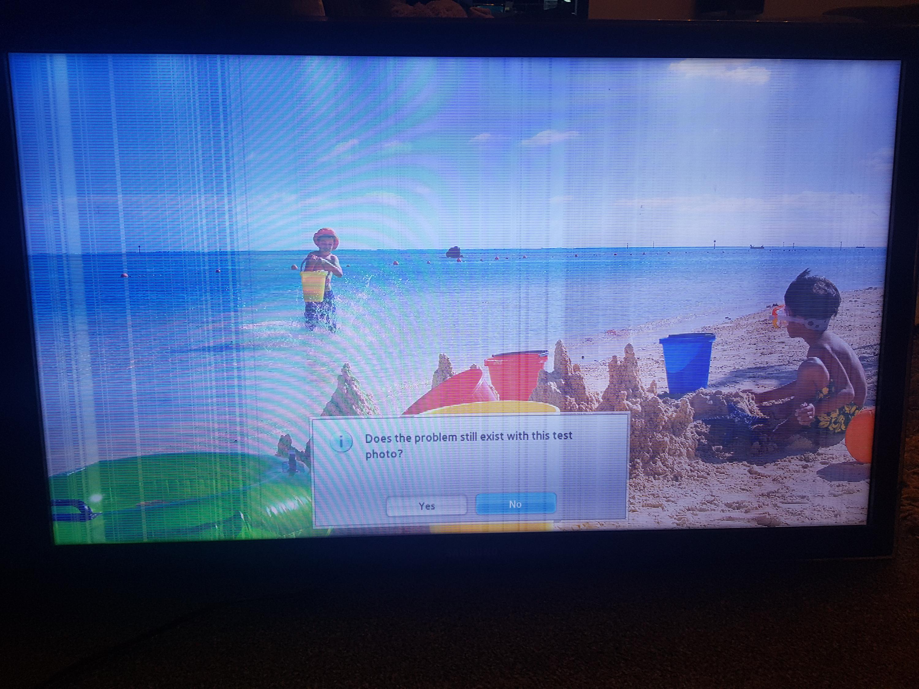

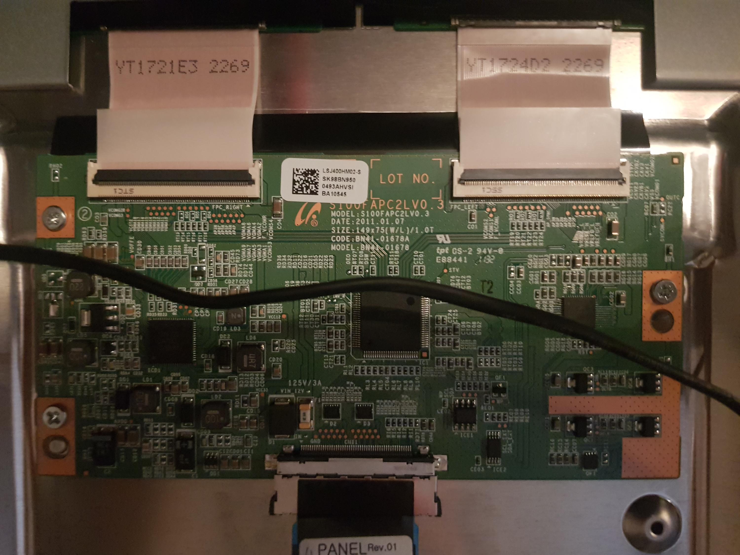

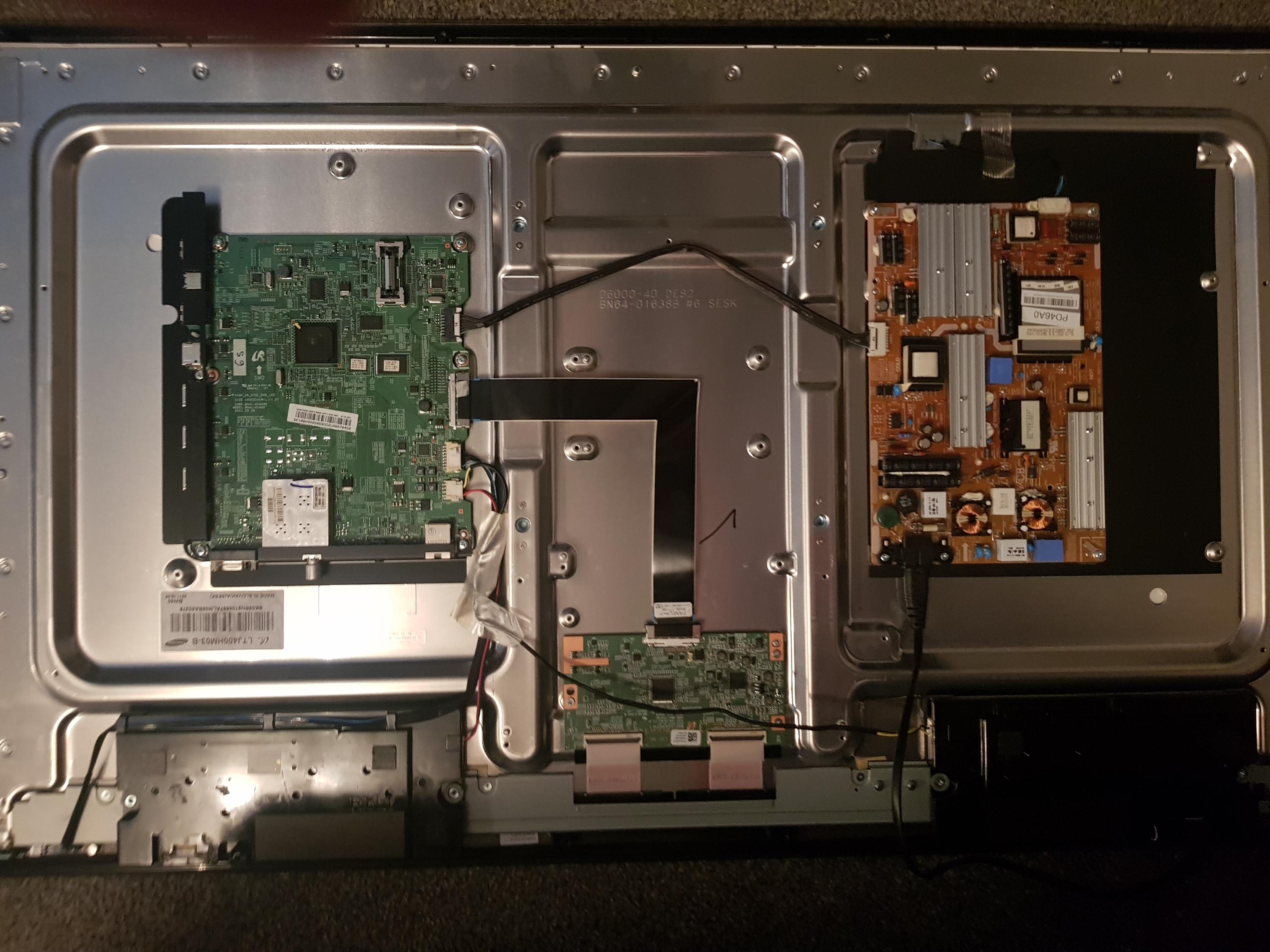

    Ok, so actually now have the TV in my possession, so have more info, the pics above were how it was, I have since unplugged Tcon, cleaned connections, plugged back in, and now its worse lol.
    Here are the pics as it is now, including pics of it opened up

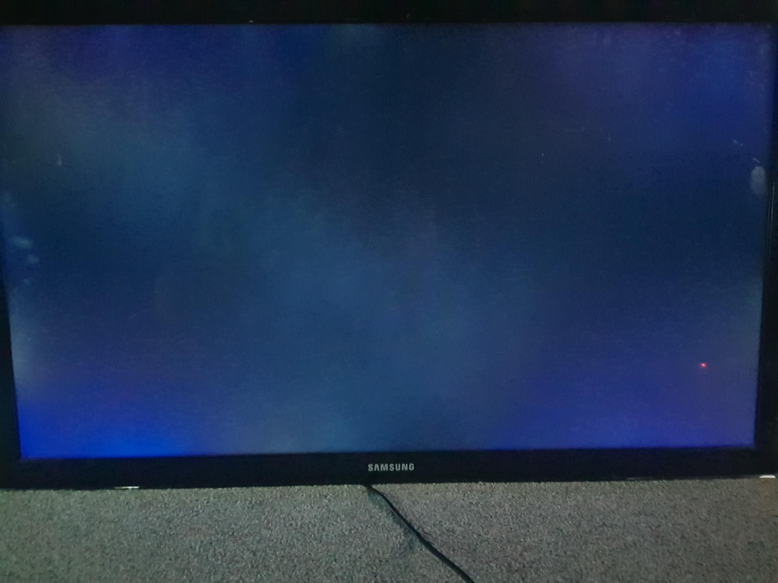

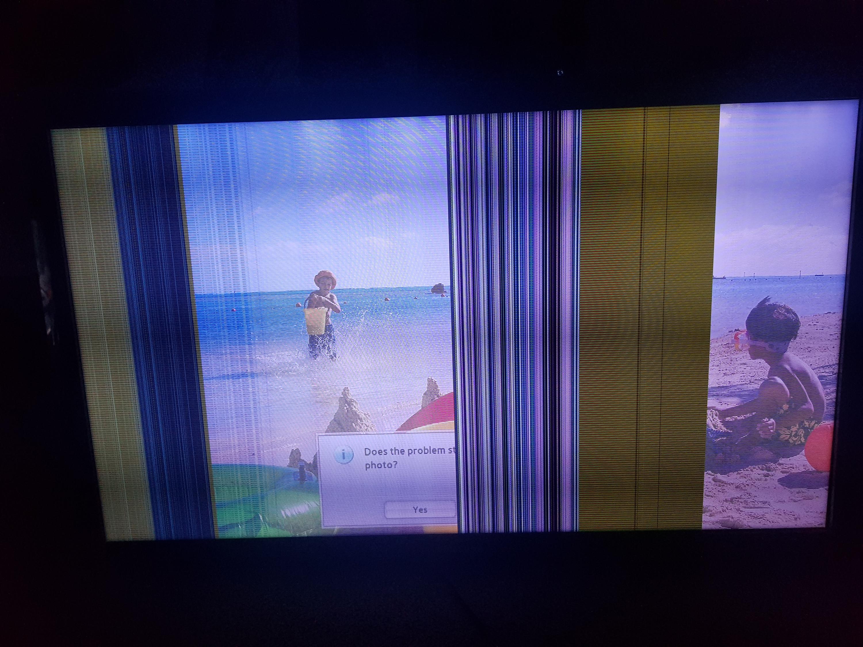

      Turned off, disconnected tcon again, reconnected and turned back on n now looks like this
      • Bloopeta
        • Jun 2018
        • 526
        • United Kingdom

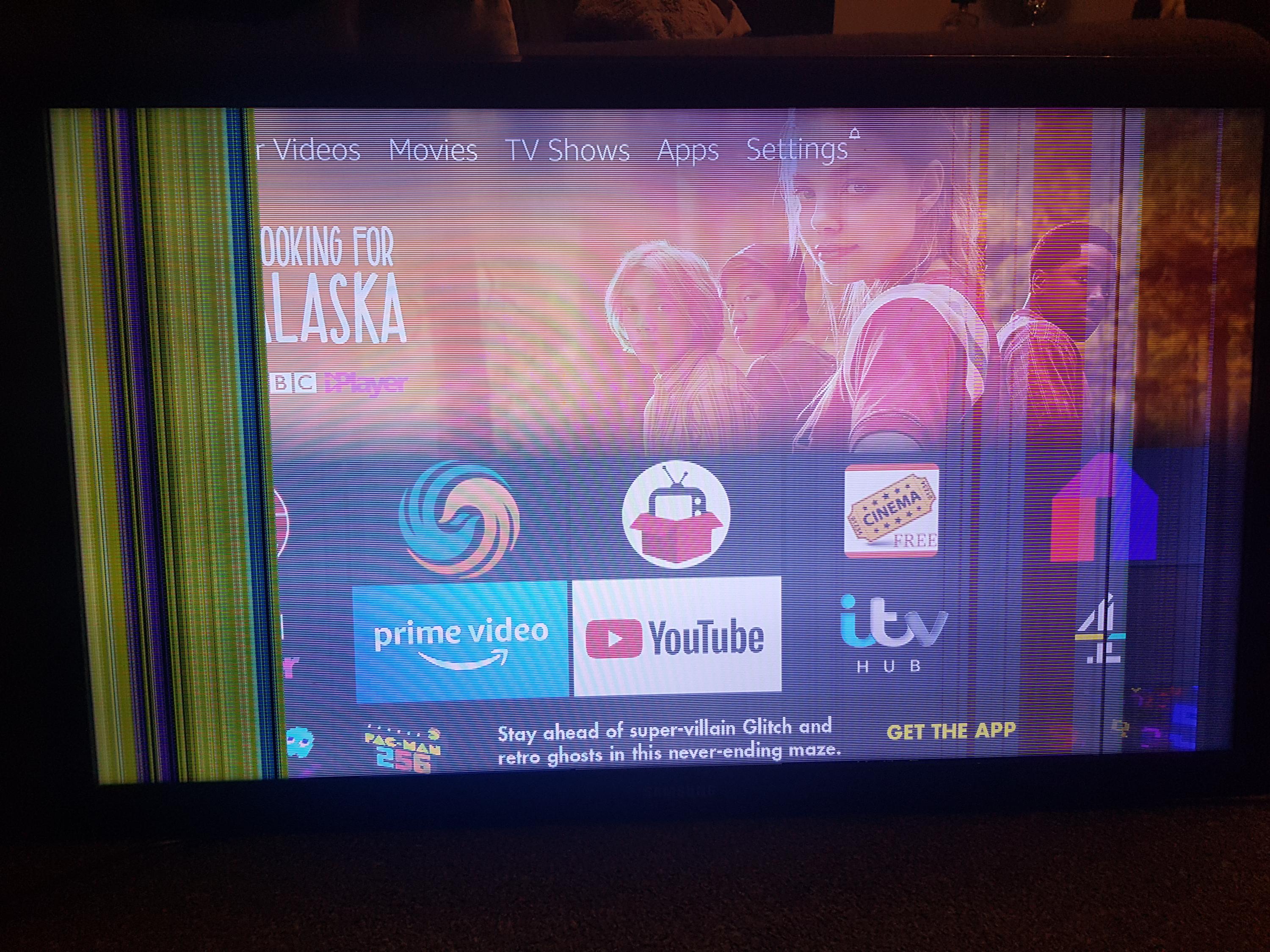

        Constantly changes all the time, very hard to picture
          Need to start somewhere, maybe test the tcon, I see lots of test points.
          • Bloopeta
            • Jun 2018
            • 526
            • United Kingdom
            Where would I saart with that please?
              Maybe try this first: https://www.youtube.com/watch?v=GcBwTums_mI
                  HVIN_12V
                  VCC_3.3V
                  VCC_1.8V
                  VCC_1.2V
                  VCC_1.1V some there, I don't usually test tcons much so not sure if these voltages are standard from tv to tv or not, you could test those gamma points? but it really doesn't look like a gamma issue to me.

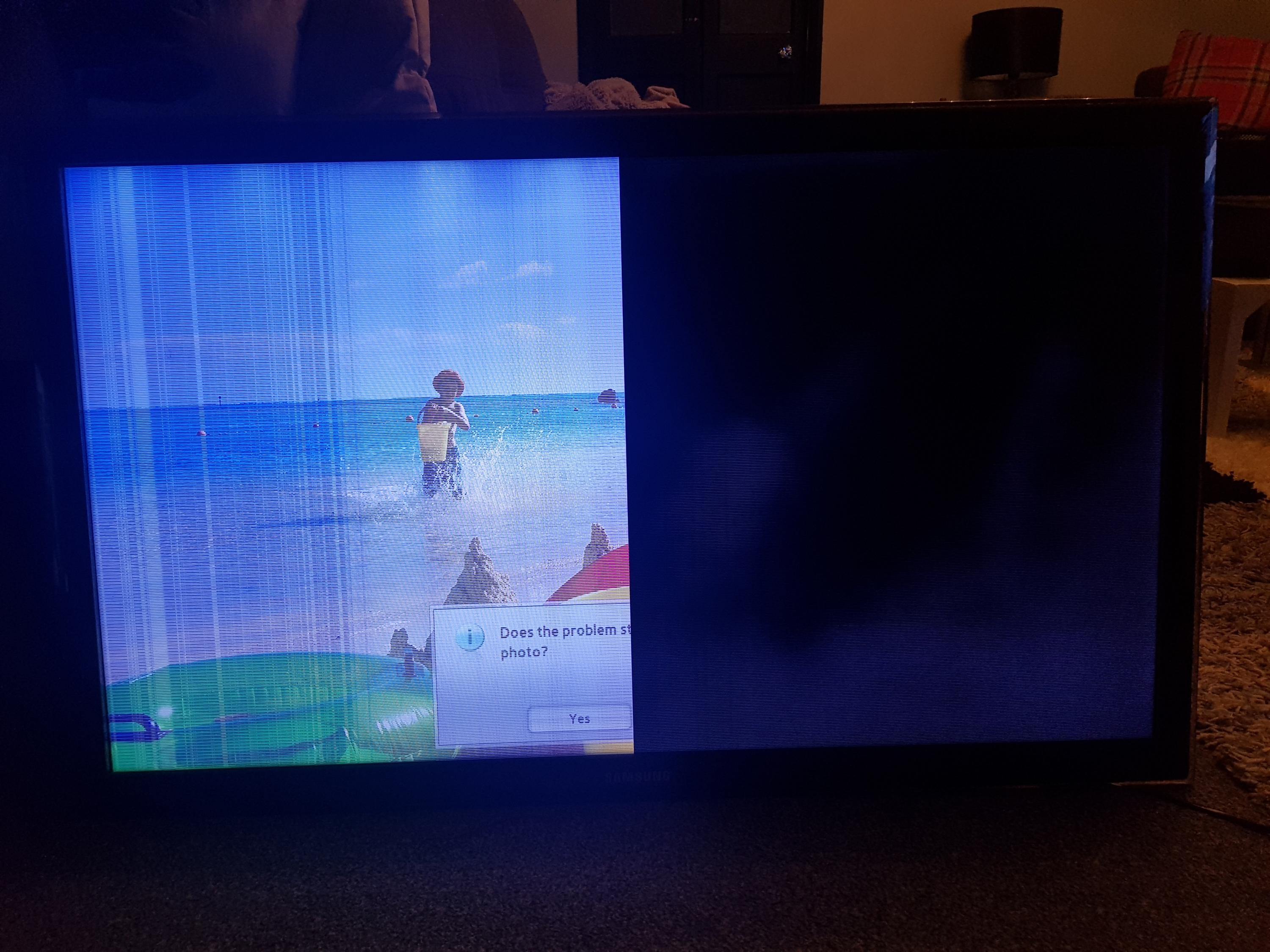

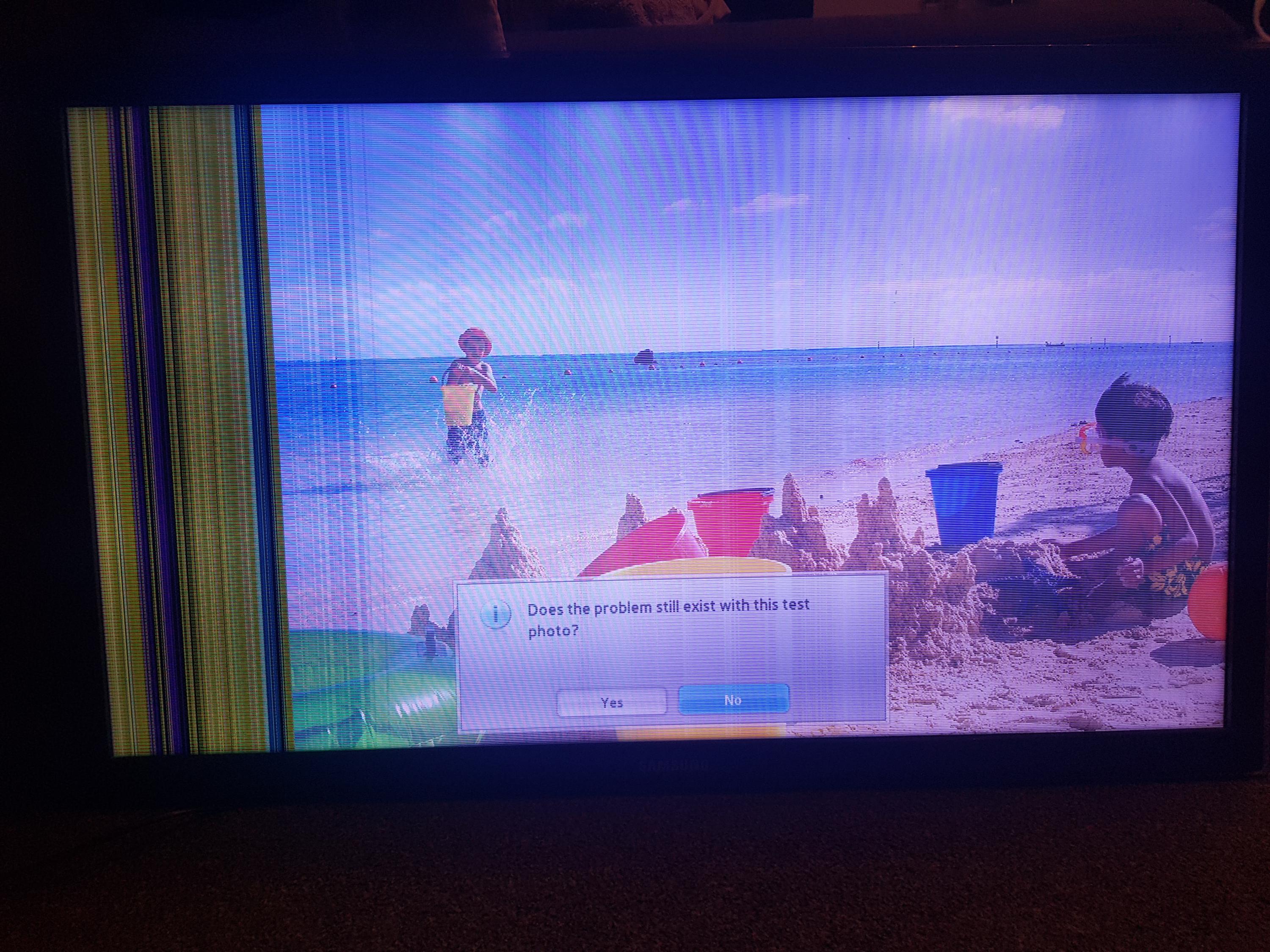

                    Just watched the video, disconnected 1 side at a time, heres the pics.
                    Also tried wiggling and tapping the bonded tabs, that did nothing.

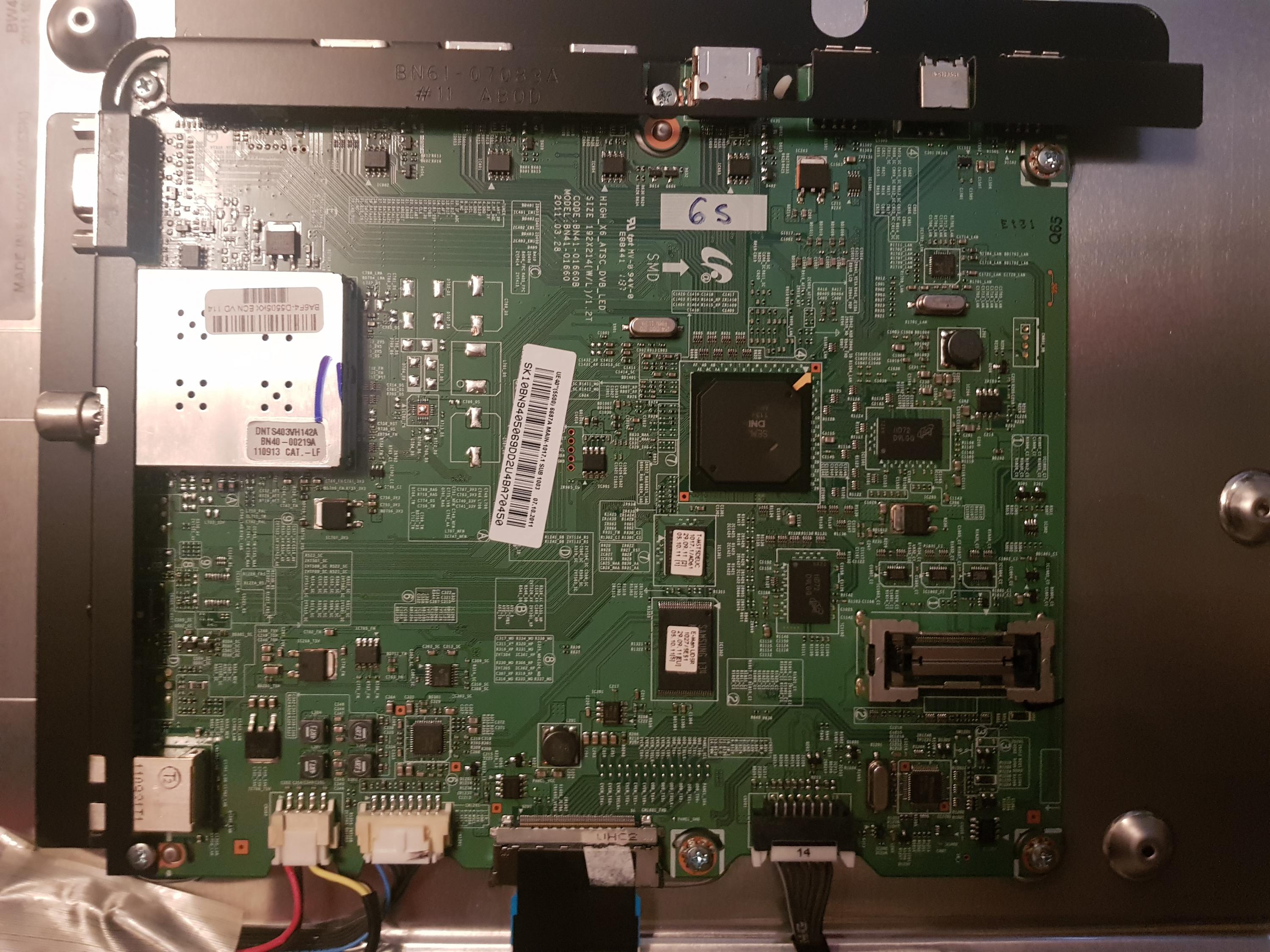

                      https://www.badcaps.net/forum/attach...7&d=1574437580
                      It looks like main board issue.
                      Did you try heating/cooling the maim board yet?
                      • Bloopeta
                        • Jun 2018
                        • 526
                        • United Kingdom
                        No not yet, been focusing on Tcon, I will try that now
                          I don't know if it's dangerous, as in might short something BUT I've seen some get a better or clear picture by adjusting one of the ribbon cables while in the diagnostic mode you are in on the picture, with tv running.
                          • Bloopeta
                            • Jun 2018
                            • 526
                            • United Kingdom

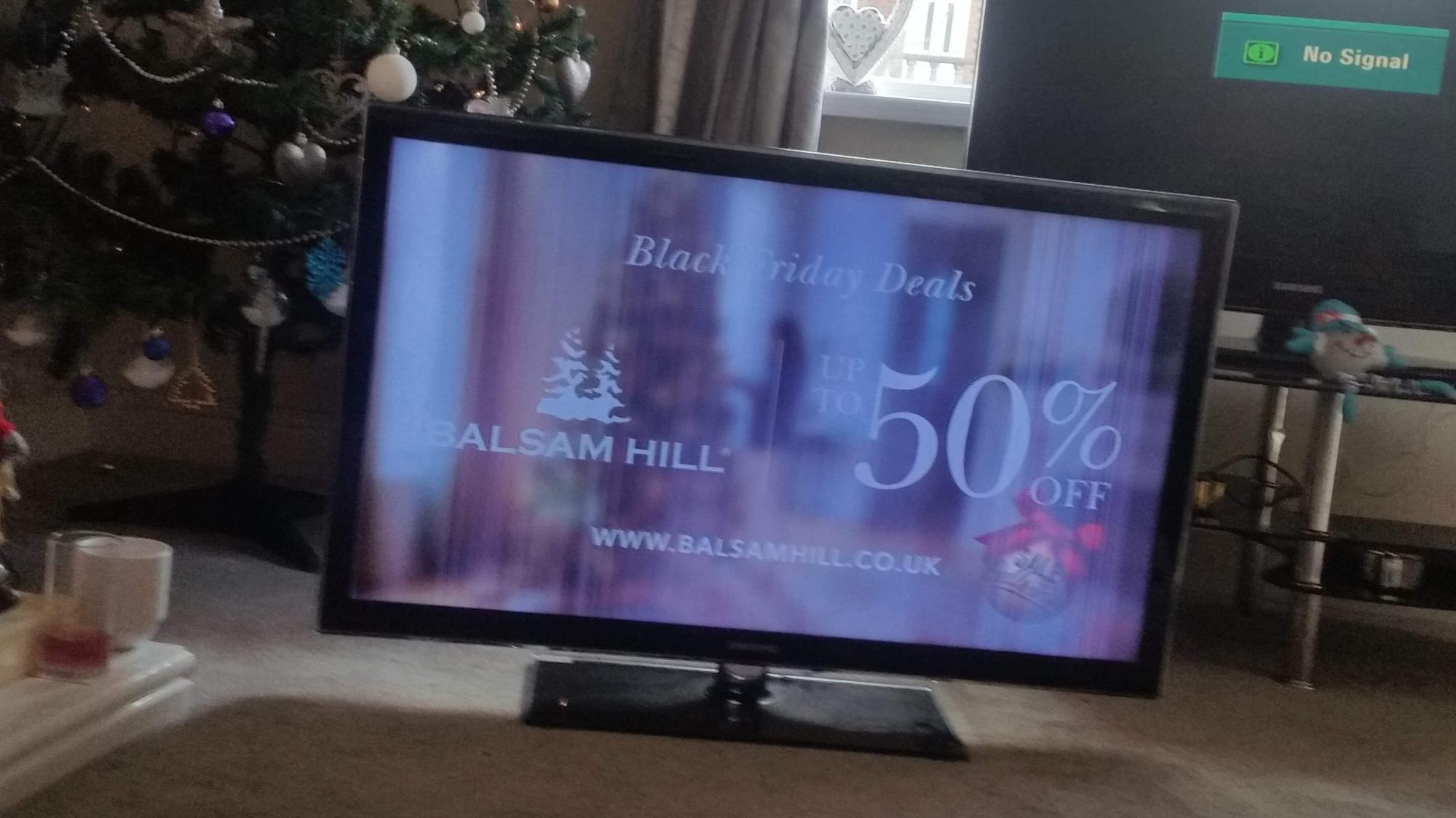

                            Tried heating then cooling board, also tried playing with ribbon cables whilst switched on picture test screen.
                            Pic 1 is how the screen looks with nainboard unplugged, pic 2 is how it now looks all connected after trying the above mentioned things
                            • nomoresonys
                              • Jan 2013
                              • 12196
                              • U.S.
                              So it seems to be changing somewhat, that makes me think it's the tcon.
                              • Bloopeta
                                • Jun 2018
                                • 526
                                • United Kingdom
                                It changes everytime I do something, rarely the same twice
