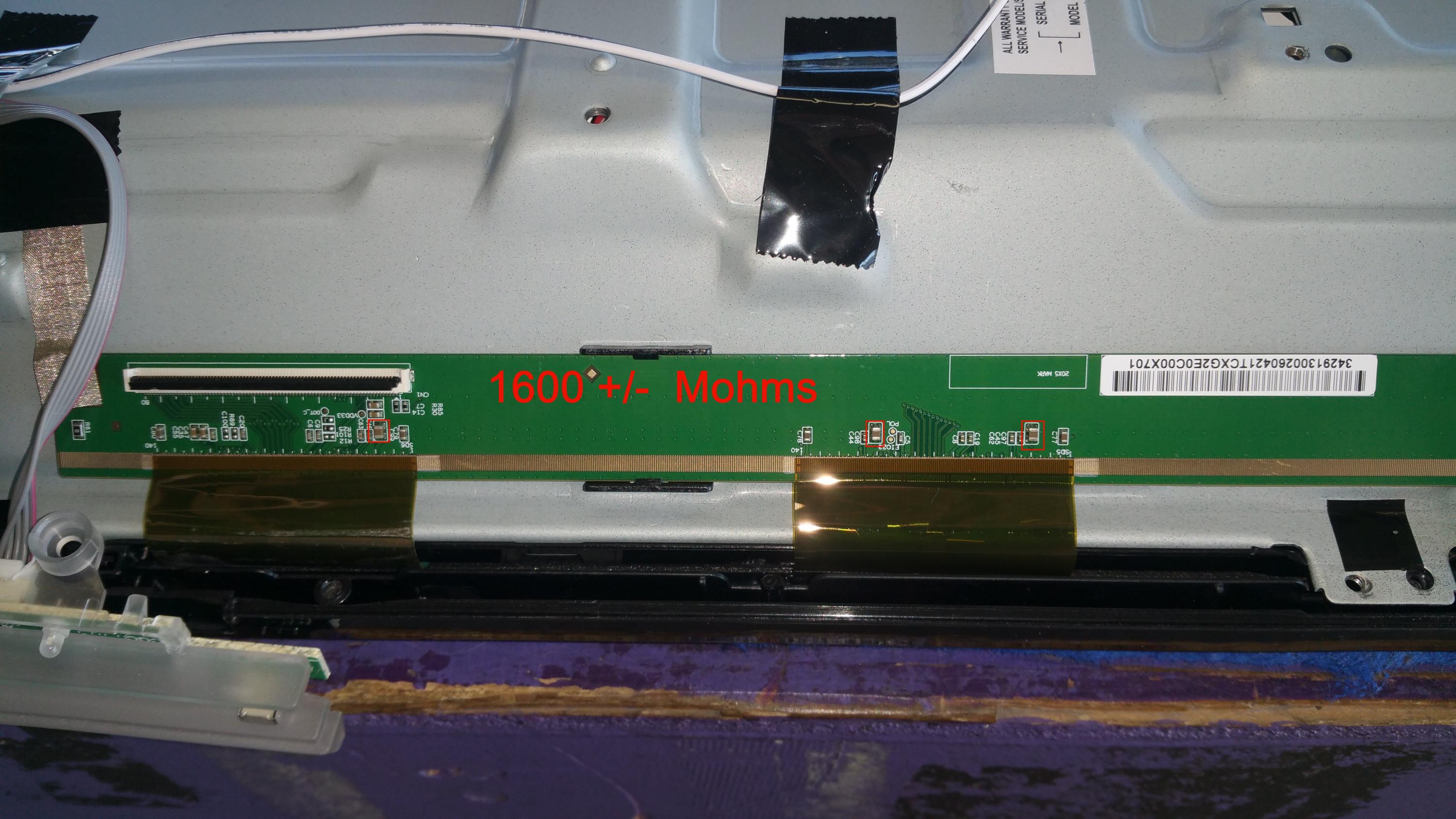

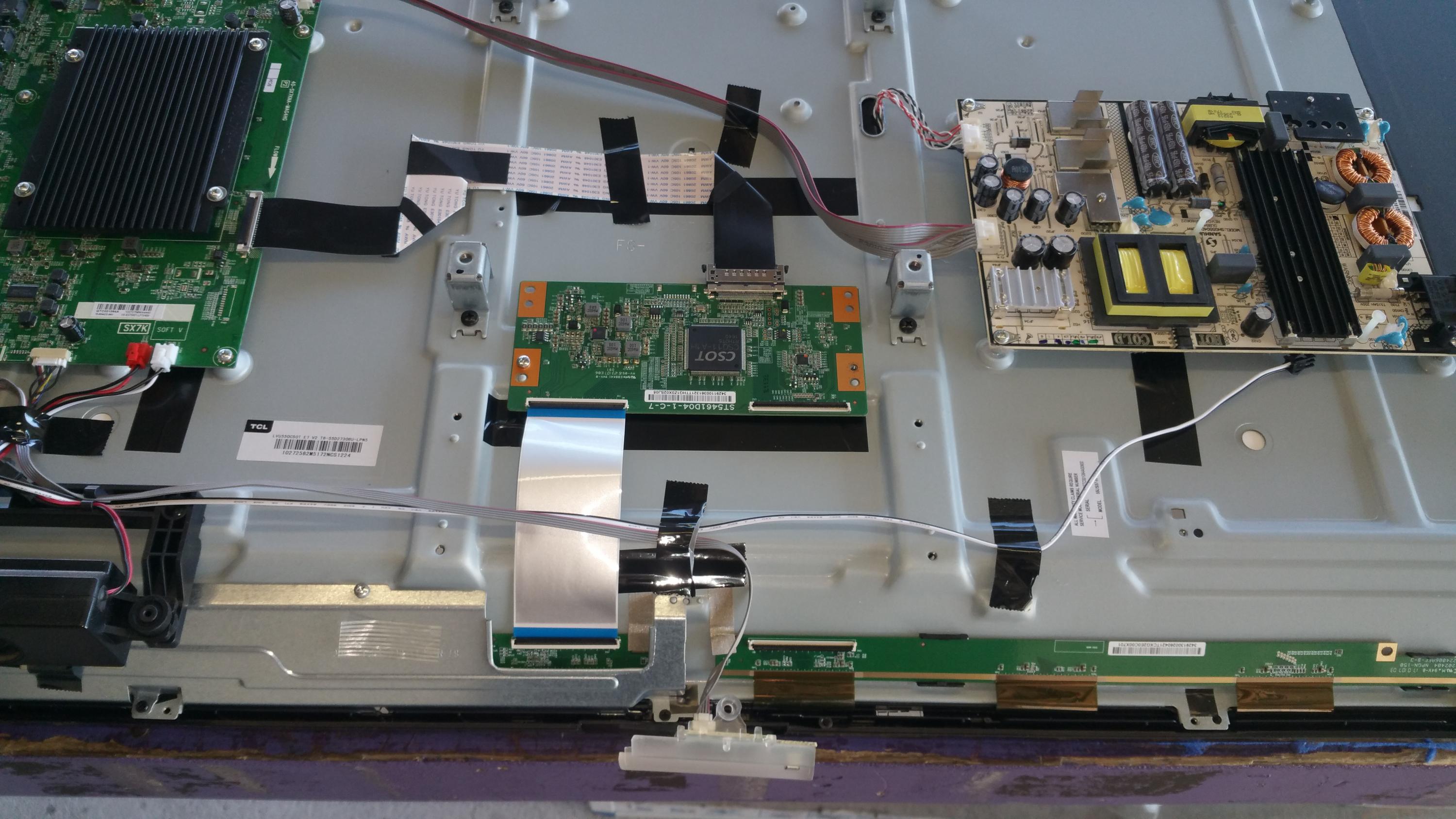

    Got a nice TCL in.. 55US57..
    I have dealt with a few of these, but there issues were backlights..
    This one, the backlights are fine, I just get no display at power up..
    I have found that, if I take off the right connector that goes from the TCON to the Panel Boards, I get display on the Left side of the TV...
    That tells me either it's a bad TCON (hope hope) or a bad left side panel board...
    If it's the panel board, it's likely unfixable..
    Is there a way to determine conclusively whether it's the TCON or Panel Board???
    Other than replacing the TCON...

    What did you get when you did the other ribbon cable?
    • Michale32086
      • Nov 2011
      • 1453
      Re: TCL 55US57 Bad Tcon Or Bad Panel Boards
      Backlights.. no display on panel.. Sorry.. Meant to add that detail..
        https://www.badcaps.net/forum/attach...1&d=1574193881
        Start checking the RESISTANCE of those MLCC on that tab bonding board of the bad side.
          Awesome.. Thanx...
          Uh.. Forgive my ignorance. Can you circle an MLCC??
            Those brown tan caps.
              Checked the first three.. Marked..
              1600 Mohms +/- 10-20ish
                You need to check all of them.
                BTW, you meter can read 1600 Mega Ohms?
                  Will do... As soon as I get back to the shop.. Is that a normal correct reading for those?? 1600 +/-??
                  My meter says which I took to mean Mega Ohms
                  I'll get right back on it when I get to the shop..
                  Thanx for the replies..

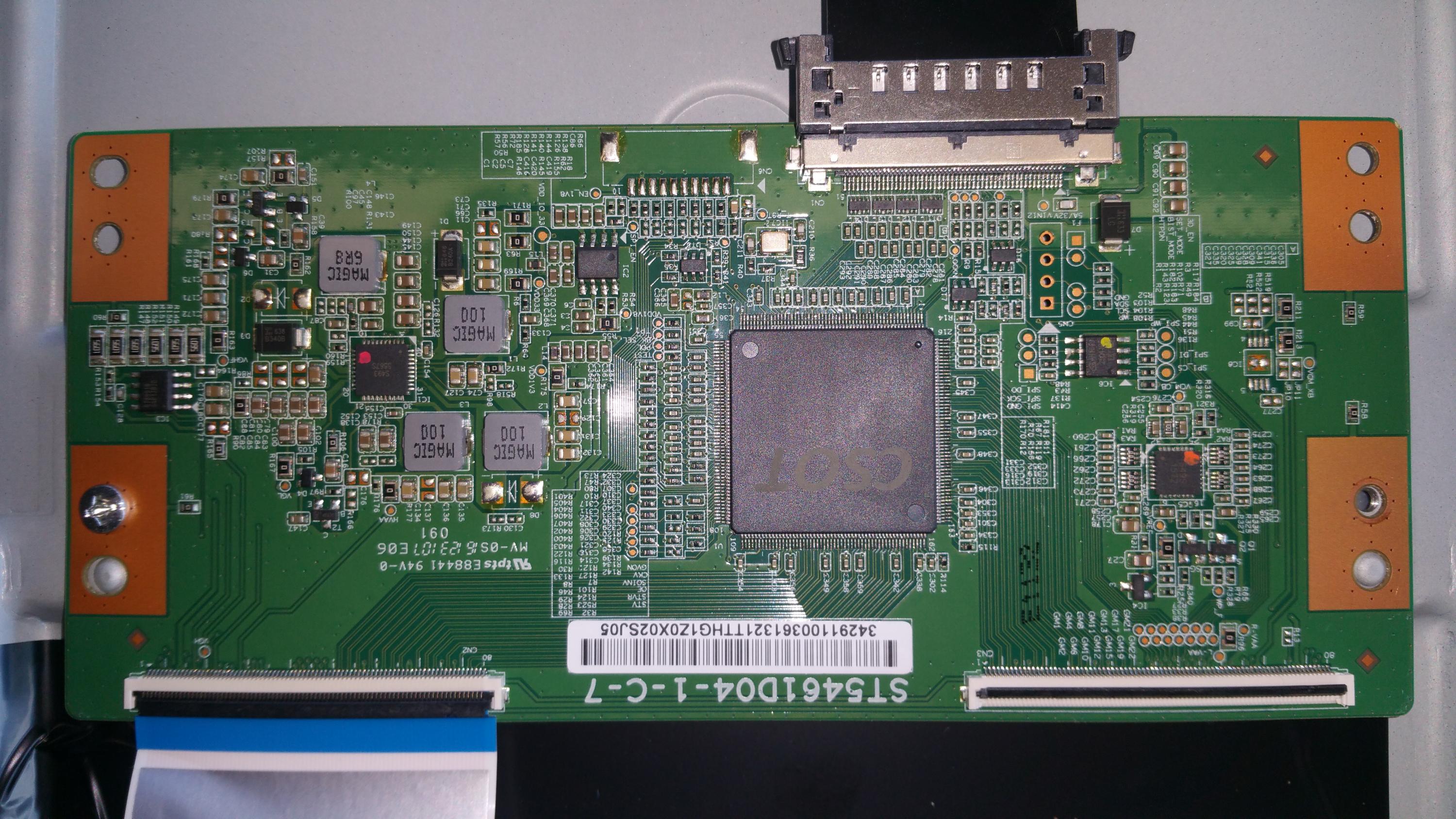

                    That might be a match, looks like it has the same part number: https://www.ebay.com/itm/4T-TCN550-C...cAAOSwzztdOxRt
                      Yea, the one I have is a 1-C-7... I found one on EBAY, but want to confirm that the TCON will fix it.. On the other hand, it's only about $25..
                        Looks like they both work, I thought they looked very similar: https://www.shopjimmy.com/tcl-4t-tcn...-con-board.htm
                          Yea, I am guessing it's likely a firmware difference..

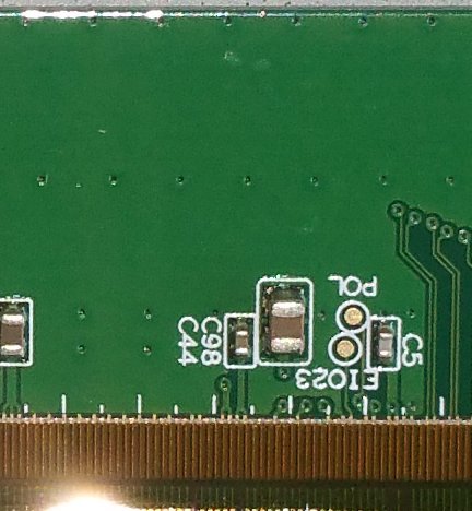

                          Question, are the MLCCs ALL of the tan caps?? Or just the larger ones I marked??
                            Probably all the ones that start with C.

                              OK, getting some different readings now..
                              With the + probe on the lower and the - probe on the upper, I get 7.5K +/-
                              With the - probe on the lower and the + probe on the upper, I get 10.05K +/-

                                  Do you have an idea of what I am looking for??
                                  Like a 0.0 reading means that cap is dead or something like that??
                                    I think 0 is dead short and too low is bad too.
