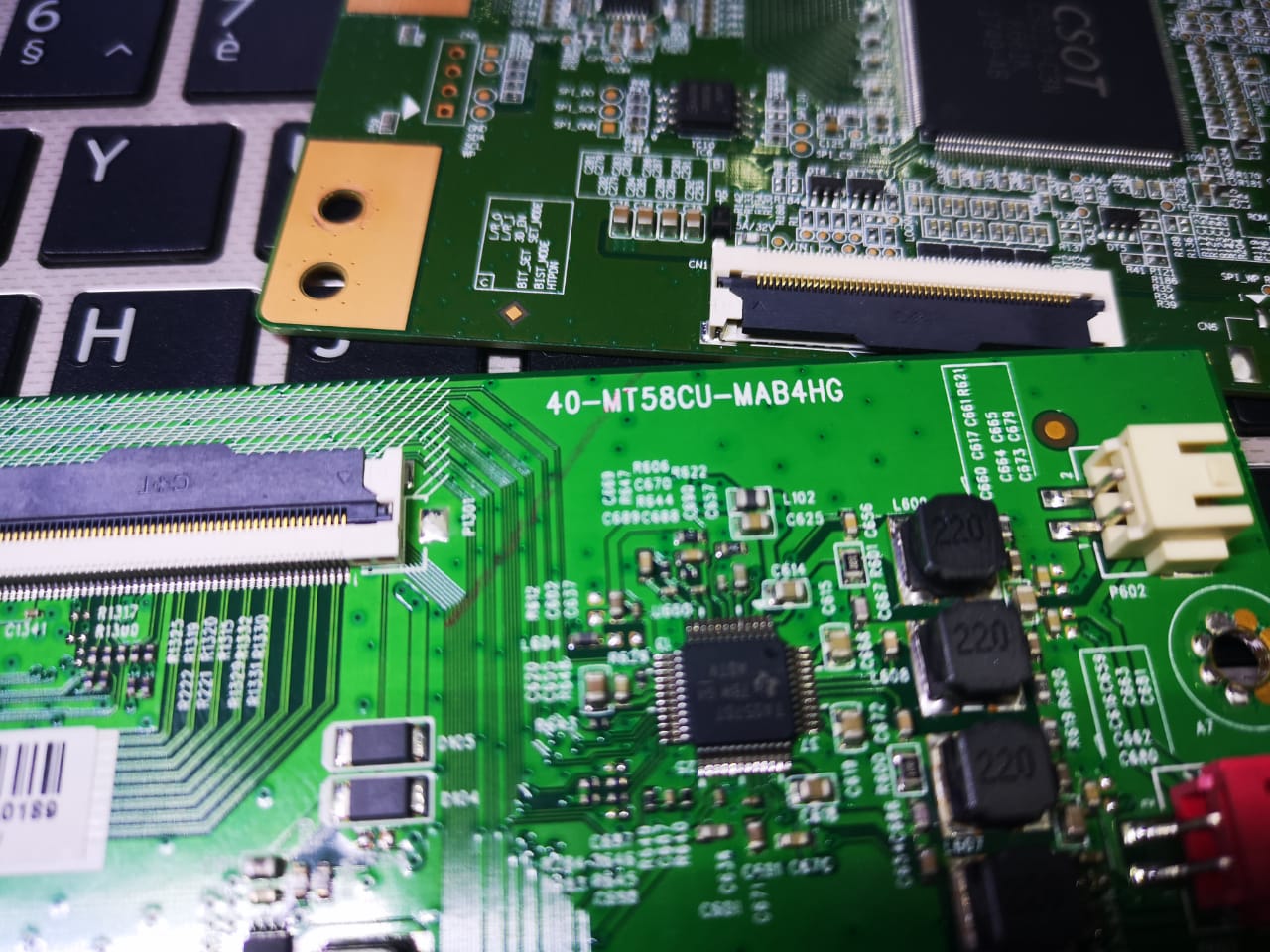

Thomson 55UC6006S Shutdown after loading android
  • medinfo
    • May 2016
    • 328
    • Morocco
    Thomson 55UC6006S Shutdown after loading android logo.

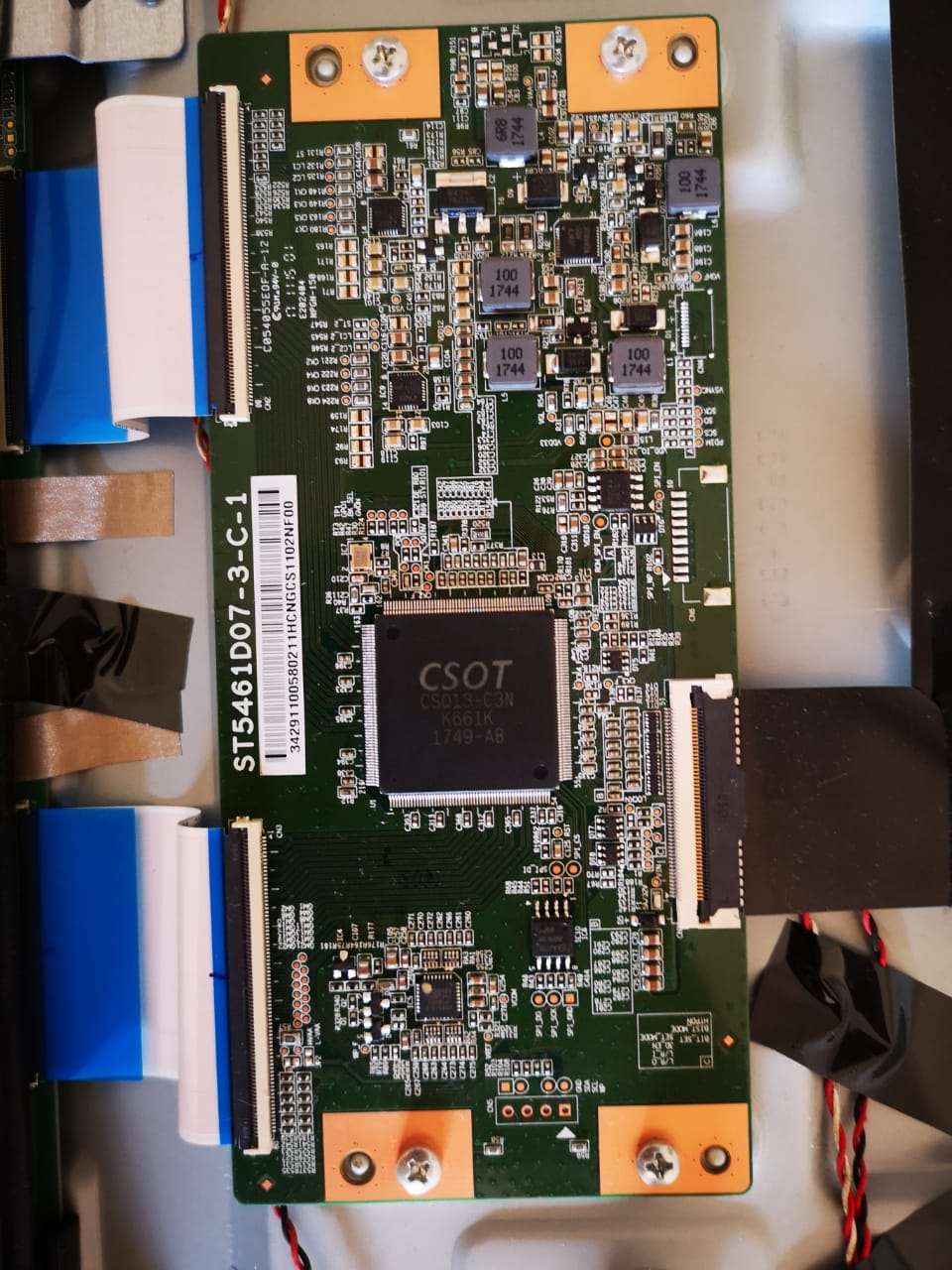

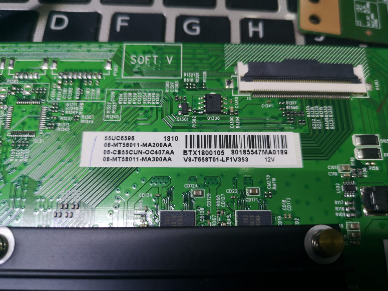

    Re: Thomson 55UC6006S Shutdown after loading android
    T-con : St5461d07-3-c-1
    motherboard : 55uc6596
    • vinceroger69
      • Mar 2012
      • 6714
      • uk
      the tcon has got two cables on the top can you remove one end and see if the set stays on if no refit and try the other side
      • medinfo
        • May 2016
        • 328
        • Morocco
        I removed both, and same problem

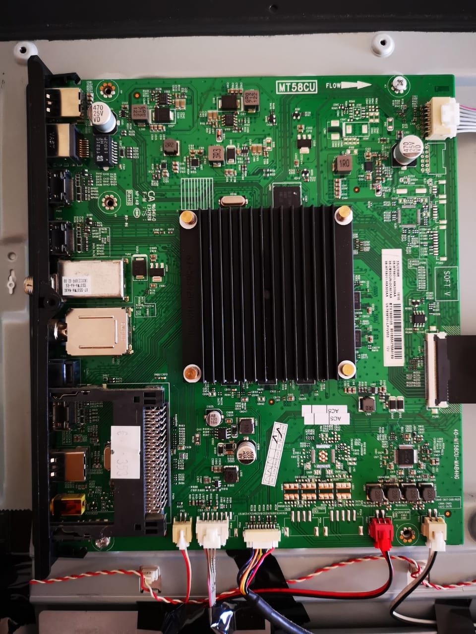

          if this was my set i would try a replacement mainboard as possible the firmware has issues hence the reboot maybe see what other more experienced users say first as mainboards are quite expensive and you need one that matches the stickers etc from your old mainboard
