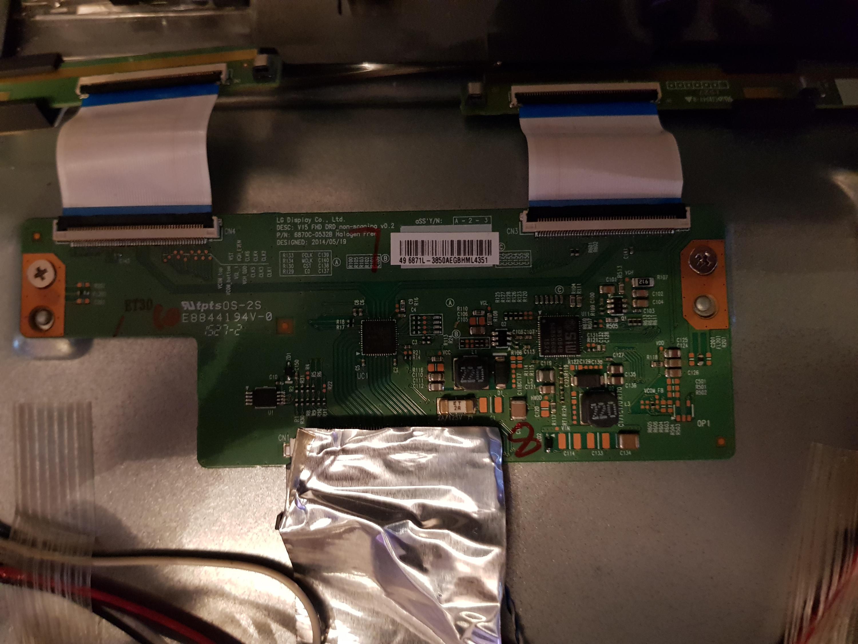

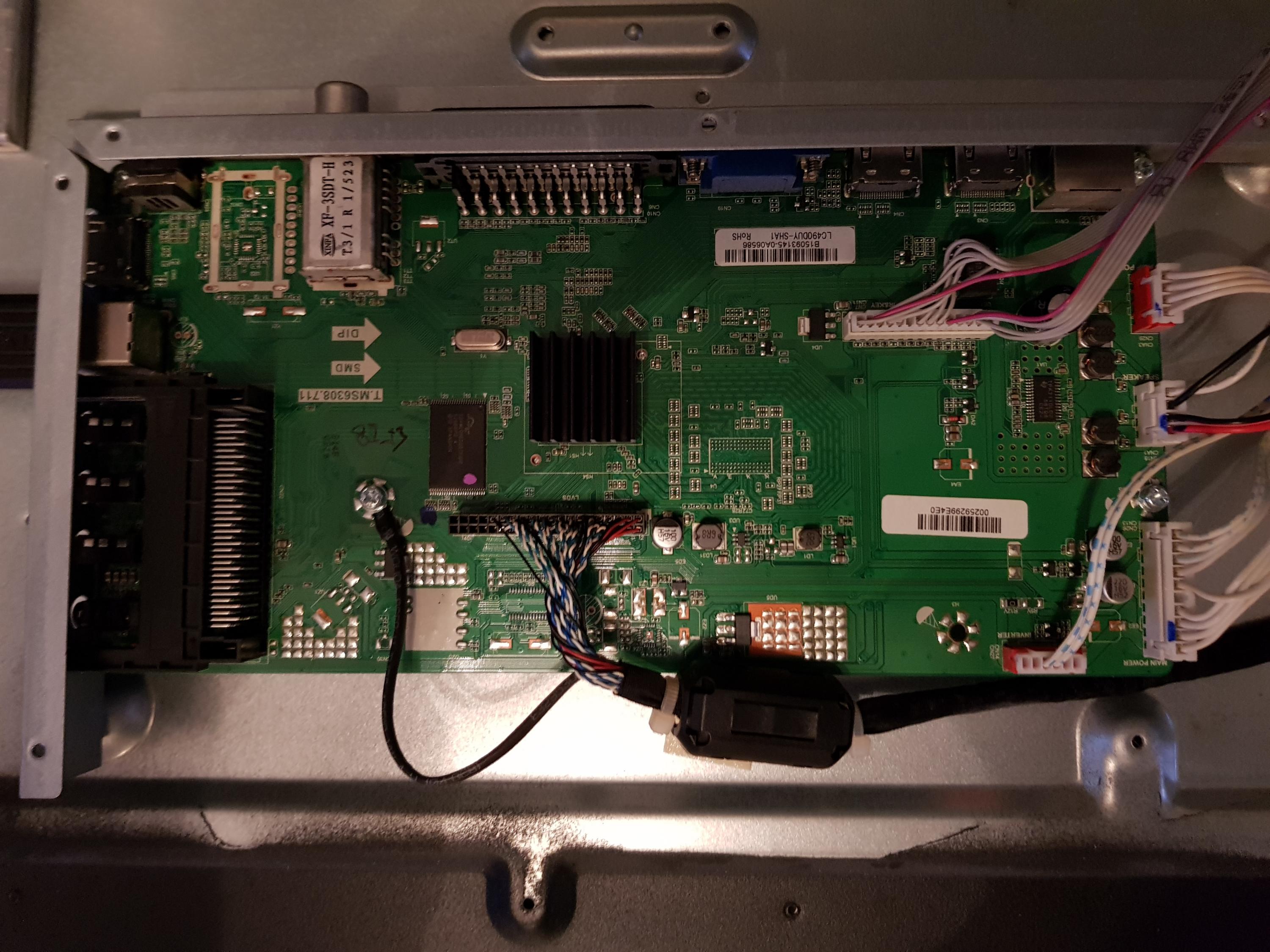

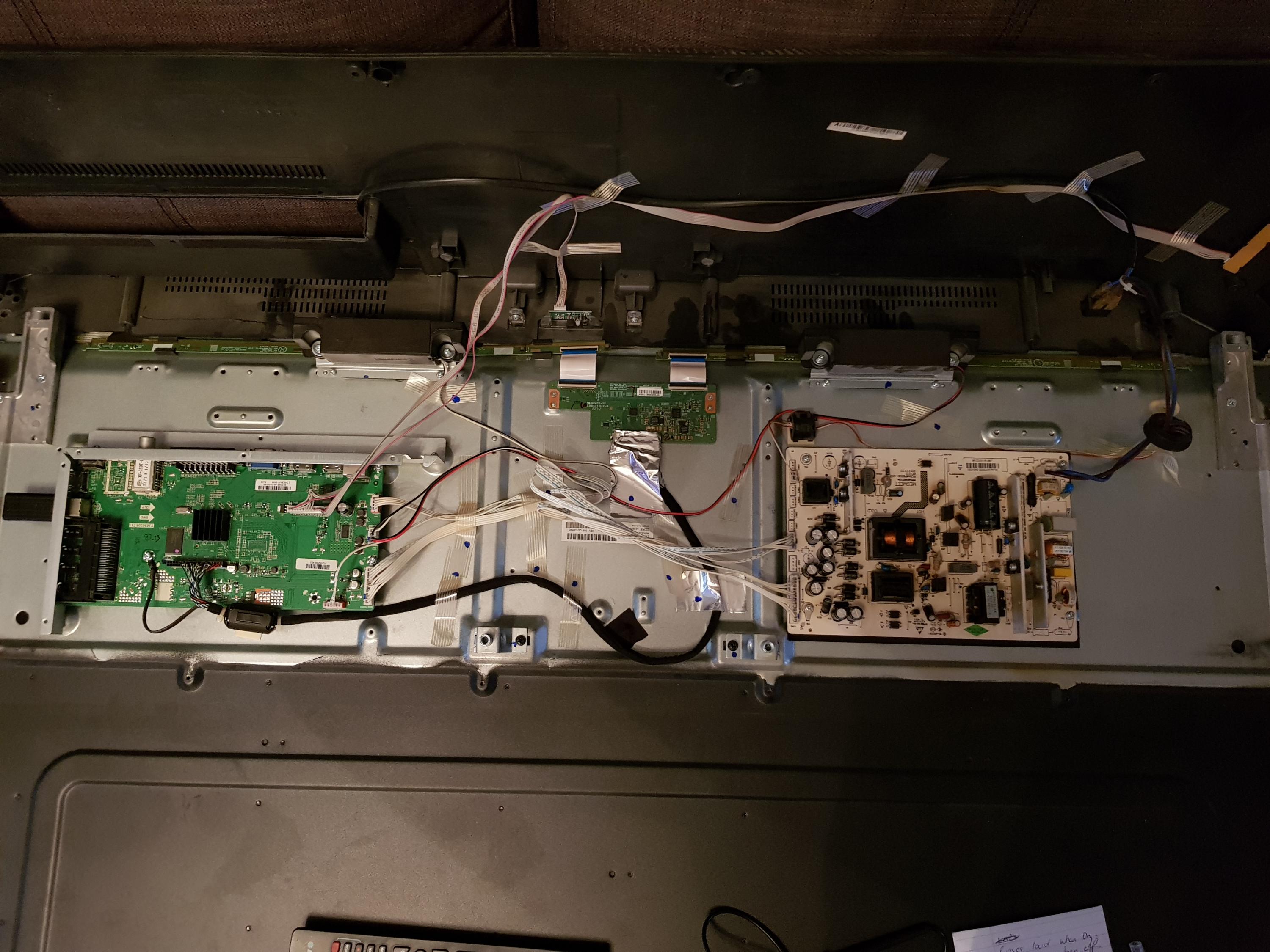

    Blaupunkt 49/235z, got this TV described as sound no picture, had a quick look, and backlights came on at first, but the LED inverter was buzzing very loudly, left TV on and after around 20 mins the backlights went out. Turning TV off and back on would bring them back on for a while but always went off sooner or later.

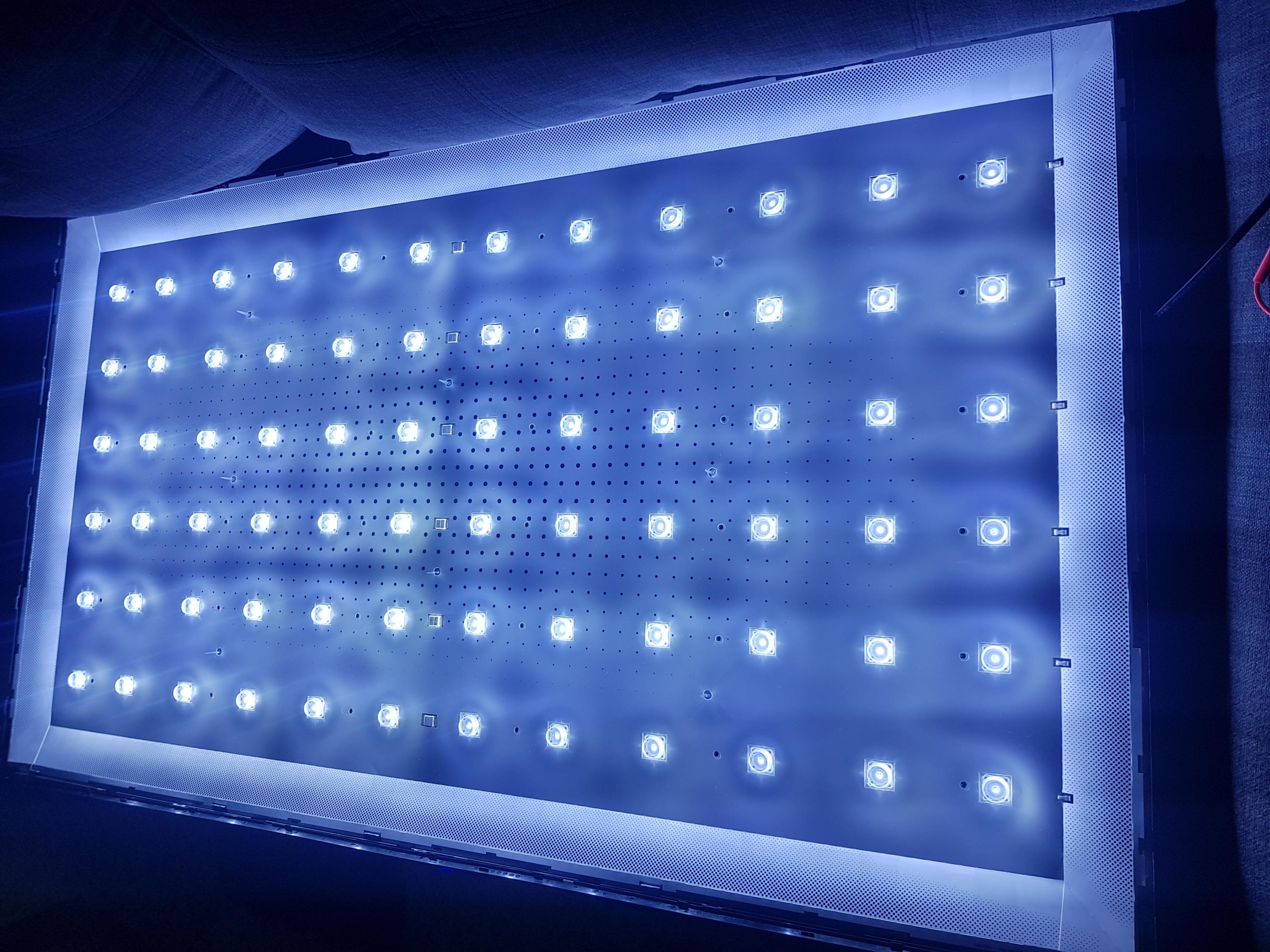

    I stripped the TV right down, tested the LED strips, both as strips and single LEDs and all of them illuminate with tester.

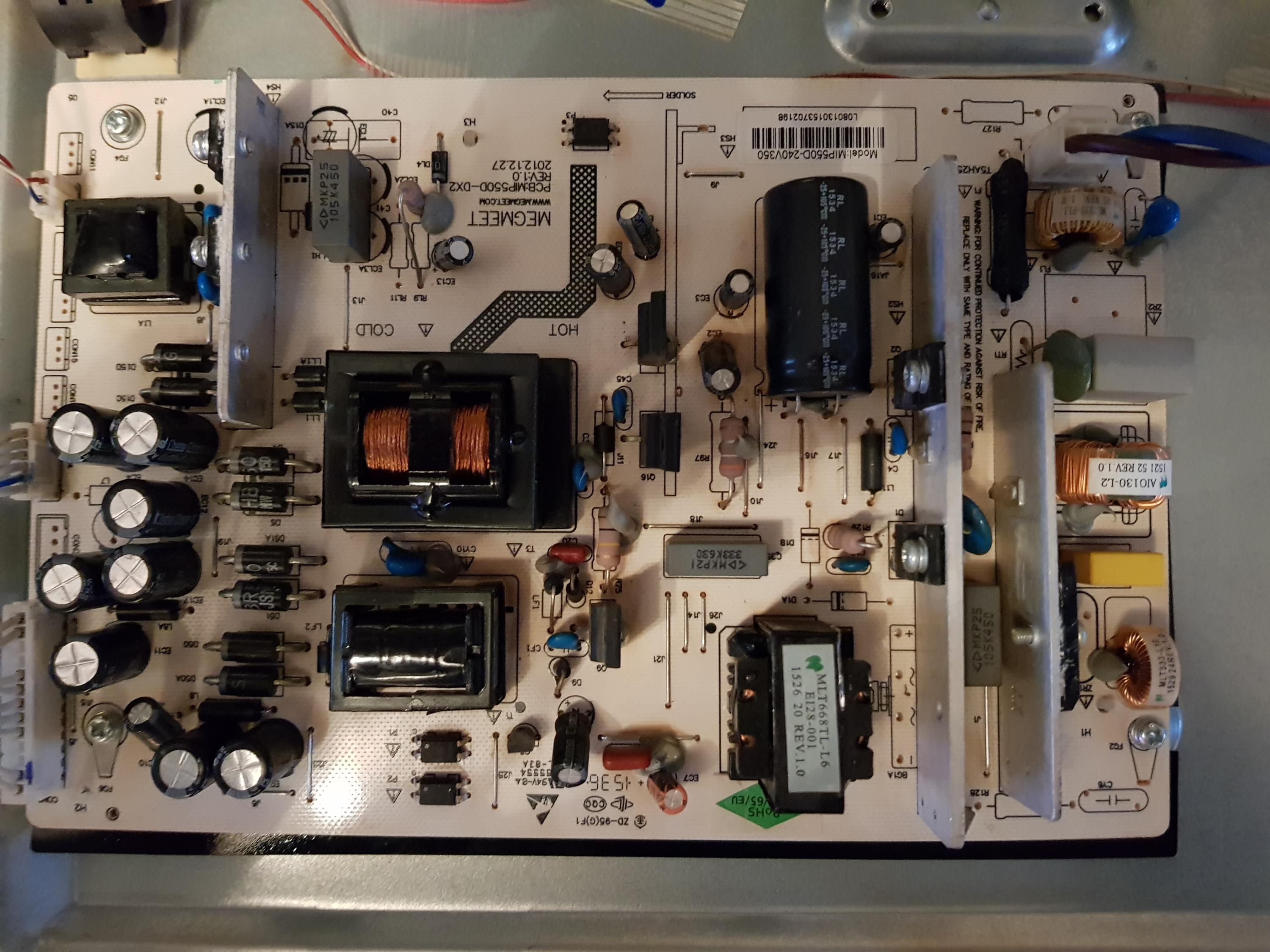

    I took readings from PCB for LEDS, which were
    LED+ 231v (when backlights were illumiated)
    LED+ 132v (times when LEDs had gone off)
    As mentioned when LEDs where illuminated, the inverter was very noisy and loud, when the LEDs wont come on, this is silent.
    Other readings from PCB are -
    +12v 12.40v
    SGND
    +5v 5.21v
    +5vSB 5.22v
    PSON 4.38v
    SGND
    +12v 12.40v
    BK 5.19v
    ADJ 4.66v
    SGND

                    As already said by others it looks like a led problem. Led testers don't test the leds at full current which is why led testers can operate the led strings. Post #8
                    • Bloopeta
                      • Jun 2018
                      • 526
                      • United Kingdom
                      Re: Blaupunkt 49/235z Backlight Inoperative
                      Thanks for the reply, so is there a way I can test and determine which LEDs are at fault please?

                        If you don't have a current limiting power supply you can use a pair of AA batteries as in this thread https://www.badcaps.net/forum/showth...ght=AA+battery

                                  Have now tried, with a pair of AA batteries, all LEDs illuminate, and im now partially blind lol

                                    possibly something heat related but what? is a new power supply cheap? maybe worth ruling it out you could always resell the board on ebay etc and get your money back if it does not fix the issue
                                    • Bloopeta
                                      • Jun 2018
                                      • 526
                                      • United Kingdom
                                      Ive actually swapped out the PSB this morning as I picked one up for pennies, just to rule it out, no change

                                        sounds like a led issue then maybe a led failing when hot if thats possible, are all the led strips the same number if so maybe buy one strip and swap each strip in turn?
