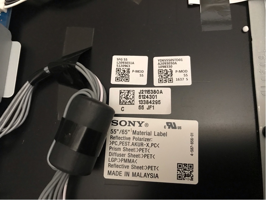

                      Re: sony 55xd9305 cycling red/green/blue
                      Do you have the LCD panel model number?
                          thats whats on the back
