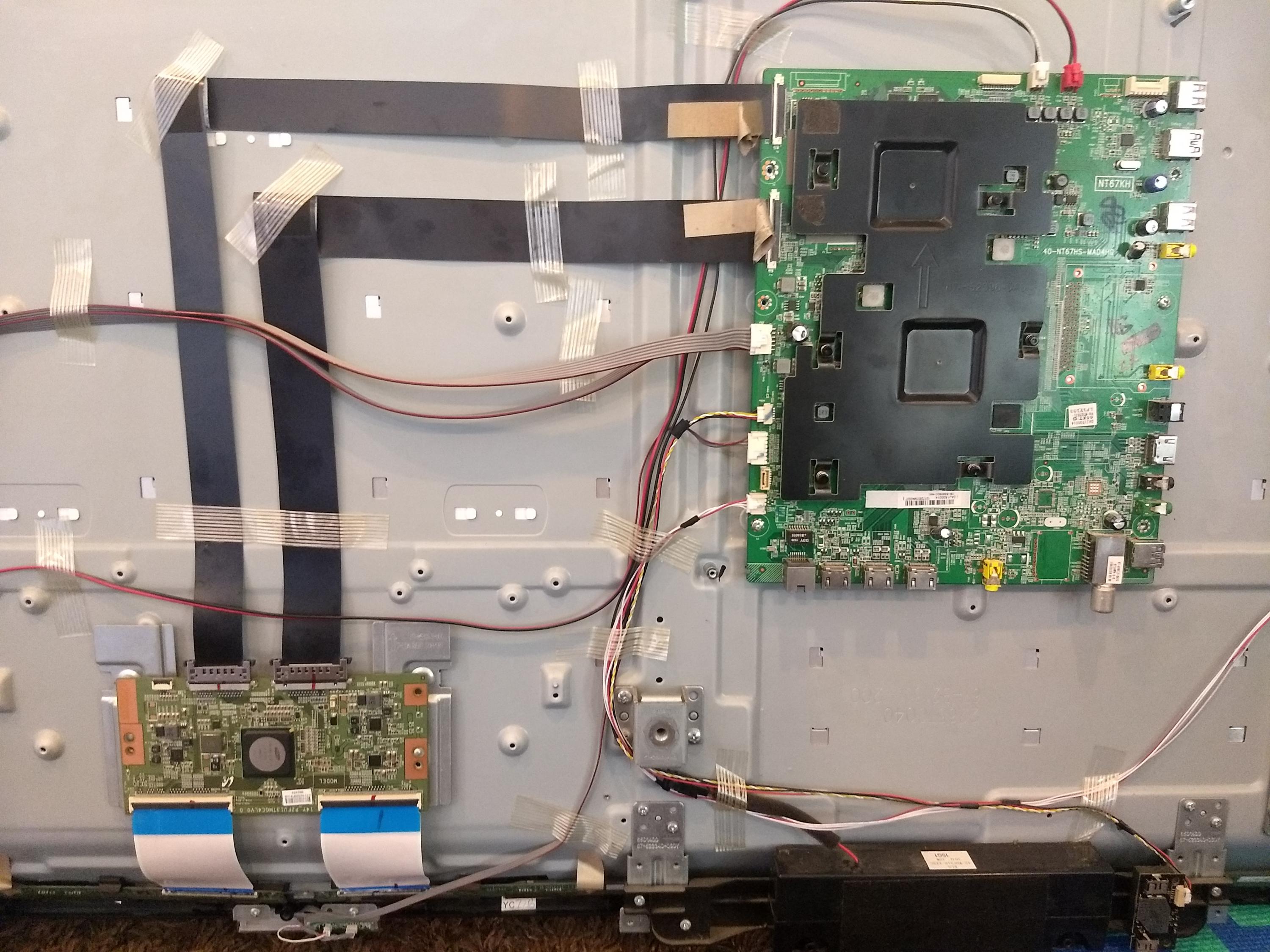

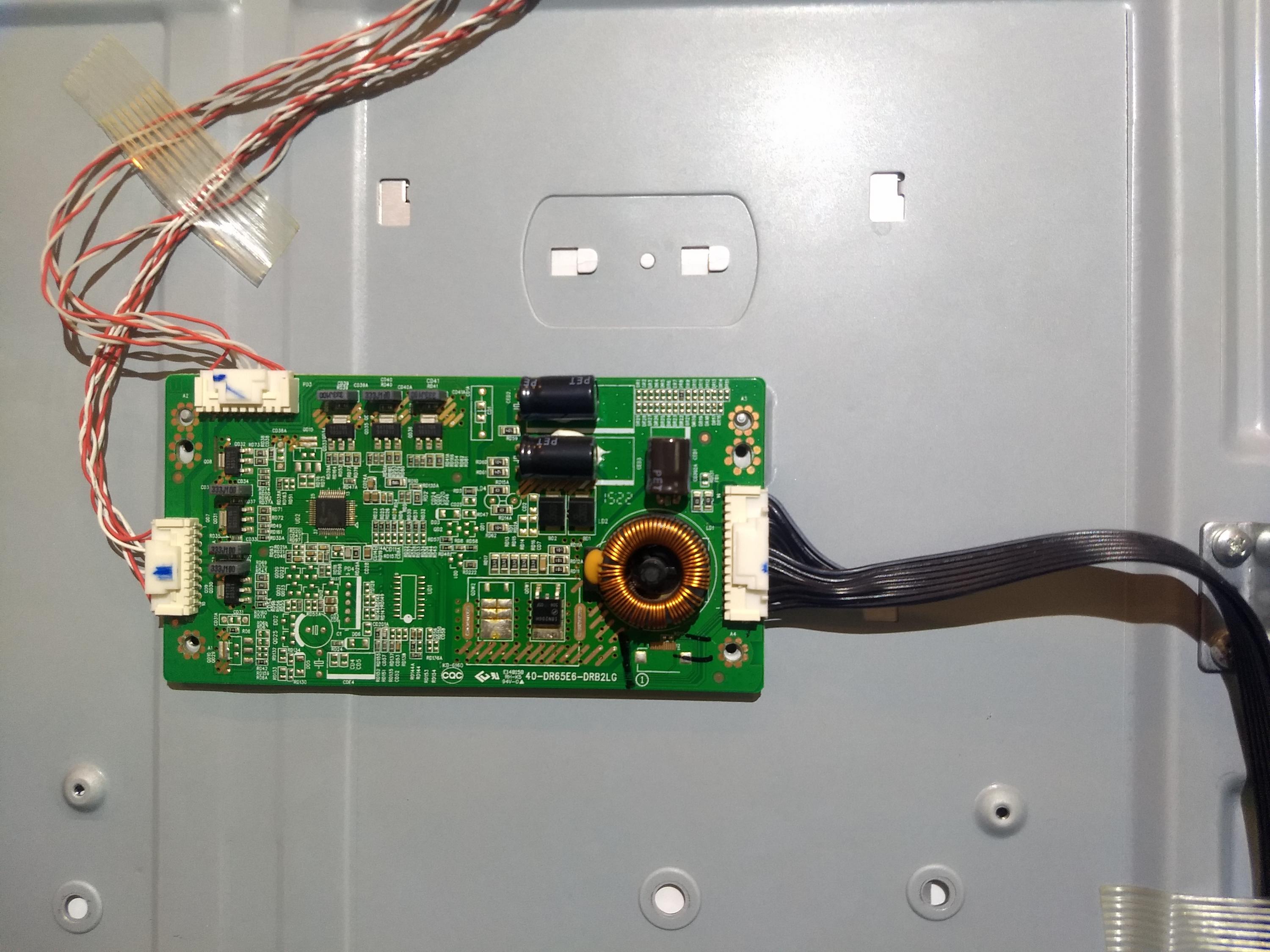

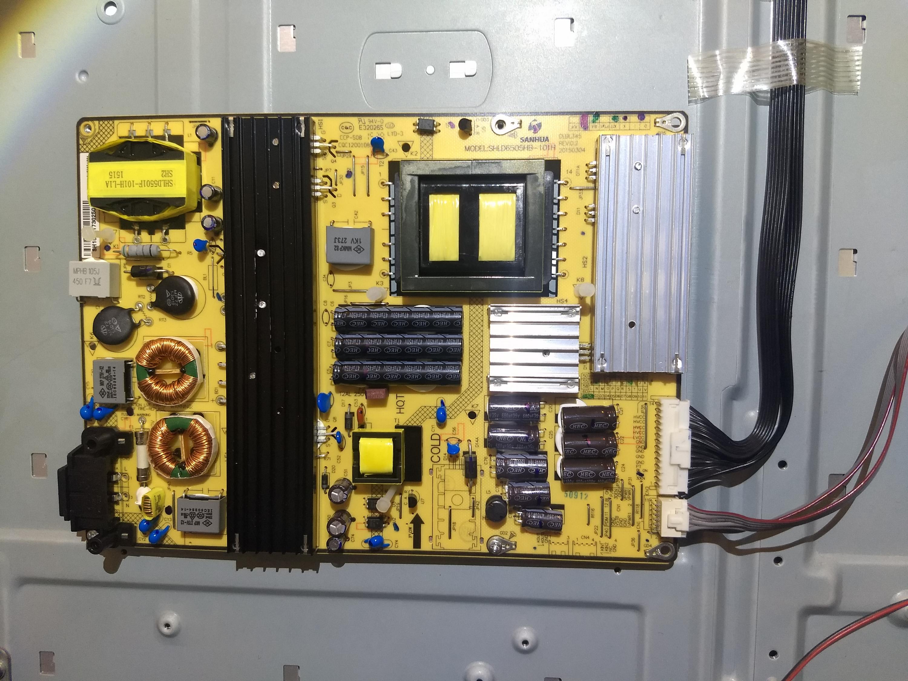

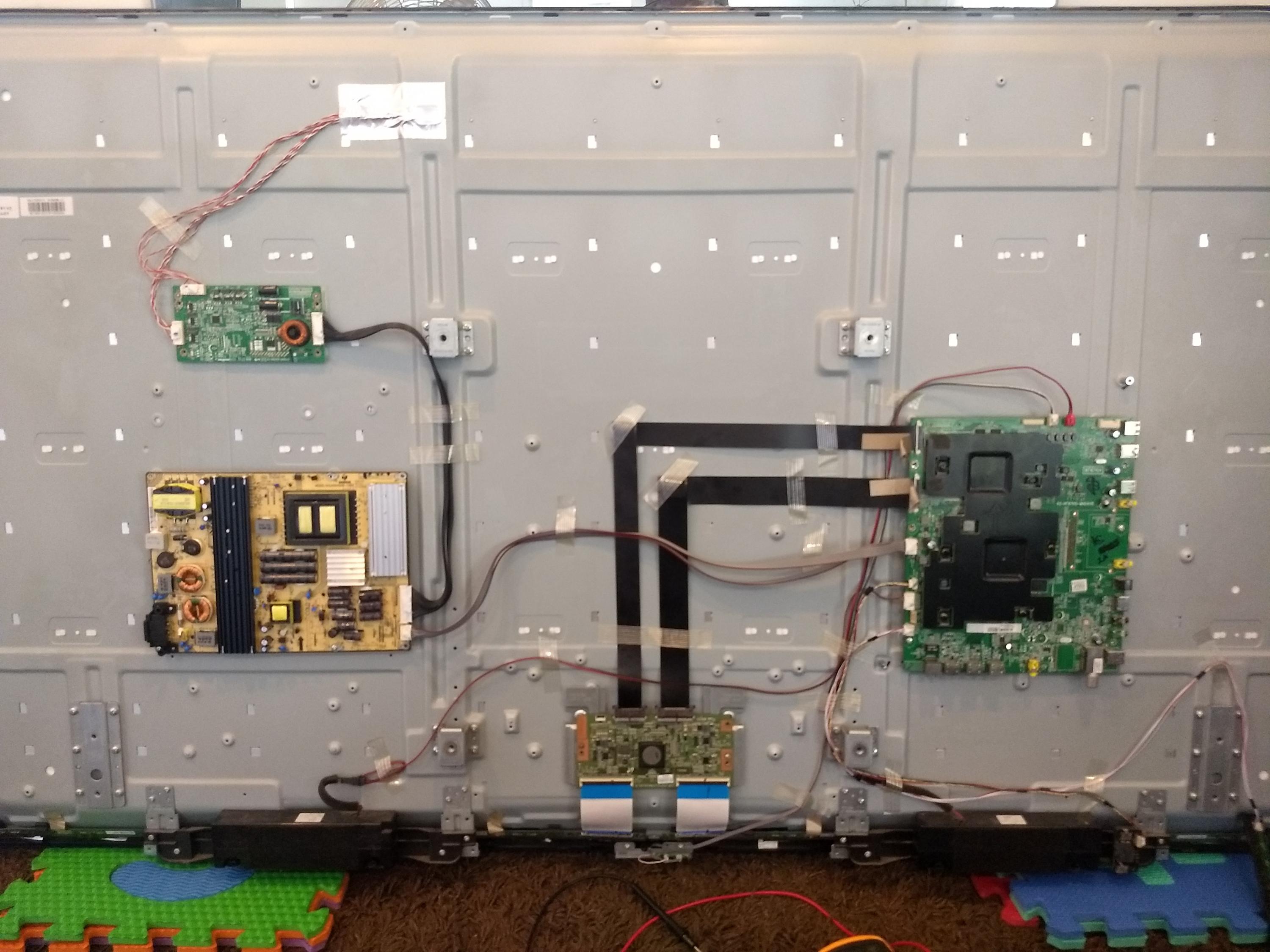

    Pics attached.
    Any help would be much appreciated.

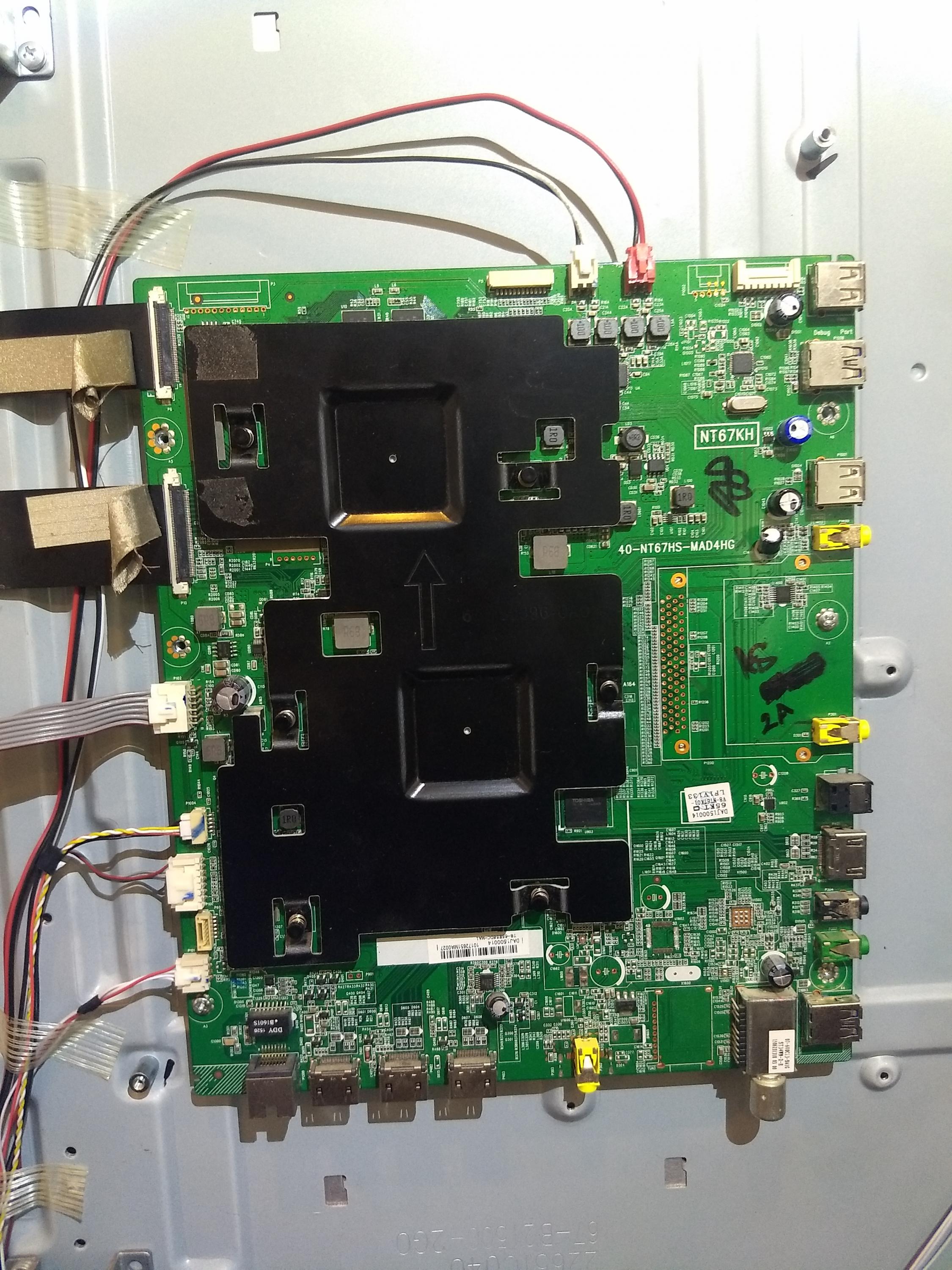

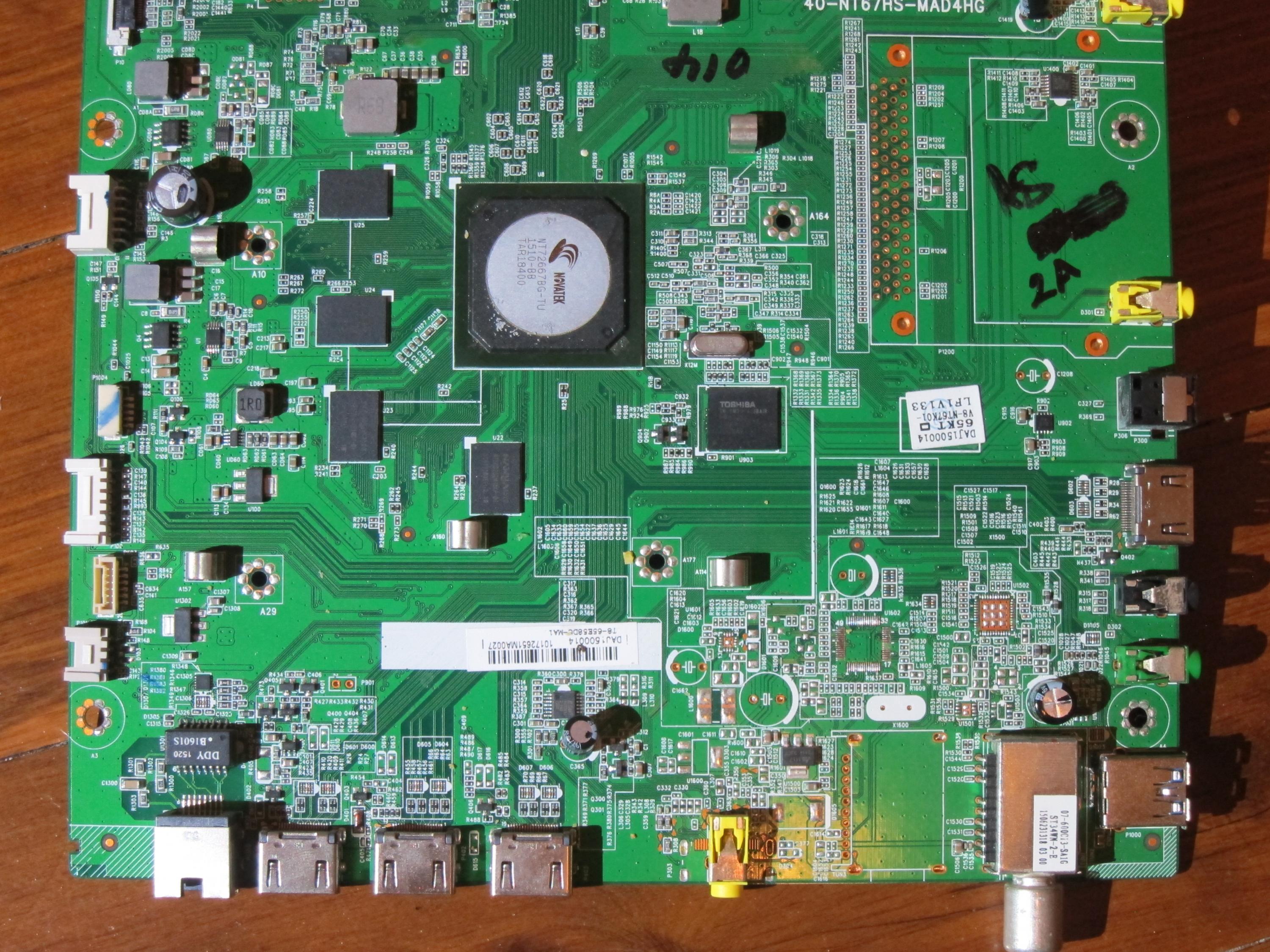

      Here is a pic of the Mainboard without the heatsink cover.

          12V for the tcon usually is switched through the main board from the power supply on one of the edges of the LVDS cables. You can usually figure out which edge by ohming the tcon fuse with one of the edges and usually passes through more than 1 pin. You can trace this through the main board where it should go through a FET switch. Could be a BGA failure on the processor not sending the tcon on signal to the FET. Can test this by heating the processor with a hair dryer before plugging in. Also check for 12V from the power supply going to the main board.

            Yeah I can't see any, which is odd (see the list of voltage readings from the original post). In the absence of a dedicated 12v signal going direct from the pcb to the MB, is it possible that the mainboard could convert the 23.6v or the 3v into 12v?

              Re: Backlights but no picture - No 12v to Tcon board

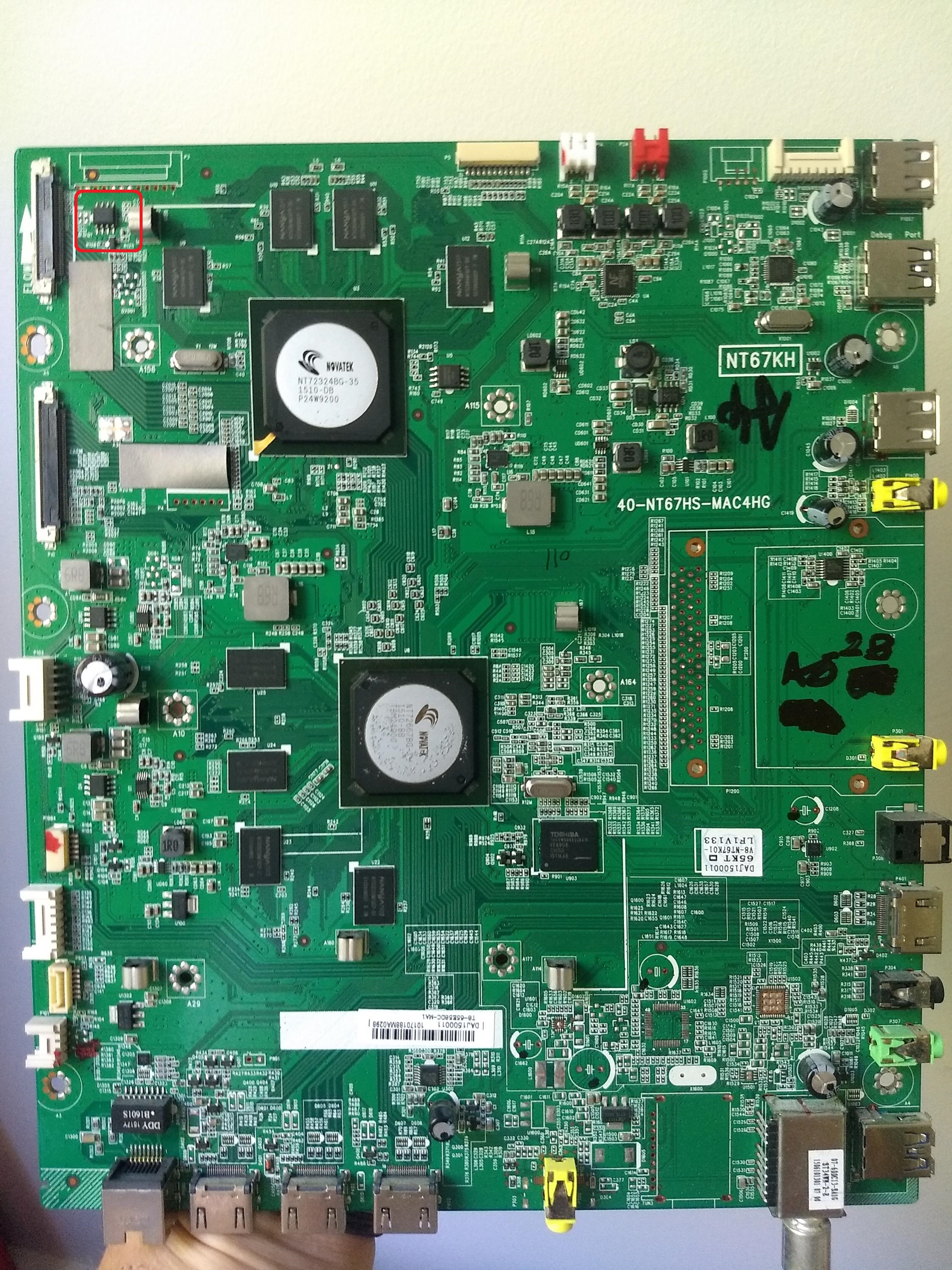

              It will be 24v -> 12v. You could check the coils (grey squares) for a short to ground, the power rails for the processors and memory will be low but it's possible the 12v might have a short.
                https://www.badcaps.net/forum/attach...1&d=1571549151
                Can we get picture that is in focus? Right now I cannot read the designators on the board.

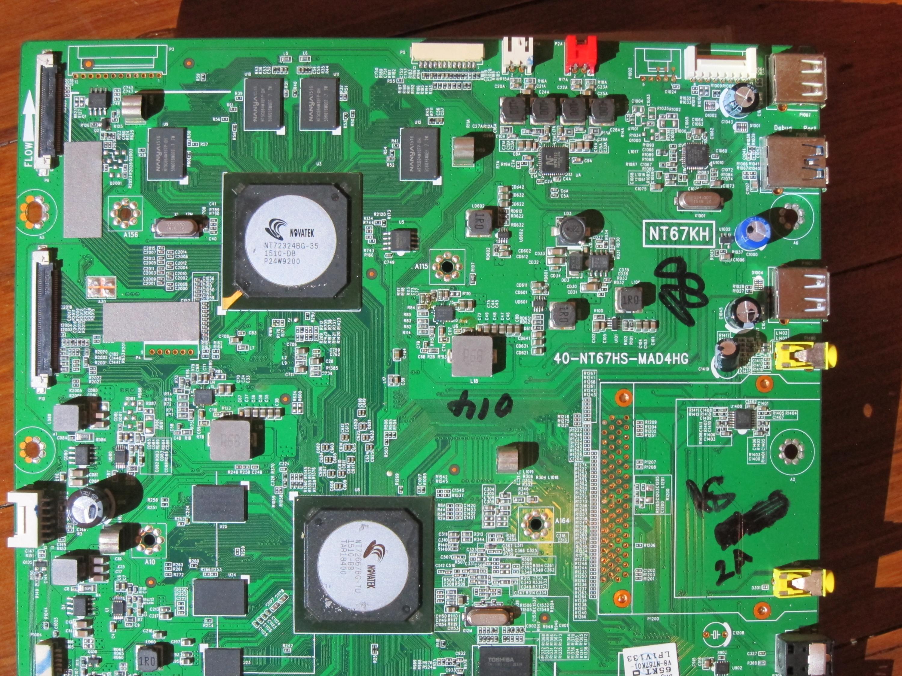

                  Hi BudM
                  Sorry. My mobile is hopeless with close up detail. I've retaken using a proper camera and split it into two photos so you get clearer detail. Thanks.
                    Unfortunately no shorts to ground in the coils.
                    There is a 6R8 coil on the mainboard reading 12v. It also has a test point on the flip side that says 12v. But somehow that isn't getting to the Tcon.
                        What is the part number given on the IC
                        • Stuckster
                          • Oct 2019
                          • 40
                          Hi. Thanks for your help! It should be much clearer on this image.
                          https://www.badcaps.net/forum/attach...6&d=1571657047

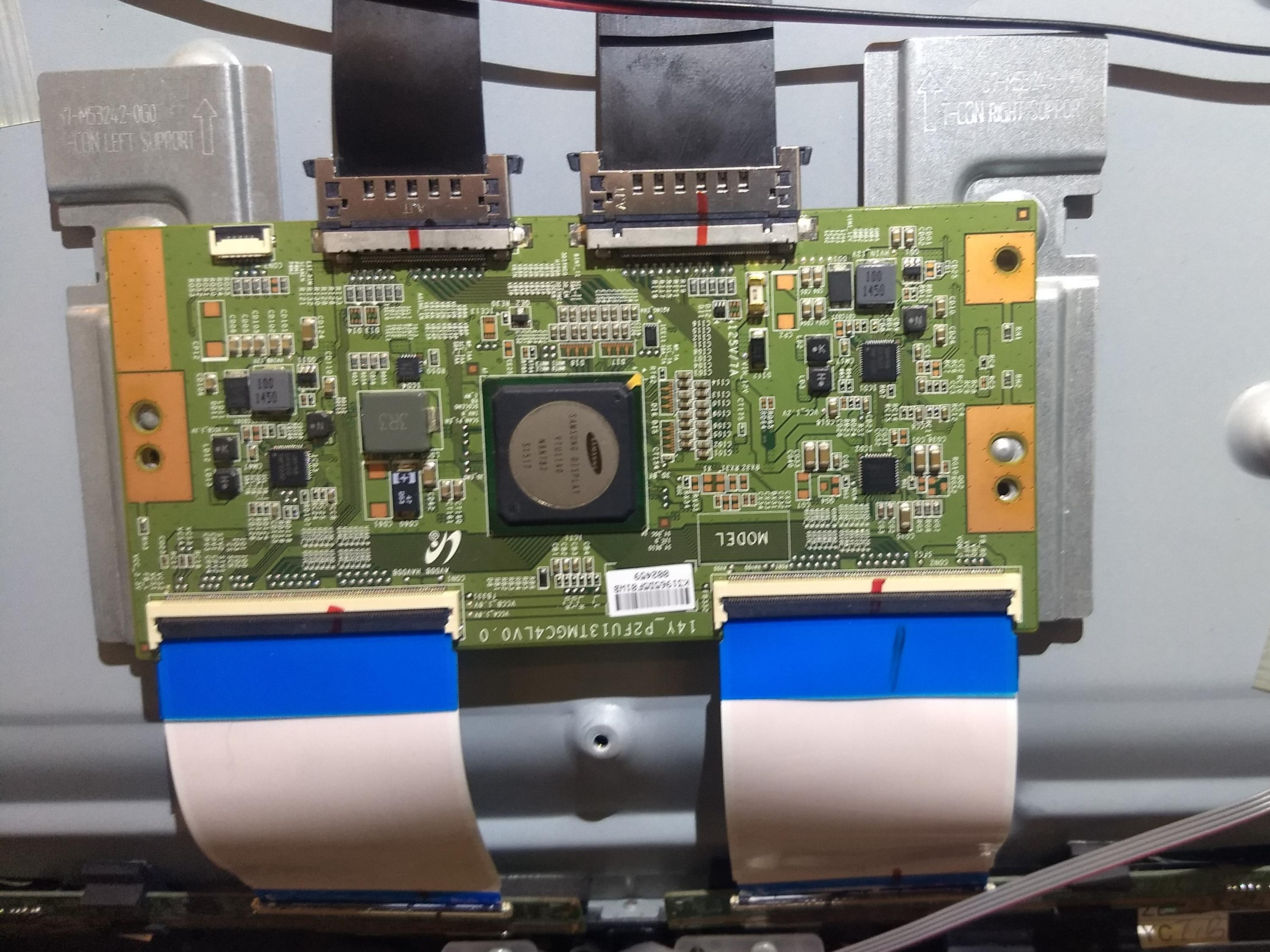

                            Meter in diode mode check the small ceramic capacitors on t-con, see if any read short or beep if you have beep function on meter, kind of unlikely tho, see if tcon fuse is blown, do you get the 12 volt with the lvds cable disconnected?
                              Check for voltage on each side of tcon fuse black probe on chassis ground if you haven't yet.
                                    Unfortunately it's not. It's the numbers written on top of the IC I'm asking for.
                                      Tcon fuse is good. I believe the 12v is sent to the Tcon via the 51pin LVDS cable. So I would presume that there will still be no 12v with the LVDS unplugged, but I will test it anyway.

                                      • Stuckster
                                        • Oct 2019
                                        • 40
                                        Hey. Sorry. I can see 2 or 3 smaller ICs on the board. Do you need to know the numbers printed on each of them? If not, could you identify the specific one you are referring to?
