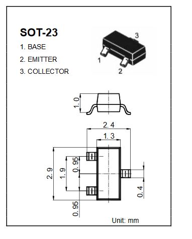

    Emitter pin (Top) is connected to R125/C181
    Collector pin (Middle pin) is connected to R126
    Base is the bottom pin.
    Thanks.
    Emitter pin = 0.0v ON, 0.0v OFF
    Collector pin = 11.5v ON, 0.0v OFF
    Base pin = 0.0v ON, 0.0v OFF

      This may be the layout for the smd transistor. The readings given for the base does not appear correct.

          BASE is not being driven.
          Check the resistance between GND and the Base pin.
            #45
            Re: Backlights but no picture - No 12v to Tcon board
            Resistance between GND and the Base pin is 3.3 measured at 200k Ohms.
