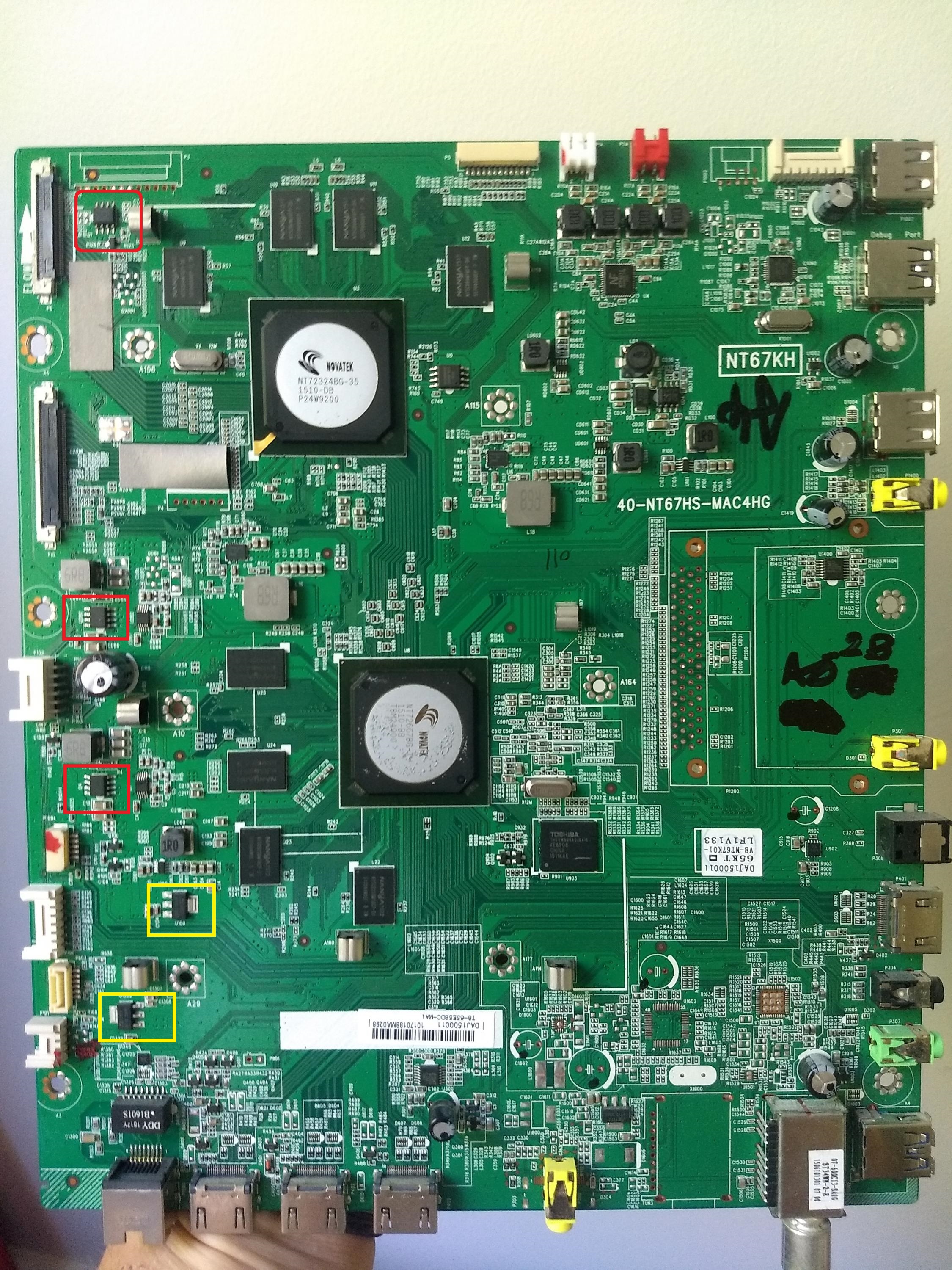

      Sorry, my mistake. Posted the wrong picture. Can you give the numbers on the two IC's in the red boxes. The yellow boxes have voltage regulators. Can you measure the voltage on the 3 pins of each.
      • Stuckster
        • Oct 2019
        • 40
        Re: Backlights but no picture - No 12v to Tcon board
        No problem. It's tricky to read but I think they are
        Top IC
        P3056LS
        15 10
        Middle IC
        4832
        GA5614
        Bottom IC
        4832
        GA5614
        • Stuckster
          • Oct 2019
          • 40
          Top VR
          Top pin = 0.0v
          Middle pin = 3.3v
          Bottom pin = 5.1v
          Bottom VR
          Top pin = 5.1v
          Middle pin = 3.3v
          Bottom pin = 0.0v
            Can you give the voltages on the IC pins. I suspect one of them may have the 12V but is not switching through to the Tcon.
            • dick_barton
              • Aug 2015
              • 6642
              • Wales
              Originally posted by Stuckster
              Top VR
              Top pin = 0.0v
              Middle pin = 3.3v
              Bottom pin = 5.1v
              Bottom VR
              Top pin = 5.1v
              Middle pin = 3.3v
              Bottom pin = 0.0v
              They look fine and provides the 3V3 supply to other IC's

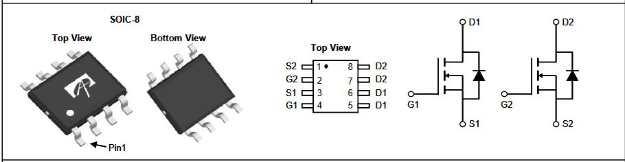

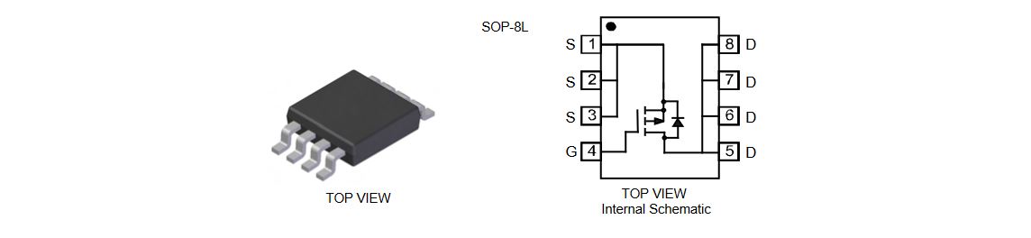

                    Can you give the IC name and pin numbers 1 to 8 as shown in the images which makes reading easier.
                    • Stuckster
                      • Oct 2019
                      • 40
                      #30
                      Sure.
                      SOP-8L (top)
                      1. S - 11.9
                      2. S - 11.9
                      3. S - 11.9
                      4. G - 11.9
                      5. D - 0.0
                      6. D - 0.0
                      7. D - 0.0
                      8. D - 0.0
                      SOIC-8 (middle)
                      1. S2 - 1.4
                      2. G2 - 3.2
                      3. S1 - 0.0
                      4. G1 - 3.5
                      5. D1 - 1.1
                      6. D1 - 1.1
                      7. D2 - 23.7
                      8. D2 - 23.6
                      SOIC-8 (bottom)
                      1. S2 - 9.9
                      2. G2 - 12.7
                      3. S1 - 0.0
                      4. G1 - 2.3
                      5. D1 - 9.9
                      6. D1 - 9.9
                      7. D2 - 23.7
                      8. D2 - 23.7
                      Hope I've got them right.

                        I believe the gate voltage should be at least 1.5V lower than the Source voltage so it looks as though the IC is not being switched on to allow the 12V through to the Drain which is probably the 12V supply for the tcon. You can check this out. With the set switched off check the resistance between the fuse on the Tcon and the Drain of the P3056LS
                        Could you also check the resistance between the Gate and Sourse and Gate and Drain.
                        • Stuckster
                          • Oct 2019
                          • 40
                          #32
                          Just realised I made a small typo. Gate should be 11.5 (not 11.9)
                          P3056LS
                          1. S - 11.9
                          2. S - 11.9
                          3. S - 11.9
                          4. G - 11.5
                          5. D - 0.0
                          6. D - 0.0
                          7. D - 0.0
                          8. D - 0.0
                          • Stuckster

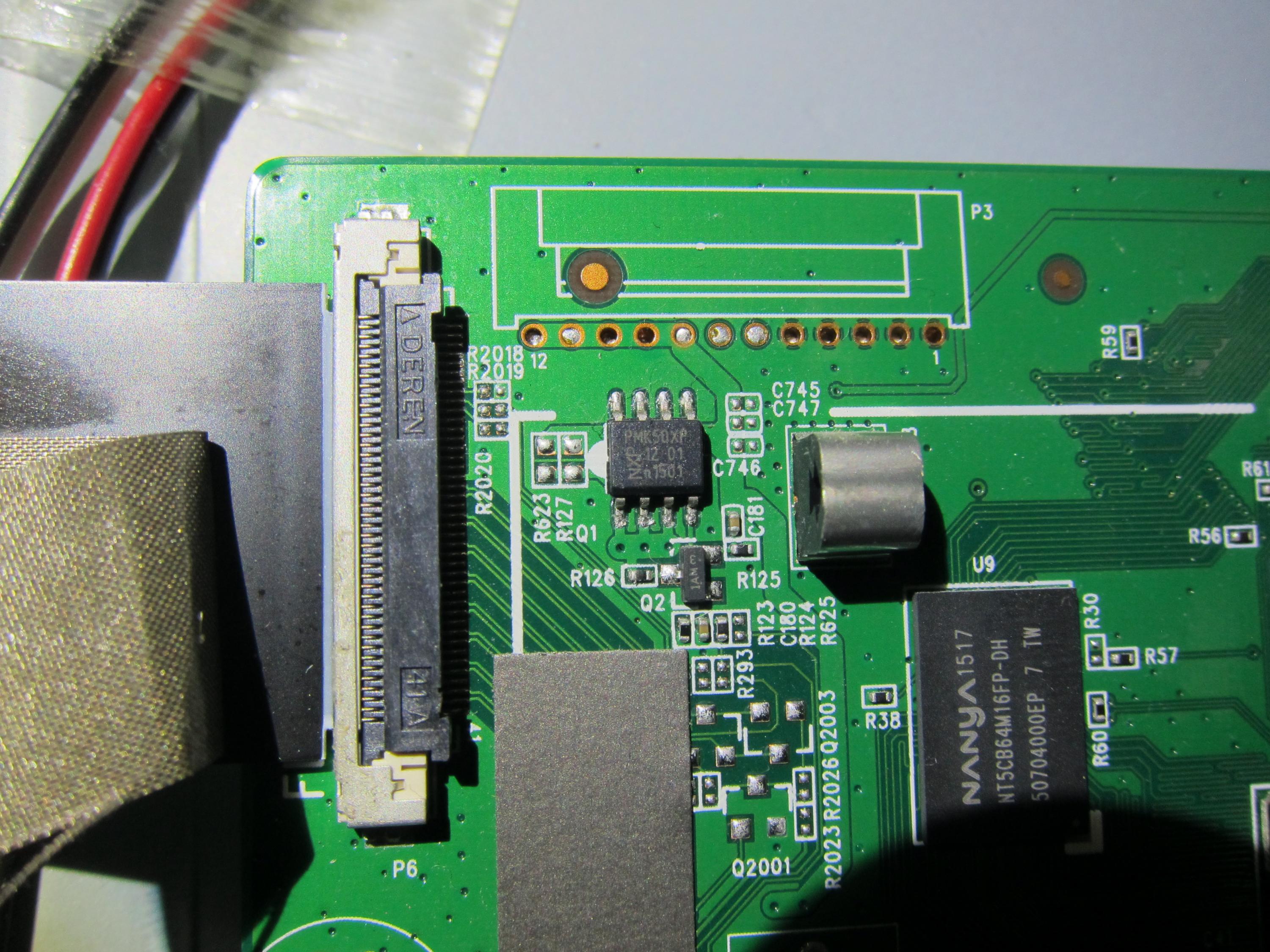

                              Can you take a really sharp photo around that IC to try and see what the Gate track is connected to.
                              • Stuckster
                                • Oct 2019
                                • 40
                                #35
                                The resistance from the Tcon fuse to Drain being 0.001 means that P3056LS should be providing the 12V Tcon supply.
                                The other resistance readings, 200K ohms means there is no internal short circuit from gate to the source
                                The problem is that the IC is not being switched on.
                                Sure. Try this.
                                Now the first thing you're going to say is, that's a different IC! Which is true.
                                I should explain that I currently have two mainboards (same model). Lets call them A and B. Board A is the original board that came with the set. It failed and has too much wrong with it to resurrect. Board B is a replacement board that I bought "in used working condition". It is the board that I have been talking about in this thread. All the voltage and resistance readings have come from board B.
                                When you asked for the IC numbers I assumed (wrongly) that the parts on each board would be identical. It was easier to give you the part numbers from board A since I had it on the desk and could easily take the heat sink off etc. Apologies. Nevertheless having looked up the specs for the PMK50XP IC on board B (the one in the close up photo) they appear to have the same specs and function.
                                  #36
                                  https://www.badcaps.net/forum/attach...2&d=1571874353
                                  SOP-8L (top)
                                  1. S - 11.9
                                  2. S - 11.9
                                  3. S - 11.9
                                  4. G - 11.9
                                  5. D - 0.0
                                  6. D - 0.0
                                  7. D - 0.0
                                  8. D - 0.0
                                  So if you check the resistance between the T-CON fuse and D pin of Q1, it shows about the same resistance of the meter's probes resistance?

                                      #38
                                      Put DC Volt meter black lead on the chassis, Red lead to the Base pin of Q2 then turn the TV ON and OFF (wait 5 seconds between toggling) to see if the Voltage on the Base pin of Q2 changed state when you toggle the TV ON and OFF.
                                      • Stuckster
                                        • Oct 2019
                                        • 40
                                        #39
                                        Sure. Is the base pin the one on it's own? Sorry I'm a bit of a noob with pcbs.
                                          #40
                                          Emitter pin (Top) is connected to R125/C181
                                          Collector pin (Middle pin) is connected to R126
                                          Base is the bottom pin.
