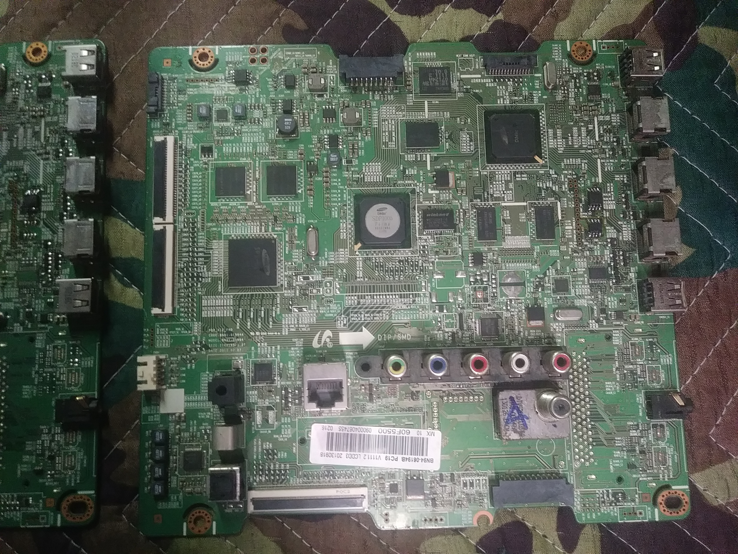

I had a problem with power supply at first rectifier was burn and some transistos...so i decide to buy new power board an the green ligth on main wasnt getting power i npticed that the conection on cn1201 which is the remote ir sensor conector had a small transistor have been in a short was getting hot crazy so i did replace it from other boards from junk yard.....and it did work green ligth started but now the main goes on and off but no pic still....it goes on for like 5secs and off after that..
Samsung plasma PN64F5500 Main problem
by alltvrepairsHi,
I have this almost brand new Plasma was well stored. I would like to repair it for a friend of mine.
I have noticed that it works for few seconds then switches Off the Power_ On signal. Have disconnected boards and left maion board and power supply and still the same. The power supply with PS_ON and VA signals On stays on so it is not a problem in the power supply.
Any one met this problem in the past?...10-08-2025, 07:34 AM -

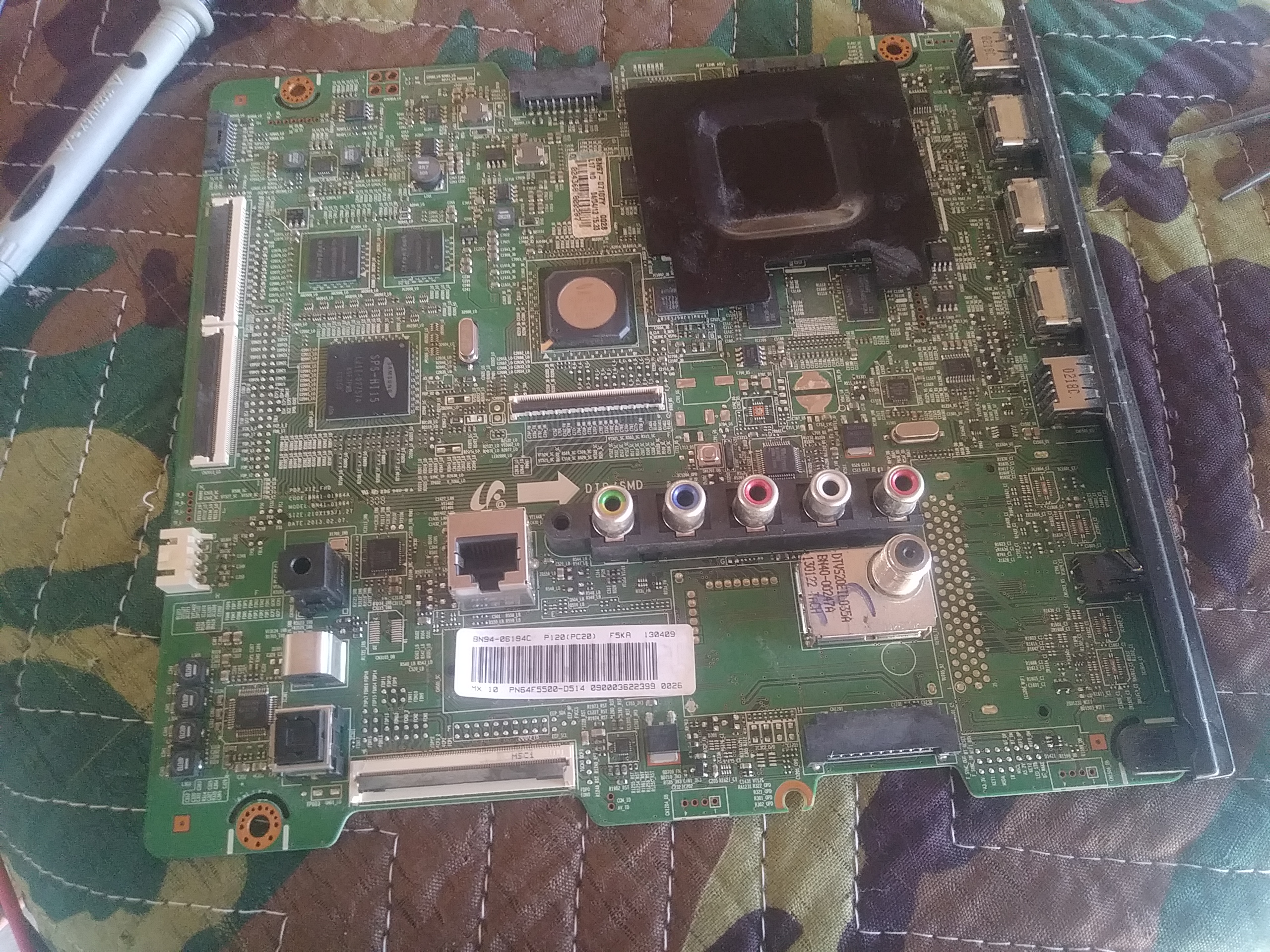

by bcstedtJust starting to crack into this one and wanted to get the ball rolling.
At power on (plug in), power light on, relays click, repeat (sometimes)
After disconnecting Y-Main from SMPS power stays on and boot up jingle is heard from speakers
Removed Y-Main for inspection and testing
This pic from:
PN50C540G3FXZA Fast Track Troubleshooting Manual - Rev 1/10/12

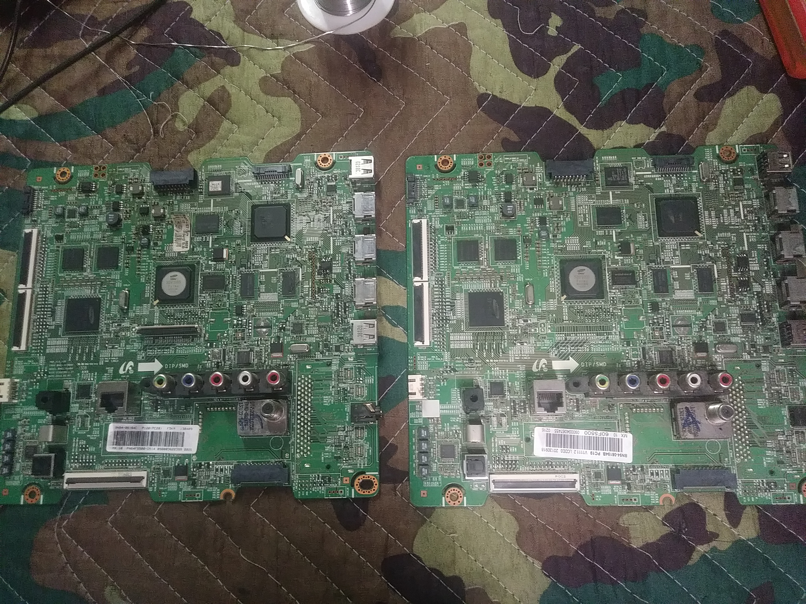

by JSin21Hoping someone here could possibly help. I have a few questions in regards to compatibility with main boards. But I'll give a quick short run down on what's going on first;
I have Samsung Smart TV UA65MU6100WXXY version DA01
Now years ago it started intermittently playing up after a lighting strike. Lighting hit the block of units i was living in at the time. Ever since that night the TV started having a mind of its own, It would randomly turn itself off or on, and all inputs stopped responding like HDMI, aerial, but USB still worked. Anyway, over the next few months...4 Photos - Loading...
