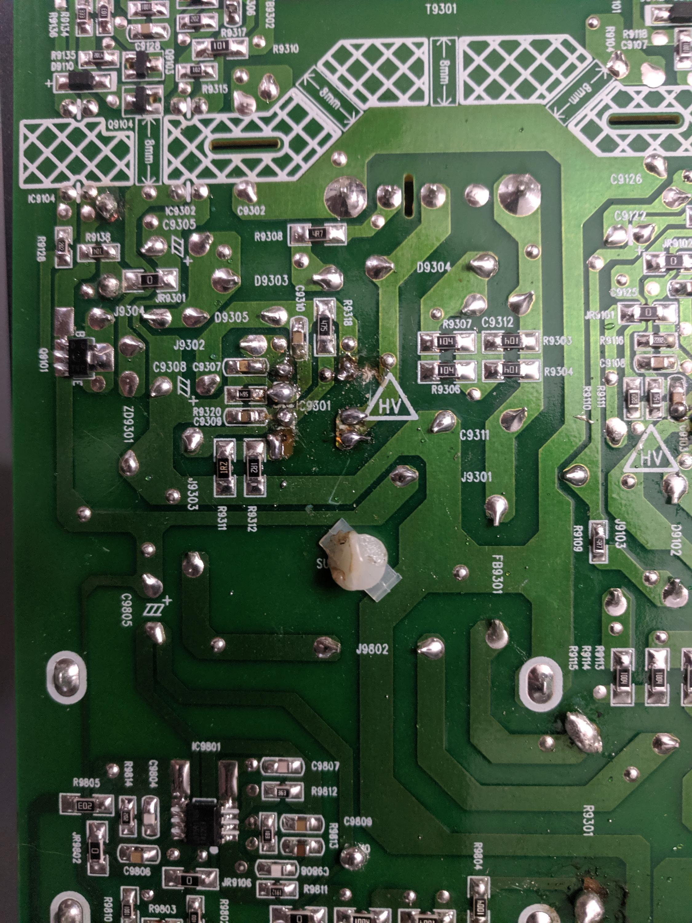

    Hello all,
    I've inherited a non-working Vizio 500I-B1 TV that someone else has tried to fix. When I opened it, the top of the IC9301 chip had blown off. I ordered a few more and replaced it, but haven't made really any other progress.
    The part number on the power supply board is 715G6100-P05-003-002H.
    I don't get any readings on the standby connector for the 5, 12, or 24v rails.
    This other post with a similar looking IC9301 chip said to make sure that the 'fusible resistor 9301' wasn't bad as well.
    I've found a JR9301 (what does JR mean in this instance?), which is what I assume that poster was talking about. When measured, it has almost no resistance across it but I'm not sure if it should when the board is powered off since at least one other component labeled "JR" also didn't measure any resistance across it. Should this measure resistance at all times?
    Any help is much appreciated. Thank you!

                      Re: Vizio 500I-B1 no standby power
                      This ic is for the +5 volts STANDBY only, Check for it at J9307
                      I Can't see your soldering from here, hold it closer to the monitor, or maybe upload a picture .
                      If you don't have the standby voltage you need to check the voltage on ic9301 (part number?)
                      Check the voltage on the primary side using BD9902 negative lead (or J9905) for your meter ground and measure the DC voltage on R9301, it should be 160vdc
                        J9307 seems to have almost no voltage. Reading 0.03V but distinctively not 0.
                        The part number that I replaced IC9301 with is STR-A6069H. Ordered from Digikey.
                        I checked the voltage between J9905 and FB9301 (R9301) and got 167V, so that's something.
                        Here is a picture of my terrible solder job. The pads almost seem to be gone from the previous person that attempted a repair, so I may have to scratch away to get some copper. Only if necessary of course.
                          With no power applied, check the resistance of R9311/12 (should be about 0.6Ω) then check ZD9301 in diode test.
                          Apply power and using hot ground (bridge rectifier -) check that you have 160 volts on pin7,8 of ic9301, then check the voltages on the other pins and post them.
                          Check that the ic pins are actually making contact wih the circuit, pin5 does not look good.
                          Be carefull this is the hot side of the power supply.
                            Those resistors are reading about 1.3 ohms for me.
                            This model doesn't have any component in the place for ZD9301.
                            I am getting 164V on pin 7,8 of IC9301.
                            I think I may have found a problem and you were correct about pin 5!
                            If I put the lead on the pin, i get ~5.5V, but if I put it on the test pad just a millimeter away, I get around 0. So my soldering job is bad here, but the pad is gone. I think I will just solder that pin straight to the test pad that is just down the trace a very small distance away.
