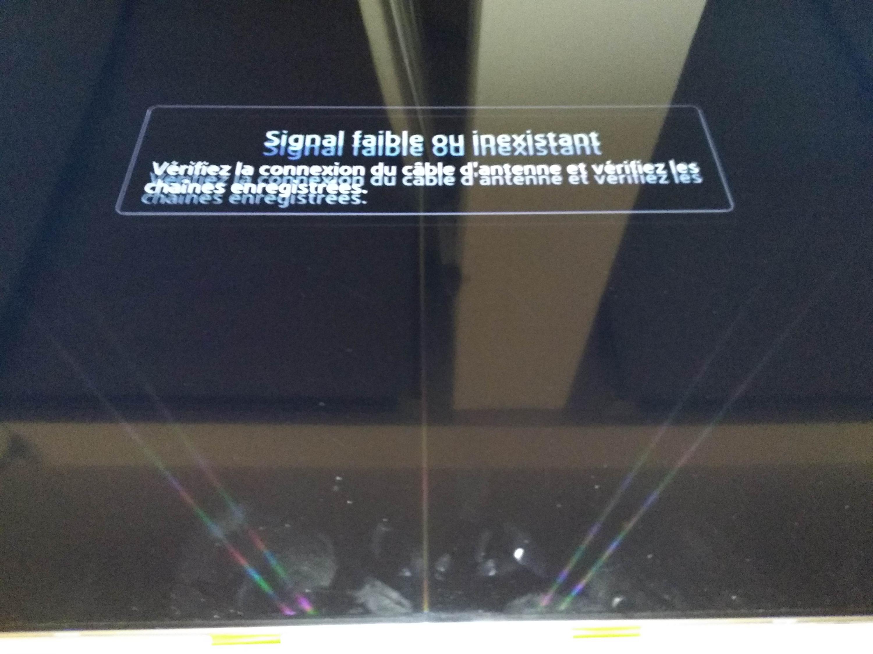

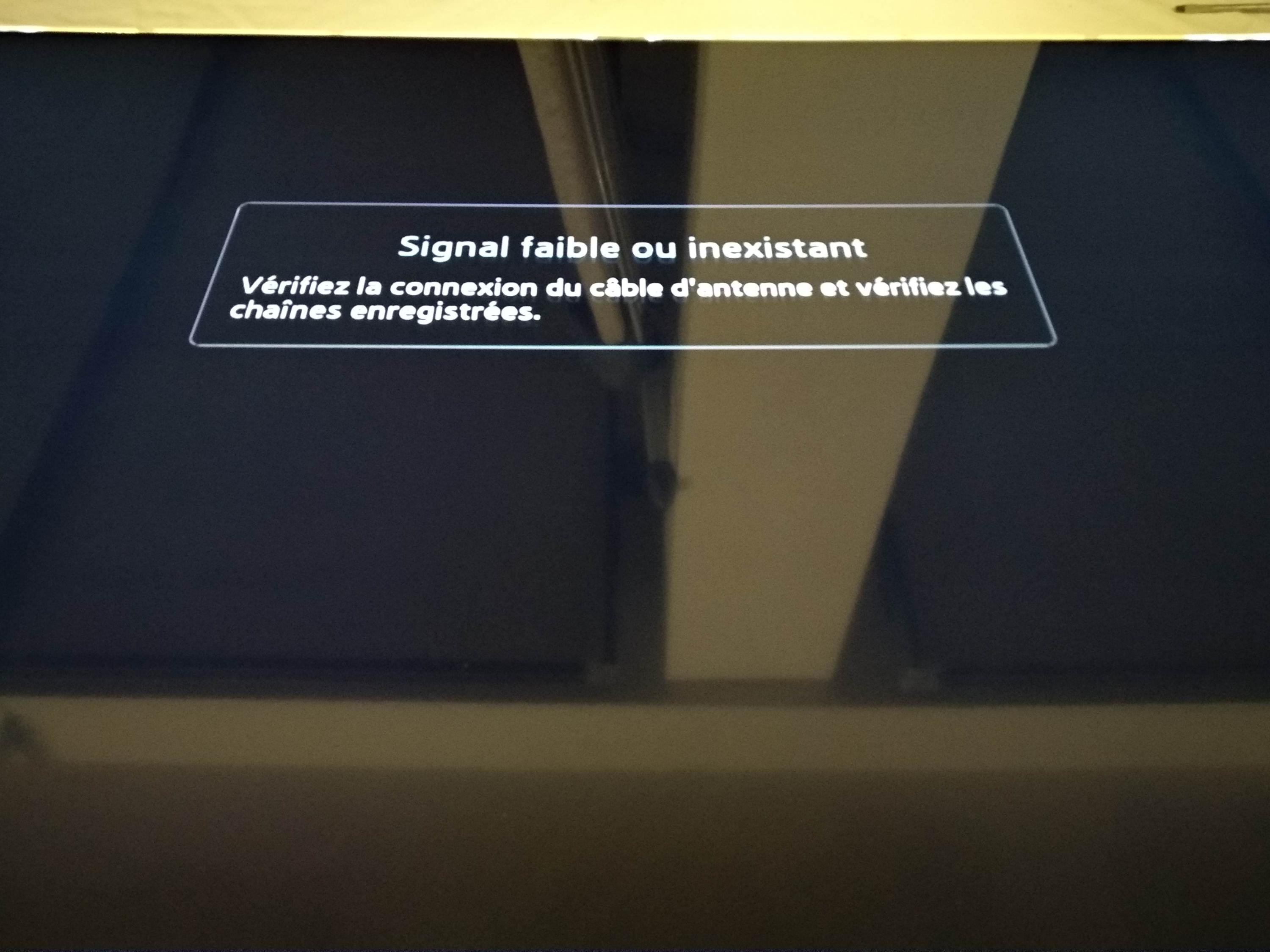

          Re: Samsung UE55ES6560 image becomes white issue
          Re
          Ok i have removed left drivers tab
          Si image Comes but there is another problem : each image persist when the other Comes
          Some pictures to explain
          Thanks again
          edit : when i unplugged the right flex of tcon i have no image just vertical lines again (at left side of the panel), but when i unplug left flex of tcon i have a good image with this remanent thing (ghosting ?)
            That's exactly what you get with a ripped off tab, did you try the "cut off tape" method first? doesn't look like it, got to be careful whose advice you take.
                  The bad driver was probably loading down the one on the opposite side 'cause them works in parallel. Have you tryied to clean the ripped side with alcool? Some deposit could make some resistance, but i don't think..
                  The defect of now is not so clear to me, if you have a text on screen at moment 1, at moment 2 you have 2 texts in different positon, at moment 3 you have 2 or 3 texts?
                  Consider that much probably it can be broken also the remaining side.
                  I suggest you for the future to get a complex surge discharger to place at mountain of the TV/game console/hifi/other..
                  If your balls are not broken you can check VGL,VGH on tcon..
                    in fact each image rest on screen for 2 seconds and then disapear. example :
                    at time 0 : only one good image
                    at time 1 : first image remain and appear second image
                    at time 2 : first image start disappear, image 2 remain and image 3 appear
                    at time 4 : first image disapear , 2nd start disapear, 3rd remain and 4th appear
                    etc....
                    as if the panel was not reinitialised between each image (don't know if this the principle but don't know how explain better)
                    and only at the power on of the tv when smart tv appear i have a white cloud center at the middle up that becomes black after 1 second. i will do some more pictures.

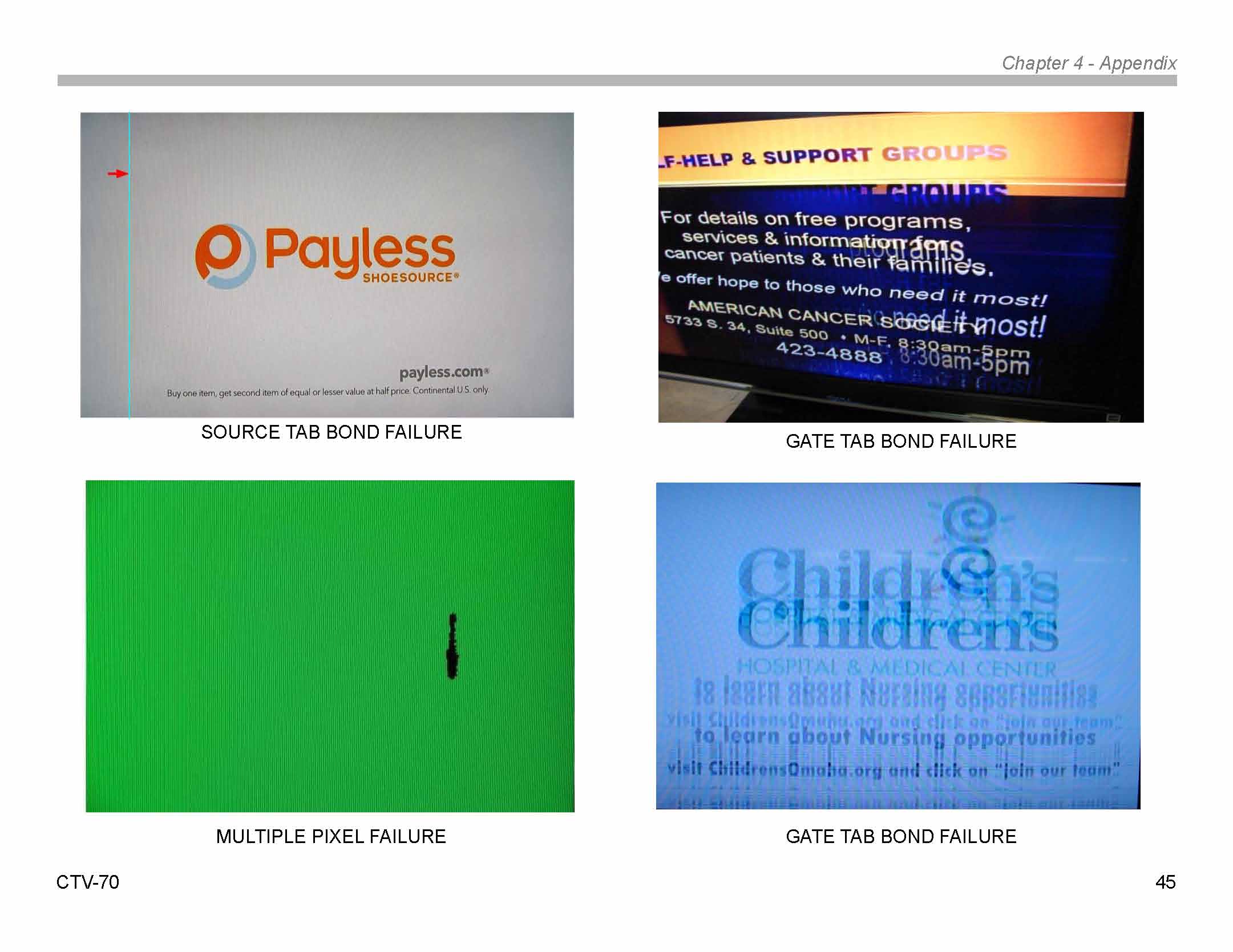

                        #31
                        Gate tab bond failure.
