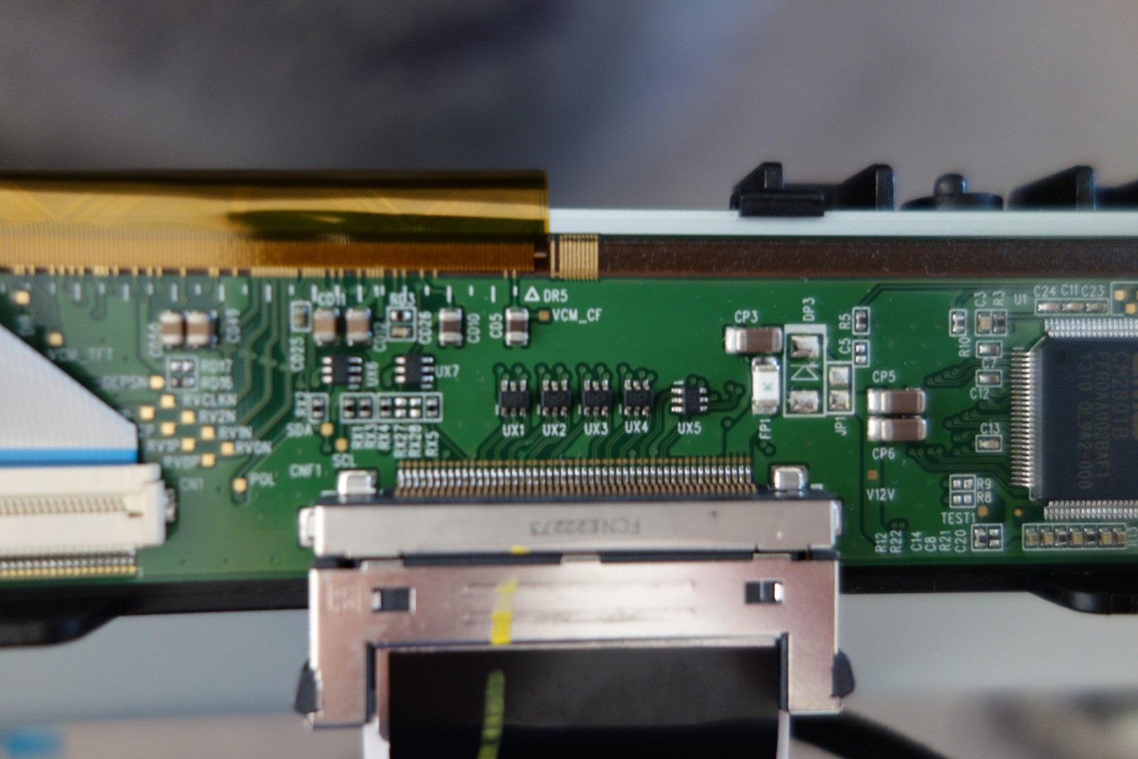

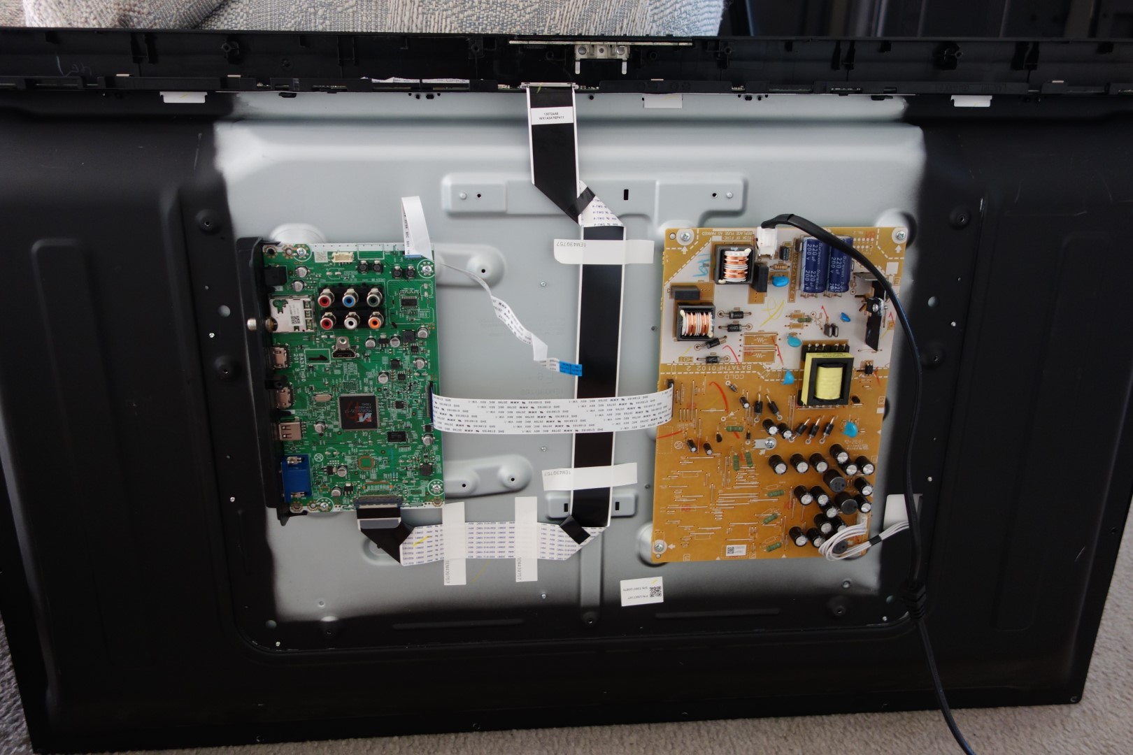

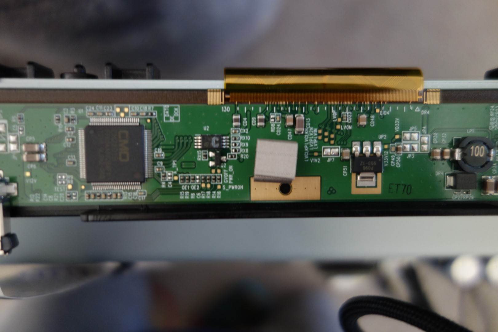

    This TV turns on with backlight but no video. There is low squealing/chattering coming from the power supply (may or may not be related). It has no tcon and its functions are integrated on the panel. With LVDS cable disconnected, it still squeals.
    Fuse by LVDS connector measures good and 12V on both sides. Random checking of a few of the surface mount caps shows no shorts.
    Main board is getting both +21V and +12V
    Looks like it may not be salvageable.

    Checked all the caps on the panel boards and none were shorted.
    Found this shopjimmy repair kit for the main board. Has 1 capacitor, 1 diode, 2 transistors and 6 IC's and fixes "no video/picture, TV makes chirp/squeal sound" My board chirps when power is first applied.
    https://www.shopjimmy.com/emerson-a3...r-lf391em4.htm
    There are quite a few main board variations for this model. I did check the 6 regulators on the main board and all had stable (with a multimeter) voltages and no shorts at the input or output.

      With the main board disconnected, there is still a quick chirp once power is applied. Humming only occurs with the backlights on.
      I have taken off all the 4.7uF chip caps off the main board but it was the same so put them back.
      I suspect the humming is a power supply issue on the led driver circuit of the power supply board and the no video may be a separate issue on the main board or panel boards.
