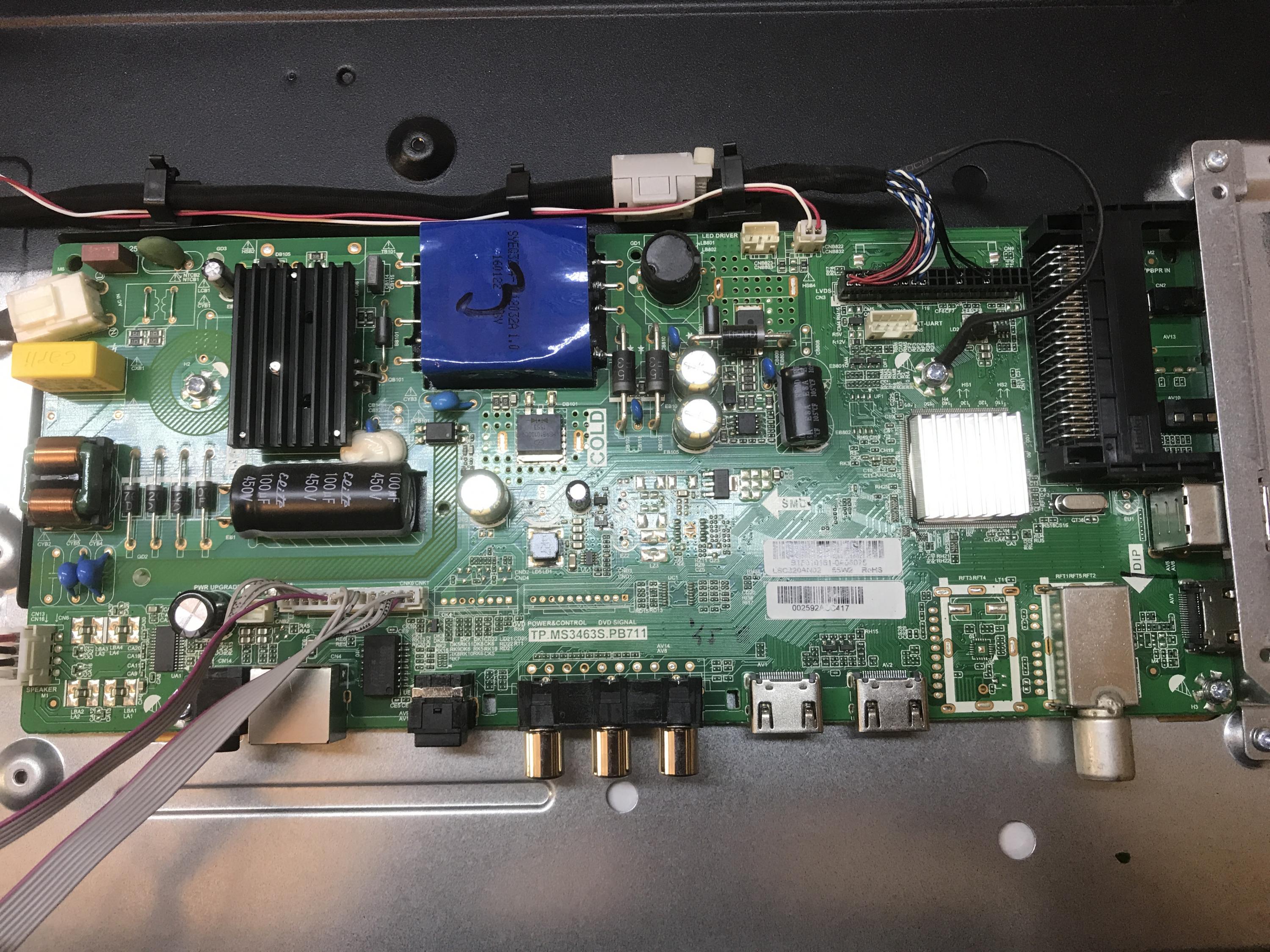

    I'm wondering if anyone can help me out with this repair?
    Nice Sharp 32". This powers on and the little LED flashes red for a few seconds, then turns white as normal to signify that it's now on.
    There's no backlight though and as far as I can see there's no image on the screen. I've stripped the screen and tested the backlight strips and they all light up ok using the tester. Another symptom is that the TV will not switch to standby.
    Voltages I tested were 330v across mains filter cap and 42v between the backlights positive output and ground. There's no boost voltage when first powered on either. All diodes test out ok.
    Any help gratefully appreciated.

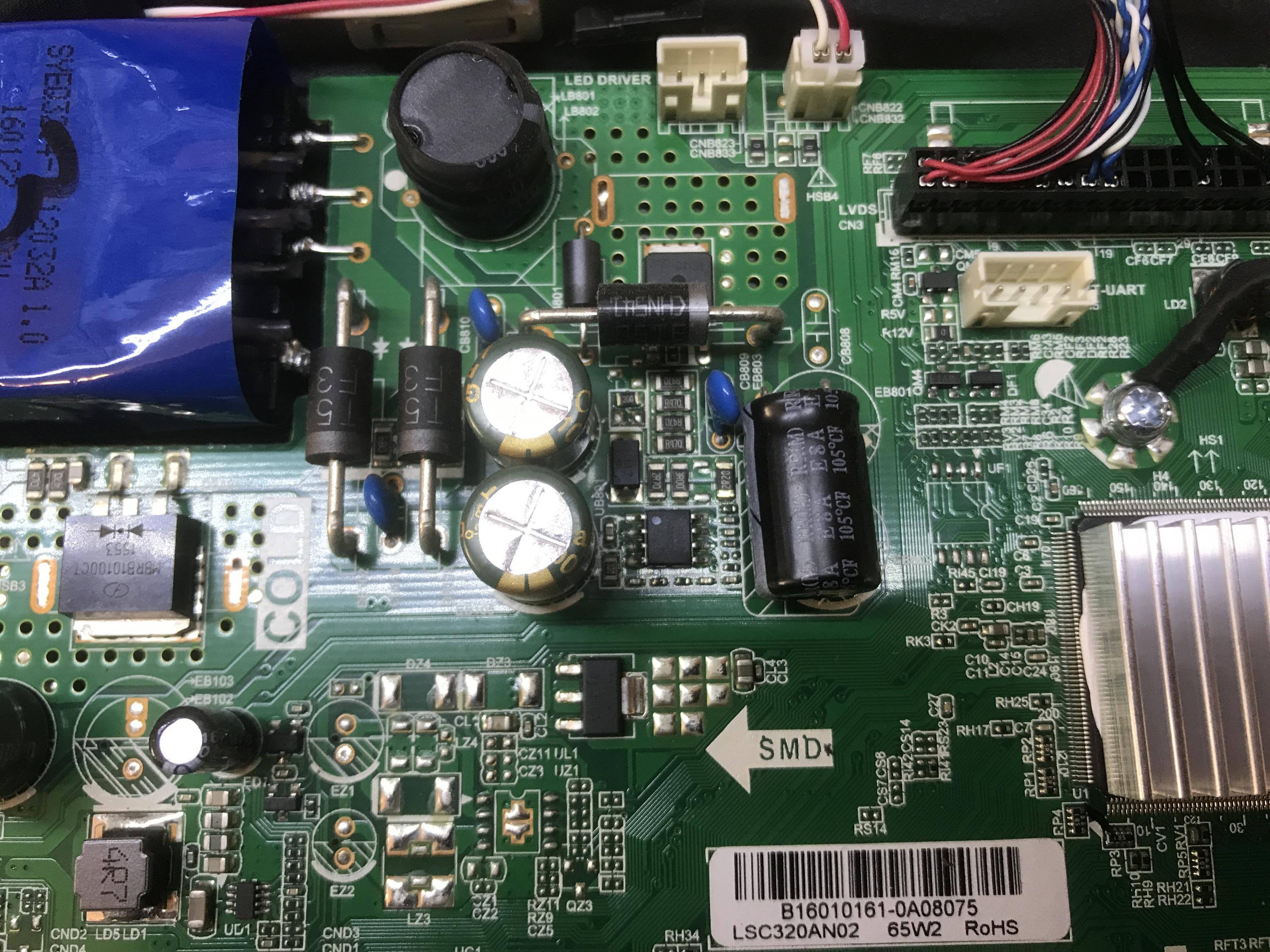

      Check if you have +12v on UB801 pin 1, that is the ic's vcc

          Re: Sharp 32CHF5111K (TP.MS3463S.PB711) Fault
          Hi again. Yep, there's 12v on pin1 on UB801. I also tried freezing the chip incase it helped show the chip as the culprit, no change though.
            Did you freeze the chip when the tv was unplugged? I thought you ment freezing the eeprom ic, this is the backlight driver, freezing it won't help

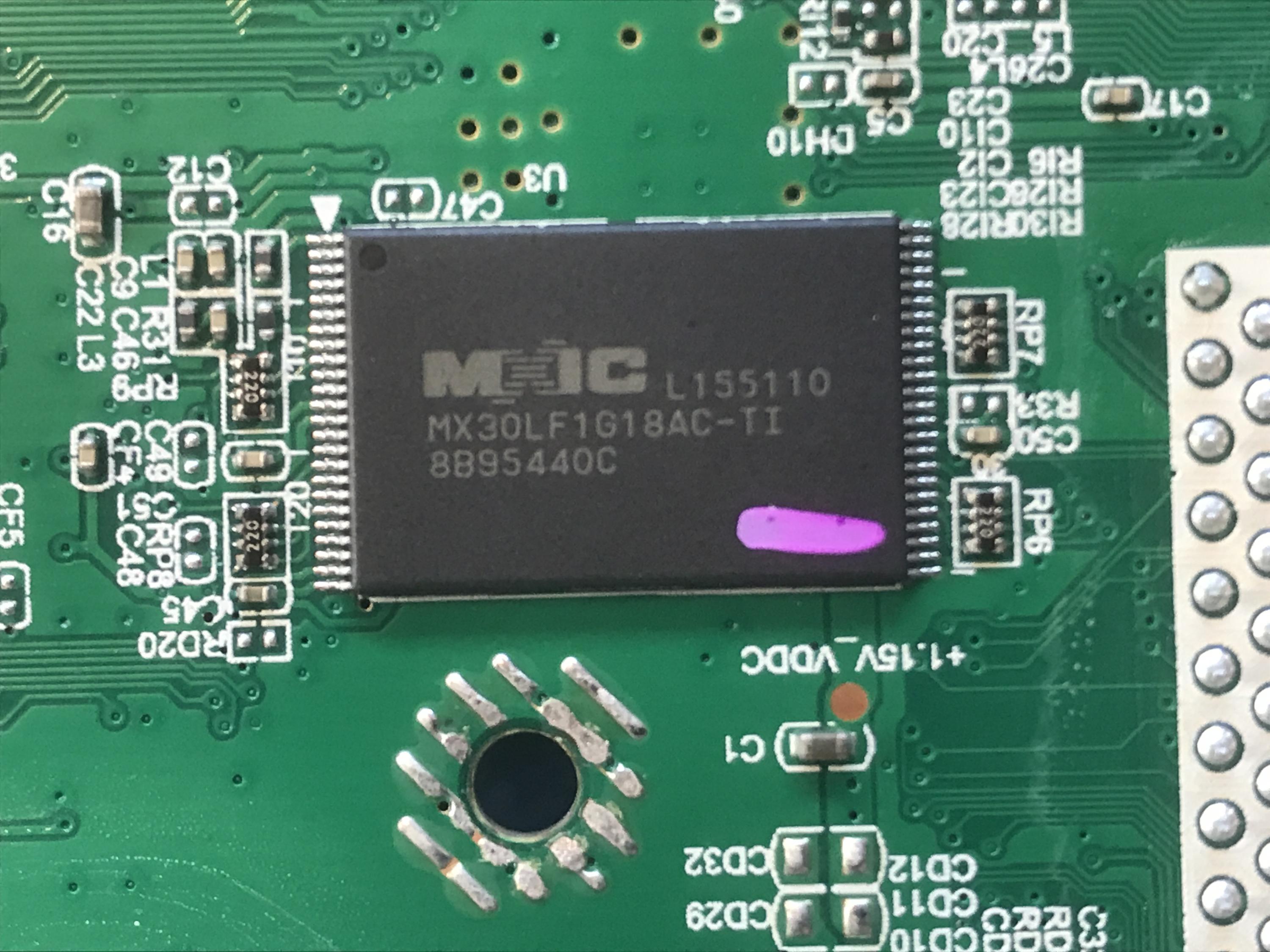

                Did you try freezing the spi/eeprom chip? I think this board uses a nand chip, mx30LF1G18IC, It might be available for this model
                  Ah ok lol. The nand must be on the underside of the board. Will check tomorrow. If it’s an spi 8 pin flash I can change it but a nand chip is beyond my soldering skills ☹️

                    The spi would be located at UF1, it's not populated
                      Morning R.J., yeah it's a big nand chip on the underside of the board, I tried giving it a freeze as well but still no results.
                      I may just have to buy a replacement board for this TV I'm guessing, although I'm not sure if it's worth the cost given that it's a basic model with no smart functions.

                              Was the tv unplugged when you tried spraying the ic? It needs to be unplugged, The ic is read when first plugged in. But that freezing trick usually only works with those 8 pin spi ic's and not the nand
                              You had 12v on UB801 pin1 , you could check pin8,that is the PMM pin that controls the brightness of the backlight
