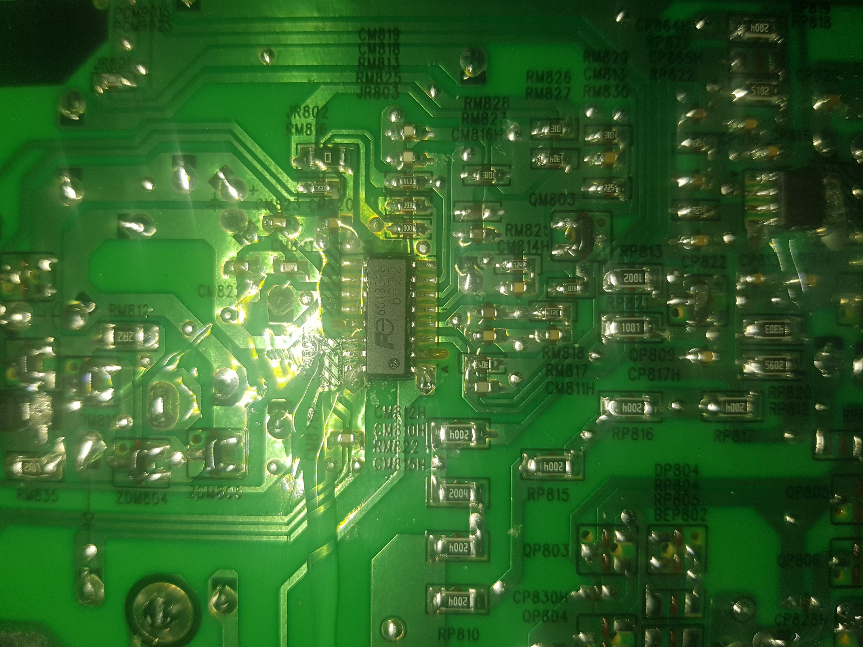

    Samsung UN43NU6950FXZA No power
    by mrtek
    Hi
    Picked up another TV. Samsung UN43NU6950FXZA. No power and no standBy led on. Removed back cover and:
    Main fuse = OK
    Back light LED = OK. Power them with aux power source
    LED output = OK 156V
    I do get 12 V DC out of the power supply going to the digital section but no 5V or 3.3V. PS_on voltage is only 1.8V. I have looked everywhere on the PCB , I could not find i reference for 5V output.
    Also removed connections to panel, speakers and remote but no luck. One strange thing is that even with the LED power supply working, backlight LED do not turn on...
