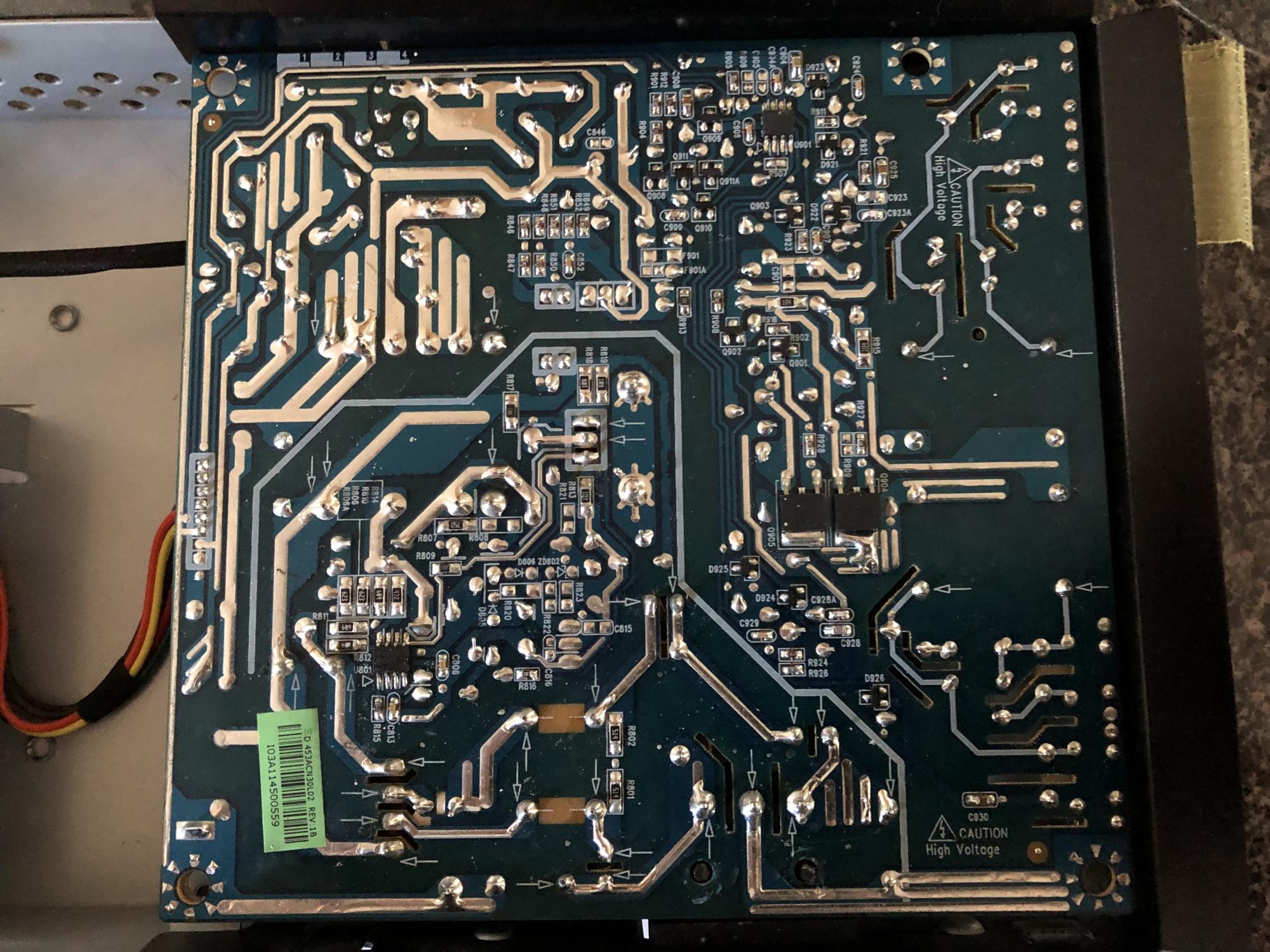

    This monitor used to sometimes work when power button pressed which made it seem like a sticky power button to the original owner, now it's completely dead. No standby light no green power light.
    There's no voltage key at the secondary outputs but I do measure some voltages:
    5v, 5v. 2.7v the rest are 0v.
    There's 3.3v at the power button which does go low to 0v when it's pressed.
    Not sure if I'm to rule this a mainboard issue or not. Want to try manually turning the psu on to see if the rest of the voltages come up but don't know which pin it is. Any help would be appreciated

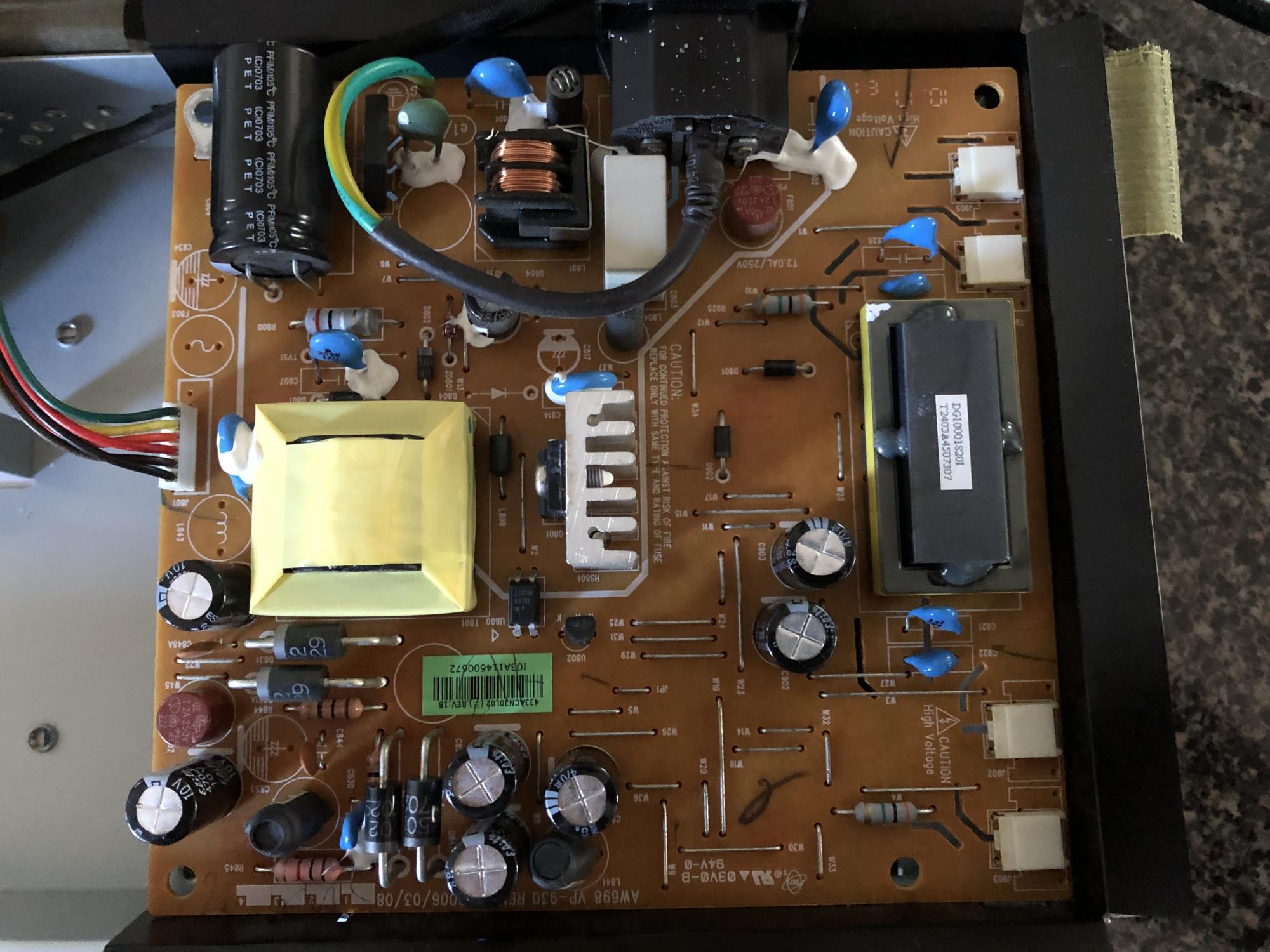

          Pull the boards and look for bad/cold solder joints, check the solder around the transformer/s and anything on a heatsink, CAREFUL what you touch capacitors can hold a charge for hours after power is removed. Warning is for those who might be looking on that might not be aware.

            I've already tried that and touched up a couple suspicious joints. Didn't change anything

                The + 5volts on pins 1&2 is correct, pin3 is vbri and pin 4 is Ven, 5&6 are ground
                Check the voltage on JP1, I believe it should be around 14v, it supplies the inverter section.
                To turn on the power supply, disconnect the main board cable. and use a 1k restsor between pin1 (+5v) and pin4 (VEN). You may also need a 1k between pin1 and pin3 (VBRI)
                C809 (100µf/50v) could be bad/weak in the primary
                There are two voltage regulator ic's on the main board, U6 (3.3v) and U7 (1.8v) Check there output voltages, You can check the voltage on the tab.

                  Try heating the capacitors of the powerboard with a hairdryer, see if the screech changes any.

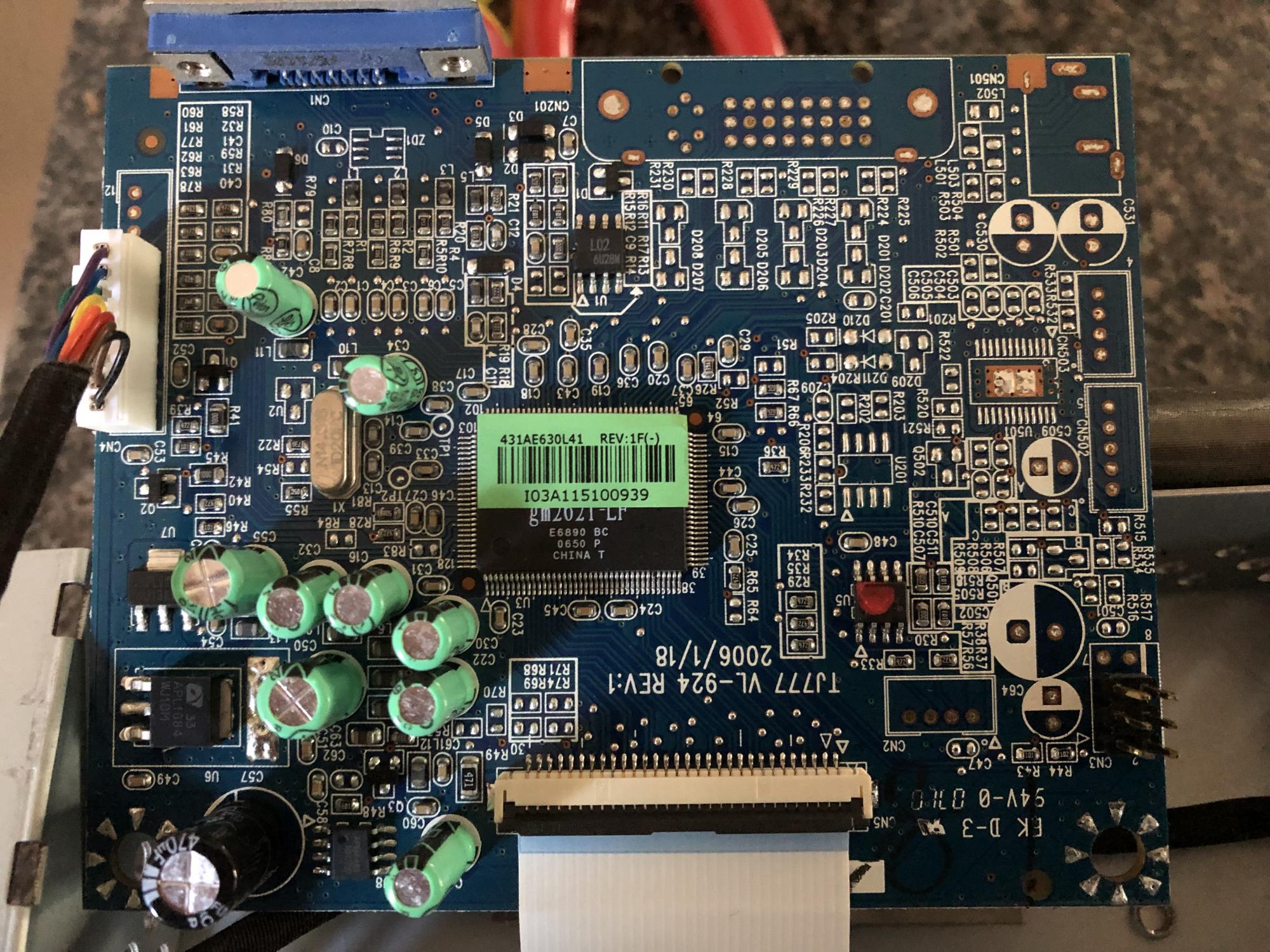

                    I have found shorts on the main board can cause the PS transformer to squeal. Check for shorts on the voltage rails of the main board and then try to narrow down to decoupling caps.

                      U6 and U7 output proper voltages.
                      Where's JP1? What's the 2.7v I measure from power board? Seems like an odd voltage but it's steady as well as the other 5v's
                      C809 seems to be a different brand of cap than the others I'll investigate it. Also wonder if that glue around it has become corrosive but it seems to be a silicone rather than the old type that would become an issue. Is that cap part of the switching ic?

                          JP1 is near U802, or use D841 cathode. It is the supply voltage for the inverter section. That 2.7v is coming from the main board, it is the VBRI, brightness signal for the backlights.
                          C809 is likely ok if you have +5v and +14v. It is the VCC filter cap for the smps ic. If c809 failed you would not have the standby voltage.

                            With the mainboard connected I get 20v on JP1. With it disconnected the voltage varies 8v-14v. Also with mainboard connected the transformer in the inverter section makes a squealing sound but no noise with mainboard disconnected.
                            If I jumper 5v to pin 4 to turn on the supply, what voltages should I be able to measure to determine if working properly? Should I have the backlights connected to see if they turn on?

                                      It is better to use an oscilloscope or an esr meter to check for bad caps on the IP board, but next it probably need a reprogram of the eprom or the microcontroller on the interface board due ripple corruption of them.
