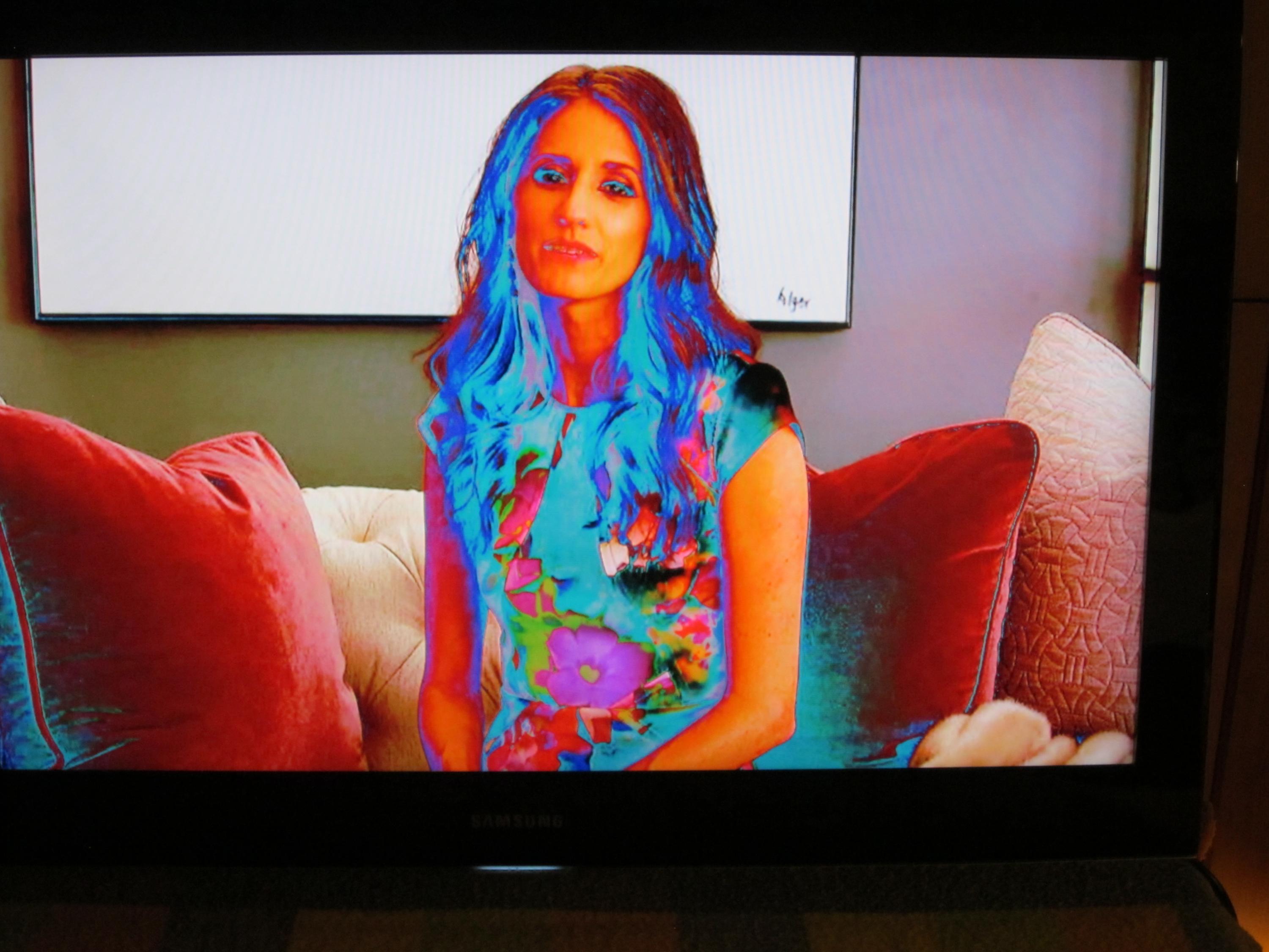

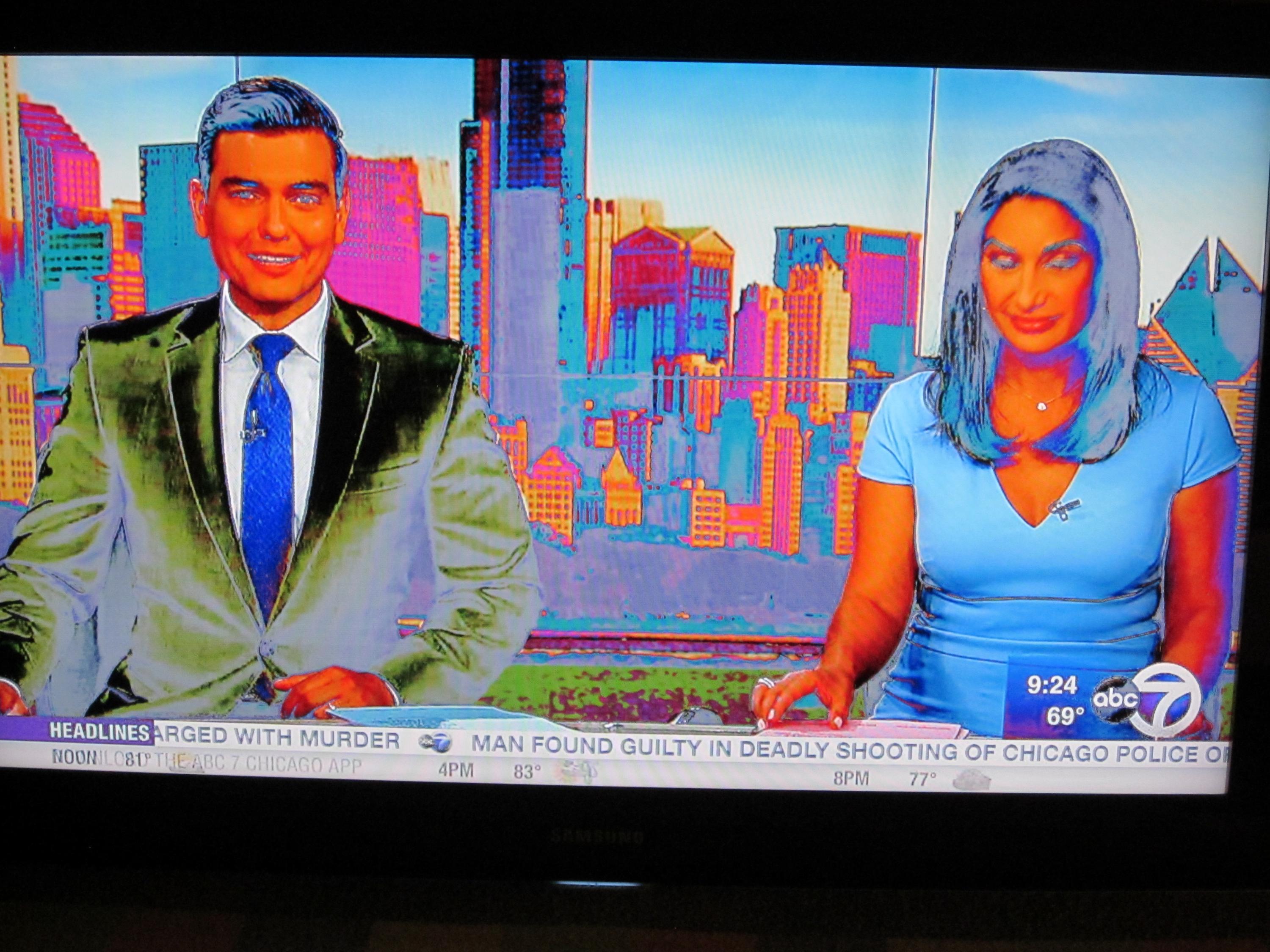

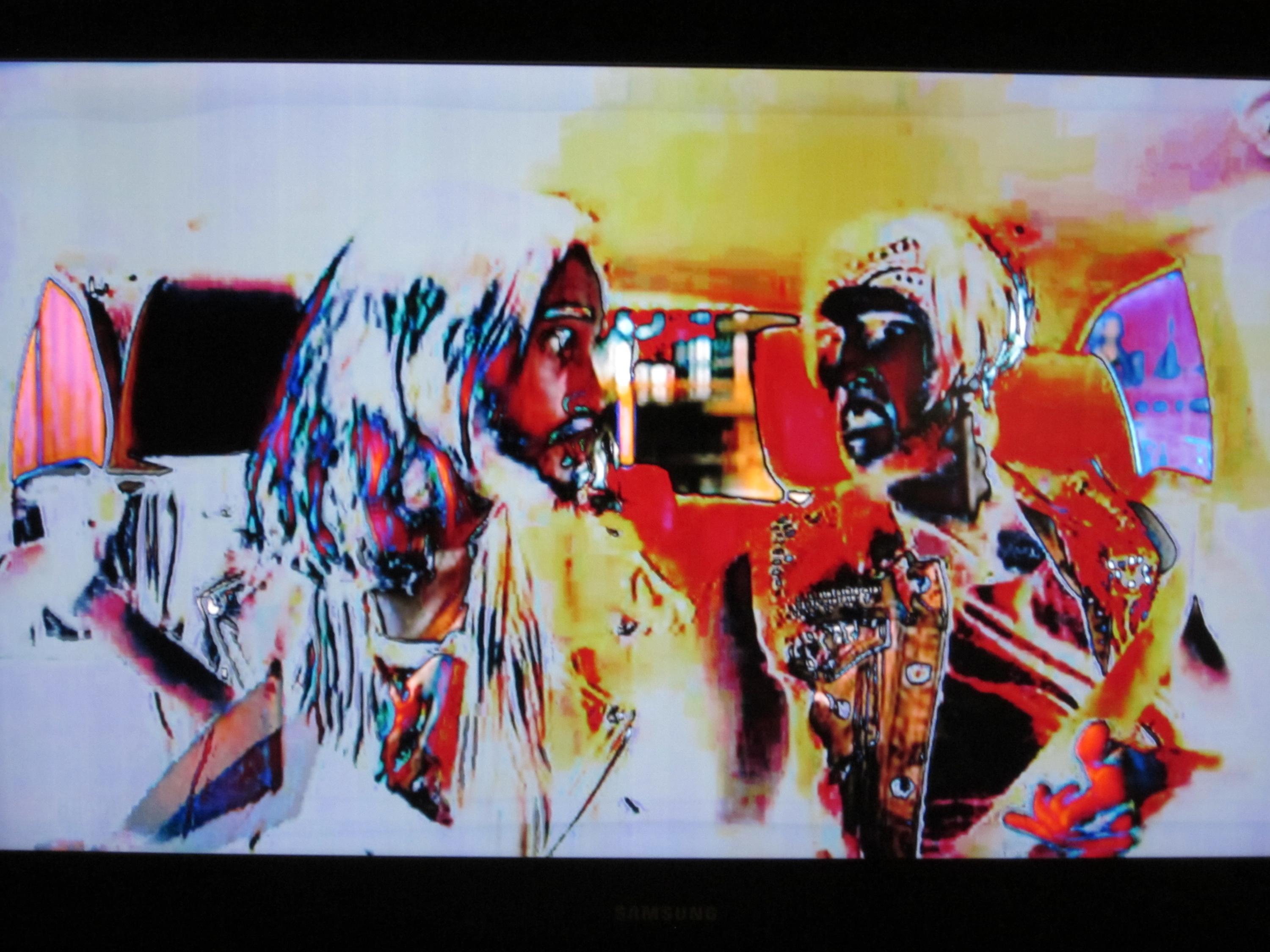

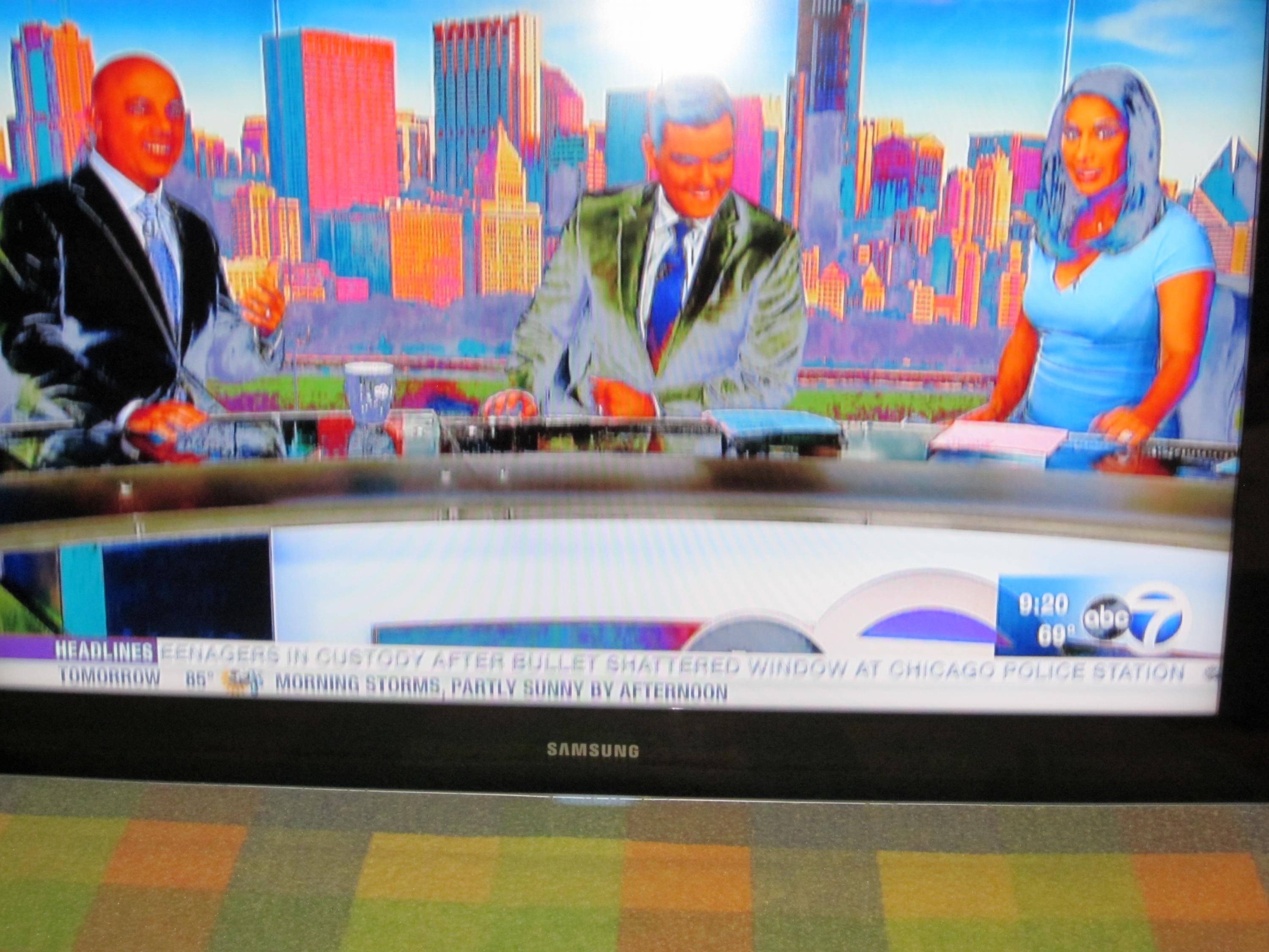

    Hi all. Any help would be greatly appreciated.
    Thiss is a Samsung LCD TV model LN40A550P3FXZA with a picture solarization issue that I am trying to trouble shoot.
    I have spent most of my time troubleshooting the T-con board. All test points on the T-con board have stable DC voltages. I have documented those voltages on all test points but can not find anywhere what these voltages should be. The GRD test point on the T-conn board reads 1.8v DC which seems like it should read 0 v DC.
    No capacitors on any of the boards appear to have issues. I would like to be sure which board needs to be replaced before I buy a replacement board. Attached are pictures of the TV picture that shows the issue if that would help isolate which board may be bad.

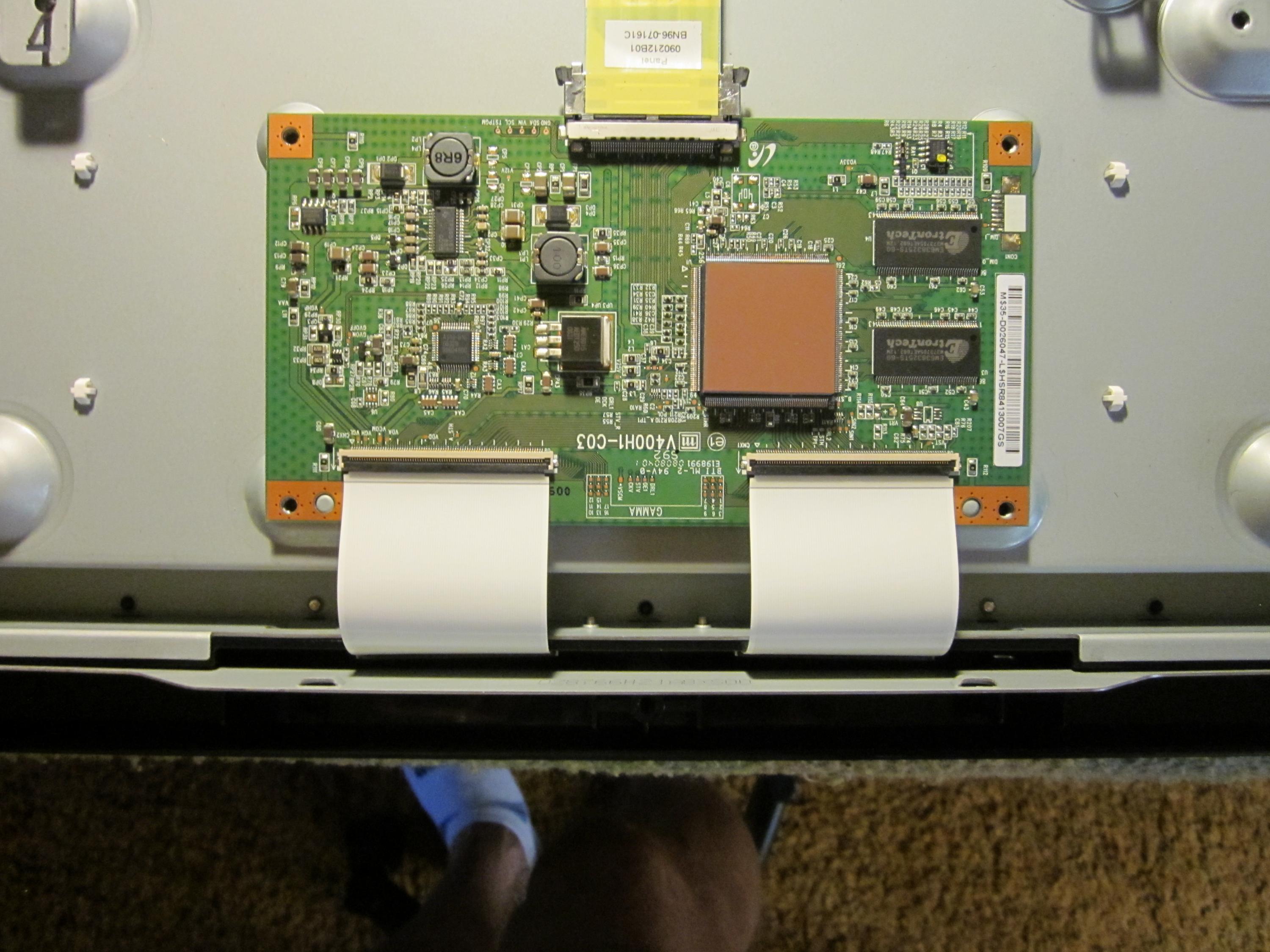

    Re: Samsung LCD LN40AQ550P3FXZA Solarization Issue

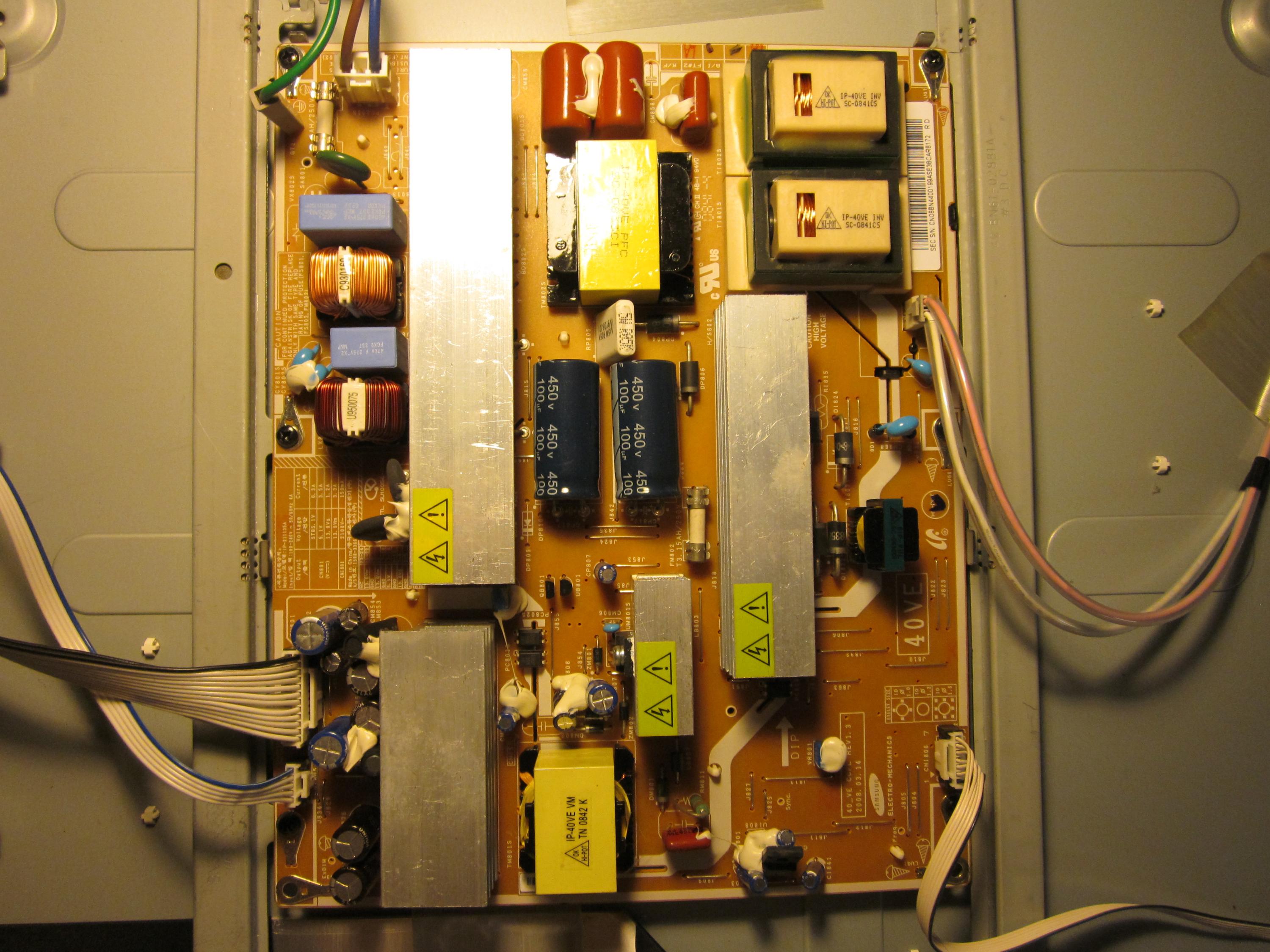

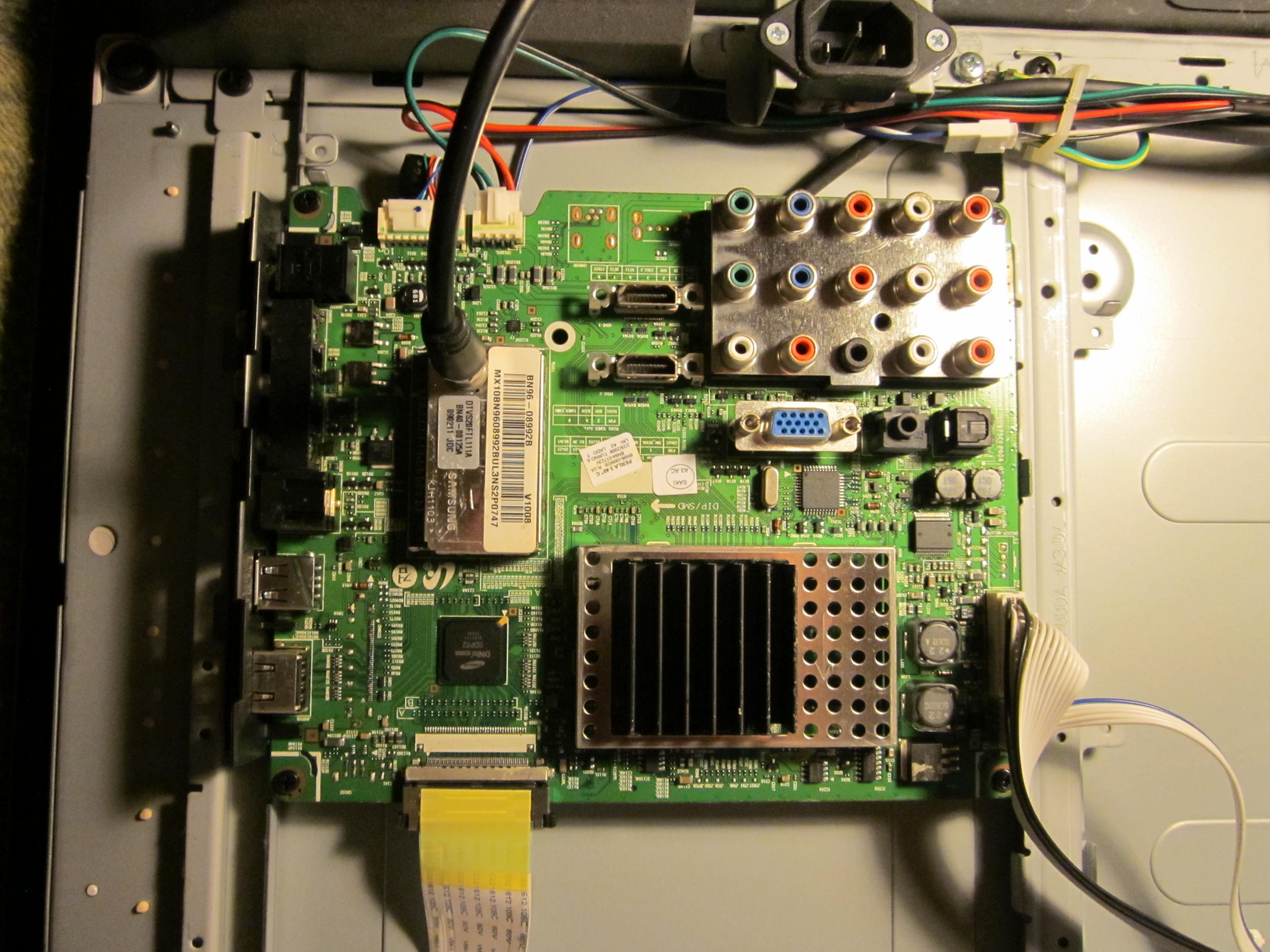

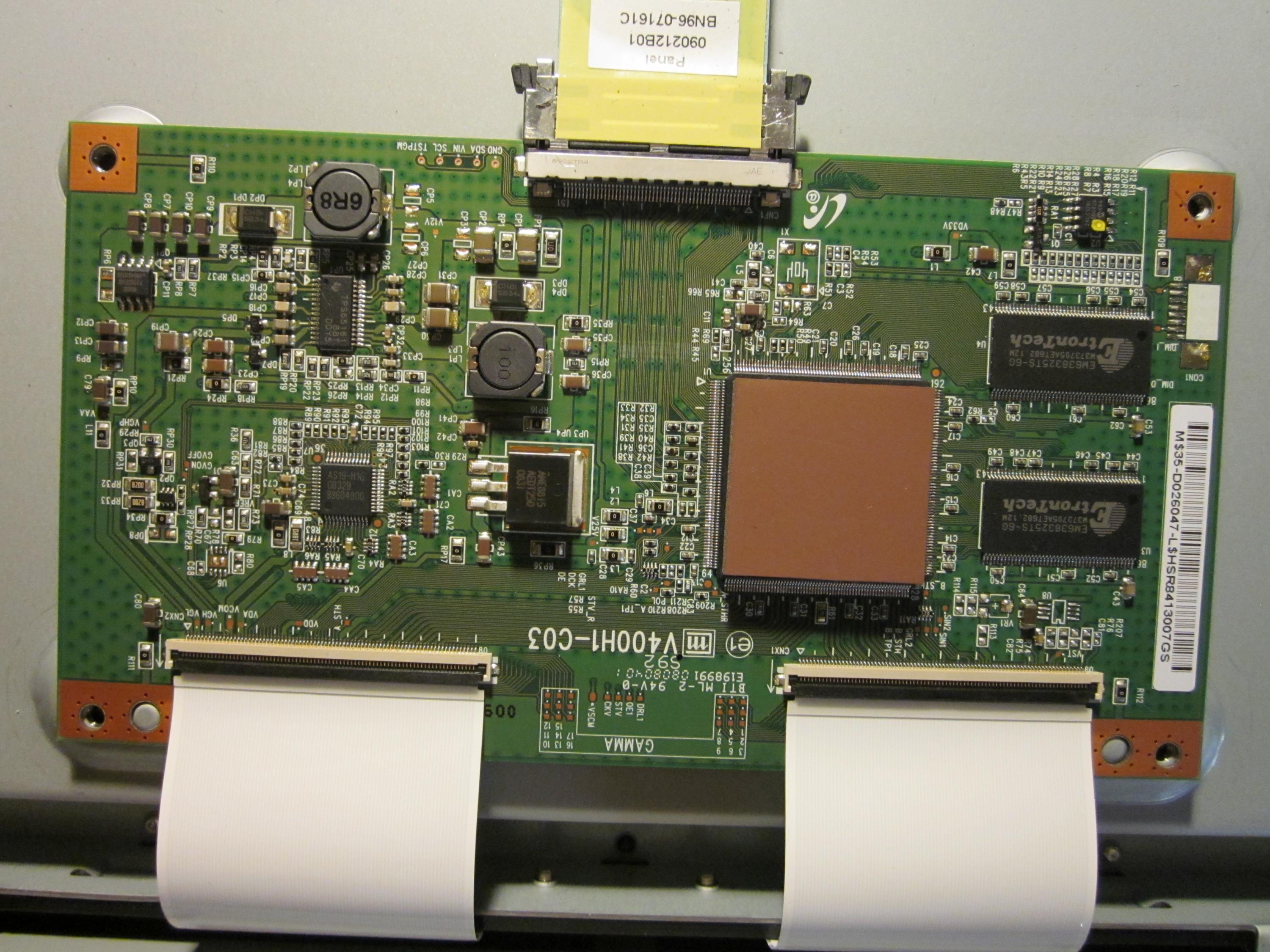

    Also attached are pictures of each of the 3 boards on this Samsung LCD LN40AQ550P3FXZA with a Solarization Issue.
      See where it says GAMMA? those would be the points to test.
        they should go gradually in one direction like 1.2, 2.3, 3.4 so on if next one is like 1.2 then you have a problem with the gamma ic, I do believe.
          Yes. I have tested the GAMA test points and have the readings for each test point, but I don't know what readings would indicate proper voltages. I have also tested the 5 additional test points inside the GAMA test points and the 5 test points to the left of the yellow ribbon connector. However I have no documentation that tells me what each test point should read.
            What are your readings? start with 1 then 2, 3, thru 17 post results here.
              These are the reading from ground to the test point, not reading between test points. Meaning black to ground and red to test point 1, etc.
              1 15.0
              2 12.83
              3 12.04
              4 11.14
              5 10.73
              6 10.40
              7 9.98
              8 9.12
              9 8.16
              10 13.19
              11 14.08
              12 11.64
              13 6.81
              14 5.62
              15 4.88
              16 3.56
              17 2.65
                Yes, faulty gamma ic, I'd guess an AS15.
                  Looks like AS19-H1G
                      Originally posted by R_J
                      Looks like AS19-H1G
                      You're right, I didn't zoom in on the photo.

                        Thanks for the opinion that it is a bad T-Con board because of the bad Gama IC, but what leads you to that conclusion based on the test point data? Just curious.
                          A non faulty one produces a linear graph when plotted.
                                Yes. I ordered a "new" T-con board on ebay for $28.22. It looked like the Gama IC was about $12. At those prices I would just a well go with a whole new T-con board. I am hoping it is a good T-con board.
                                Diff .... So a good board would have a downward slope of the voltages from TP1 to TP17. Is that correct? Thanks for all of your help.

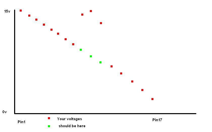

                                  This is a rough graph of you voltages, its not that bad but your picture is not that bad. If more of the voltages were off your picture would look a lot worse.
                                      Did you read post 4?? On your chart you're ok 1 thru 9 then it goes up, which is bad. Not rocket science.
