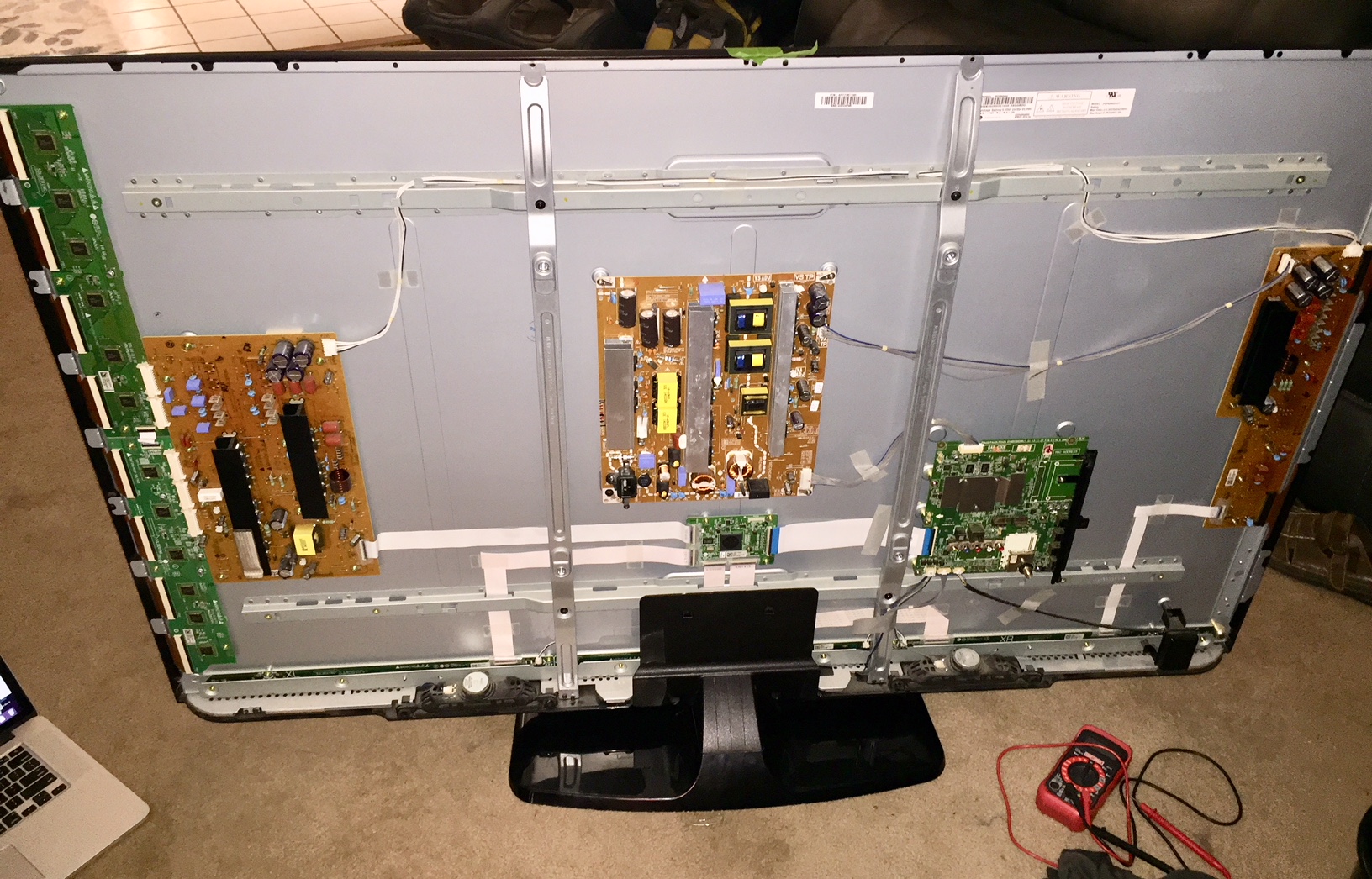

    Hello all ~
    I picked up a nice 2014 LG 60" plasma the other day and it has the relatively common problem of the cyclical clicking on the power supply. I have been trying to isolate the problem but could use a little help in doing so. I have been taking some notes on my progress and will post those soon along with some pictures. Just wanted to get this thread started for the moment.
  • kca
    • Feb 2016
    • 529
    Re: LG 60PB6900 ~ Relay with cyclical, repeated clicking upon startup

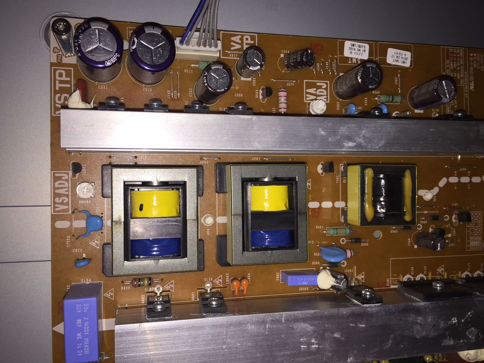

    LG 60PB6900 ~ 60” Plasma (2014 model)
    The Problem: Upon plugging in the power cord, get a cyclical, repeated clicking emanating from the power supply with the red LED on the front panel turning on and off in concert with the relay switch clicking.

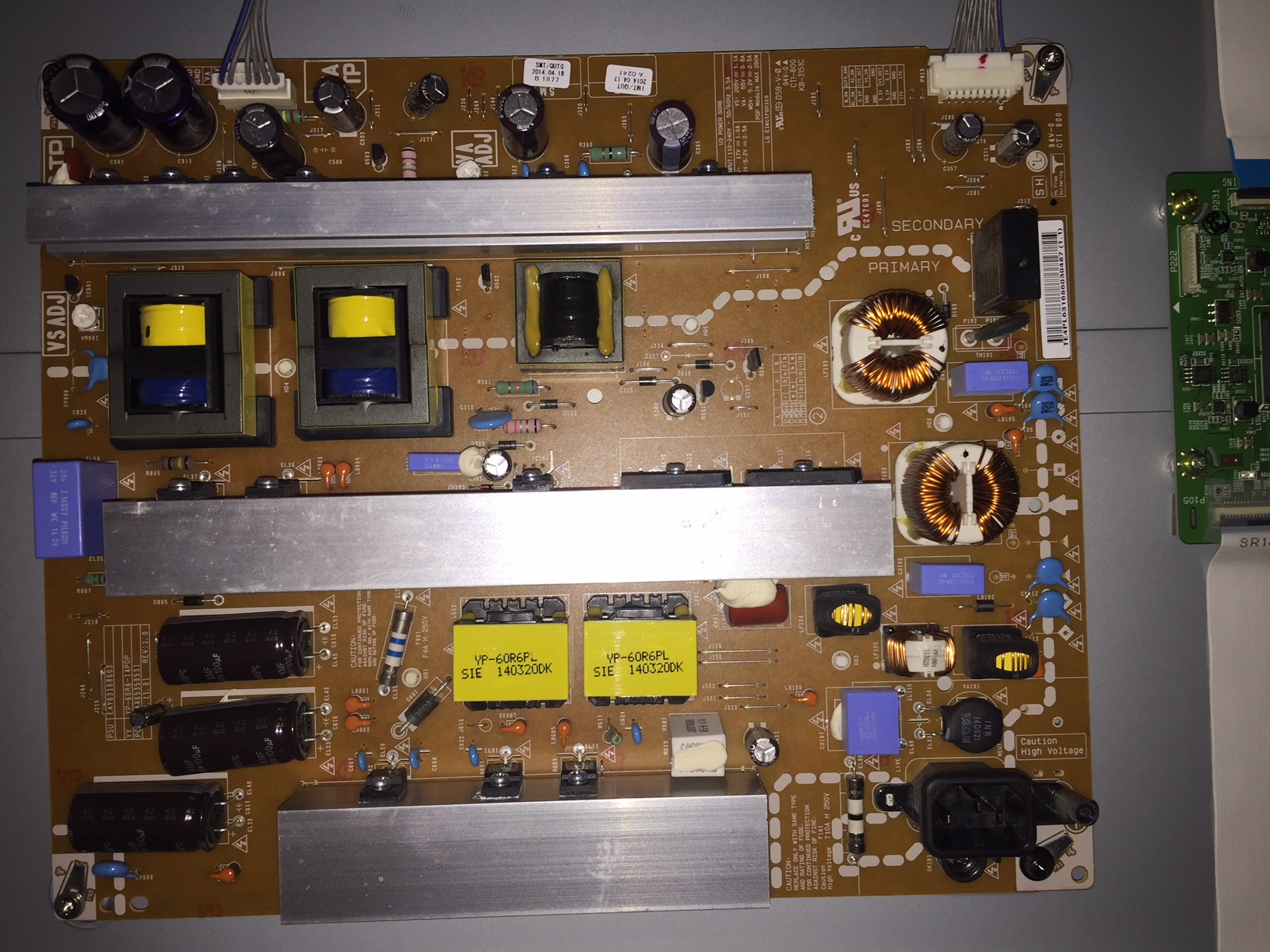

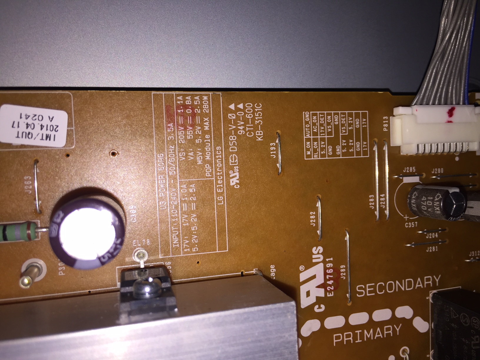

    Testing of PSU Voltages:
    Connector that leads from PSU over to the ZSUS (located in the upper-right hand corner of the PSU):
    VS was on the PSU was initially at 215 ~ I dialed it down to 205, where it was supposed to be.
    VA was right on at 55
    5V, labeled as M5V on the board itself, was as expected and sitting at 5.1
    Exact readings, after I made the adjustment, were:
    205
    205
    0
    0
    55
    5.1
    Connector that leads from the PSU down to the Main Board (located in the lower-right hand corner of the PSU):
    Everything seems to be in order here too.
    Exact readings were:
    3.2
    3.2
    5.1
    0
    0
    5.1
    5.1
    0
    17.1
    [B][I][U]TESTS ATTEMPTED TO ISOLATE WHICH BOARD IS AT FAULT:
    When EVERYTHING is connected ~ Cyclical, repeated clicking
    When the connector from the PSU to the Main Board is pulled at the top of the Main Board ~ Only one click
    When everything is in play, including the Main Board, but the ribbon from the Main Board to the Logic Board is pulled at the Logic Board itself ~ Cyclical, repeated clicking
    Note: Highlighted this section because the pattern seemed a little fishy to me.
    When everything is connected except the ZSUS, meaning I pulled the connector that leads from the PSU to the ZSUS at the ZSUS itself ~ Only 1 click
    When the connection between the ZSUS and the YSUS is broken (by unplugging the connector at the top of the ZSUS) ~ Only 1 click
    Everything connected except the YSUS ~ Only 1 click
    * Baked the Main Board on the evening of Monday, August 5th. To no avail. Nothing appears to change, indicating that the Main Board is not the likely culprit here. Did this just because so many of the LG's I've worked on of late have had Main Board issues that were easily resolved by the reflow.
    * Test to see if I could produce a test pattern by bridging R651 and R652 on the Logic Board produced only 1 click and NO picture and/or test pattern (as kind of expected, because the Main Board was disconnected from the PSU for the purposes of this test). And, given the fact that there is no direct connection between the PSU on this model and the Logic Board itself. Performed this on Tuesday, August 6th.
    Note: when the same test is performed, with the Main Board connected up to the PSU this time, but the Logic Board disconnected from the Main then I do get the repeated clicking (as mostly expected).
    * Tried heating up the PSU with a hairdryer ~ to no avail. Didn't seem to change anything, although I did not keep it on there extremely long. Tried to hit all of the mosfets, though, and get them heated up to the potential point of change.
    There is no green LED indicator light showing up on the Logic Board. Haven't seen one yet, through any and all of these tests. There does NOT appear to be a light built into the board at all, though I could be wrong about this.

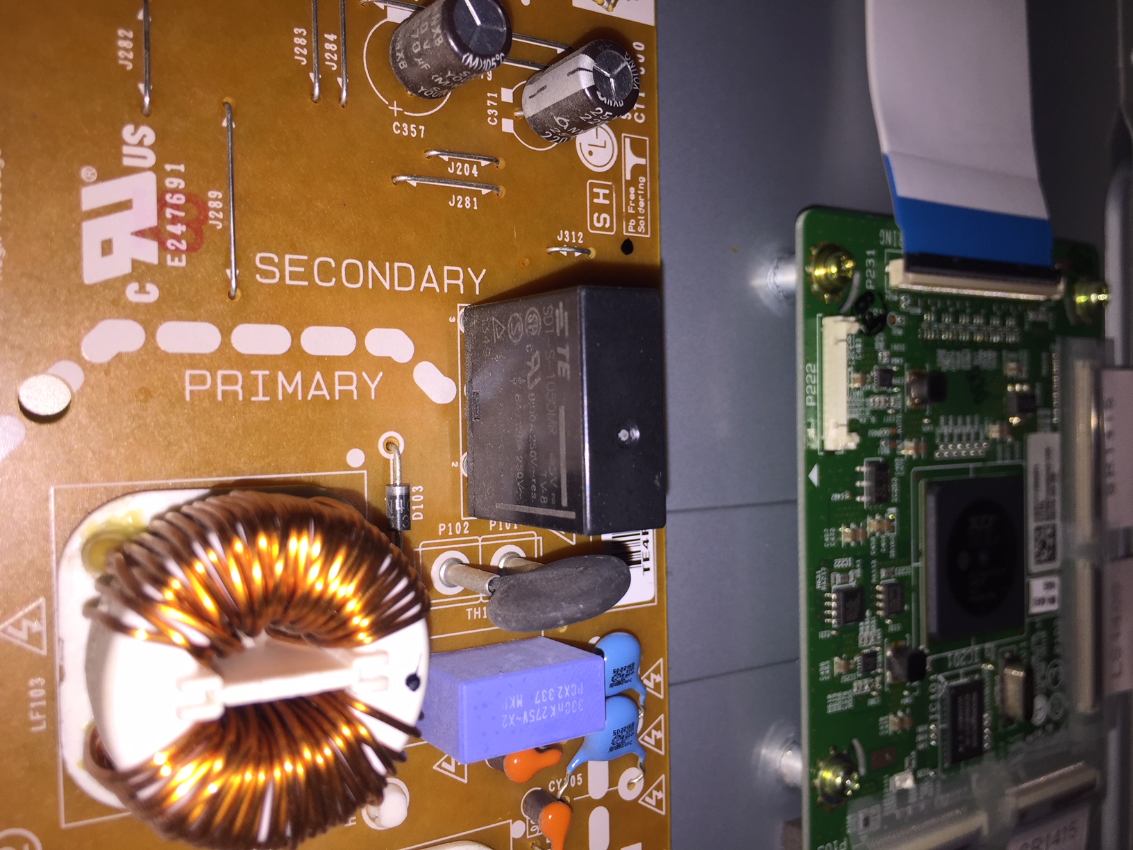

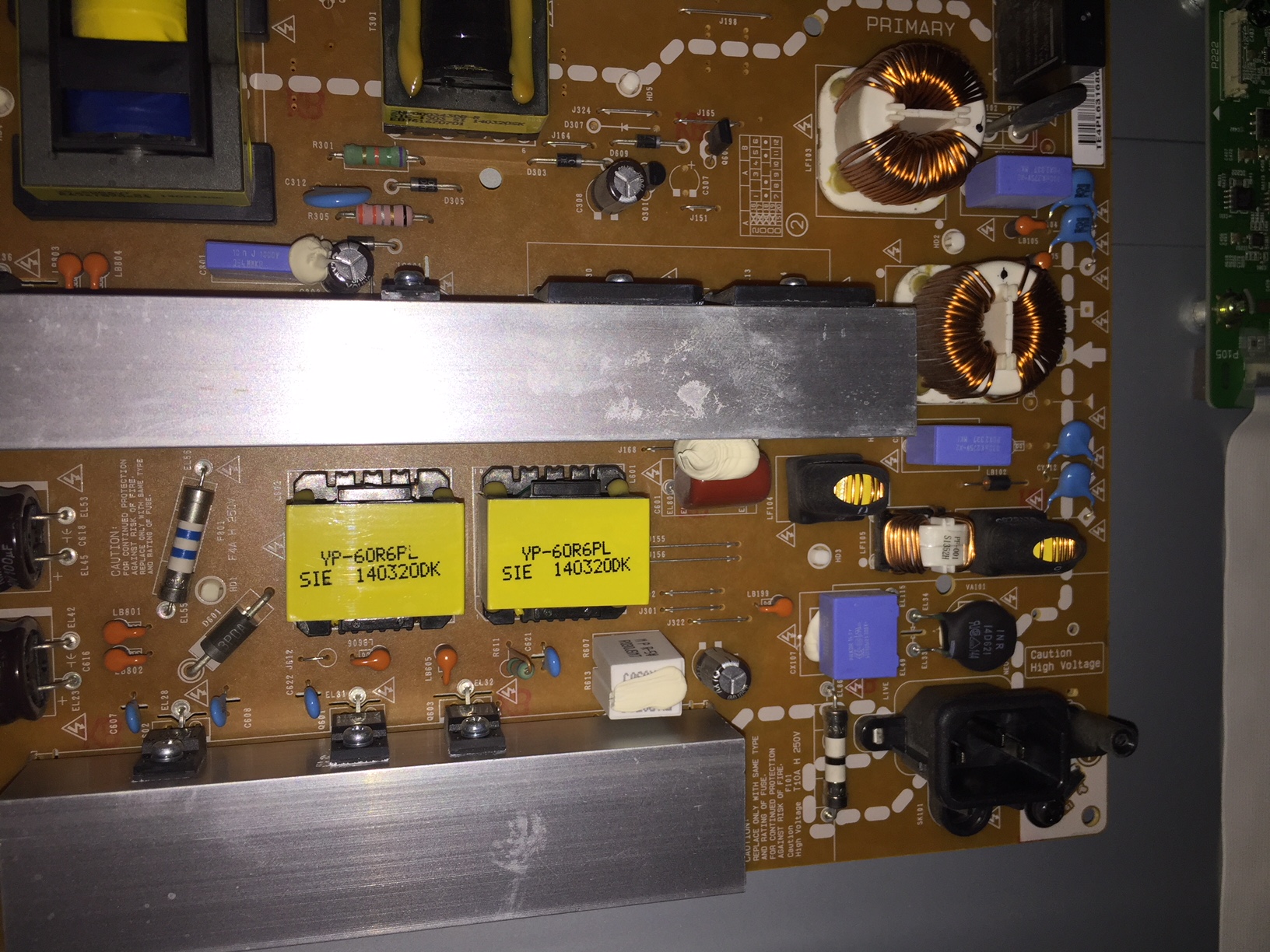

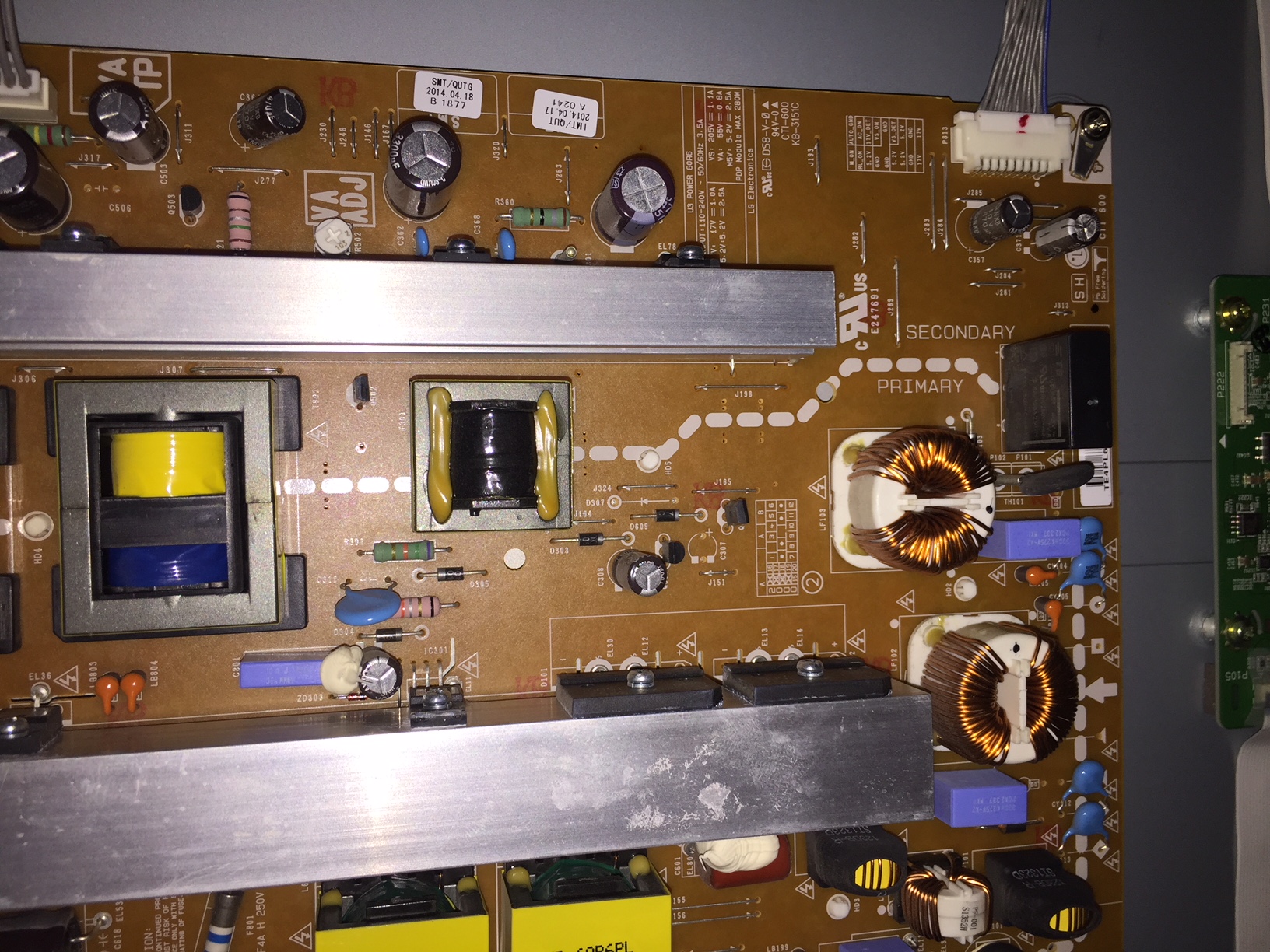

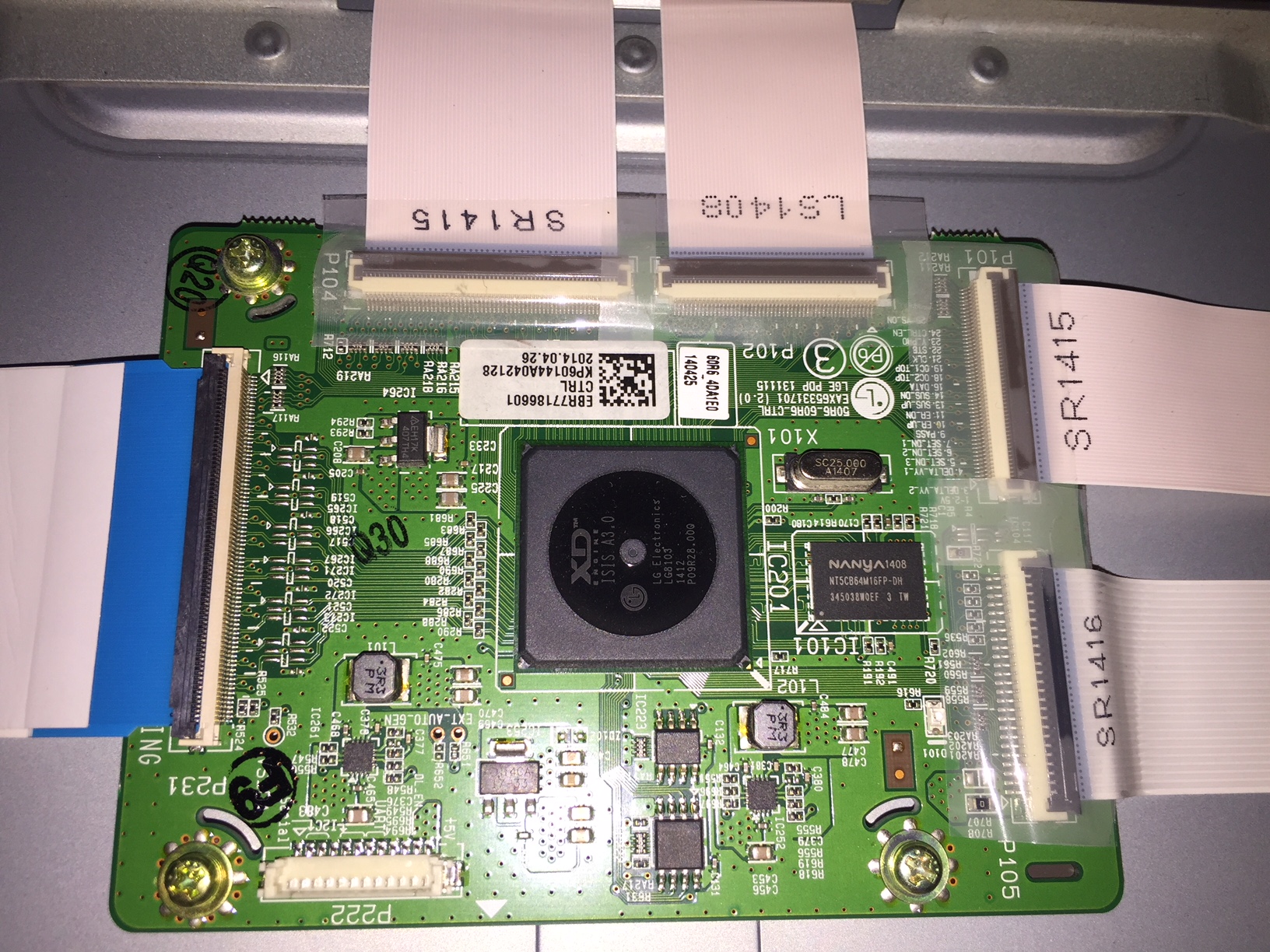

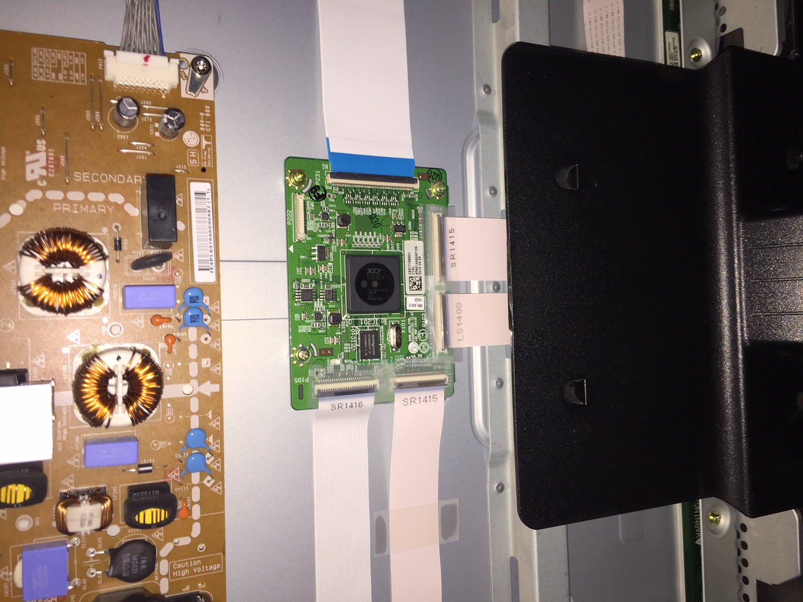

      And some more photos that focus in on the Logic Board. If the Power Supply Unit is not the culprit, could it be that the Logic Board is faulty given the tests I have conducted and outlined above?
      Apologies for all of the 90 degree rotated photos and the upside down one as well. I'm still not sure why half of my uploads are correct and the other half are askew. If anyone has a clue, let me know how to remedy this.

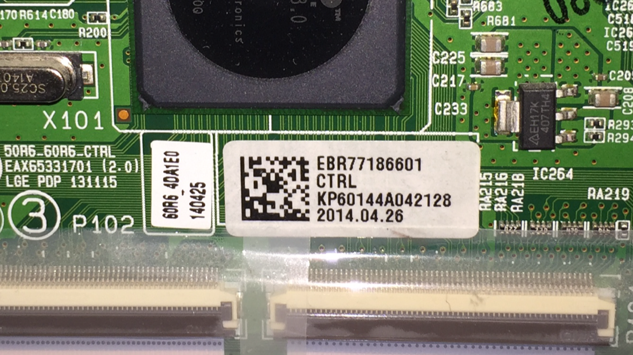

        Dissconnect the cable between the Main board and the control board, Then connect the two points on the control board labeled EXT_AUTO_GEN and plug in the tv, you should see the screen run through a series of tests. If this works the fault is on your main board.
        The LED on the control board is D101 near P105

          Thanks. I do see the location of the LED now on the Control Board. Still have not seen that light up, however, in any and all of my tests.
          As far as the Auto Gen test, I already performed that and there was no change. That's the R651 and R652 reference I made up above in Post # 2.
          I did it twice, just to be sure. Once with the Main Board disconnected from the PSU (with the result being 1 click only, as somewhat expected as that followed the general pattern), and the 2nd time with the PSU and the Main Board still connected (with that result being the repeated clicks, also primarily expected).

            Q: Does the fact that I am getting NO green light on the Logic / Control Board at all, under any scenario I've tested so far, .... coupled with the fact that the PSU seems to be generating correct voltages, ..... and in addition the clicking relay sound remains even if I isolate this Logic / Control Board
            ALL lead to the probability that it is a faulty Logic / Control Board?
            Or, is it not likely that simple?
            If so, they are only about $25 and probably worth the cost to swap out and try. Though I would rather be sure that I have eliminated all of the other boards as possibilities first.

              I have seen another test for the same control board on a 50PB5600 but I have never used it
              After disconnecting the tape between "Main" and "Logic" and shorting Pin 1 and Pin2 of the P222 connector on "Logic" LED D101 flashes in the sequence: long, short, long, short, break etc.
              In this case the person replaced the Y-sus and it fixed the problem

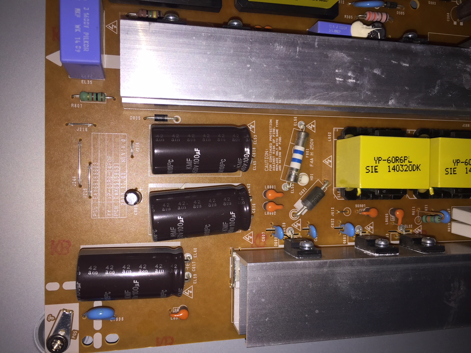

                                I must have misread your second post, I thought you were measuring 205 volts on the VS going to the Y-sus board. Maybe that was with the plug disconnected between the power supply and the Ysus.
                                Usually one of the first tests is to check the resistance across the VS plug on the Ysus if the VS voltage is being killed.
                                You will need to check for shorted fets on the board.
