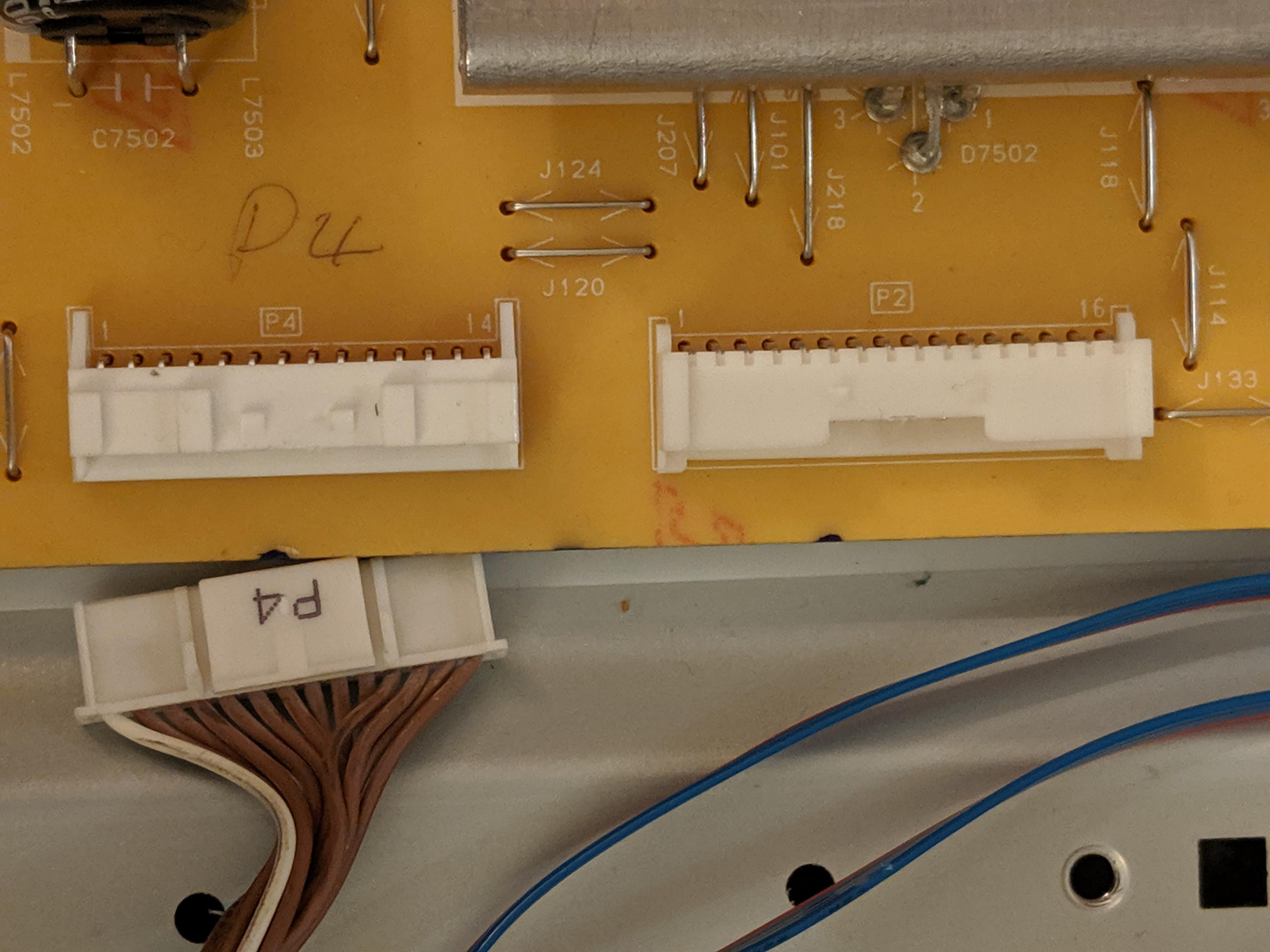

          I'm not sure I understand what you mean. Here's a picture of the connectors on the power board.

            Re: Panasonic Viera TX-L32E3B won't power up, green LED flashing

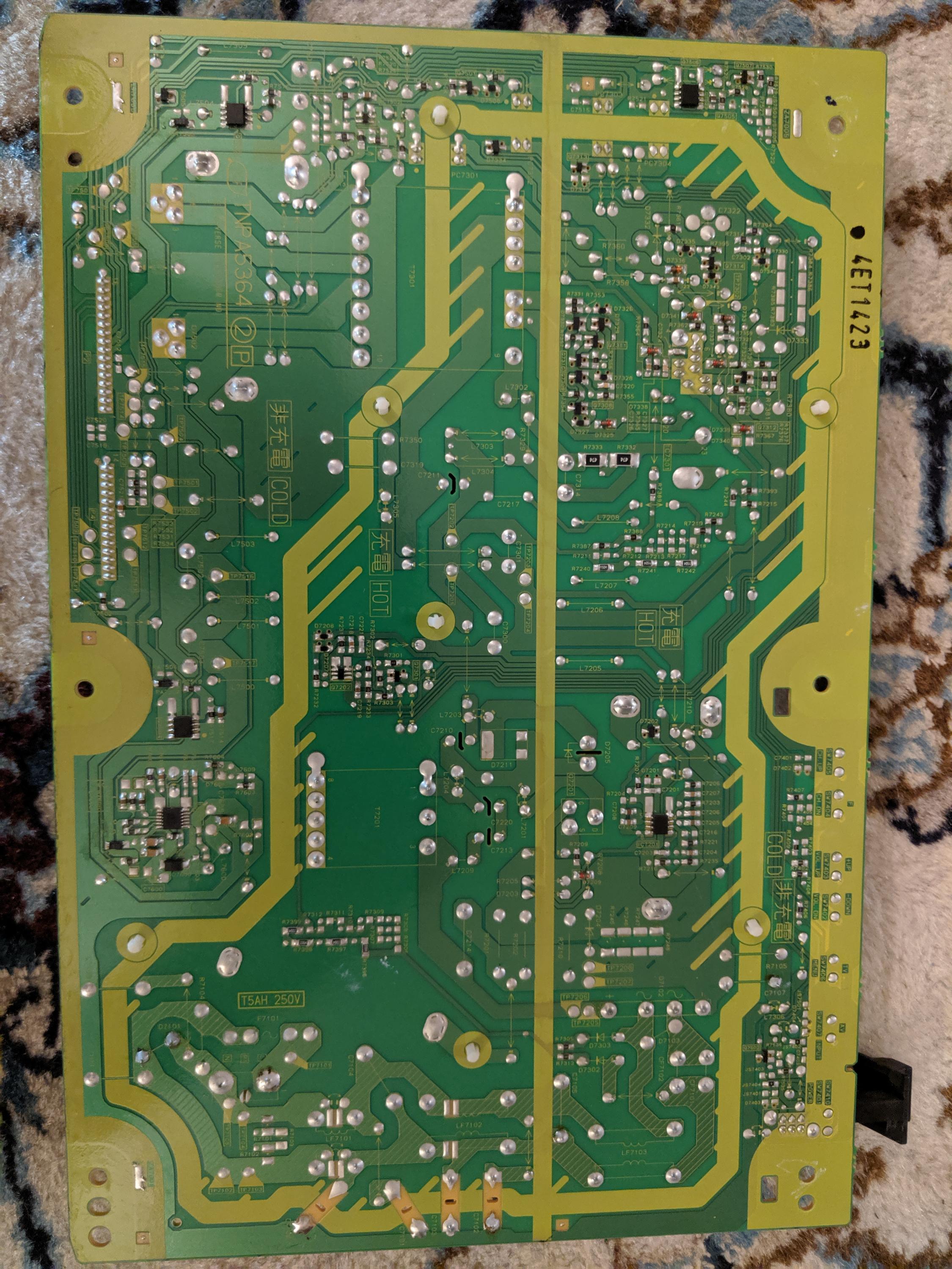

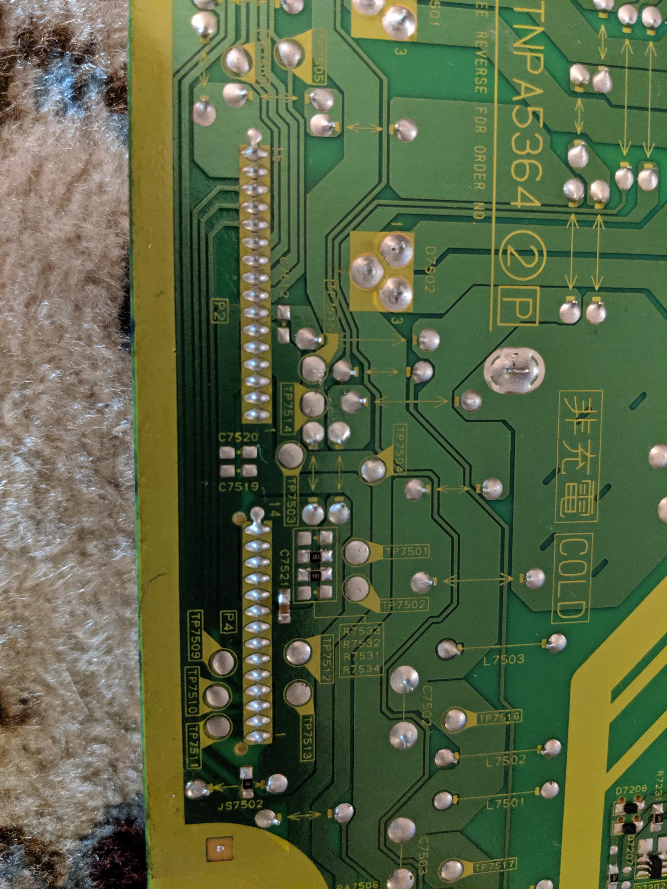

            take the psu out and look on the down side if there printed label described the name or volts of the socket pins which connected to MB
              Can't see anything like that on the back of the board. Photos attached.
                bad things.. so how we will know which pins PW-on and DR-on ..
                disconnect MB to PSU. just keep the LED driver socket connected and plug it on and read all pins volts .. need to narrow and compare with yours first post reading
