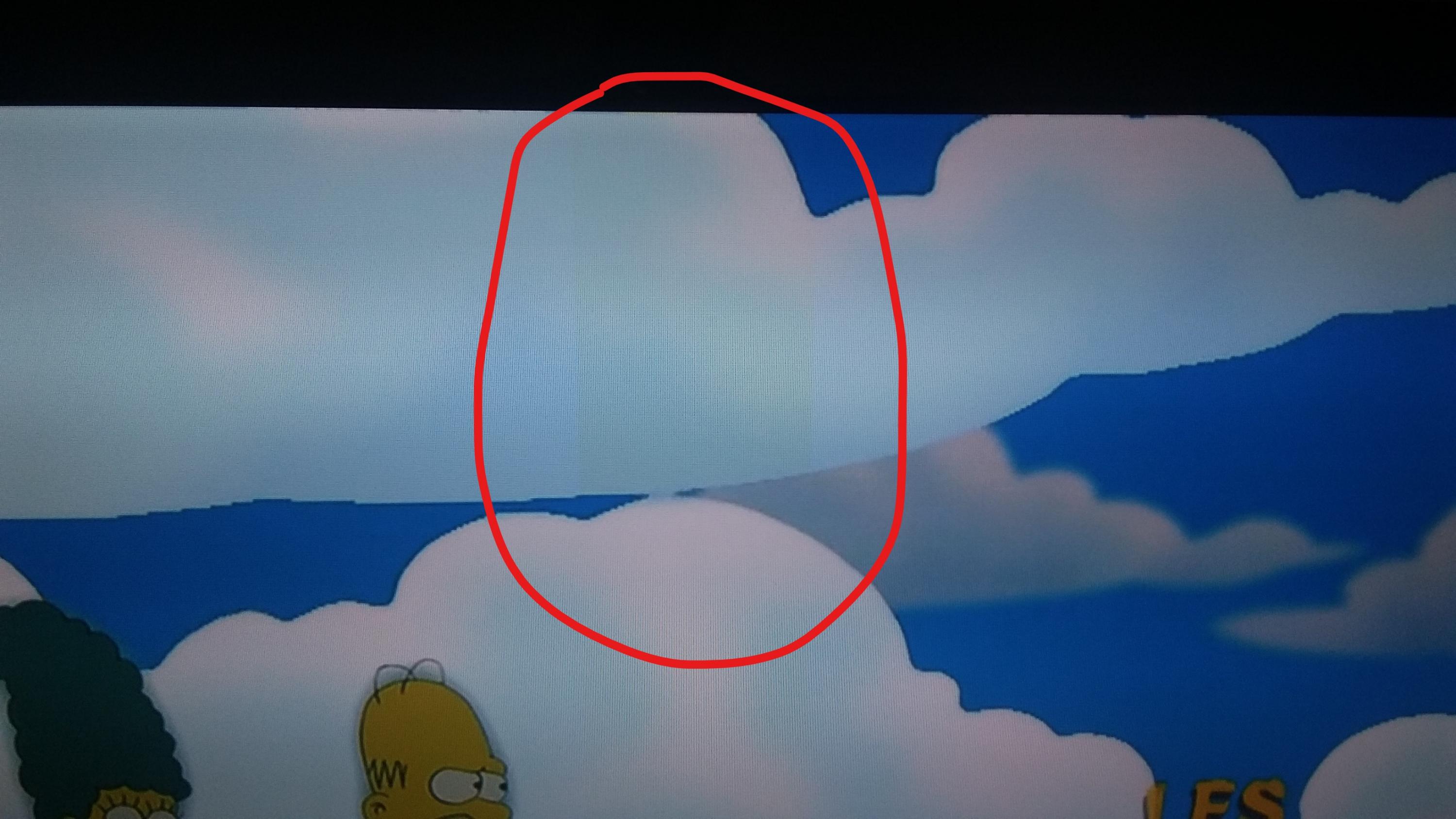

    I get this TV which power up but no LG Logo display or whatever.
    Try to "bake" the mainboard at 385 for 10 minutes without success.
    So, I order a new mainboard which at first.... has the same problem
    since the shipping cost was almost the price of the board itself...
    Again, I try to "bake" it 385 for 10 minutes but then, the TV start and everything seems fines! Nices colors, bright screen...
    But... here's the problems:

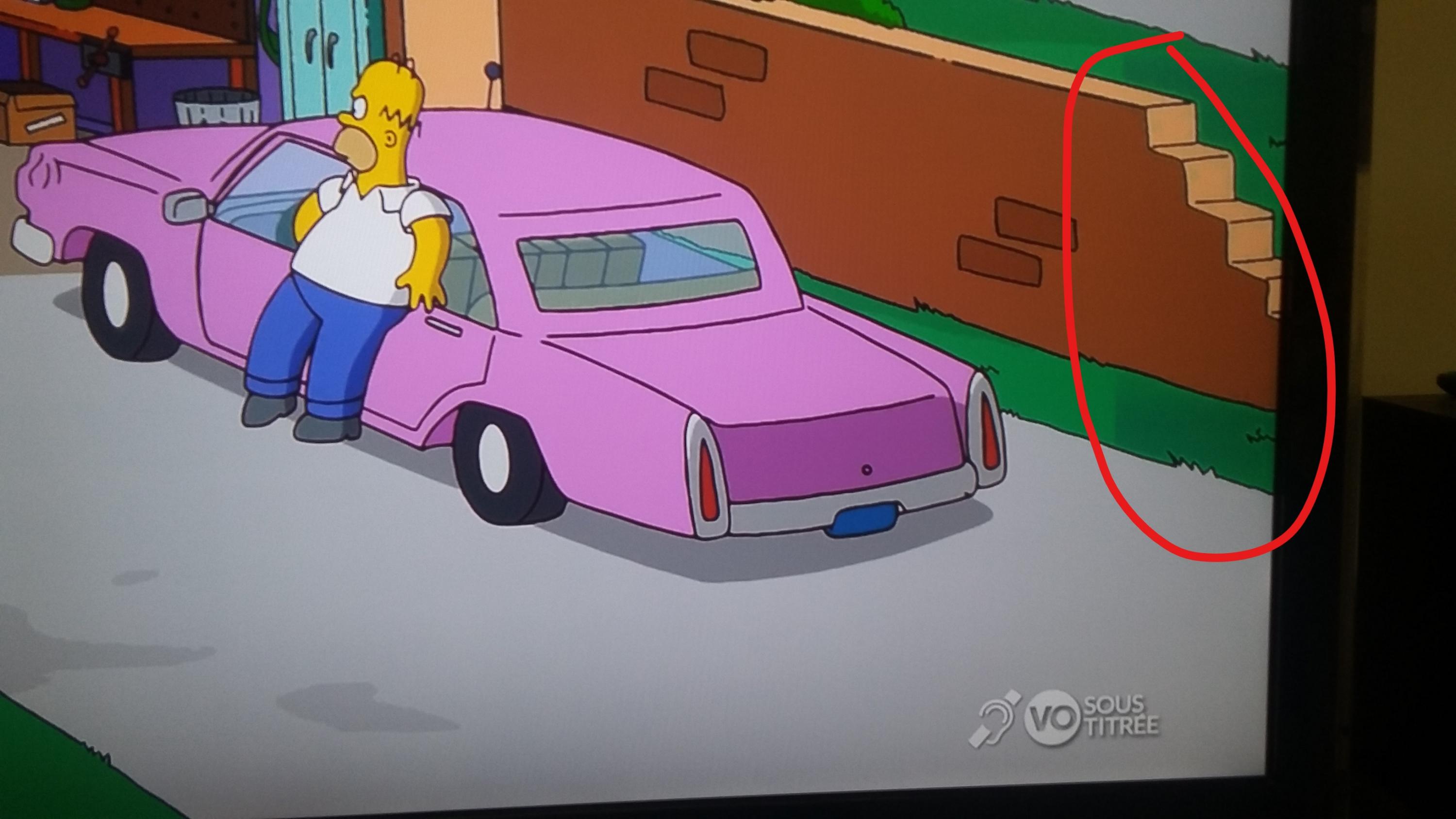

    With some flashy colors (blue sky or yellow (like in simpson)) there's 3 bands on the screen on which there's somes glitch with colors. It's appears only for few frames (almost perfect before you see it... then you only check thoses lines... Theses 3 of them. 20 cm thick.
    But most of the time, thoses are not visible.
    I take picture with a Simpson Episode and pause picture on the right time to get the frame with the maximum "glitch". the next frame, all seems perfect...
    Now I'm wondering... does the screen is defective or maybe it's the T-CON or... still the mainboard...
    but for the T-Con and Mainboard.. I think that the problem would be more visible ...I think... (like whole screen or half screen problems) no??

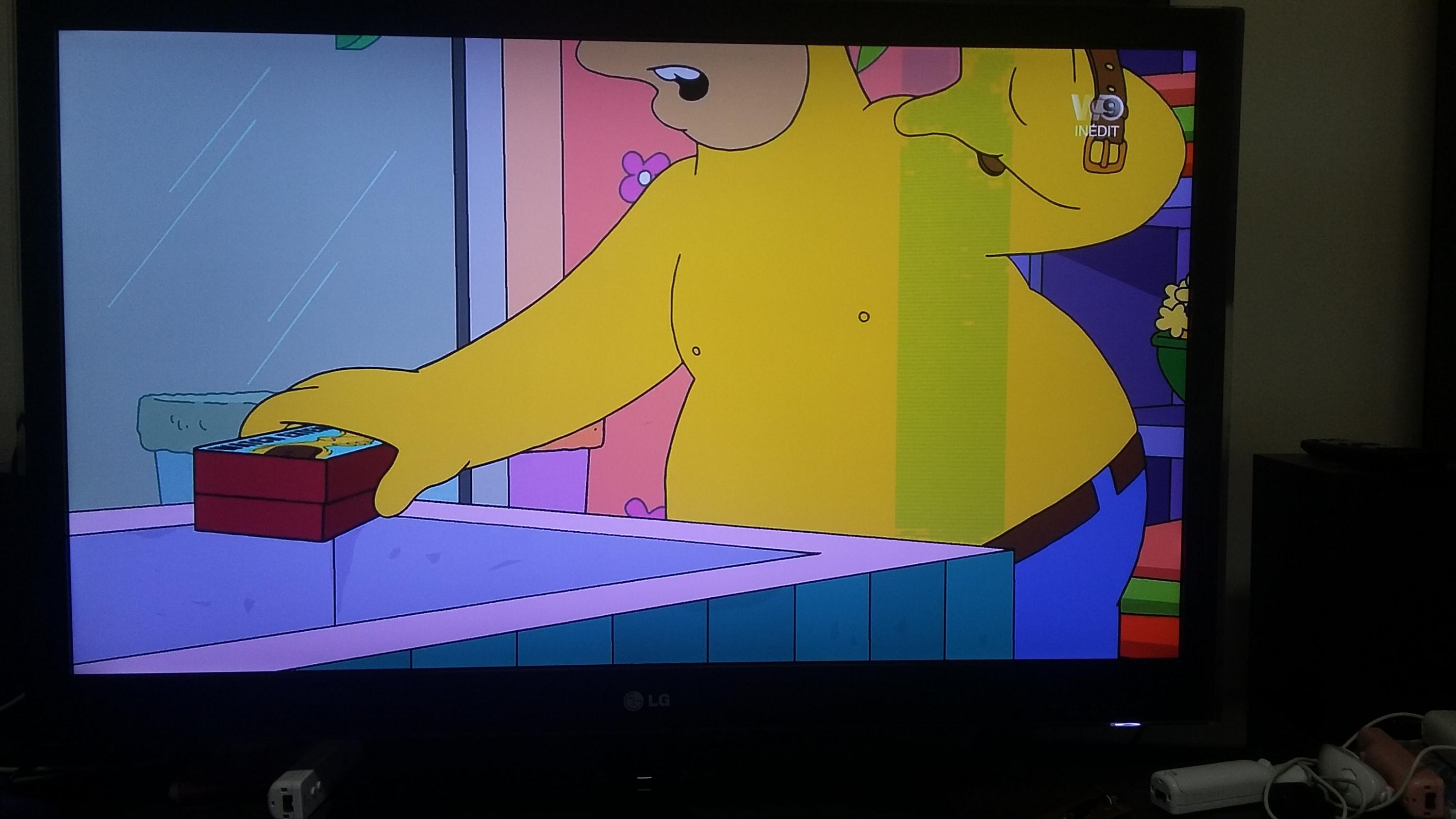

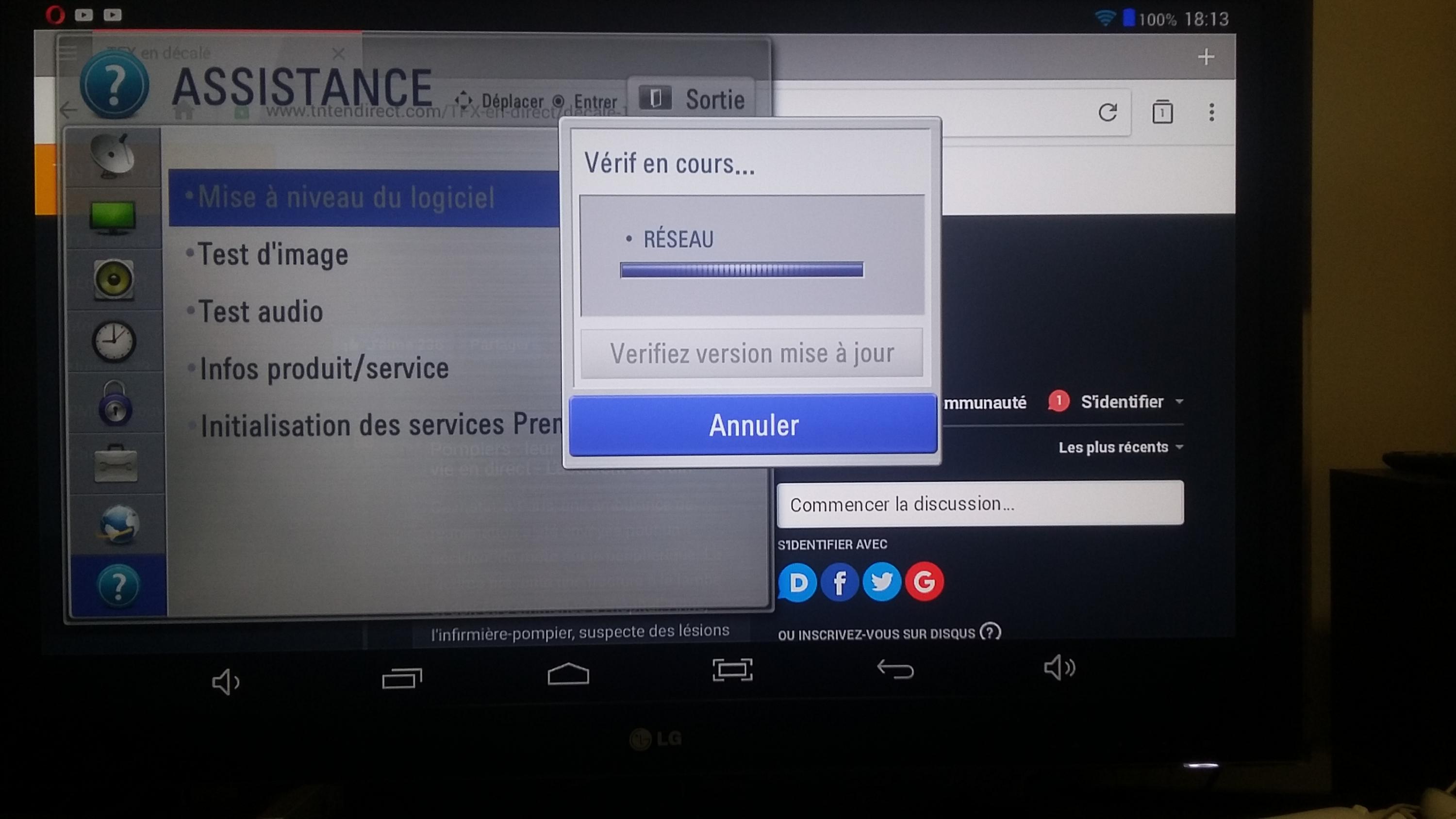

    But here, most of the time, the picture is perfect (see the first image checking for firmware update)
    And even the picture test appear almost perfect except a bunch of red pixels in the yellow bar on the shirt of the player (see football players picture).

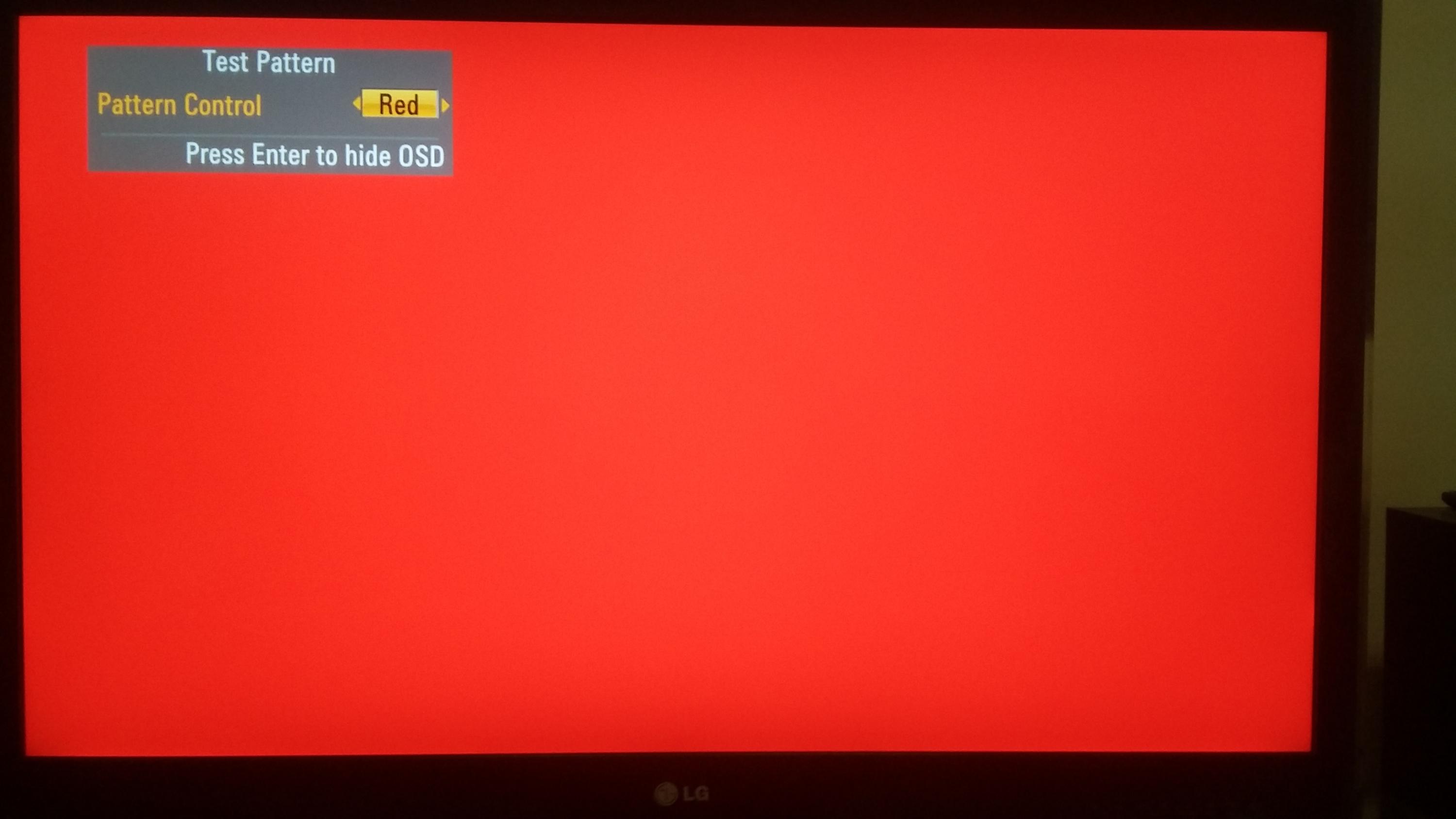

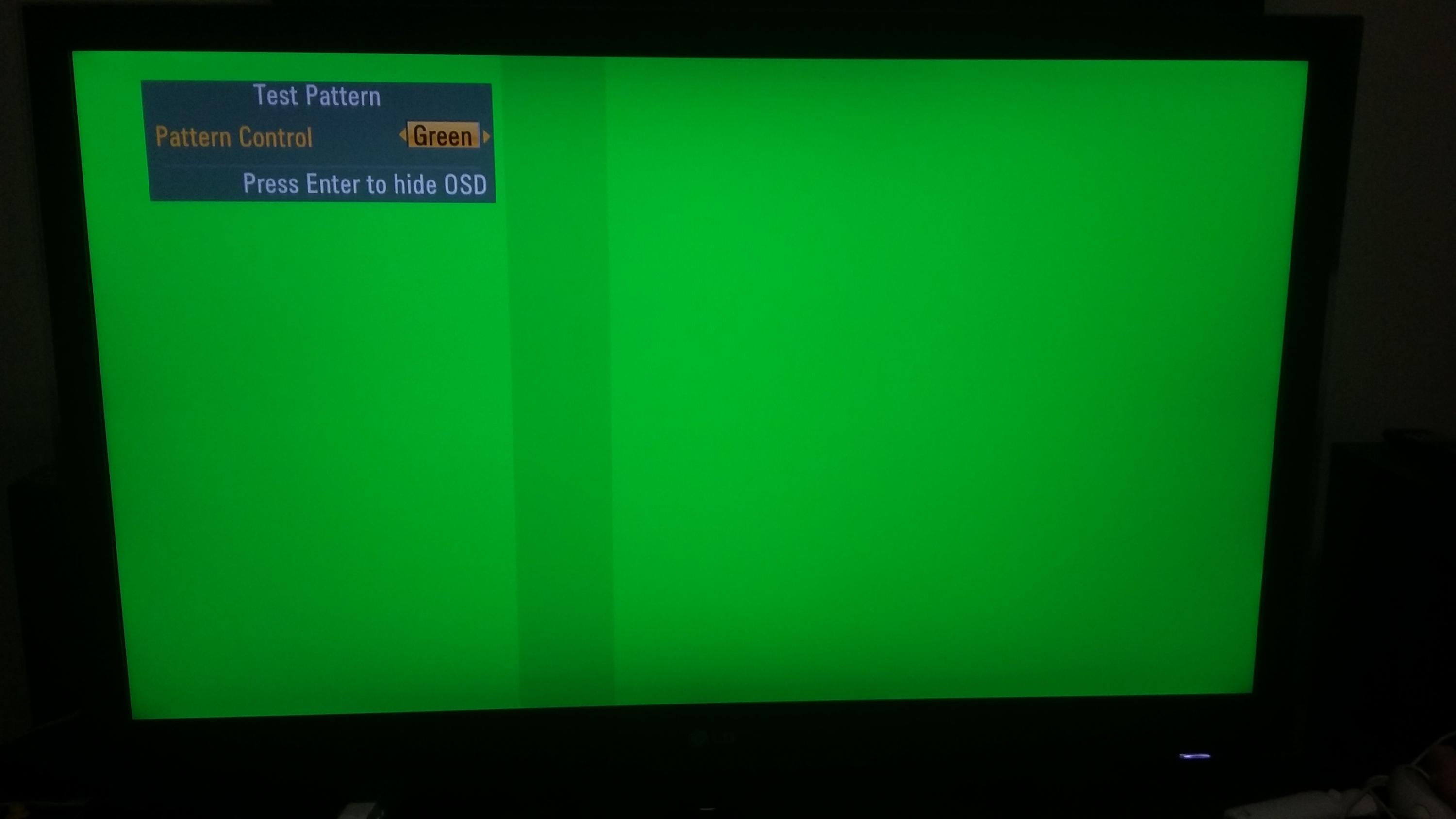

    I do the service remote hack to access the service mode.
    And I do the pattern tests.
    Every colors look fine except sometimes, the green have a darker thick 20cm line. Which I could see when there's light blue sky images.
    (Full red and full green pictures attached)

    Re: LG 42LV5400 problems with vertical band (20cm) with only somes colors
    looks like the tab or driver ic to me.

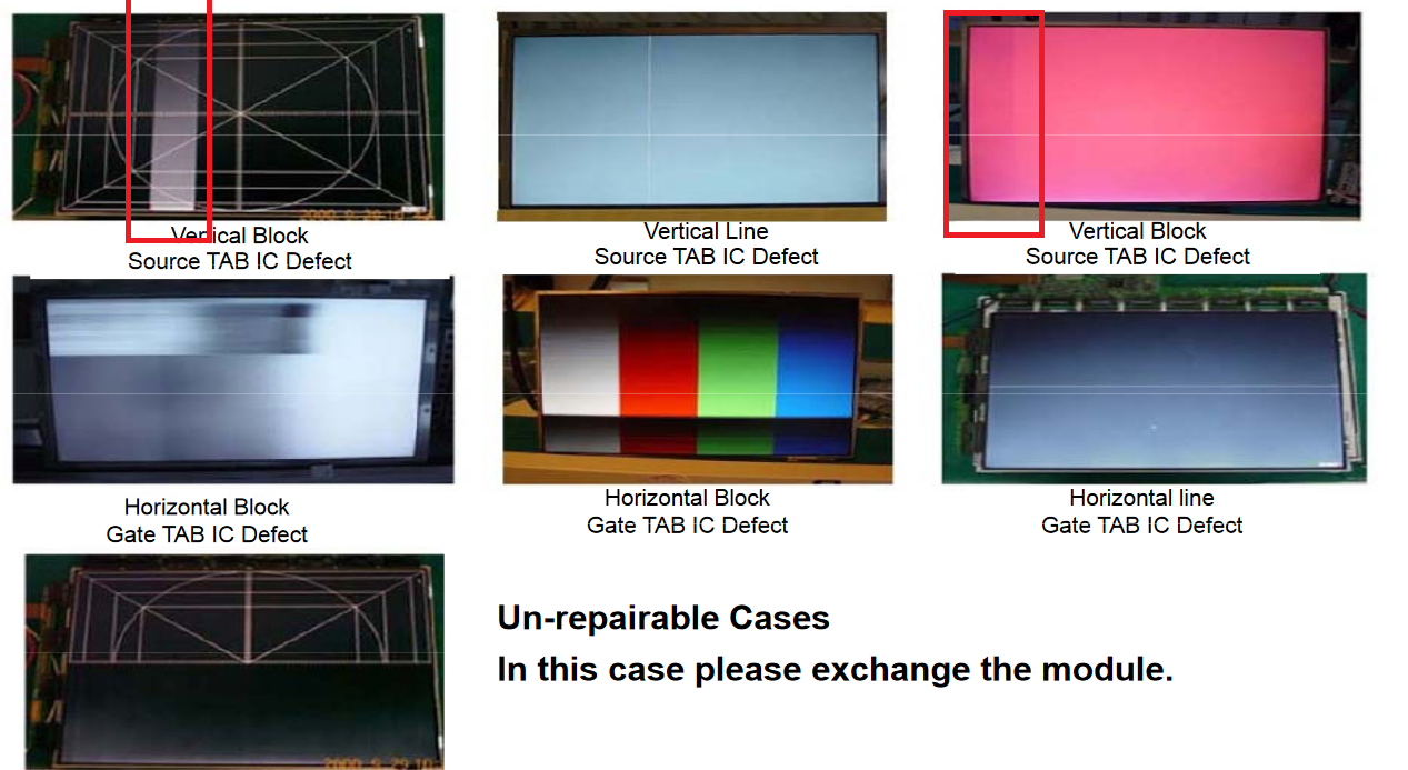

        ... well... I found a service manual for another LG in which they show somes of the potential problems.
        and
        I think you're right CapLeaker...
        The pictures in the manual for a "TAB IC Defect" is exactly what I have on my screen...
        and it said : un-repairable cases.. exchange module..
        so the lcd panel is defective and there's nothing to do it seems...
        thank you all for your help

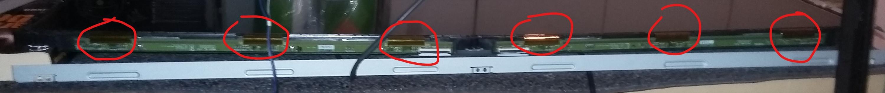

          If it's your own personal tv, not a customers, you can take it down to the tab bonds and apply a little pressure if it clears up, could be candidate for the shim method. If that is the issue.

            Demonstration: https://www.youtube.com/watch?v=FlCHVoSpX_8

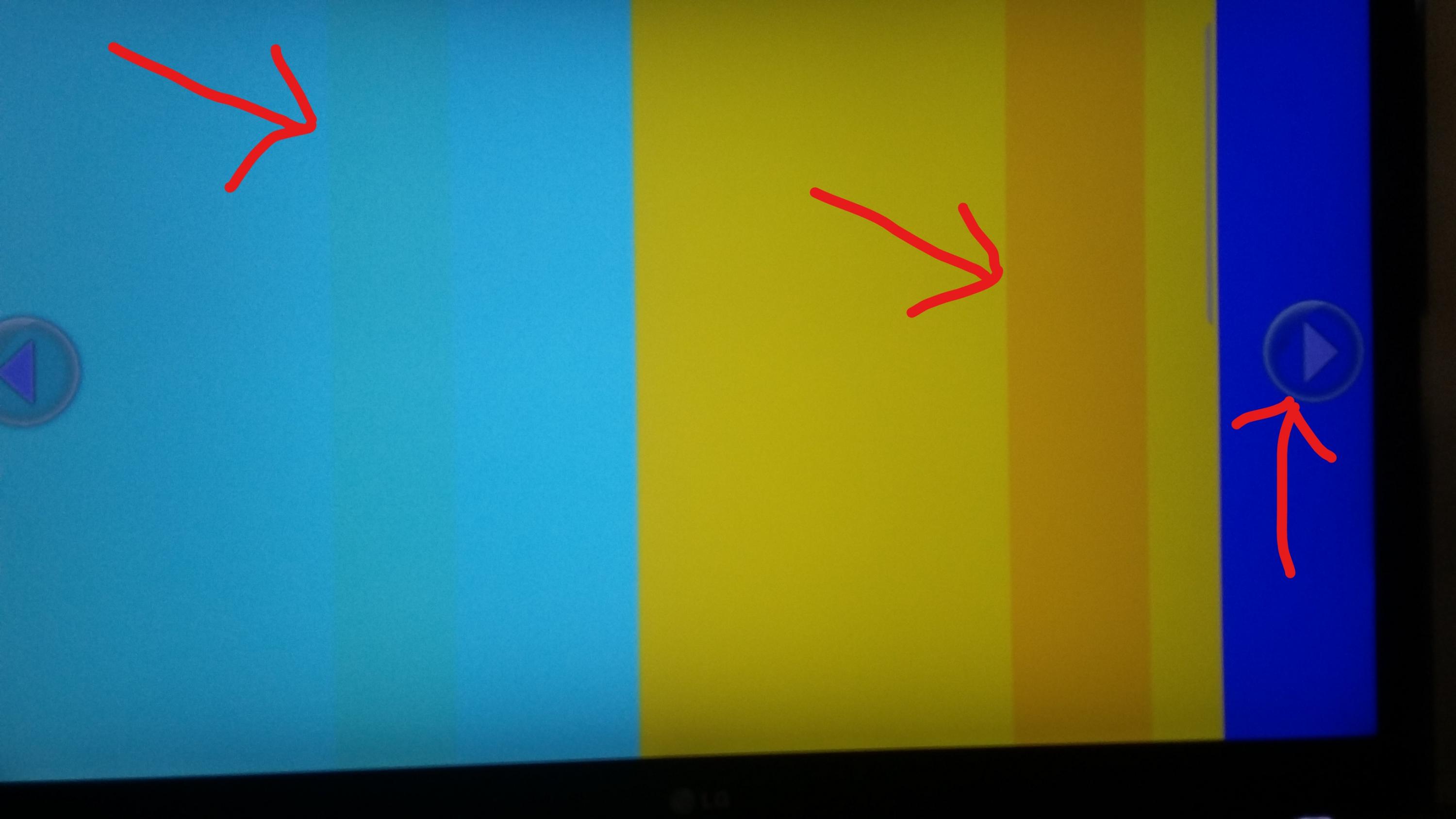

              Because the trouble is hard to see, I made an image with the colors I've got problems. Now we see every vertical block at once
              It will be easier to see if it's works or not
              I keep you updated when I'll try.
              Thank you!
                What's strange to me is how it's moving from one side to the other, usually they're stationary in line with the tab bond.

                    to me its Main board issue, in set ( firmware )test picture & menu displayed correctly . only via video signal source such sat areal cable or av or HDMI will show this issue. if it was panel then the issue will be display on any source.

                      I try to gently push every tab bonds (like in the video) but nothing change in the screen.
                      Maybe it still this sh**y motherboard...
                      or the Tab IC or driver IC like CapLeaker said..
                      the test picture in firmware (football player) show a little glitch also in the same vertical block part.
