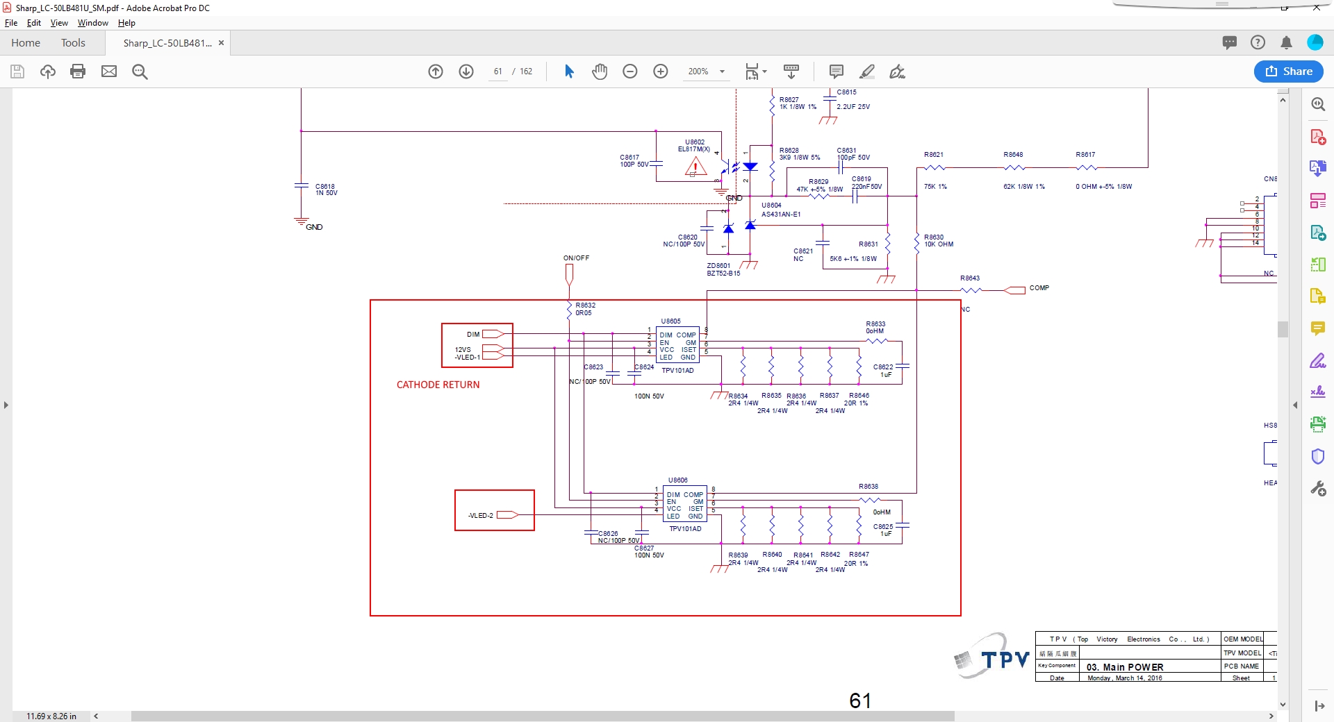

            Got the schematic. Page 61 has the led configuration
            Mykolas

              I believe resistance network r8607-r8615 would have to be increased. Am I right about this? Is there any other circuit that would need to be changed at the same time?
              Thanks for any insight,
              Mykolas

                Re: SHARP/BESTBUY LC-50LB481U Need to lower current to led"s
                Looks like mostly they just raise the resister value which lowers the current.

                    What page of the service you ref those resistors to?
                    Page 56? I do not see R8607 ~ 8615, that's 9 resistors?
                    Is LED controller IC U8601 (PF7708AS) used on your board? I would look up the spec sheet on that.

                      I'm sorry, the resistor network is located on pg. 61.
                      U8601 is : PF6002AS so far can't find data sheet.
                      Mykolas

                        I think there is a bit of confusion here. The schematic is for three different power boards. Page 56 and 58 are for 32" and 43". They basically use the same IC U8601. Page 61 is for the 50". Completely different circuit.
                        Mykolas
                          You have two LED strings and two LED controller IC's TPV101AD U805 and U806.
                          Pin 6 (ISET) is for setting the current for the LED string by adjusting the value of the resistors attached the ISET pin.

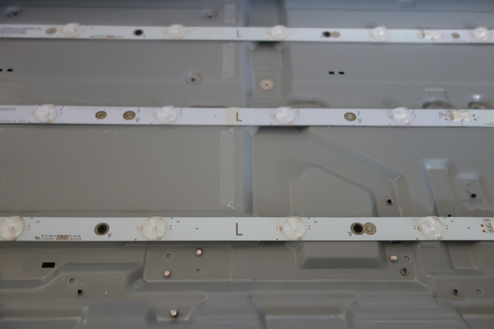

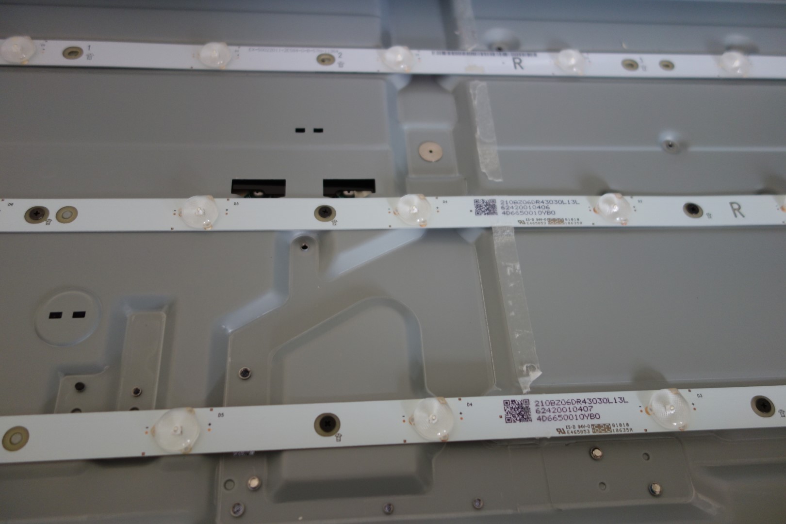

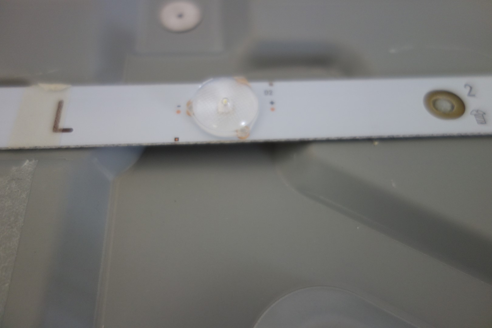

                            Just got this TV replacing 3 bad strips with used ones I had. The default backlight level is labelled TV Brightness and defaults to Brightest (max) after doing a factory reset. Some leds sit in cavities in the chassis so may not get the best heatsinking if floating in the air. I think the combination of these two issues are causing LED failures on this model.
                              Did you take lots of good pictures? OP did not provide any pictures for this TV model, thanks.
                              • neilc6
                                • Nov 2015
                                • 1550
                                No pictures of the back but pictures of how the leds sit on top of the cavities.
