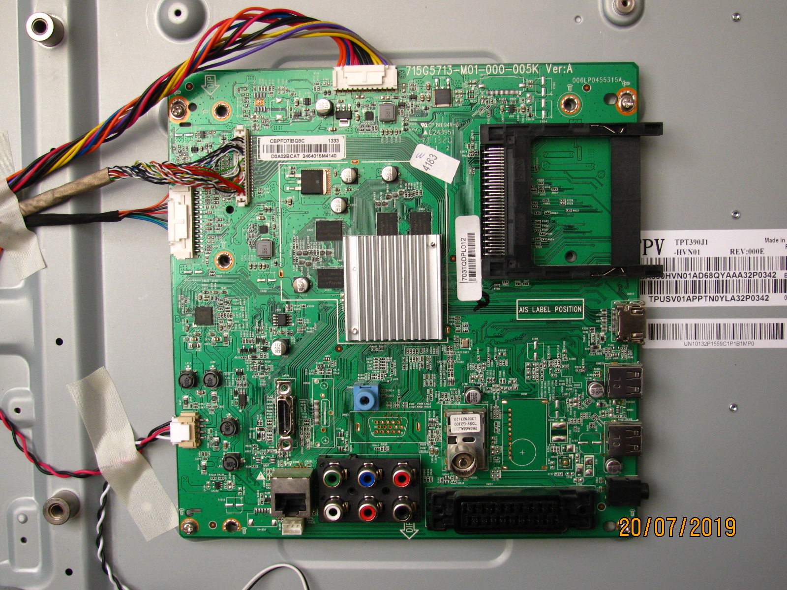

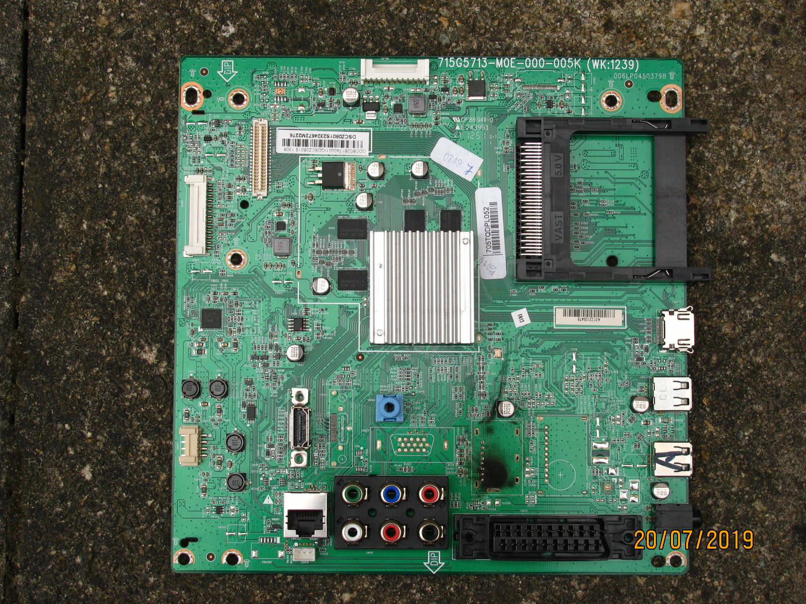

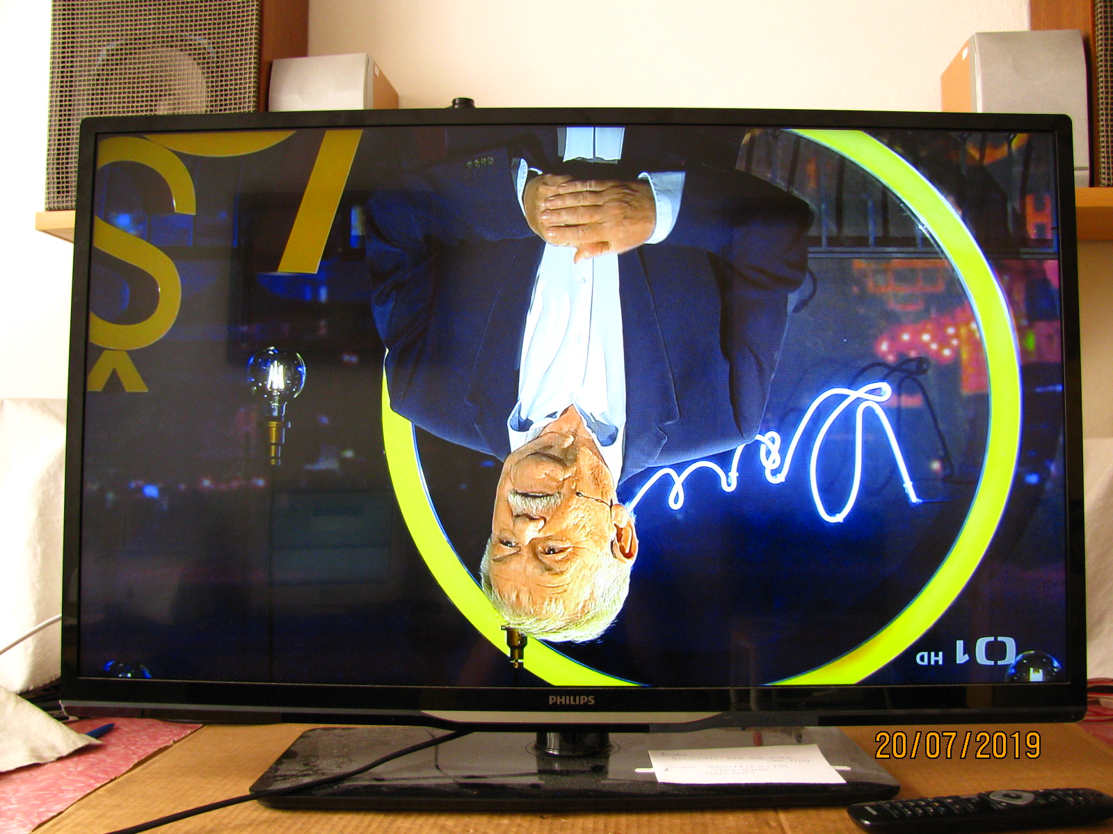

    Hello boys! I have here LCD TV Philips 39PFL3208H/12, chassis TPM10.1ELA, panel TPT390J1-HVN01, main board 715G5713-M0E-000-005K. This original board is burned. I have given there main board 715G5713-M01-000-005K from TV Philips 40PFL3208H/12 instead it. I thought it would be enough to set the right panel TPT390J1-HVN01 in service menu . I did so. The picture is now nice, bud vertikaly turned. Look at the photo. I have no idea how to repair it. Could you help me please? Miloš

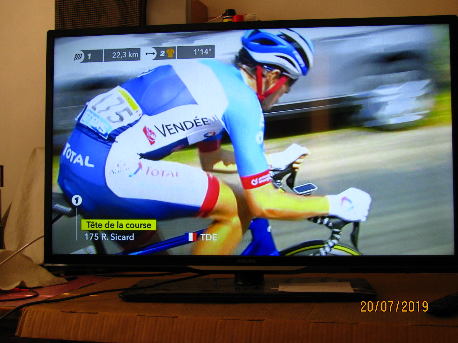

    Press on remote MENU-1999-back and you get into the factory menu, scroll down to HV-flip and set it to yes or no depending. After that scroll down to exit factory. After a cold reset it wil work.
    • milha
      • Jun 2012
      • 48
      • Czech republic
      Re: LCD TV Philips 39PFL3208H/12-turned picture
      William, thank you very much. I did it how you had written. It is working properly now. Have a good luck! Miloš
