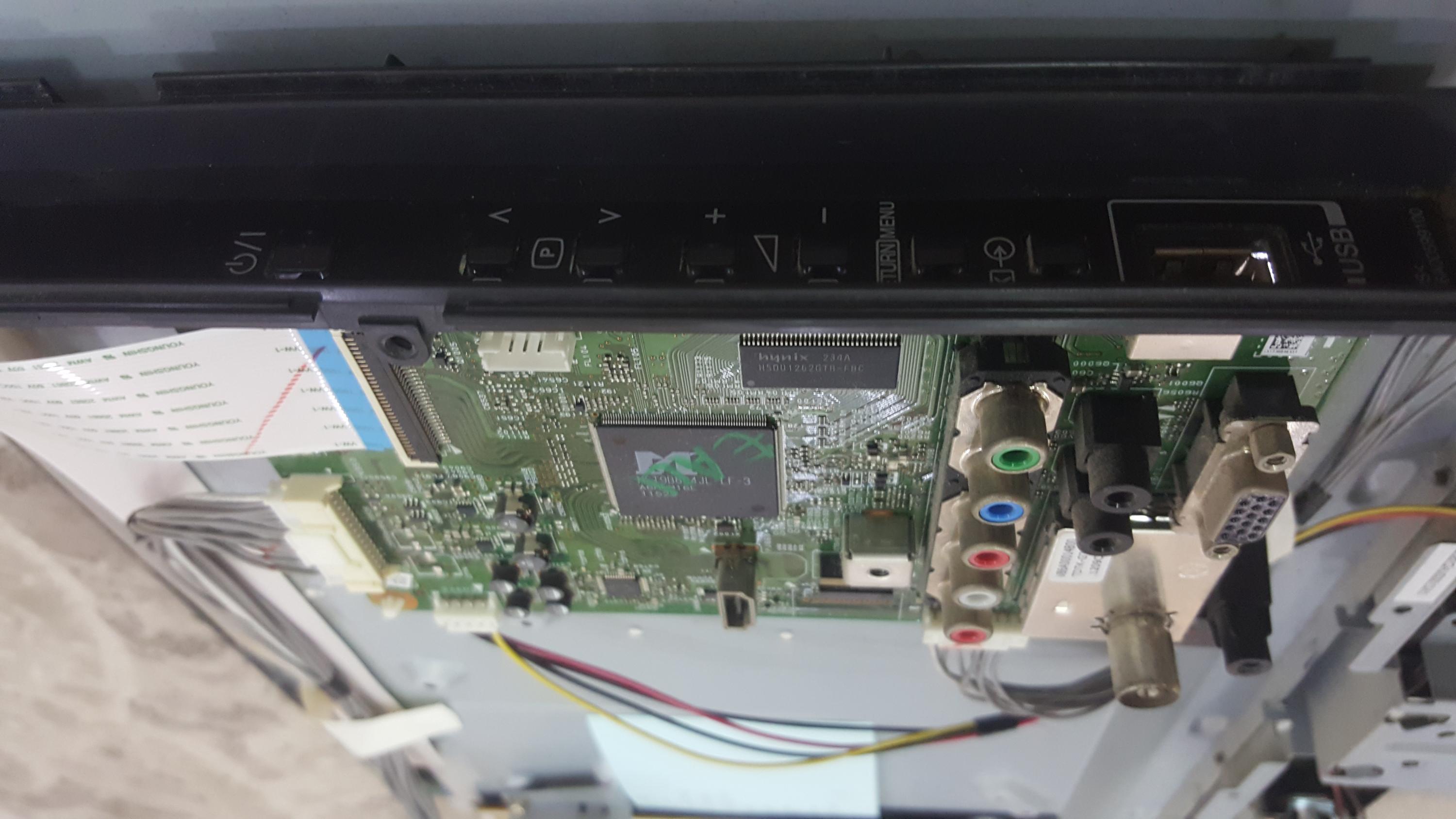

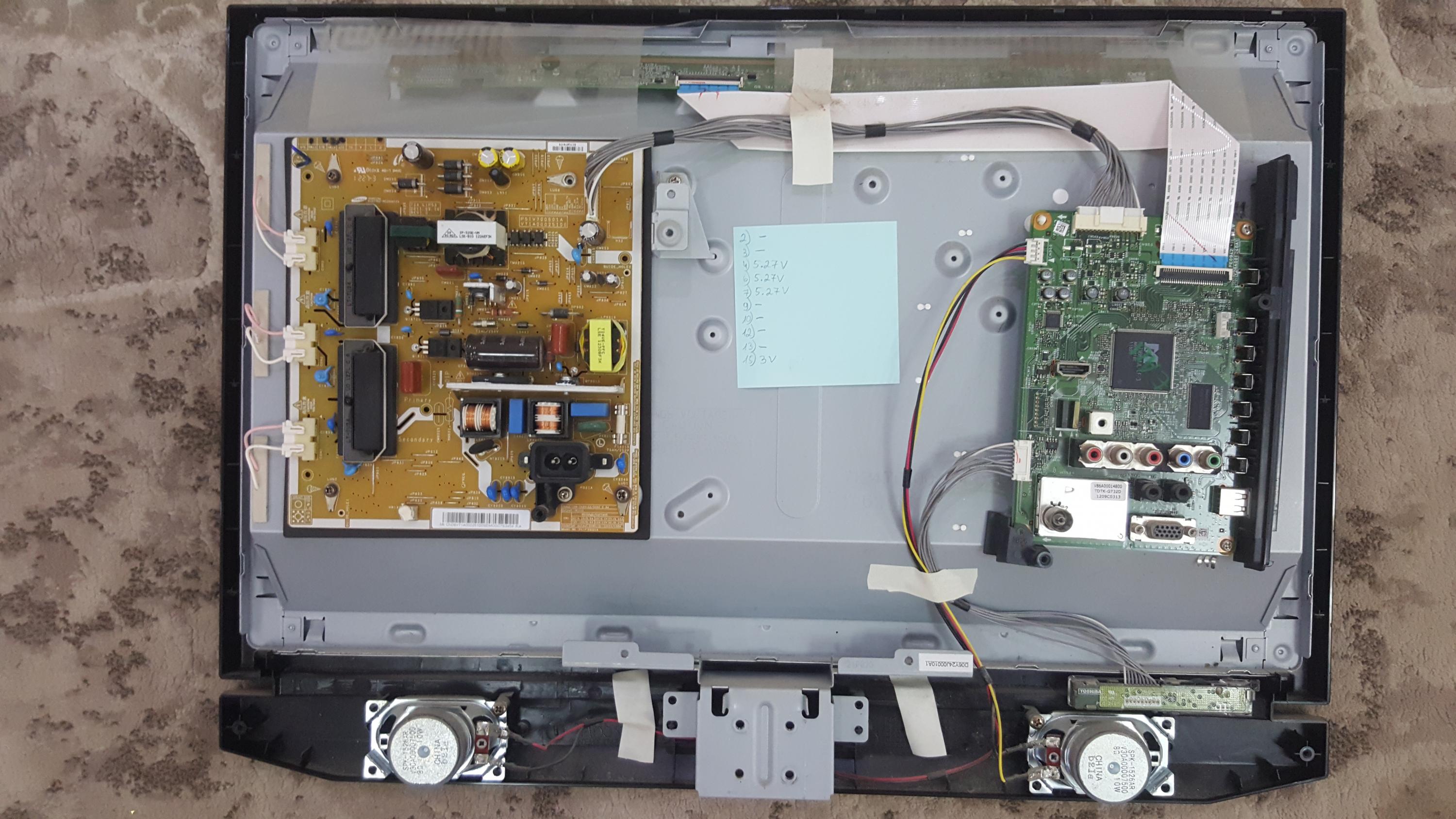

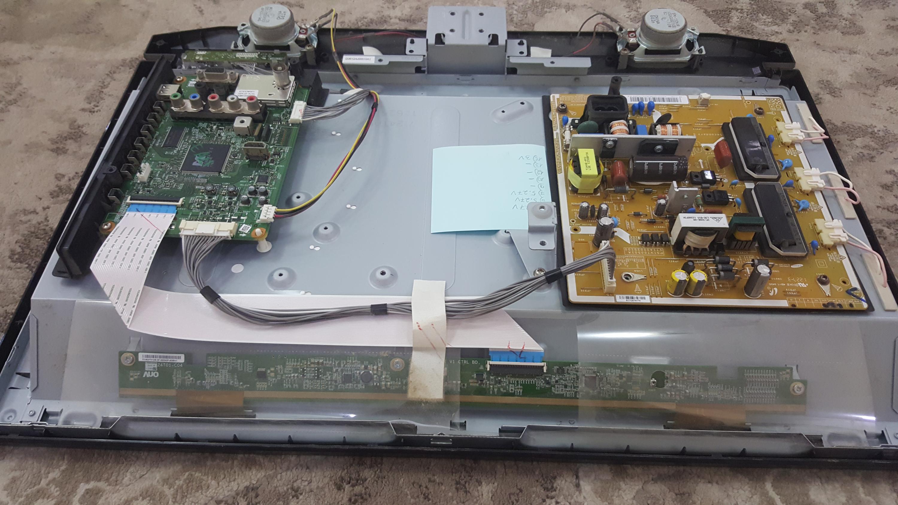

    My grandfather's TV stopped to turn on, has red light.

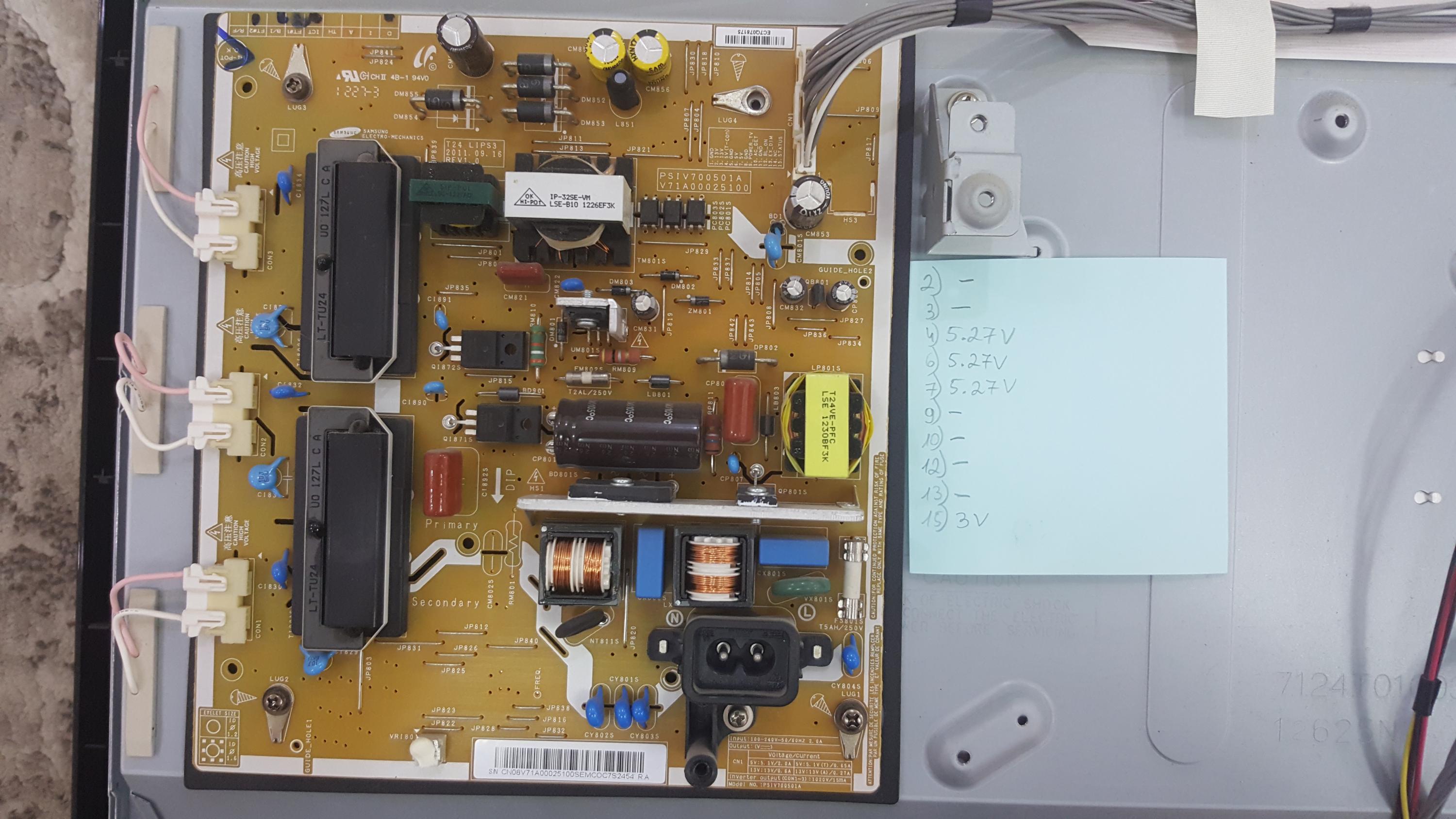

    The capacitors aren't bulged. Diodes are OK (on power supply).
    Has voltages as seen on the small paper that I attached to the photos (when the cable is disconnected-CN1 connection).

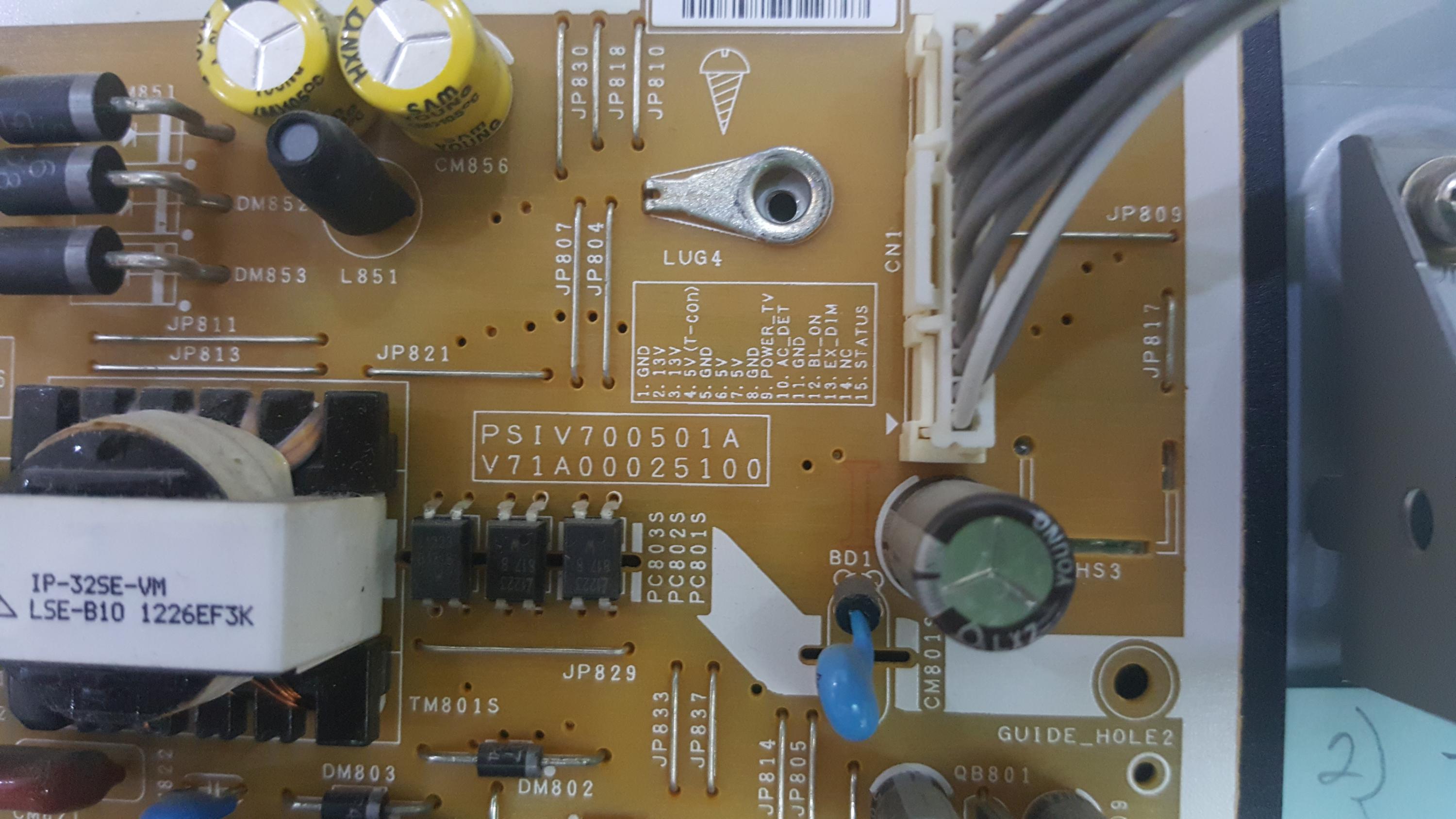

    BUT, when I connect the cable of the main board, I don't see the 3V on PIN 15 which say STATUS.
    Where should I start to check? I have only DMM unfortunatly.
    Thanks for your help guys.

    How can I isolate the problem?
    Is it the PSU or the main board?

      The power source command is set to pin 9 (power tv). Often with "+", about 3v. If you do not find the pin 9 startup command the problem is in the motherboard. Disconnect the source from the motherboard and start the 3 V power source (a 100-1 k resistor between pin 6.7 and pin 9). There must be a voltage of 13v on pins 2.3. With resistance between pins 6.7 and pin 12 (bl-on), the neon lights must be lit.
