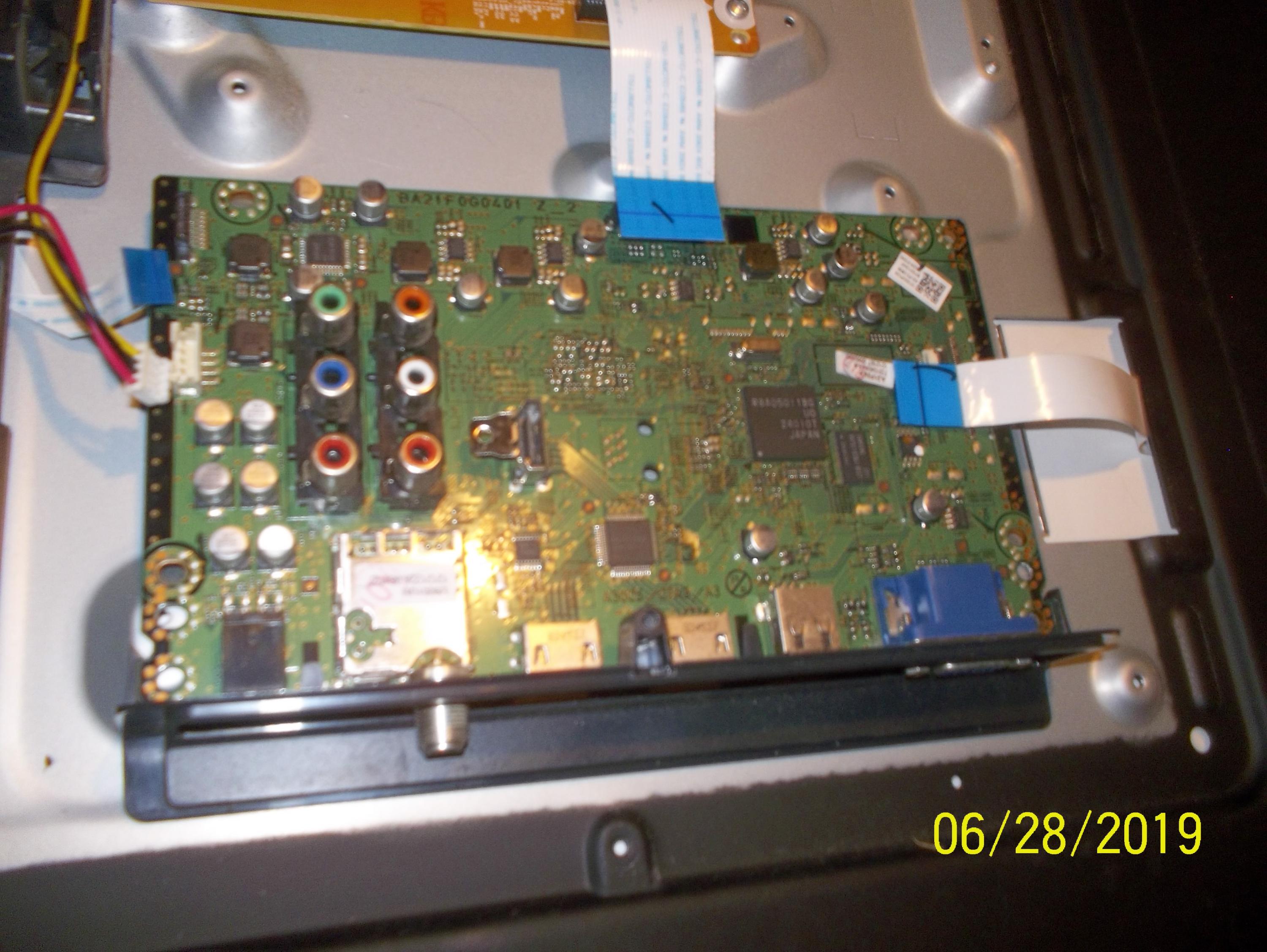

    Hey everyone!
    So I have a TV that just died. Magnavox 32ME402V/F7.
    Pretty sure it's a bad capacitor.
    I'm sure I found one that's bad using my ESR tester. But I have two questions.

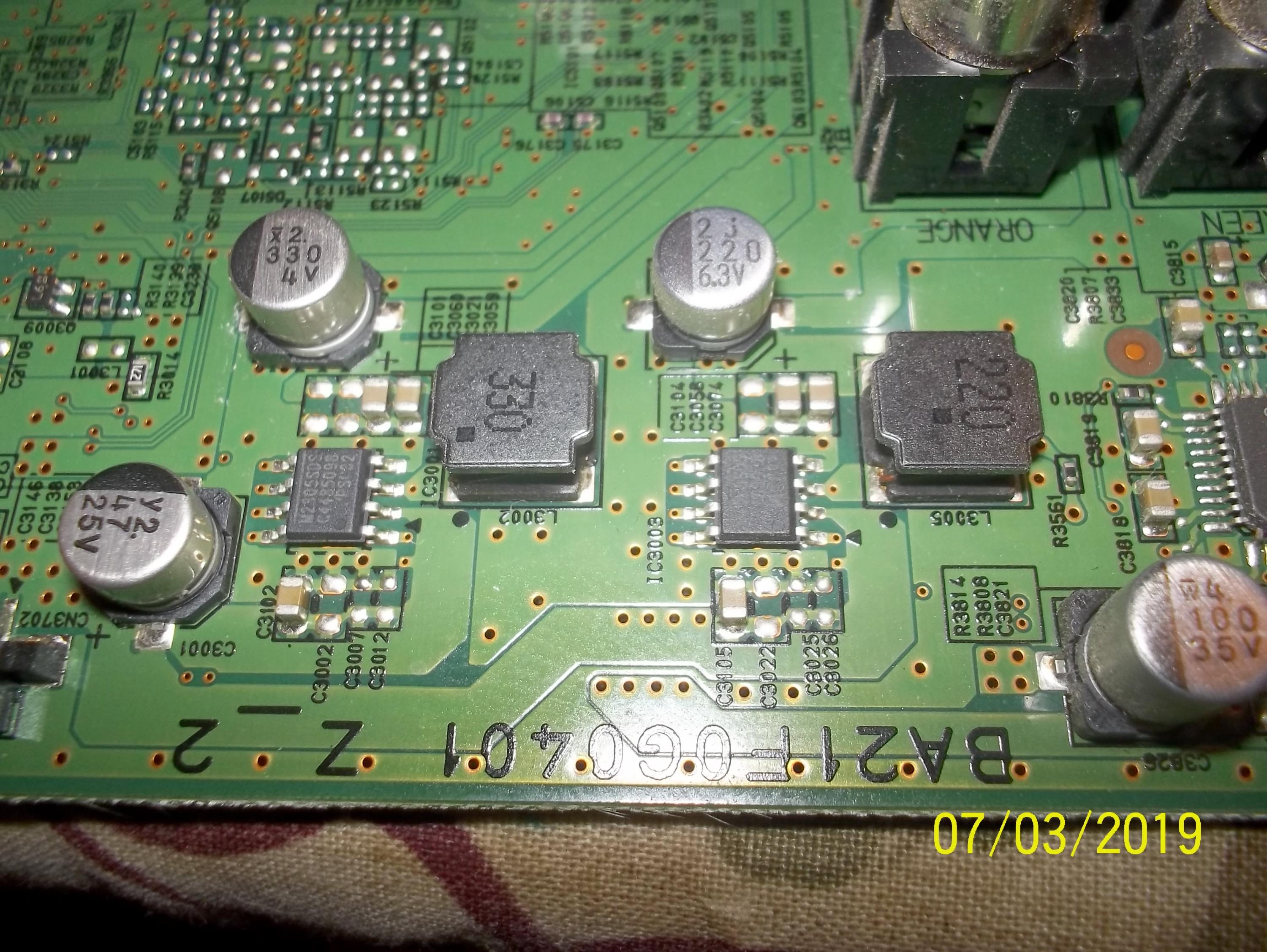

    The one that's bad according to my tester is a 25v 47 mocrofarad SMD aluminum cap. Soneone said I can't just use any general purpose cap. That I needed to know what series to get. I have no clue what cap to replace this with.
    My second question is... I have one cap that's 4 volts, 330uF and another that's 6.3 volts, 220uF. My ESR (or MESR) Tester has a chart that starts at 10 volts. So how do I test those lower voltage caps. Is there a chart that would be useful with this tester? It's an MESR-100 esr meter.
    Thanks for all your help!
    Beau

    Can we see the pictures of what we are dealing with? BTW, you should make new post in the TV section.
    Also, did you test ESR with the caps removed from the board?

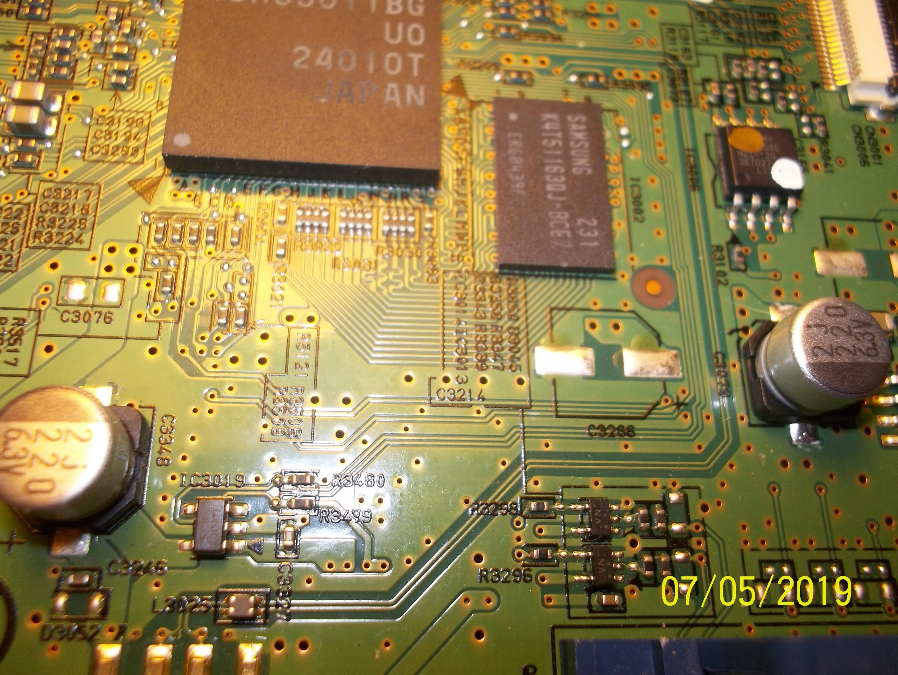

      Re: Main board Magnavox 32ME402V/F7
      Thanks for the response budm!!
      Here's a couple pictures...
      https://www.dropbox.com/sh/ktf8biovy...yHP5E3jGa?dl=0
      I wasn't sure if I could upload them here or not.
      I didn't desolder the caps, I tested them inline. But out of the 4, 25v 47uf caps, 3 read .710 and 1 reads 2.1 leading me to believe that one is bad since the chart on the meter says that particular one shouldn't read above 1.2.
      and again, I don't what the lower voltage ones should read since the chart starts at 10v.
            We need to see pictures of the whole backside of the TV showing all the boards, then good clear straight shot of the whole Top and bottom side of the power supply board which is the board we will want to test the Voltages first, the pictures must be clear enough to read the printed labels, designator as printed on the board.

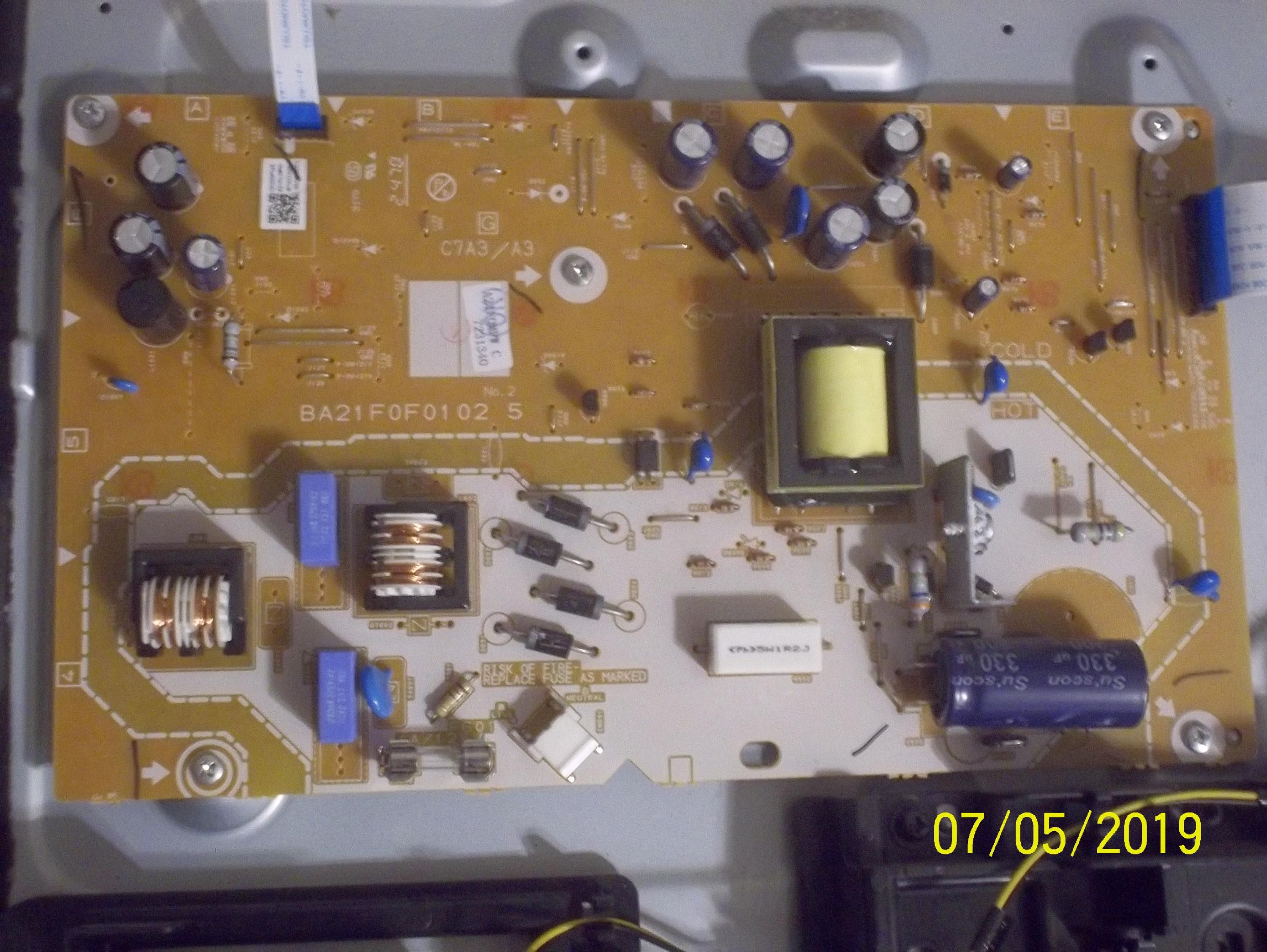

              Got ya!
              Here's a picture of the other board.. Power board?
              Just to give you a little background. When I plug the TV in, it gives off a high pitched squealing sound. I found a video on youtube where the television did the exact same thing. When he unplugged the ribbon connecting the two boards, the squealing stopped. He then replaced one capacitor on the main board and voila the issue was resolved. So that's why I'm thinking maybe I have the same problem.
              Here's the video. Mine is doing exactly the same thing. https://www.youtube.com/watch?v=uAFCTZCb1BA
              If you need more pictures I will be happy to post them. Whatever you need. I REALLY appreciate all your help!
              AND the only tester I have is an MESR-100 esr meter...… Tell me what other tester I should get and I'll order it ASAP!
                Sounds like typical shorted SMD MLCC (not Lytics cap type) cap C3214 for the 21V Line on the main board, but there are other caps connected in parallel with C3214 as well, so you have have to remove several.
                https://www.badcaps.net/forum/showth...light=elefw605
                https://www.badcaps.net/forum/showthread.php?t=76666
                Have all the boards connected back in place then use Ohm meter to check the resistance between GND and jumpers and report the reading: I suspect low Ohm reading on the P-ON 21V which is the one that failed often.
                ALL 3.3V
                P-ON +21V
                Amp +13V
                Your picture is not clear.
                Is this your exact board?
                https://www.shopjimmy.com/magnavox-a...upply-unit.htm
                BTW, you cannot use ESR meter to check cap in circuit, it will never give you the correct reading because there are other components connected to the cap.

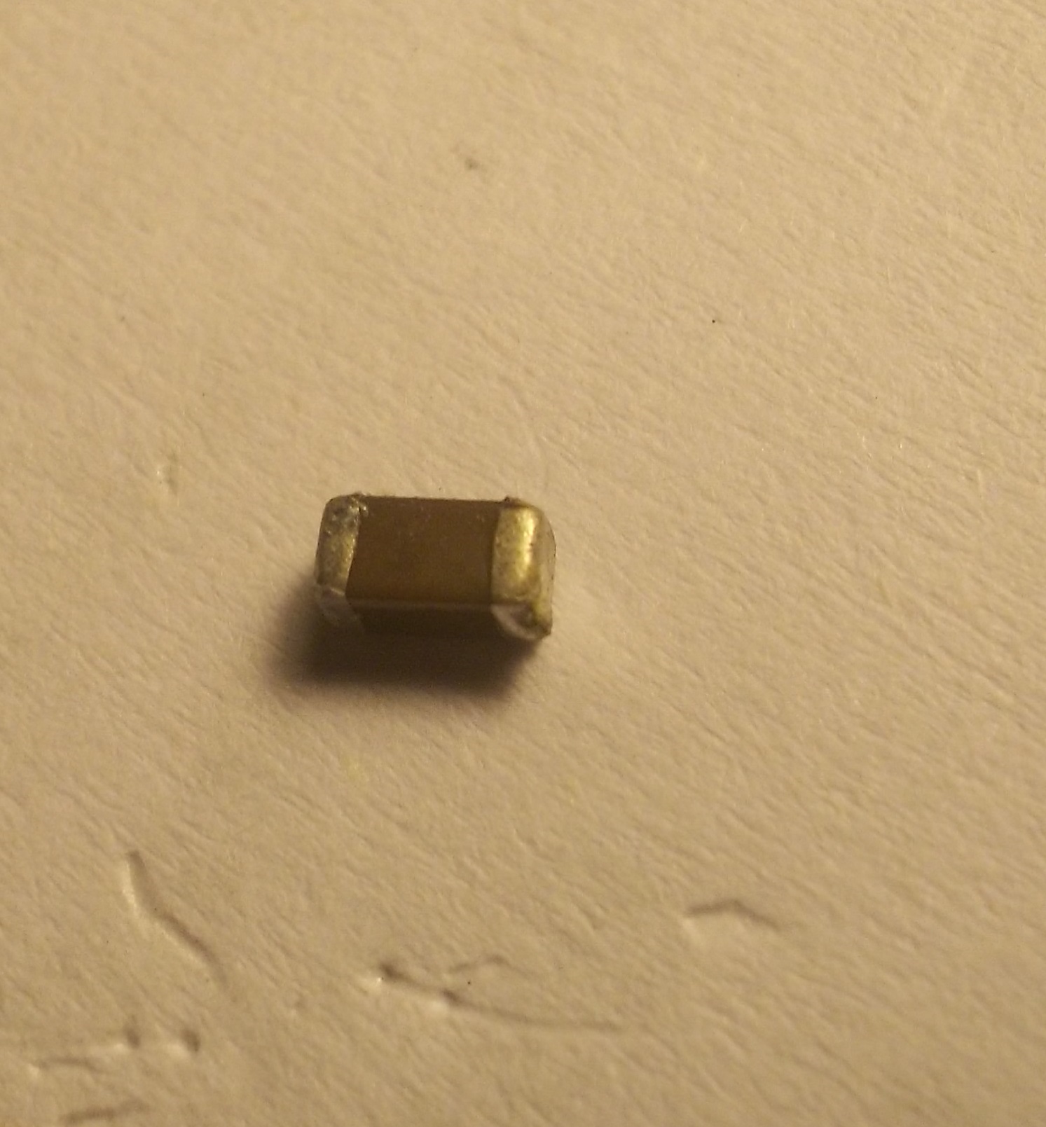

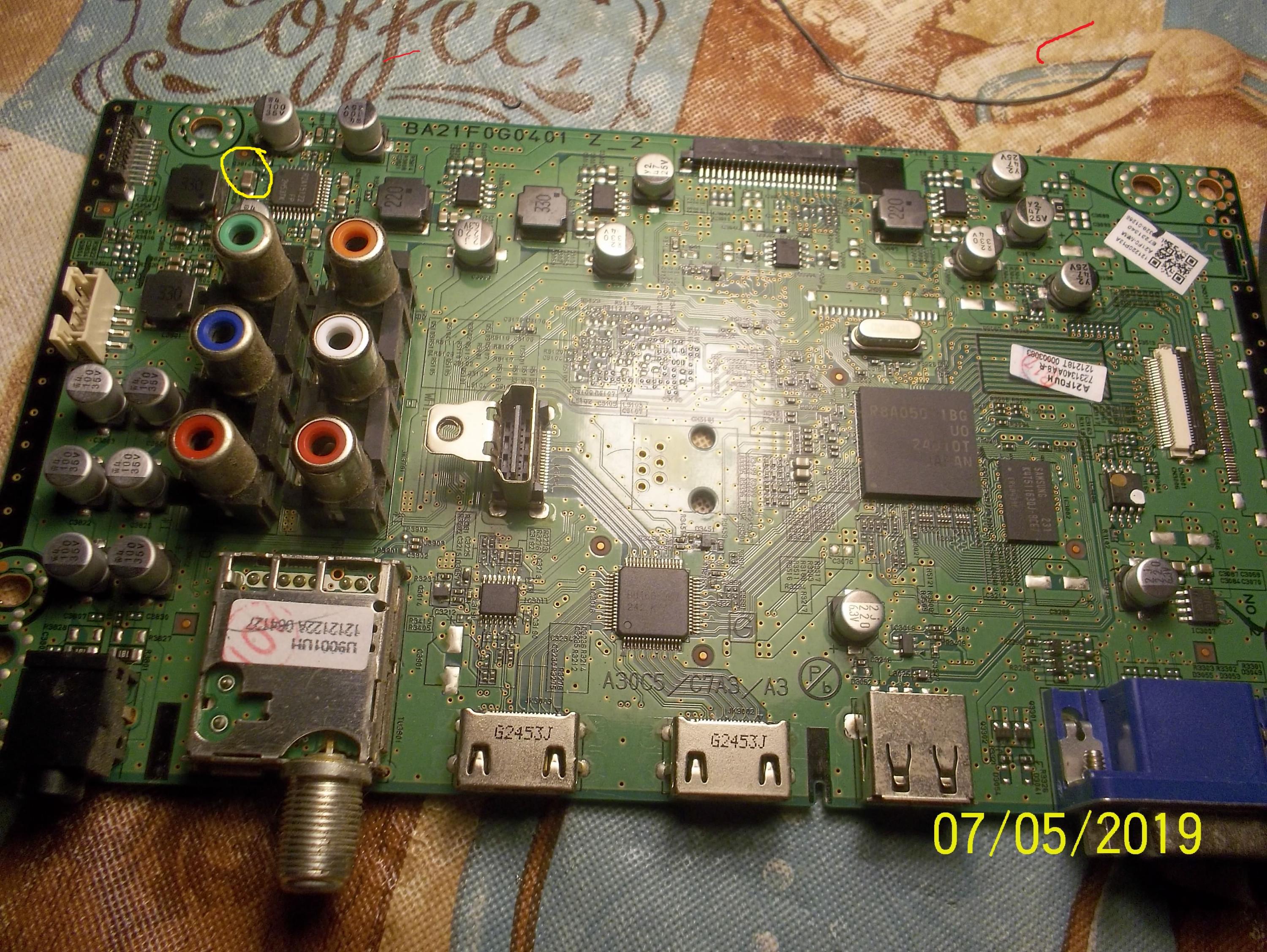

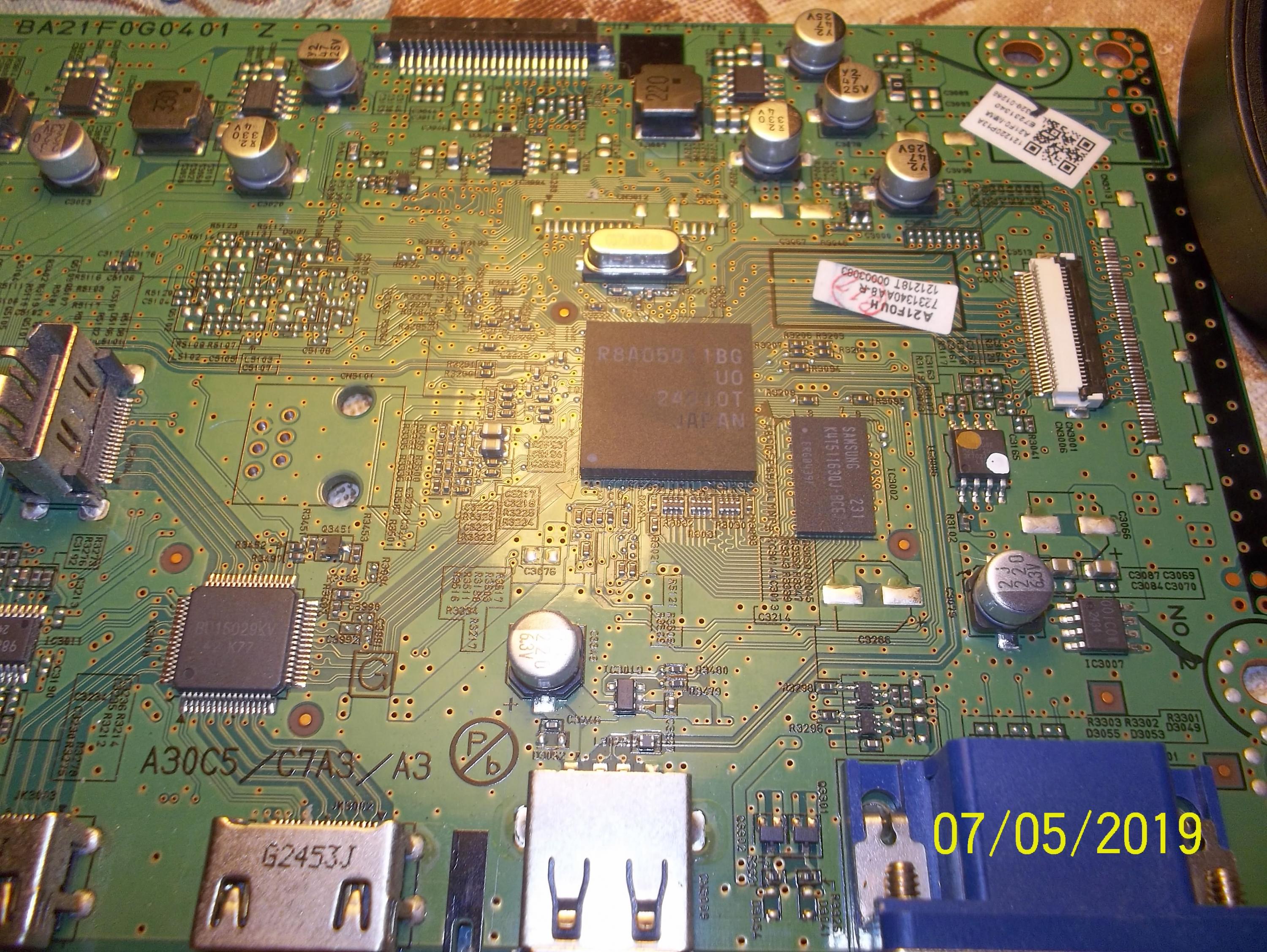

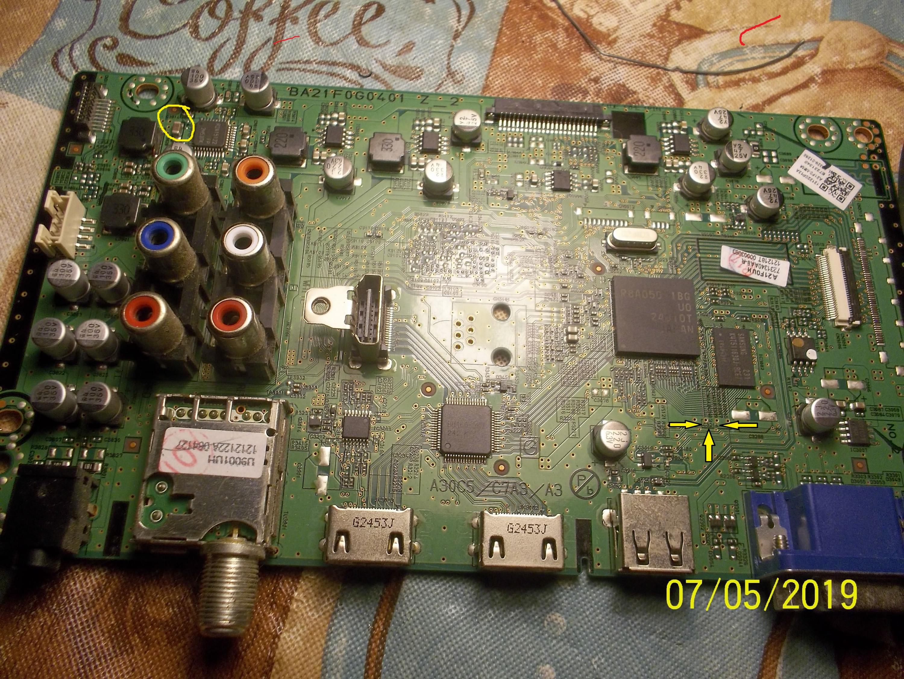

                              Okay so,
                              I believe I have all the tools I need to "maybe" figure this out.
                              Is it possible to find out what's wrong without actually putting it back in the TV? Like I said I have a replacement board that is working just beautifully and I would hate to have to take it apart if I don't have to, but if that's the only way, so be it. I just want to learn how to find the issue and repair it.
                              I've included some more pictures if that's helpful.
                              You mentioned a couple times C3214. I found that number but it doesn't look like anything's attached there. Of course I could be wrong.
                              I think you may have gotten that from that YouTube video. That wasn't the exact same board. Very close but not quite. It was just the exact same issue.
                              I pulled one ceramic smd just because I can now with my hot air thingy and measured it with my ESR meter out of circuit and it reads
                              between 0.650 and 0.750. Of course I have no clue what that means. But I figured I would start somewhere.... LOL Is that a good cap do you think? I circled where I got if from.
                              Well there you have that. Thanks again!!
                                  Read post #8 about checking the resistance.
                                  Read post #13, you are supposed to check the RESISTANCE of the suspected bad cap with the Ohm meter (Multi meter), that is what the meter you bought it for. I do not understand why you use ESR meter, we are looking for DCR of the cap, not ESR.
                                  https://www.badcaps.net/forum/attach...3&d=1562566440
                                  Is that C3214? I cannot read the deisgnator form your pictures.
                                  Please follow the instruction if you want help troubleshooting the problem.

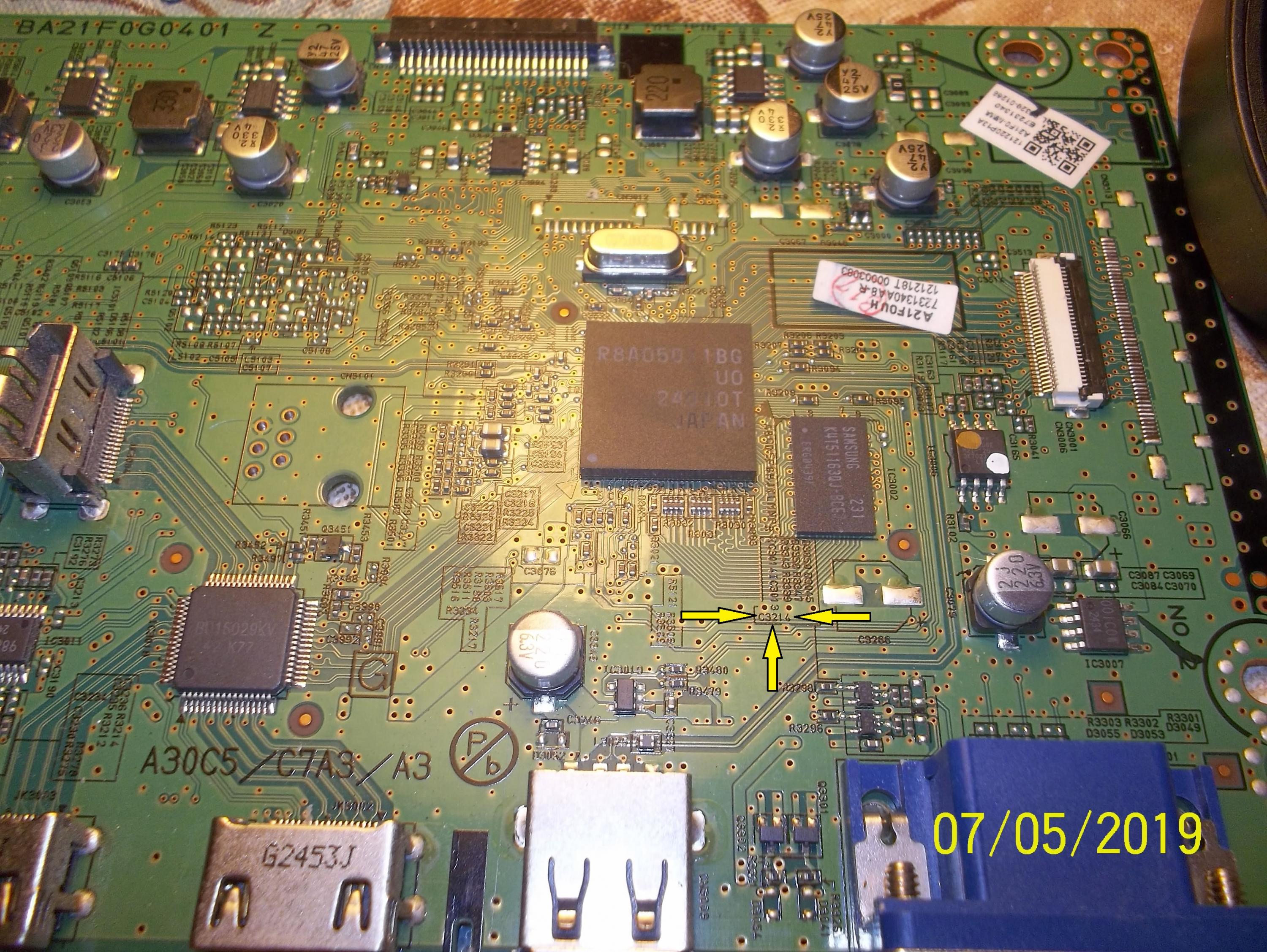

                                    The link you copied is not the C3214 you keep referring to. You can clearly see that number in the first 2 pictures.
                                    I redid the pictures. The Arrows show you where that C3214 is located. Hopefully that will help. In the meantime I'll try to figure out how to do what you requested in post #8. Thanks again.
                                        BTW: https://www.badcaps.net/forum/attach...4&d=1562566440
                                        Which cap is that one that you removed? C?????
                                        You must be real careful handling that type of cap (MLCC), it can be easily be damaged during removing or reinstalling. You must check its DC resistance before you put it back in place and after it is put back in place.
