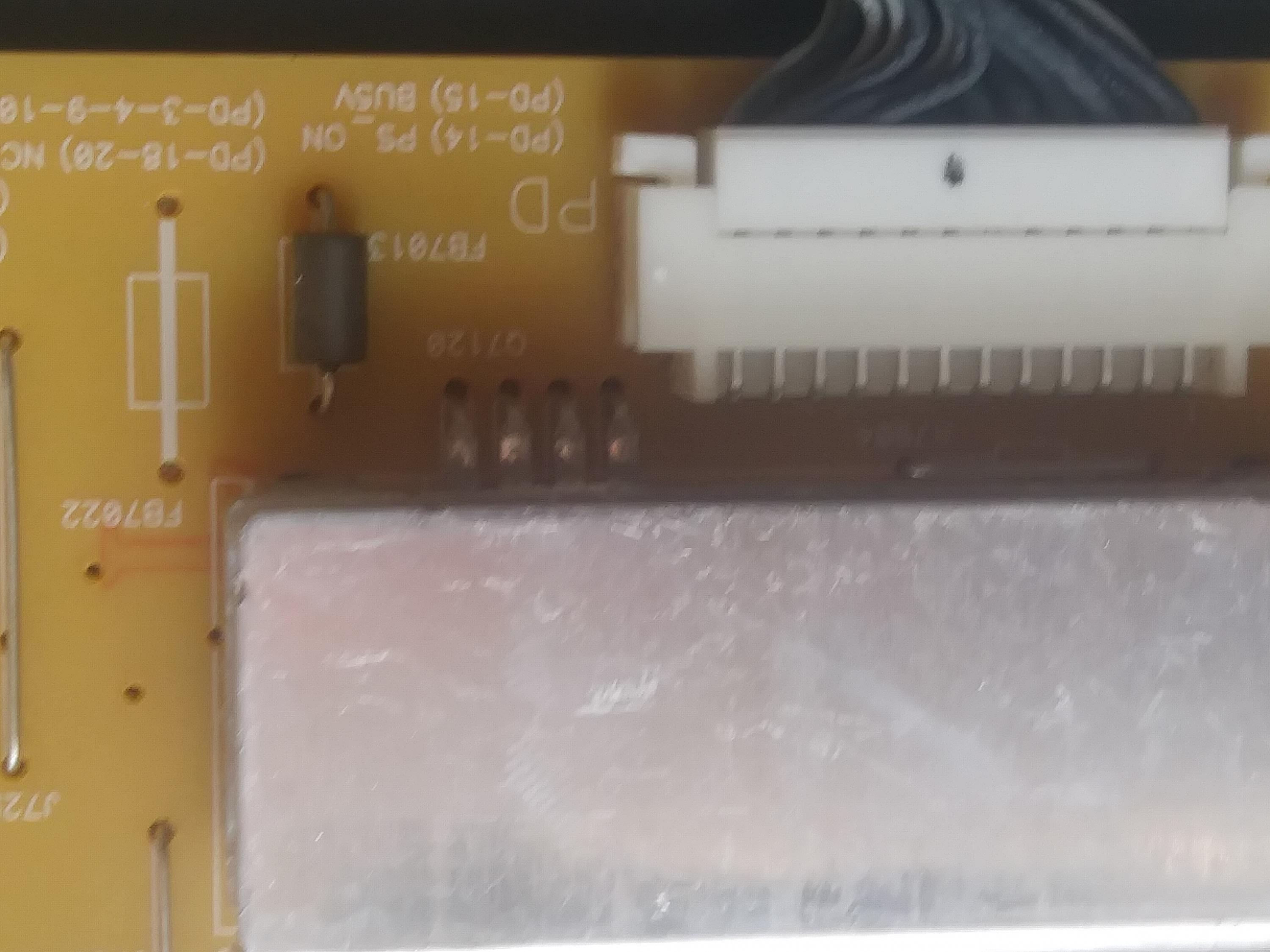

          Check Q7120.
          • nomoresonys
            • Jan 2013
            • 12206
            • U.S.
            Re: Sharp 70inch led 3blink & 1short
            With everything hooked up and power on, measure vdc on Q7120, starting from right leg, call furthest right leg pin 1, measure all 4 legs, report voltage readings.

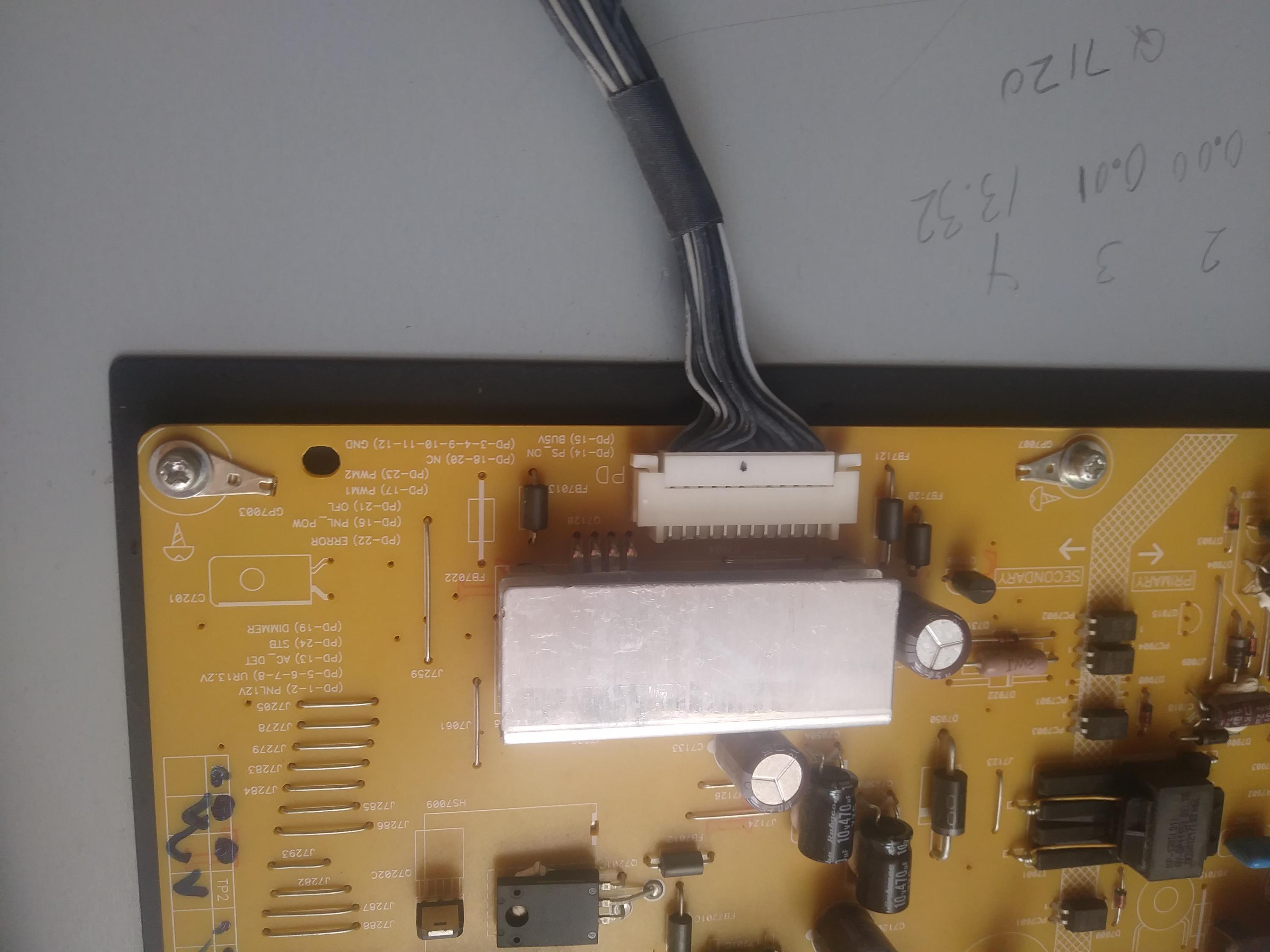

                  ..........Pins..Q7120....
                  1
                  0.132
                  2
                  0.00
                  3
                  0.01
                  4
                  13.32
                    Measurements seem off did you start on far right leg?? is this your board? see Q7120? it's on the heatsink right by the connector. https://www.shopjimmy.com/sharp-runt...-led-board.htm

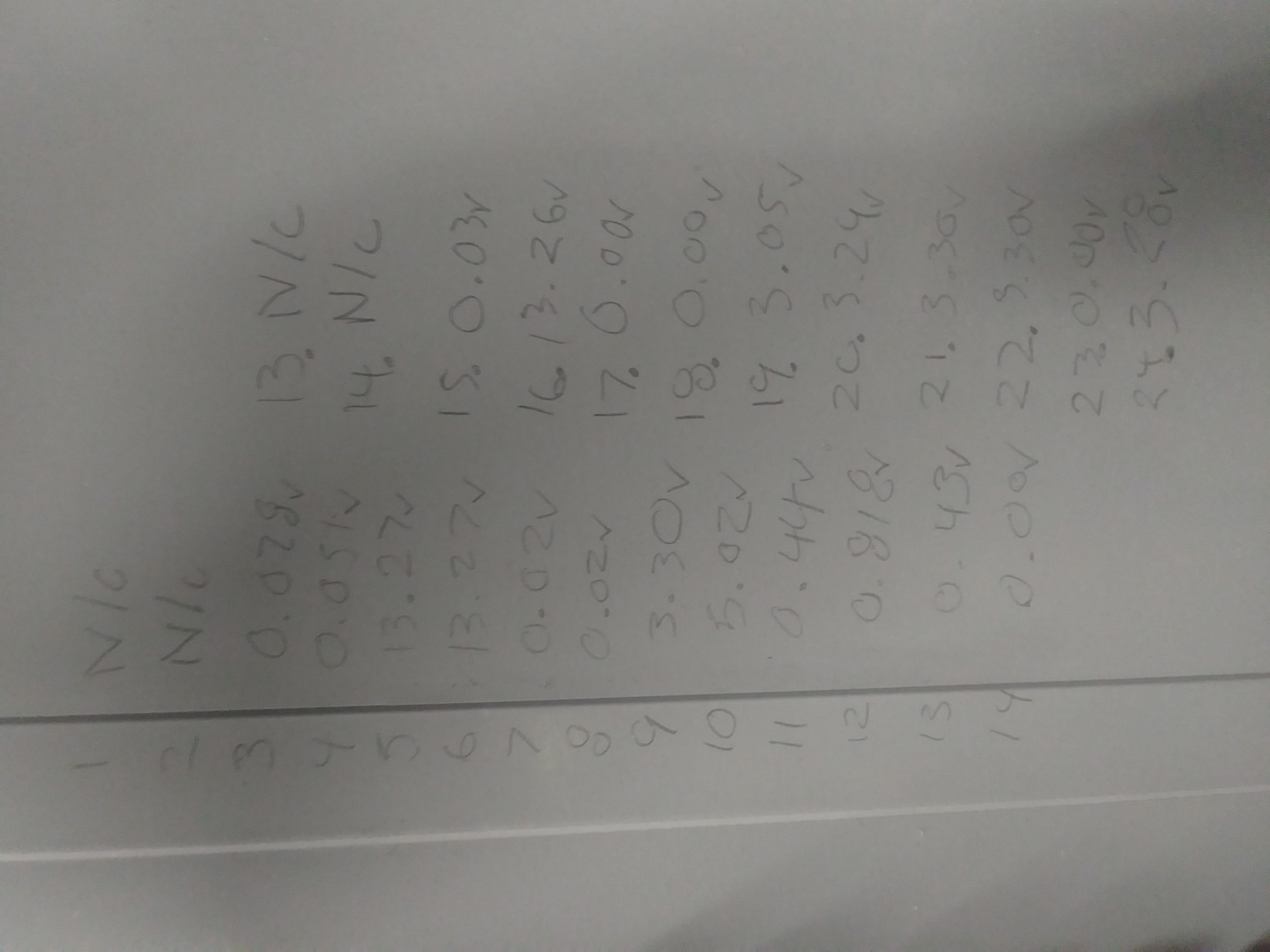

                      Test connector PD from mainboard to powerboard on powerboard side with all boards hooked up, test with tv plugged in but off then hit power, report both conditions here, give pin number, pin description/name and condition both off and when you hit power on.

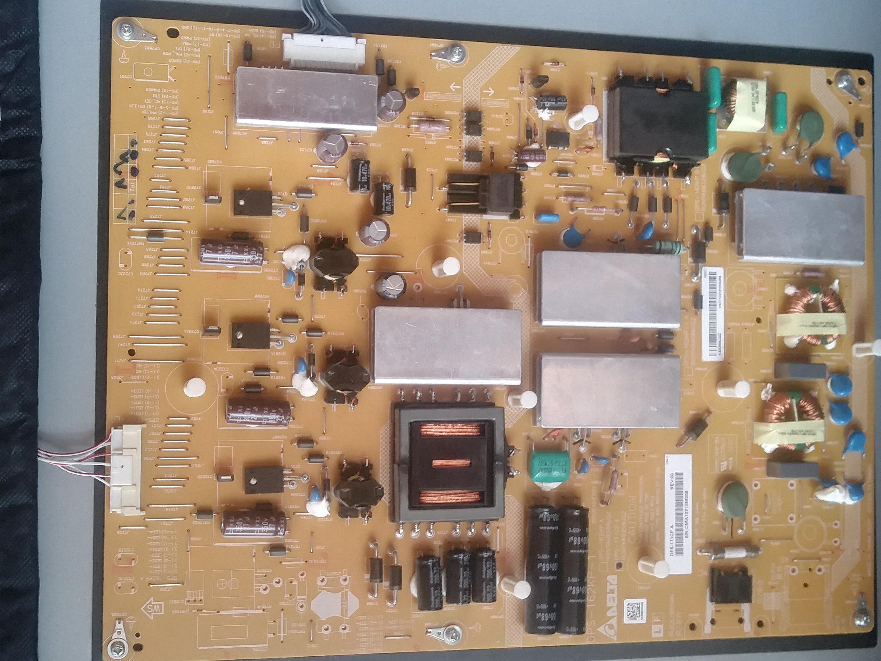

                          Originally posted by hmendez86
                          I check the Q1720...what i know or think is that 13.32v it should be 12v not 13.32. When i plug the tv led ligth stays lit like tv is on with the main board on the green ligth on main stays lit too...for several secs shutsoff and it start to 3 blinks 1 short
                          13V is the input Voltage feeding that switched 12V LDO regulator, it will not have 12V output until the PNL_PWR control signal (>2VDC) from main board is present to turn on that switched regulator.
                          Right now you need to provide the Voltage readings of the PD connector as suggested, also read the service manual regarding to the error codes.
                          You should also provide good clear pictures of the whole backside of the TV showing all the boards.

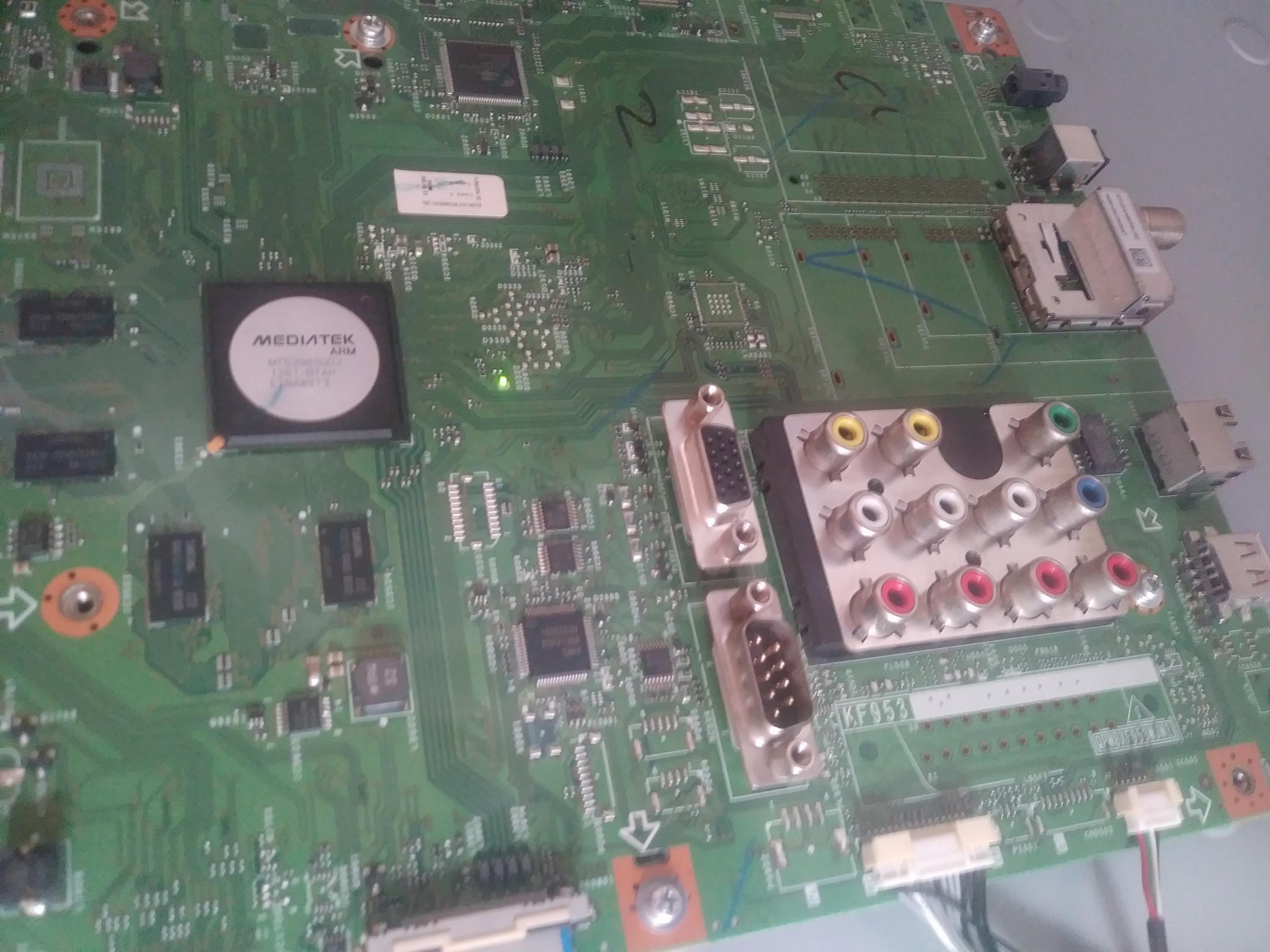

                            I change the power board still doing same thing my only thogth is the main board

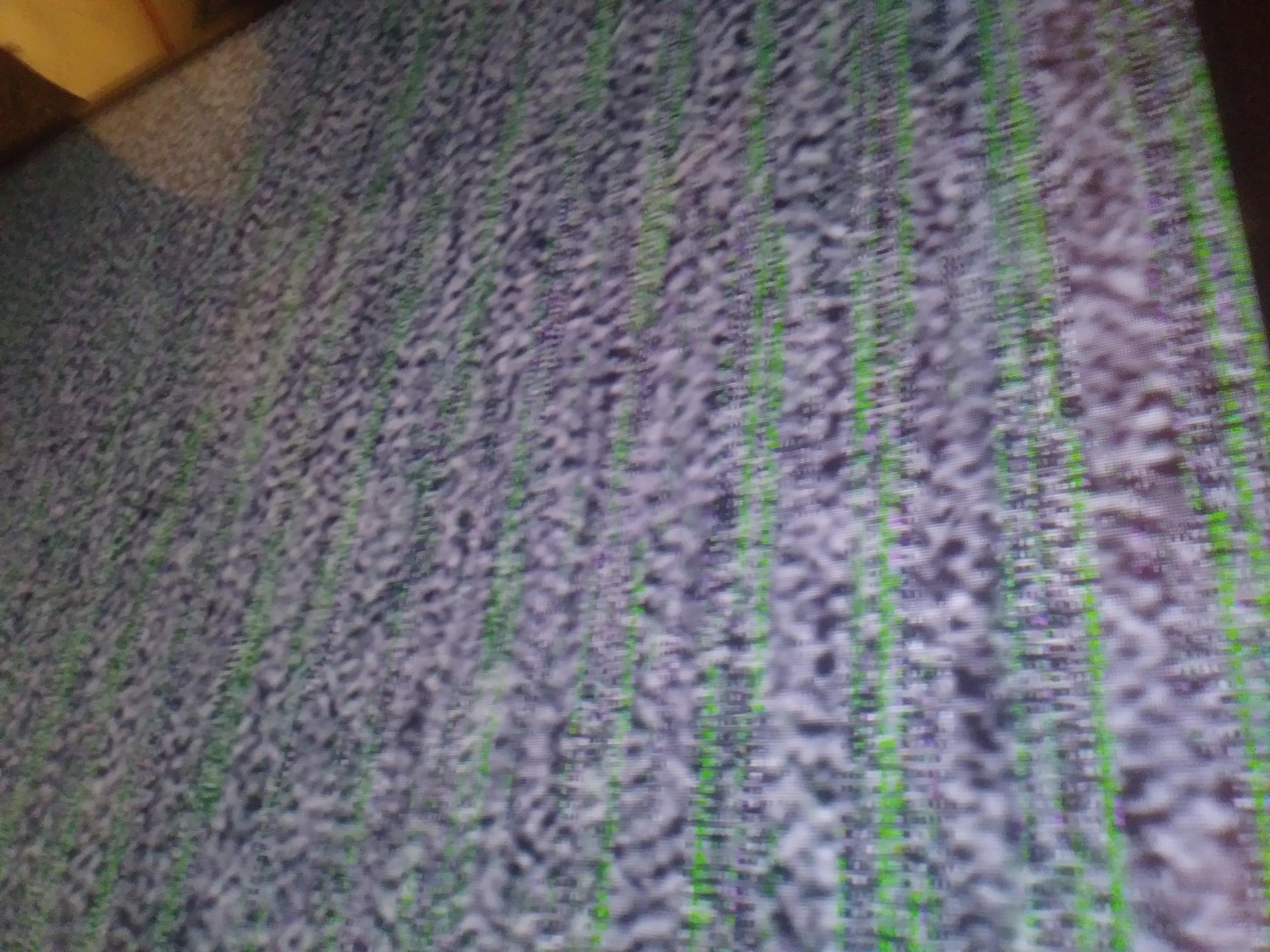

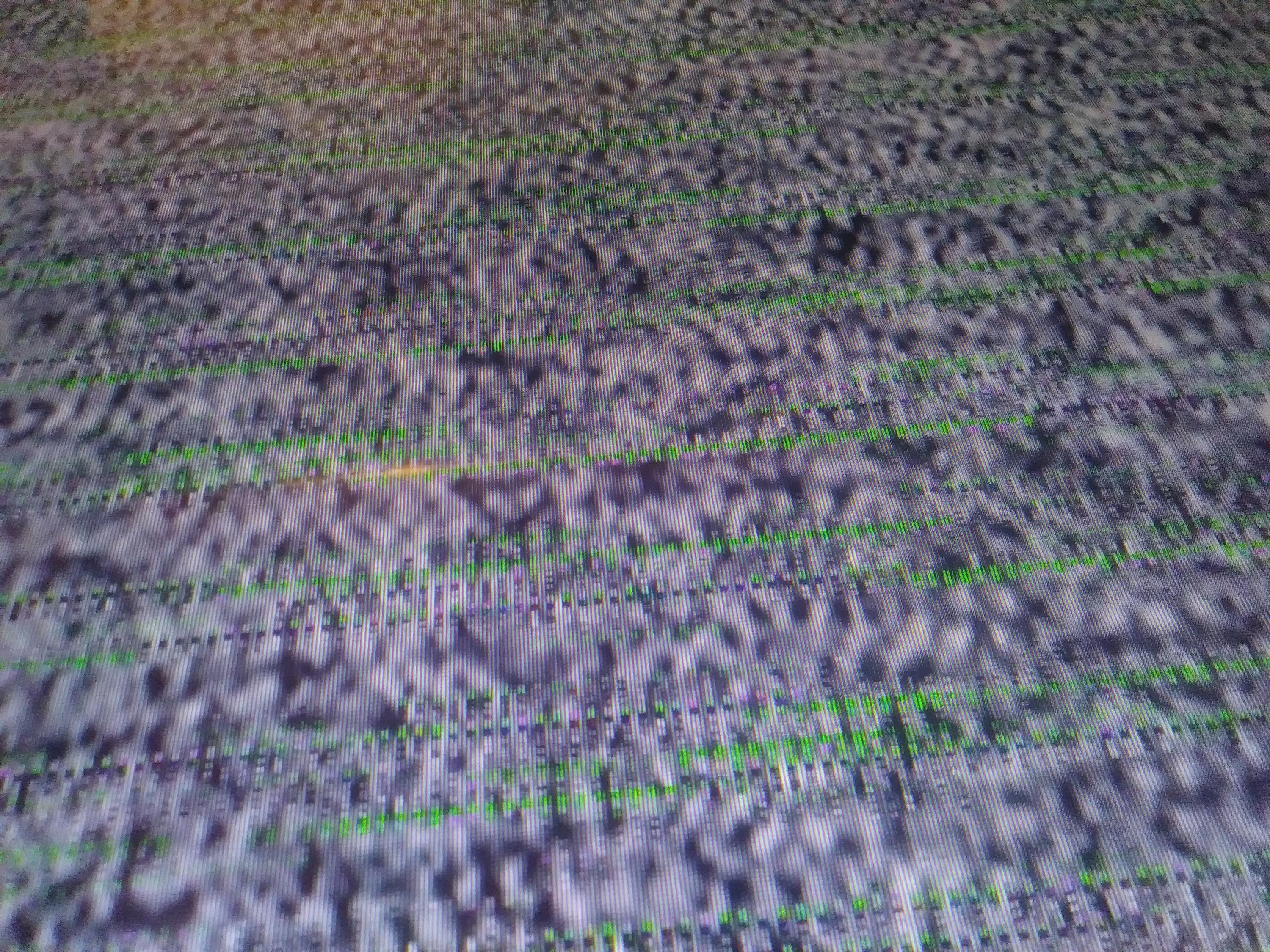

                                After a while trying to hard reset with buttons it came on the image show small green lines all over......
                                        That image looks like either BGA failure (the solder balls under the processor) or a RAM error.
