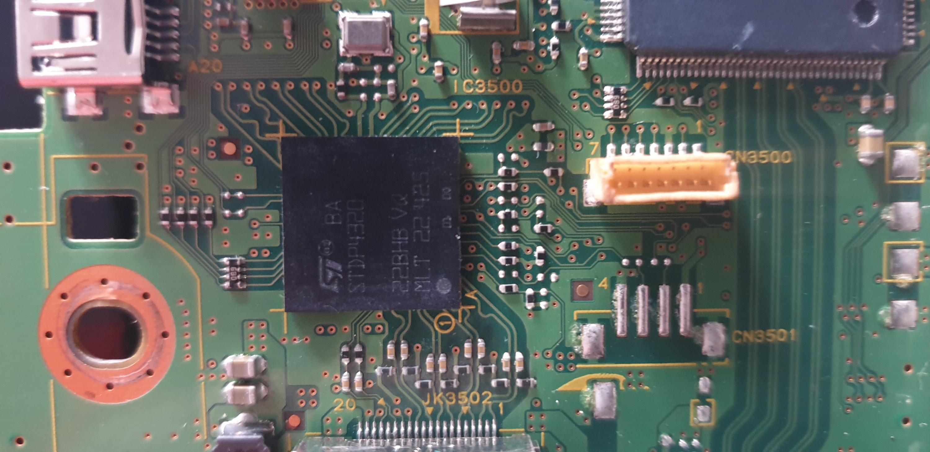

    Photos attached
    • diif
      • Feb 2014
      • 6978
      • England
      Re: Panasonic 58-TXAX802B Stuck on Panasonic Logo
      IC1600 looks like SPI flash memory.
      Is there anything on the other side of the mainboard ?
        Hi thanks for that info yes on the rear side there is another chip I shall when I get home send a photo to you to take a look
        Where would I acquire the firmware dump for this tv
        Can I just download new firmware from Panasonic and use that it is it a different kind of flash it does
        New to this so pretty basic skill but if it works it works if not then not lost anything as tv is stuck anyway so may as well give it ago
          Hi turns out the ic1600 was the chip I needed I think and its called a winbond w25q64fvsig flash I took mine out out it in the machine it read the chip saved to laptop
          Downloaded firmware from Panasonic then when I loaded that file it said it was to long so wouldn't open
          Must be something else I need to flash to it
          Instead I wrote the same info on chip back onto it and tries to fit back on board unfortunately I'm crap at soldering so instead think I burnt my board so after all that I have no idea if it would of worked so spares it is now for that tv
          Should of got someone to solder for me instead unforuanlty I cnat get it to stick without solder being all over the chip pins

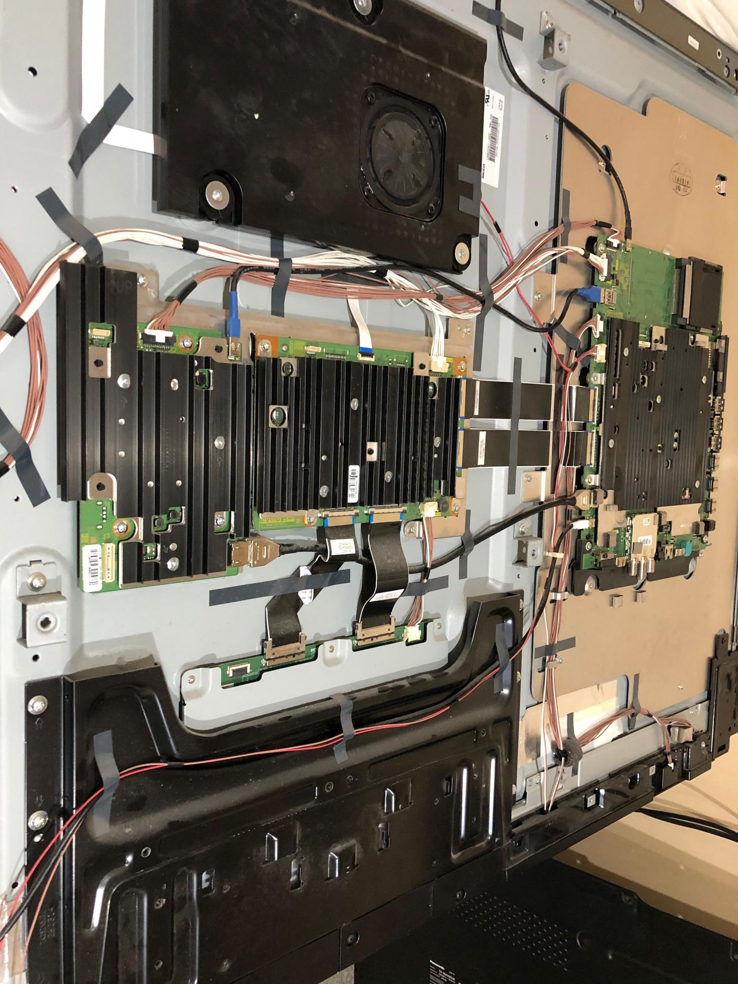

                                      Apologies for the general post, but I have exactly the same problem with the same model (the TX-58AX802). Removing and reflashing seems like an extreme solution but if anyone has any pointers I'd be more than grateful.
                                      I guess if someone could tell me where the firmware image is stored, for example there is a replacement t-con board on ebay which I'd happily fit, but want to be sure that will fix the problem (i.e. where the firmware is stored).
                                      There are three groups of boards (excluding the power on the left), the t-con board seems to be the one at the bottom (as it's the same as the part on ebay), but the other chap here sent a photo of the board on the right (which has all of the external ports connected). The centre seems to be the HDMI control board. If anyone could let me know which board I'd need to replace, or if there's any other way of getting beyond the panasonic logo that would be amazing.
                                      This only just happened, it seems to have automatically updated itself as it had been fine since I had it which was second hand for a little over a week!
                                      *** EDIT! ***
                                      OK - so t-con = timing controller, so would imagine it's unlikely to be that, so the firmware is on a chip on the mainboard presumably. Did anyone manage to reflash it? I'm so surprised, I've seen around 15 of these panels showing the same problem just in my limited research, there's got to be a straightforward way of doing this. WOuld happily pay is anyone could reflash it for me, I'm in Huntingdon\St Neots area.
                                      *** SECOND EDIT!? ***
                                      So based upon what diif and paul said I'd need to reflash the IC1600 (so need to work out how to flash it, and need to find the firmware for it, because the standard panasonic SEC file isn't enough), otherwise I'll need to find a main board replacement!
                                      *** THIRD AND FINAL EDIT!! ***
                                      OK so there's a connector labelled CN1600 which I traced back to the IC1600 chip, presumably so it could be factory flashed.
                                      Is there any way of getting hold of the IC1600 firmware from the above broken link, and would anyone be able to flash it for me for a fee?

                                        #39
                                        There is no need to upload a new DUMP to the IC1600, but the main problem is in the eMMC IC8903 on the other side of the mainboard.
