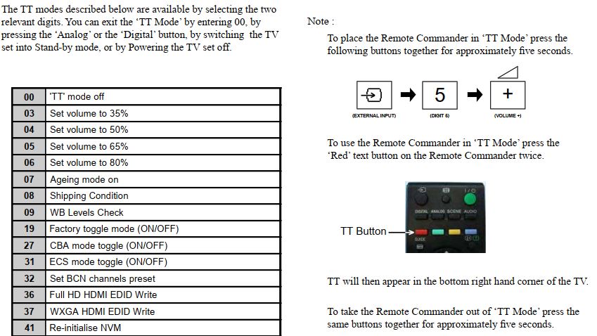

    Hi, a friend has brought me the a sony kdl37s5600 motherboard, which has the problem of 5 pulses blinking red led. Thinking that the issue could be the power supply, I've tested the board with my supply, having the same response.
    I've tested all the voltages(supply and dc-dc converters) and all are good at the beginning(because during the red led blinking the voltages disappear).

    Search for service manual not schematic.
    The LED flashing 5 times is a NVM error.

      I've tried to enter the TT menu, because i've seen in the manual that i can enter the number 41 to restart the NVM, but i can't do that, i've pressed the three keys to enter the mode during 5 seconds and the red key 2 times before pressing 41, without having any response.
      I've tested if the TV responds to the power off pulse of the remote control but it doesn't respond, and I think that the blocking status of it doesn't allow to enter that menu.
      I also cannot see anything on the screen because i don't have the t-con.
      Thanks a lot.

          With the whole tv I have the same response, it seems that the operating system is fully locked, and it doesn't respond to the remote signal.
          I have thought two alternatives: or search for the NVM memory and replace it (I don't know where it is located, the component name) or search for a new motherboard.
