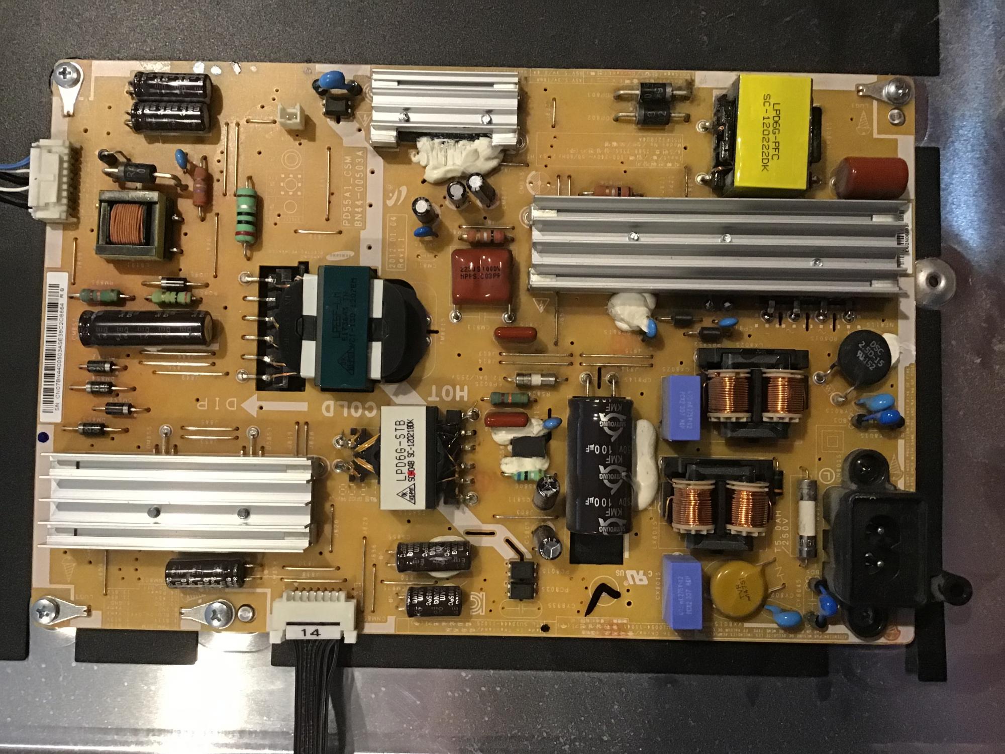

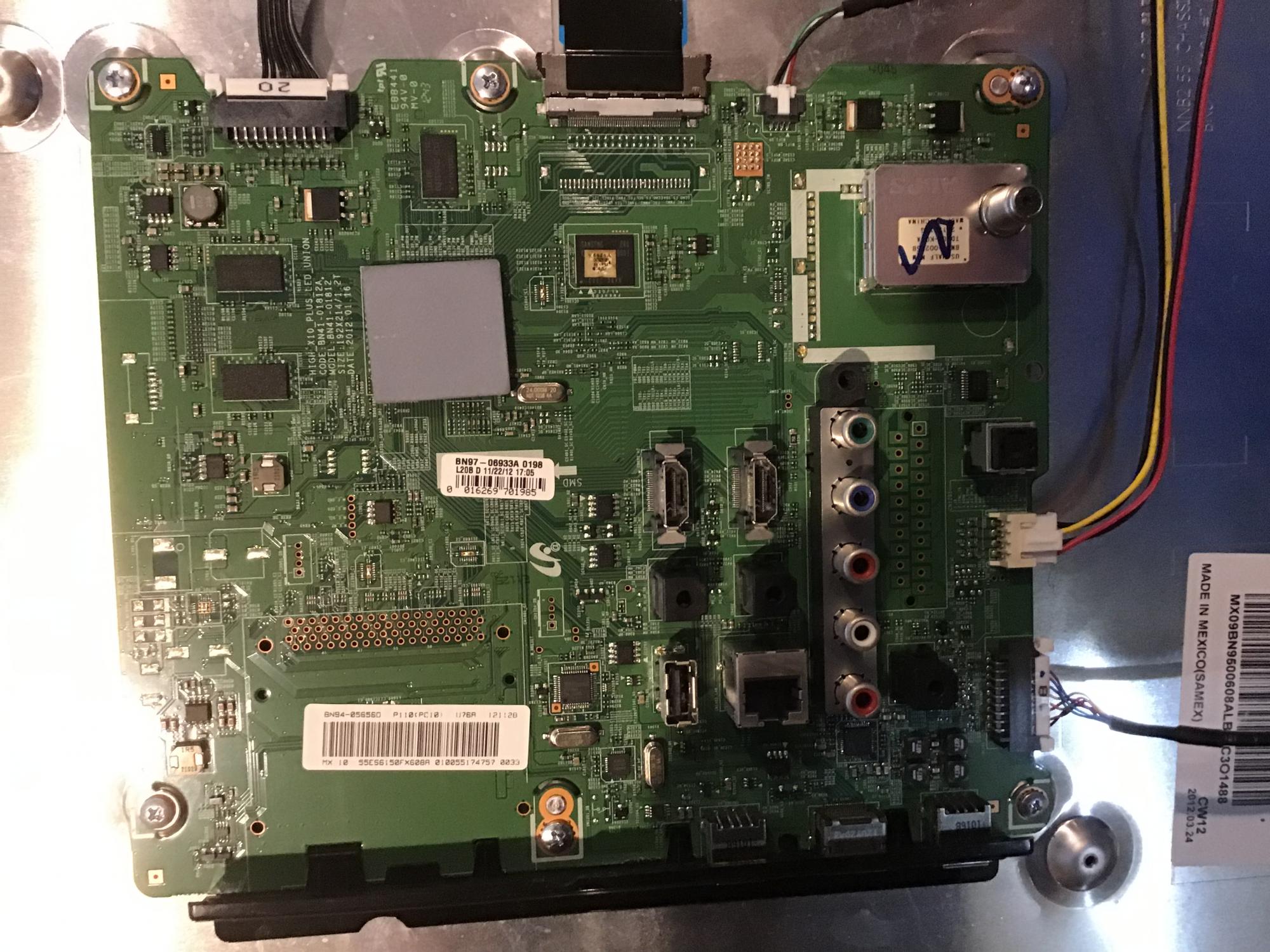

    I have a Samsung UN55ES6150F TV with a BN44-00503A power supply board and a BN94-05656D mainboard.
    An HDMI connector on my mainboard was damaged, so I remove it and tried to solder on another one. That did not turn out too well so i decided to remove the HDMI connector completly and reinstall the mainboard.
    Powered on the tv and it worked for minute or two. Then the volume died. I turned off the TV to check my connections and it would not turn back on. I would get 5 blinking lights and when i went to turn it on it would change to 2 blinking lights 5 times.
    I decided to order another mainboard. Installed the new main board and when power is applied i get 2 blinking lights 5 times. When i remove the cable that connects the power supply to the mainboard the back lights turn on and the blinking light is off.
    Here are my voltages.
    MB Connected voltages are at 0 until they jump to proper values for a second
    1. B13V———————12.73 to 0
    2. PWM_DIM—————3.84 to 0
    3. B13V———————12.73 to 0
    4. B13V———————12.73 to 0
    5. Vamp———————12.73 to 0
    6. BLU On_Off————0.0
    7. Vamp———————12.73 to 0
    8. GND———————0.0
    9. GND———————0.0
    10. GND——————-0.0
    11. B5V———————5.27 to 0
    12. A5V———————5.28 steady
    13. B5V———————5.28 to 0
    14. Power On_Off——.251 to 0
    Big cap voltage———-392.6 to 366
    Rectifier———————168.7 to 124.5
    MD not Connected
    1. B13V————-12.73 steady
    2. PWM_DIM——-3.156 steady
    3. B13V—————12.73 steady
    4. B13V—————12.73 steady
    5. Vamp—————12.73 steady
    6. BLU On_Off——-2.94
    7. Vamp—————12.73 steady
    8. GND——————0.0
    9. GND——————0.0
    10. GND—————-0.0
    11. B5V——————5.27 steady
    12. A5V——————5.28 steady
    13. B5V——————5.28 steady
    14. Power On_Off—-3.294 steady
    Big cap voltage———392 staedy
    Rectifier——————-108.5 steady
    Written on board
    A5V:5.3V/18mA
    B5V:5.3V/3.4A
    B13:12.8V/2.1A
    Vamp:12.8V/0.3A
    Does anyone have any ideas?

    here are pictures of the boards

      Either your mainboard repair damaged something connected to it, or the replacement mainboard is faulty.

        Looks like the new mainboard isn't sending the bl-on signal, where did you get it?

          That PS-ON is cycling up and down so the switched B5V, B13V, and PFC Voltage is not stable. Main board is not sending steady PS-ON signal.

                Usually confirms powerbord and backlights are working right when the backlights come on when remove cable from powerbard to mainboard. Do you have steady voltages with that cable removed?
                  Yes, all the voltages are present and steady

                    Think I would send that mainboard back, can they send you another one?

                      Sent back mainboard for another one. Problem fixed
