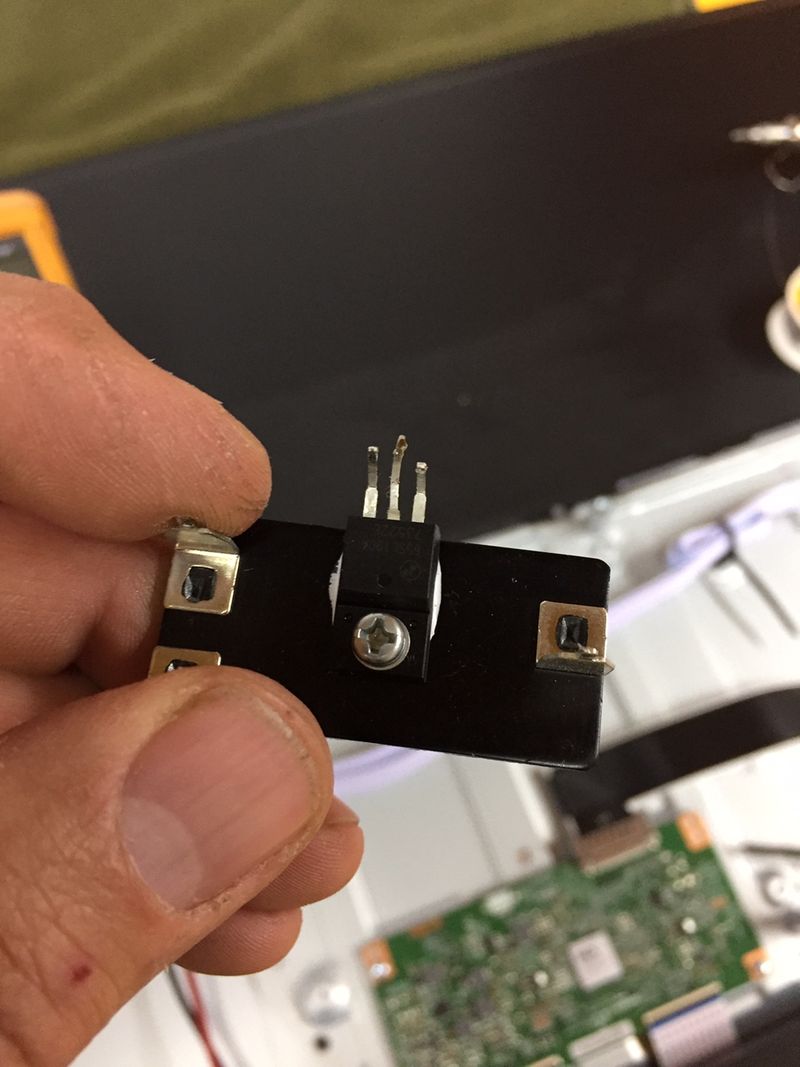

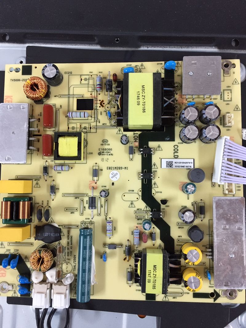

Got a hitachi 50" today delivered without back plastic cover.I'm not sure of model but its a may 2018 sticker on it.It has a blown mosfet 65sl190a and very limited info on where to get it on the web.Anyone run into this issue?

It's a AP65SL190AI, here is the datasheet. I did't check all the specs but FCPF190N65FL1 might be a sub
Power supply # TV5006-ZC02-02Attached FilesLast edited by R_J; 06-16-2019, 09:19 PM. -

Thanks RJ looks close enough for crowd we works for lol.I will give it a try.Comment
