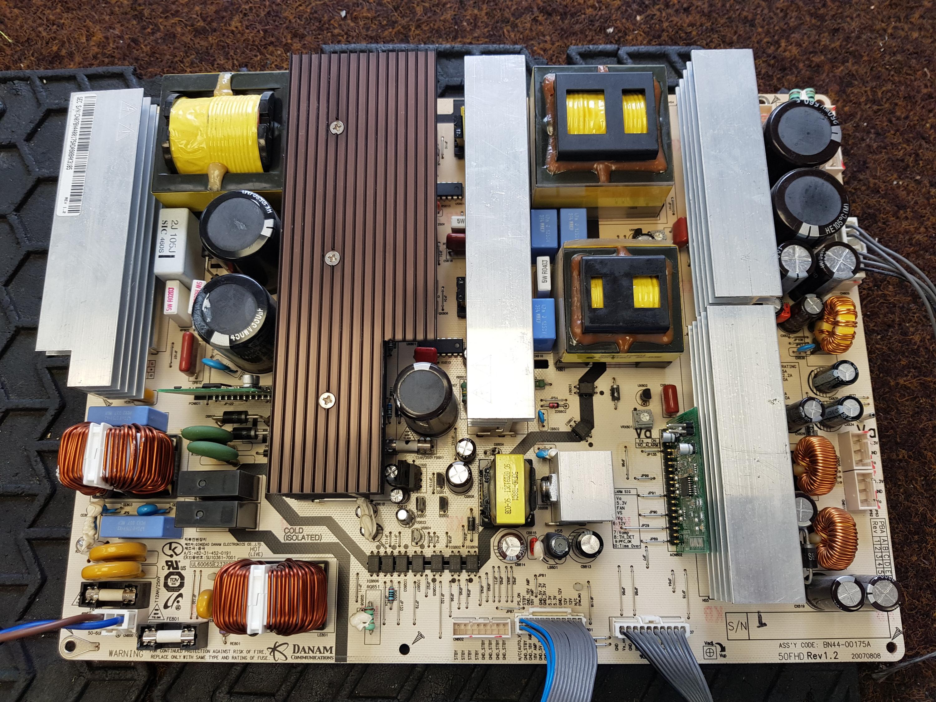

    I have a TV with a fault of not starting up every time,
    It is definitely a power supply board issue, I have found that all voltages work apart from the VS volts 200v rail.
    So the set shuts down and tries again.
    Even on the test bench with the PS-ON linked, its the same on the bench.
    I cannot find the fault, and sometimes it does work and the set runs perfectly.
    Mark.

    Re: Samsung plasma PS-50P96, BN44-00175A PSU
    OK just realised i wasnt connecting the VS on properly,
    Now i have that triggered, still no volts but green LED does 4 flashes.
    Mark.

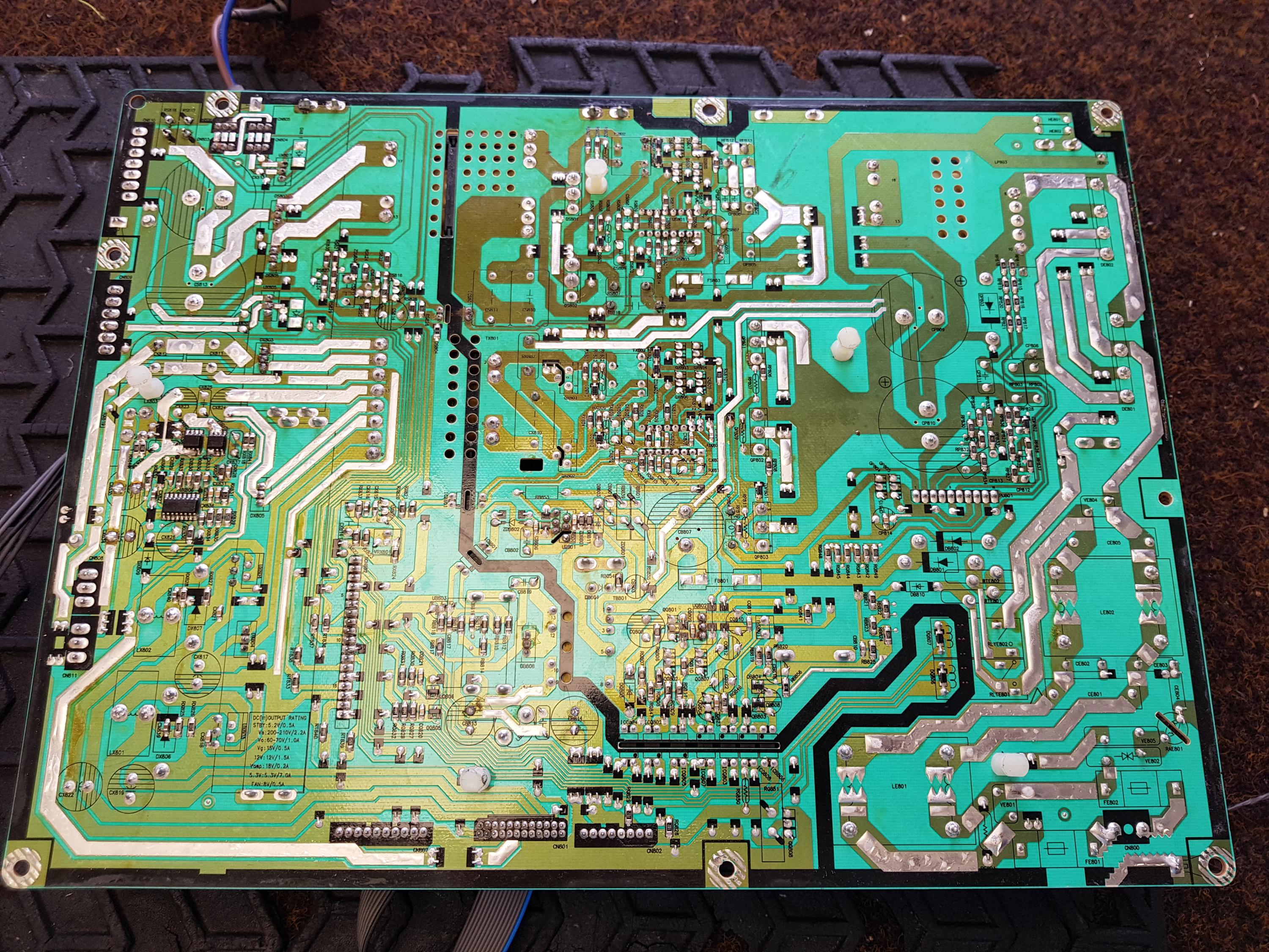

      Can we see good clear straight shot pictures of YOUR board whole top and bottom side?
        • masaudio
          • Jan 2013
          • 16
          • England
          There we go.. thanks, Mark.
            I have just been over the caps with an ESR meter, I found CX813, CX807, CS807, CQ810, CQ812 (all 47uf 50v) & CQ822 (4.7uf 50v)
            All reading low or compare, replaced with new ones.. fault still the same.
            I have tested every other cap and the only other one I replaced that was visibly blown was C8814.
