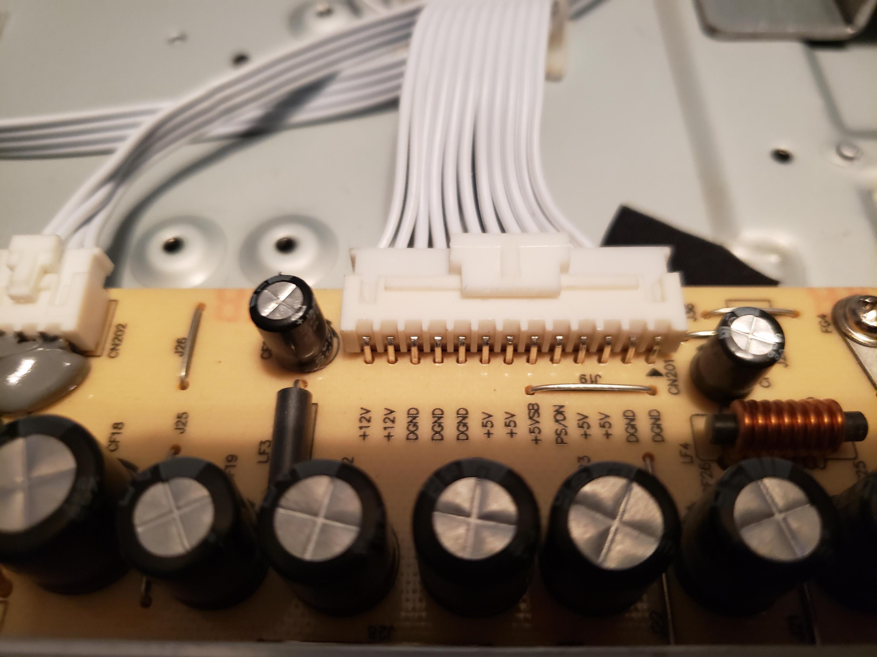

      OK here are pictures. I don't think there is an issue with the panel as I had the whole front frame back on after installing the panel and everything worked fine and I had picture on the screen and was able to get into the menu and even had it hooked up to watch TV.
      So far I have checked con201 on the PS
      starating from the top at 12V going down I have
      12V = 12.81
      12V = 12.80
      DGND = -.005
      DGND = -.004
      DGND = -.004
      5V = 5.16
      5V = 5.16
      5VSB = 5.17
      PS/ON = 4.041
      5V = 5.17
      5V = 5.17
      DGND = -.004
      DGND = -.004
      When the TV is plugged in I hear the PS and nothing changes when hitting the power button on the TV except the voltage on the main board that connects to the actual swith drops from 3.278 to .073 which in my experience should be right.

        Those Voltage readings are fine, the PS-ON control signal from main board is present so the Switched 5V and switched 12V are.
        We need to see the whole backside of the TV to see all the boards and how they are connected together.

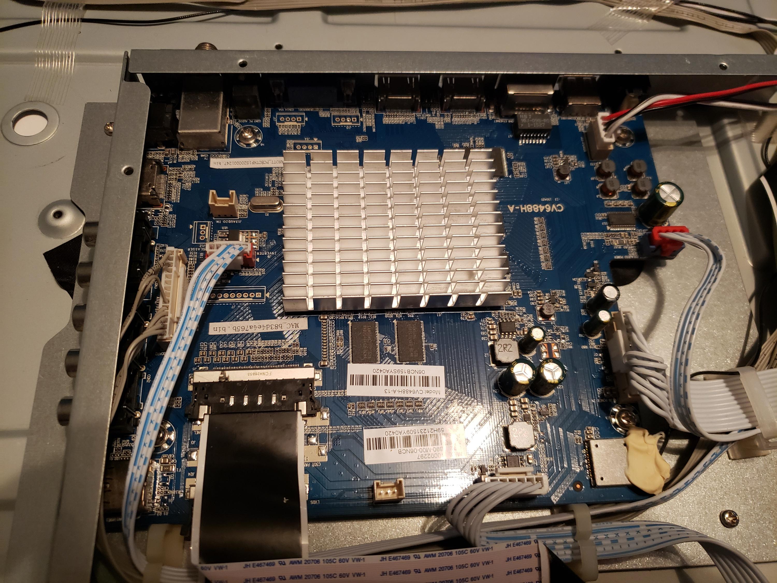

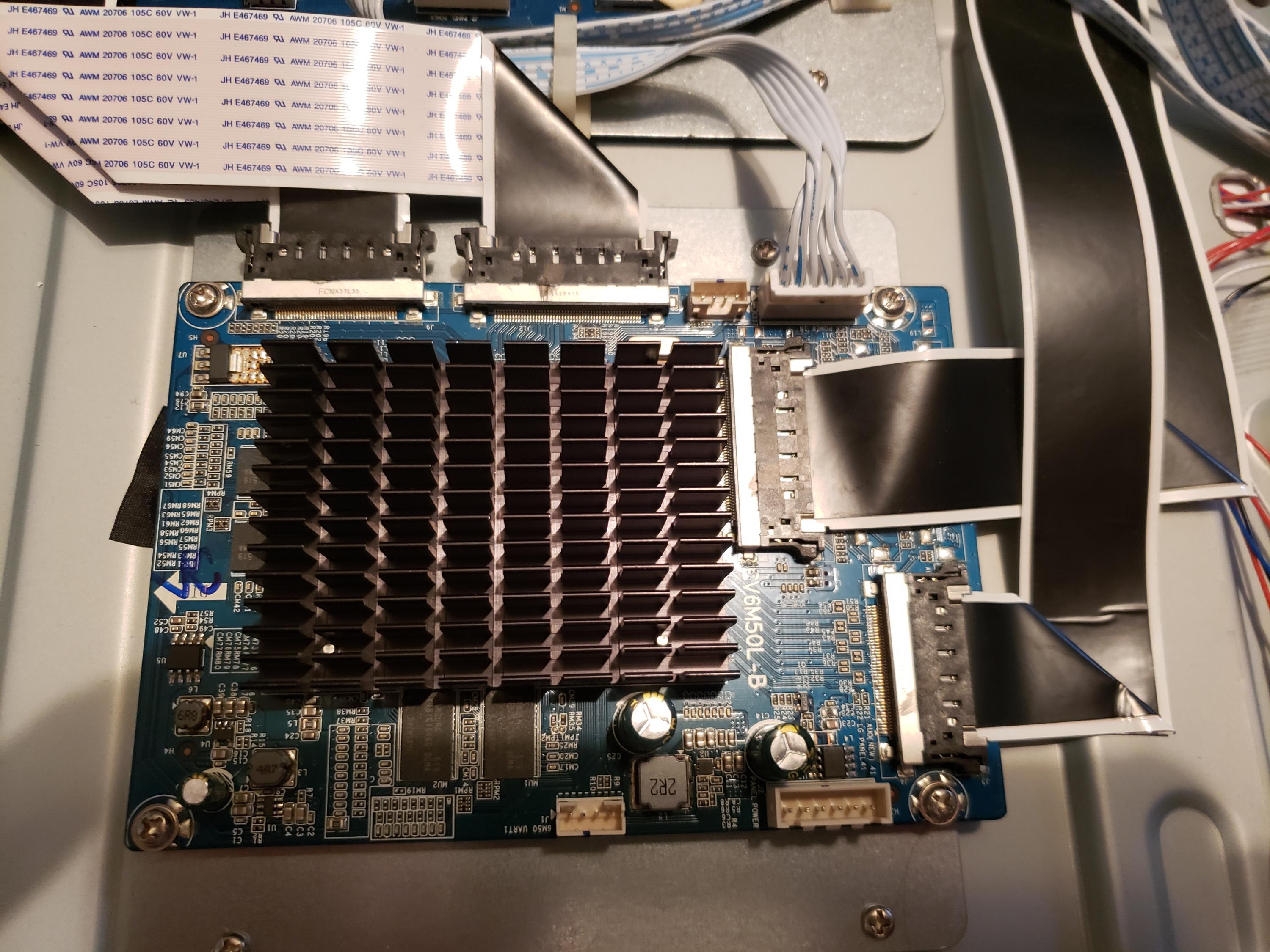

          Back Pictures
          The other thing I can't figure out is no back lights or power indicator light which I had both of before the back was put on, even if the T-con is disconnected from the Panel.
          Back lights all three sets test good at 121V with BL tester.

            Re: Panasonic tc-65cx420u No Power
            So there are two more connectors from the power supply/LED driver board to the main board but the pins are not labeled (I do not see them), one of those two connectors should have BL-ON and Dimming control signals for the backlights.
            The main board is not dead since the PS-ON is present, but does the PS-ON change state when you toggle the TV ON and OFF.
            I assume that you already try re-seating all the cables, flexing the boards, tightened all the boards mounting screws?
